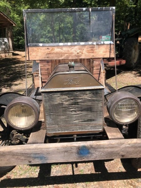

if this is it: https://www.facebook.com/marketplace/it ... 119230694/
then there isn't much there, and even if a '14 engine, it's a toss-up if its even worth what you plan to offer.
There was no such thing as a "Stagecoach Edition" Model T, so you're dealing with an owner who know absolutely nothing about this thing (it's not a car) and maybe less about it's condition or anything else.
You could sink multiple $1,000's into this thing just to make it run, and when you do, it'll still be worth only what you originally paid.

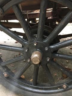

OK, I just looked at the rest of the pix. My advice above is not strong enough...Something terribly wrong with rear axle and the frame appears home made.
Pass on it. Actually, I'd avoid it like the plague.

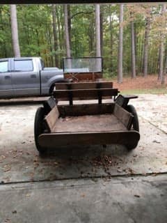

Further study of the pix and I'd say you would want to sue them for the price of gas to go look at it.
It is 100% a fantasy creation and is either horrifyingly sad or comical depending on your meds today

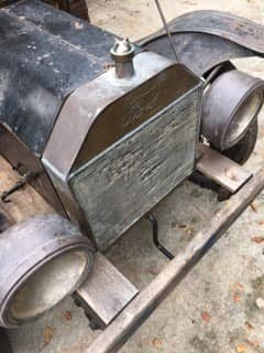

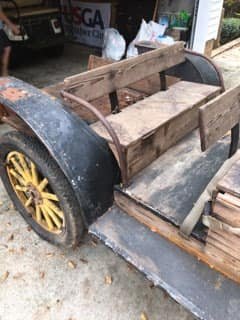

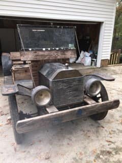

Erik Johnson
- Posts: 1143
- First Name: Erik
- Last Name: Johnson
- Location: Minneapolis, MN
Re: Going to look at a 1914 T Coach

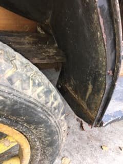

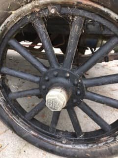

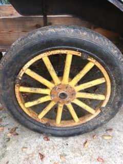

Note the Essex front wheels and the non-Ford front springs.
The hood in relation to the front axle has incorrect geometry.
It's not even a Ford. Probably an Essex running gear and engine, etc.
Very crude vehicle.
Very crude vehicle.

William, that is not a model t. It has a few model t parts with a lot of other manufacturers parts from various years cobbled together into a big kids go-cart. There is no evidence from the pictures that there is actually a model t engine in there.
If the radiator has not been molested it could be worth $100-$300 depending on year and condition. Ford radiators have a manufacturers tag with a year soldered or stamped on the back side.
If you want a model t ford, keep looking, this aint one.

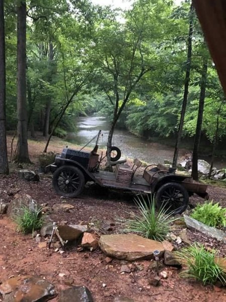

FreighTer Jim
- Posts: 1722
- Last Name: Jarzabek
- Location: Dayton, OH
- Board Member Since: 2008
Yard Art
Yard Art
As being displayed now
If you have a use for unique yard art ....
FJ
FJ

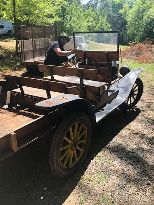

Here you go Wayne.

Model T Essex hi bred. If it runs and drives would be fun to play with as long as you know what you are getting. If you were buying as a T, not!

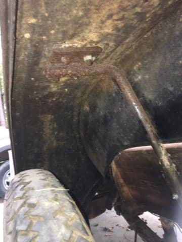

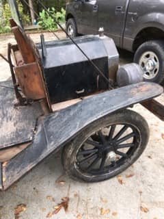

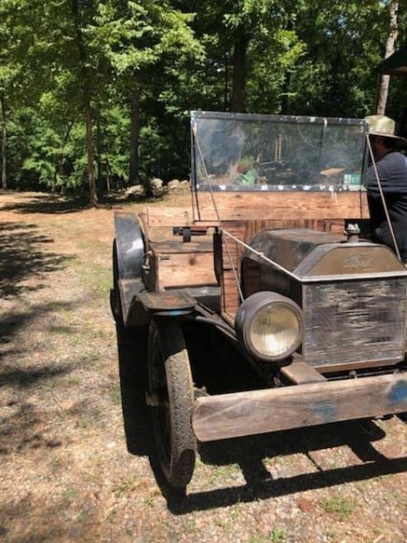

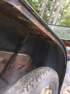

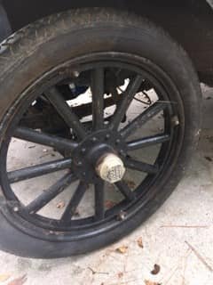

- Posts: 7411
For Wayne and anybody else without access, here are more photos.
- Posts: 7411
- Posts: 7411
I could have made them bigger, but I don't think that would have made it look any better.
