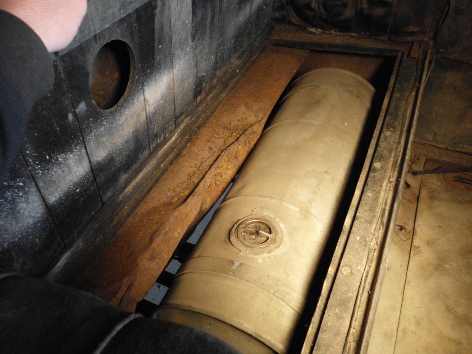

My 13 wont help as it has had some damage where it looks like someone pried the tank up and out through the seat platform to replace it or something. I do think Scott is correct about it should be a round tank but don't take my word on this one, let the experts confirm this.

Bob,
Thanks for the reply and photo.
I have the same tank (I should've written "round" and not oval.
A previous owner did the same thing to my seat platform so I'll have to address that at some point.
My tank is back in and all tightened down.
I had to loosen the straps temporarily on both ends and do a little wiggling with them to get everything lined up.
