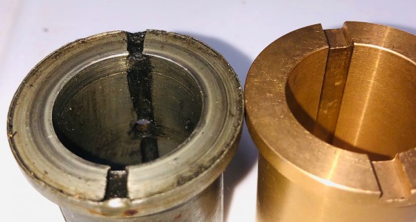

There should be a groove for the grease to travel along on the inside of the bushing that runs from about where the hole will be drilled to the front. That groove needs to be lined up with the hole. Not all types of bushings sold have one because more often then not when a used driveshaft is used, the drive shaft is worn undersized so there would be too much clearance and lots of space for grease to flow. One of my pet peeves is people not understanding the importance of that bushings fit in relation to the driveshaft. ;) I am pretty sure the machined brass ones have the slot the sintered bronze ones don't. If you are using a new drive shaft, it is my op that it should have one no matter the material.

This photo should help, the Babbitt old one on left, new on right, note the large grease groove or slot, align this slot for the hole to be drilled for the grease dope cup on the driveshaft housing... lets the grease flow the length of the bushing.

Also shown in Dan photo, the slot in the face. That slot gets the grease between the bushing and U-joint.
