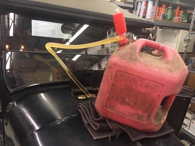

Re: "T" will not continue to run.
Today was fill up day. A nice day for a ride.

I think everyone has the same problem when you must fill the tank from a gas can. Last year I bought a syphon hose with a check valve at one end at Hershey. By putting the non check valve into the cars tank and the check valve end into the gas container and moving it up and down several times, the gas flows without a spilled drop. HOWEVER, BE SURE TO REMOVE THE CHECK VALVE END FROM THE CONTAINER BEFORE THE CARS TANK IS FULL!!!!
