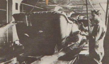

One method was flow painting the body -
http://www.mtfca.com/cgi-bin/discus/sho ... ost=195547
- Attachments
- 111502.jpg (18.9 KiB) Viewed 7423 times
- Posts: 5564
- Last Name: Hatch
- Location: Alabama
Re: How were Ford Model T bodies painted?
This type of painting is called flow coating. Last place I saw it used was at Bush Hog. They then went to powder coating. Dan

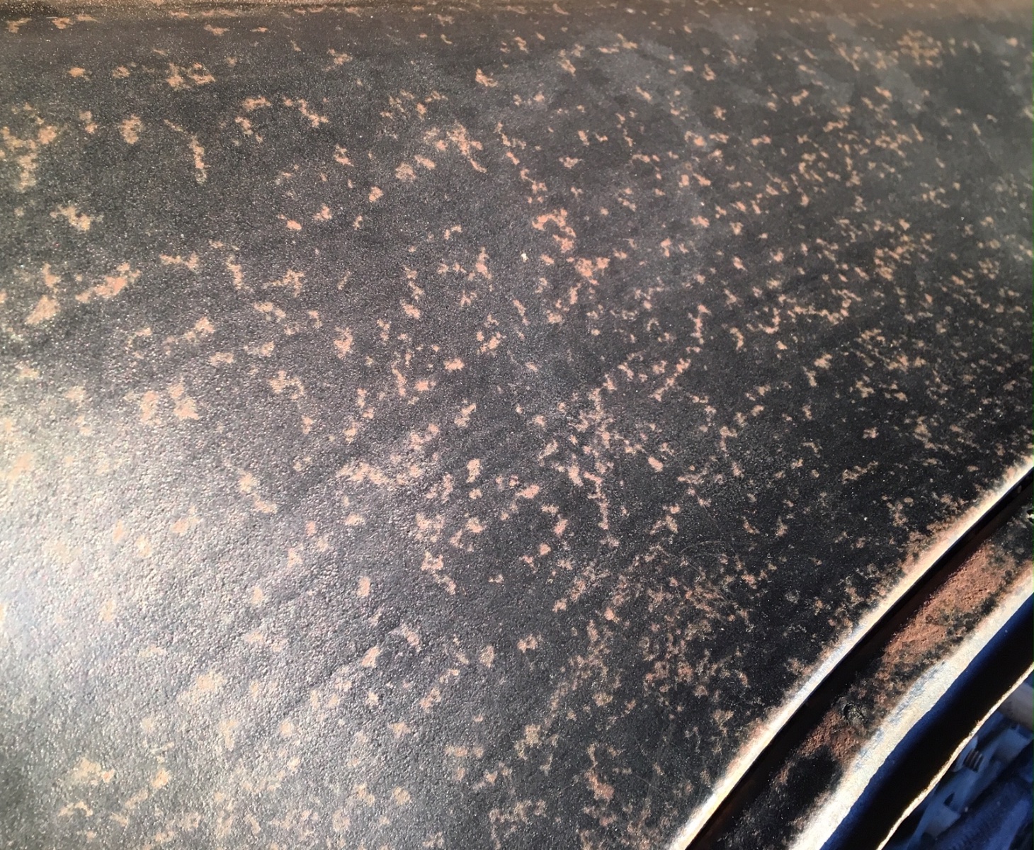

My 24 Touring shows what I believe is evidence of the flowed-on paint method. These stripes in the very old paint are what I’m referring to. They continue around the entire body in a way that allows you to see exactly what the pattern was that the painter was following.
Also present at the bottom of the body panels are drips.
And, although the fenders and aprons have the same old paint, they do not show the striations, which tends to verify my theory (because those parts were not flow painted).
The car was thoroughly used up during its working life and is not a true preservation/originality type car due to the farm mods it received. However, due to it being stored indoors in West Texas , the body is nearly perfect and I believe the paint is original.

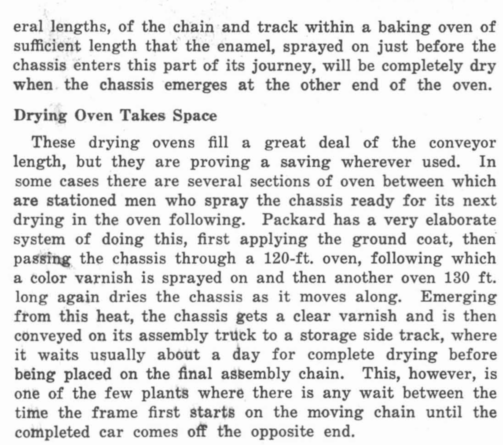

Very different types of paint applications from the different factories of the day. Gravity flow painting was well suited to assembly line, Ford used that for bodies, and used vats of enamels for sheetmetal, along with drying ovens too. Later the steel bodies got spray painted by late 1925.
Other firms used spray painting very early, for enamels too, note this article in 1916.
Packard was spray painting colors on bodies.
The Automobile July 1916
