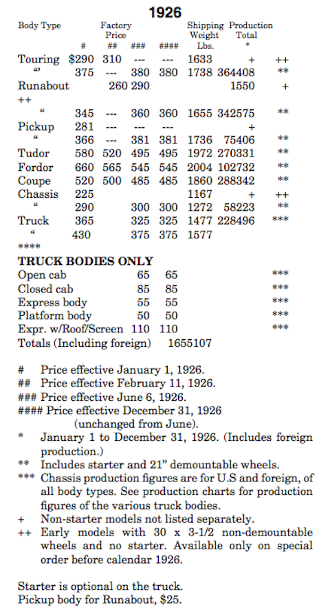

Im needing to work out how much a complete powerplant from crank handle to 4th main weighs.. any idea?

550 lbs. on a skid.

With or without coils, generator, and starter would make a difference.

Stock, with generator coils and starter. Would also be handy to know the weight of a rolling chassis without bodywork. trying to assess the weight of a minimally bodied speedster compared to a stock roadster

Post by Steve Jelf » Wed Nov 20, 2019 1:29 pm

Thats great! 😊
