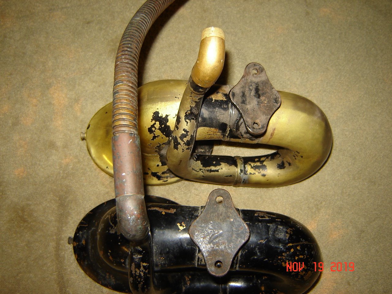

Those horns are pretty plentiful. Many times they are interchanged incorrectly. A true '15 horn has a scalloped bracket. As far as I know all 13-15 horns have the same hole spacing. For detailed information contact Jim Lyons in West Virginia.

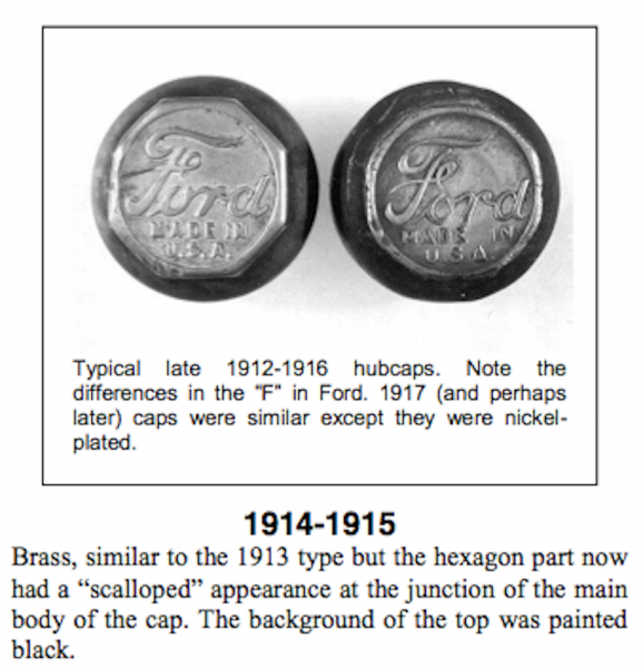

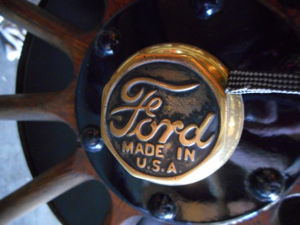

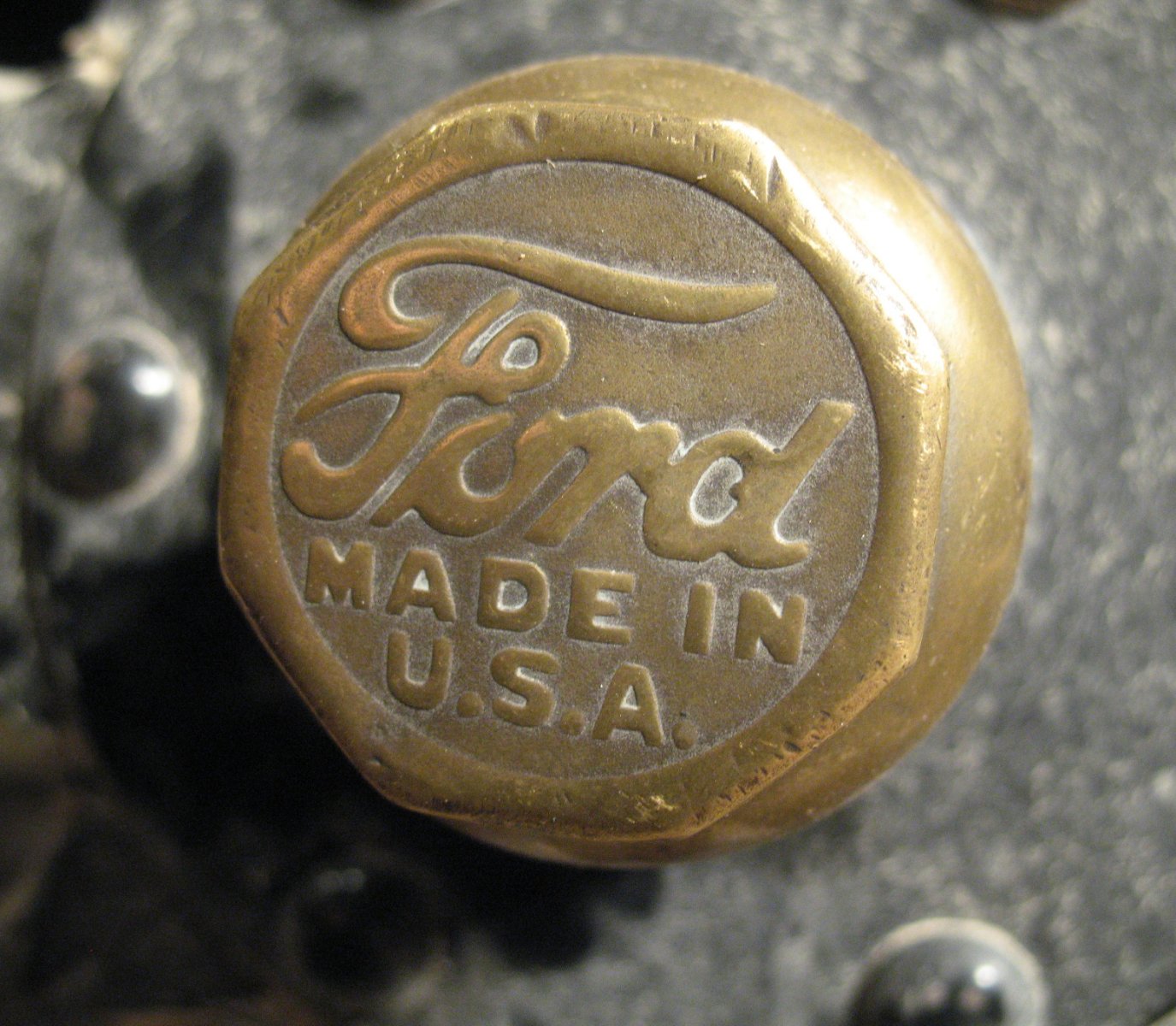

I am surprised Larry Smith did not comment on the "high F" hubcap. As I understand it, the high "F" hubcap was a one year only about 1913, and they are difficult to find in good condition. The '14/'15/'16 brass hubcaps are very similar to the later ones, with a slight difference in the outer edge of the outer end. The rim edge for the brass era caps is slightly thinner if I recall correctly, similar to the "high F" cap. Later caps have a slightly thicker rim edge. Sorry, I do not have any photos I can post that would help.

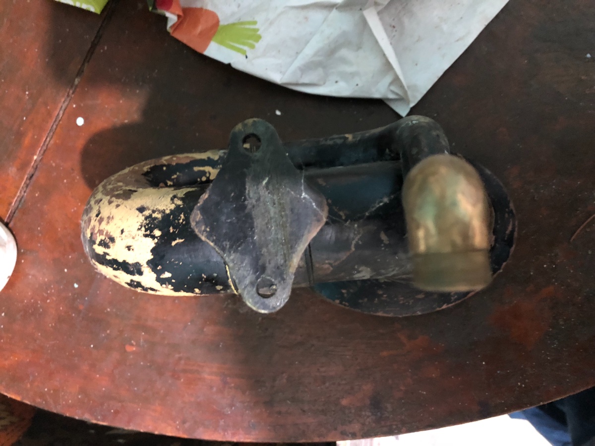

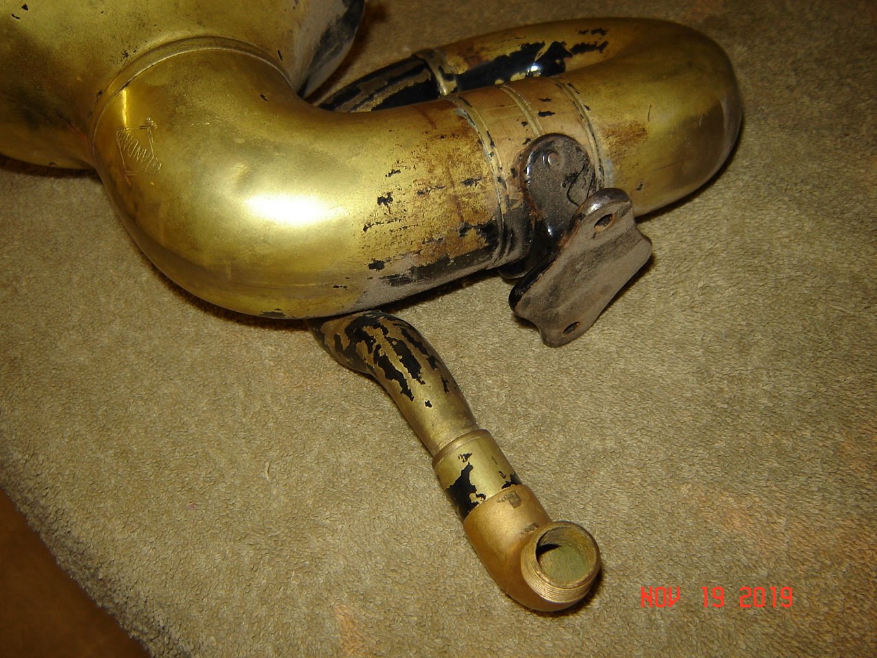

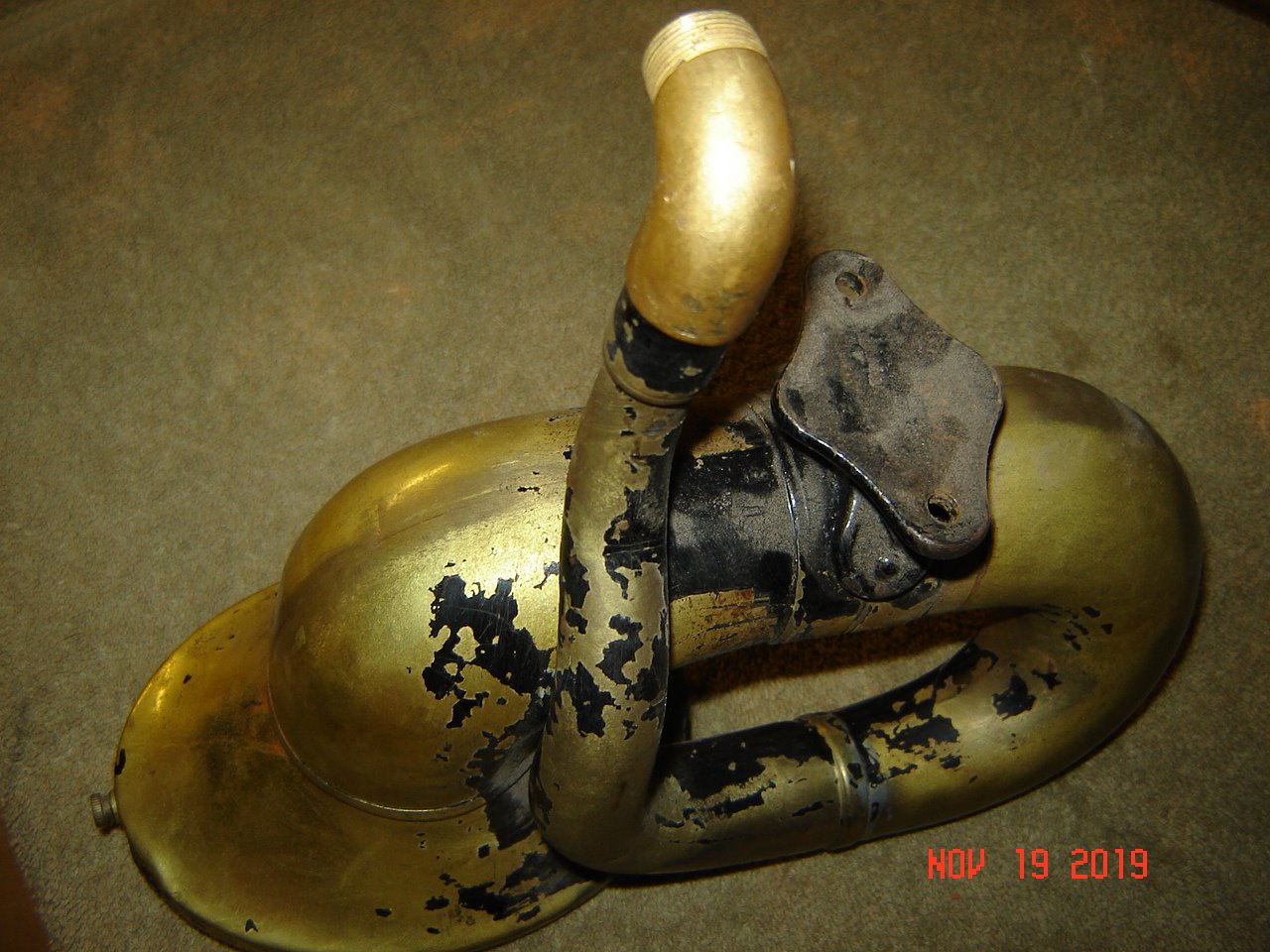

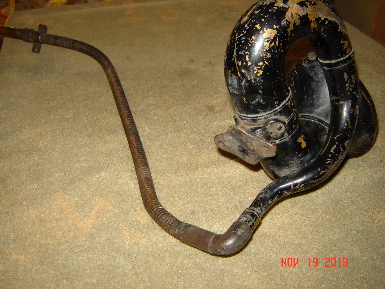

Re: 1915 Parts

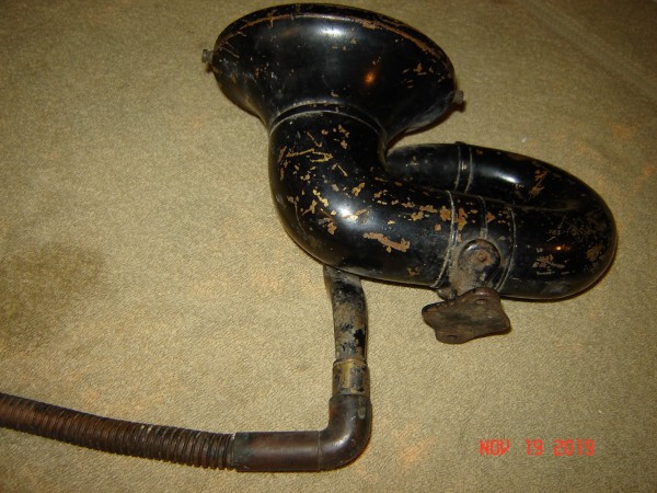

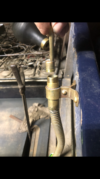

Here are some pictures. You can see the scalloped mounting bracket, also the 90 degree elbow that screws on instead of the straight tube used previously. The 1915 bracket is different than previous years as well. There is a brass tube not pictured that covers the reed and holds the bulb.

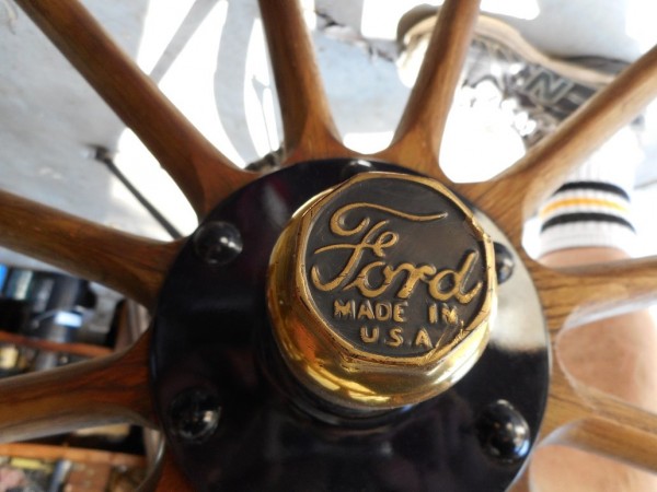

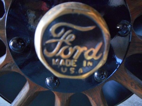

There are two styles of high F hubcaps. 1913, and 1914-17. The 1917's are nickel plated. The 1913 hub cap is very much like the 1914 style, but the F is much larger and bolder. It takes some practice to get used to the two styles.

I believe the "Rip Van Winkle" 17 has the tall F hubcaps. Hopefully someone has a photo they can post. My 14 has them.

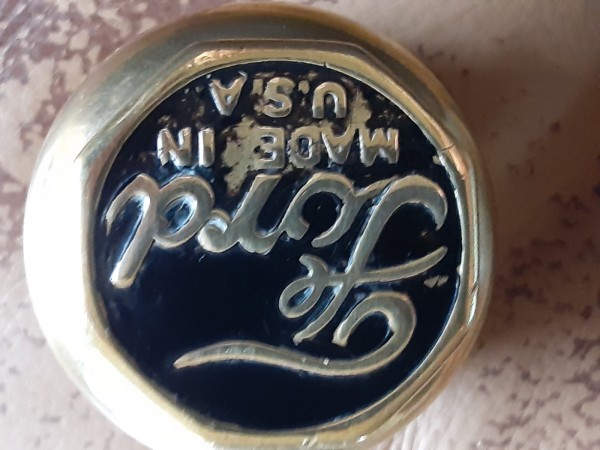

I might have one correct high F hub cap if someone could look and say yea or nay. I think Larry saw my car in Mill Valley and he said something about the hub caps being different. I've been looking for the correct high F caps to buy but they don't seem to be available, so.
I went to a trophy shop and asked if they could laser engrave the hub cap lettering on a flat cap. They said yes. My next stop will be at a weld shop to see if they can fill in low F hub caps with brass and I can flatten the tops then back to the engraver. However, the hub cap metal is very thin so I suspect it will warp when brazed and this idea will fail. Likewise, I have no idea what the cost of engraving or brazing might be.
Another option. There is supposedly a sheet metal shop in El Monte that makes the EJ 9 brass tail light top for a 15 car. If enough people were interested in high F hub caps maybe the shop could be located and the owner might make a few.

Those hubcaps are easy to get confused on, especially the difference between a true '13 and '14. Keep in mind, Ford had different suppliers for those. The depth of the octagon can be different. I probably have more 1913 hubcaps than anyone, and there are differences among them. For anyone interested, the "F" in the script is much bolder than the '14-'16 caps. The '16 style was carried over into '17, as I have nickel plated examples of those too. The easiest way to tell is to put a '13 hubcap next to a '14, and the difference will be apparent. I have the '14 style hubcaps on my 1915, but don't have any photos of them.
