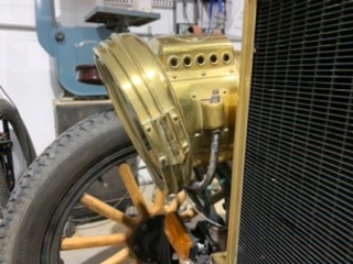

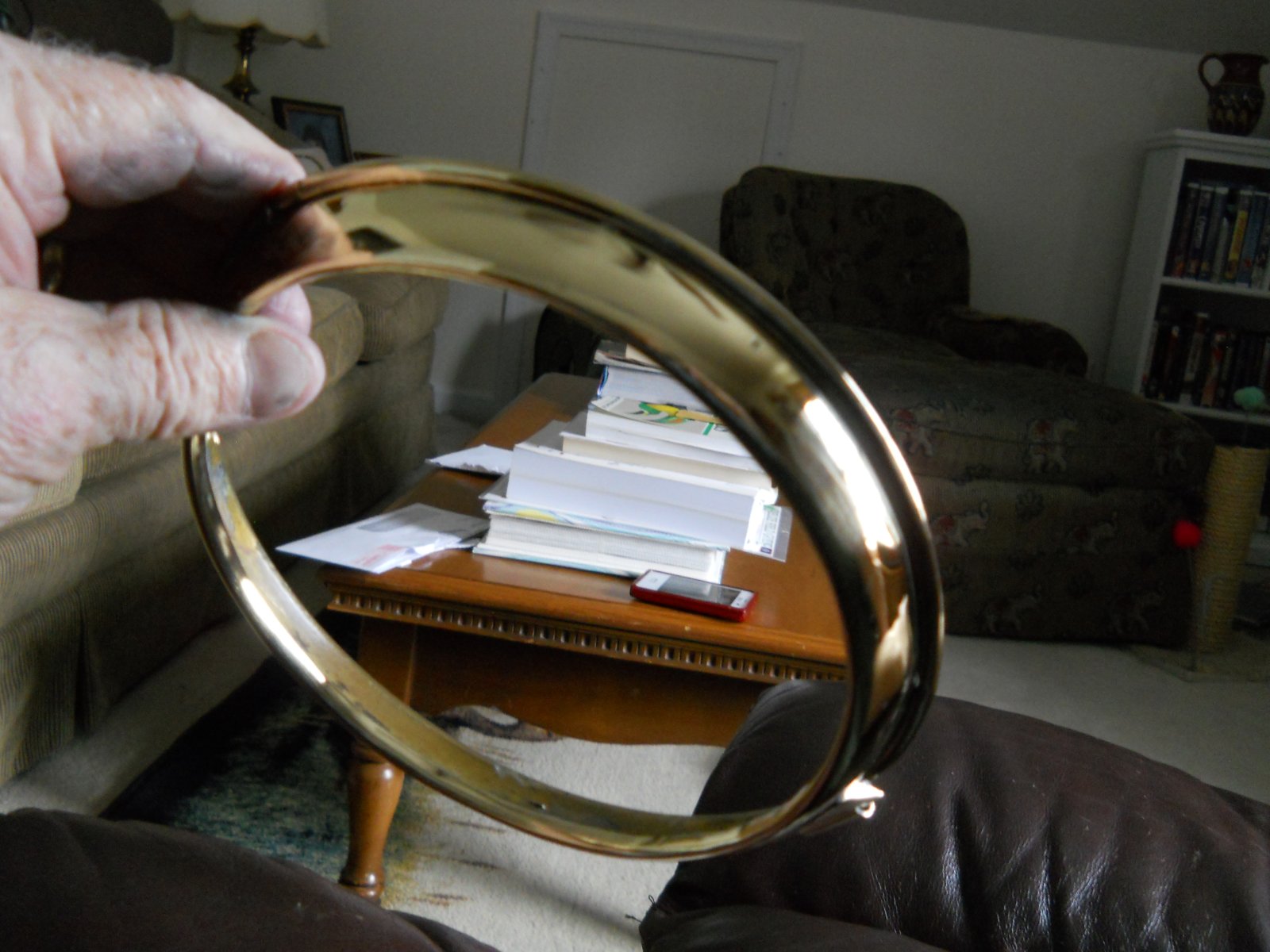

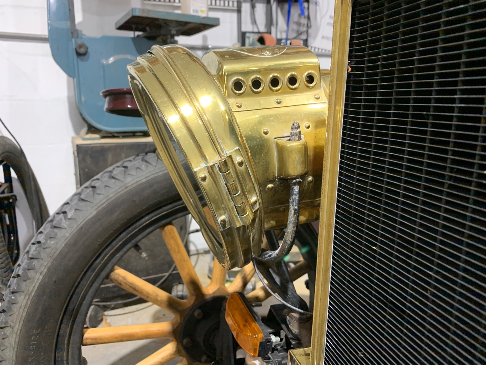

I have a pair if E&J 466 brass headlights which need to have the barrel straightened. Who is capable of making such a repair? I am located in the Tampa area. I tried to post a photo, no luck.The opening against which the lens door closes is bent back at the bottom so the lens door is tilted downward.

I see the photos posted. Both lamps have the same damage.

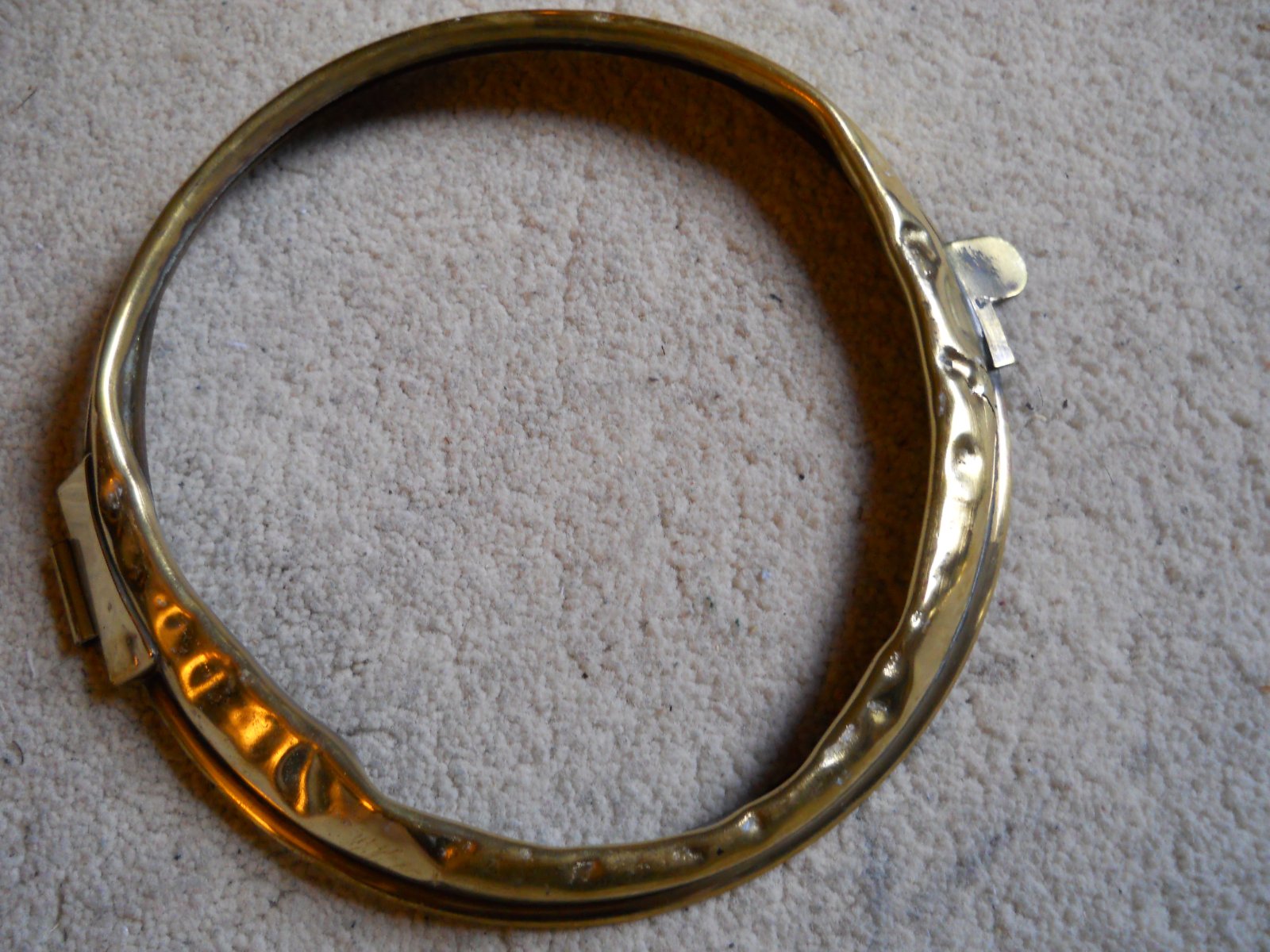

Is the brass split at the bent area? Annealing the brass will soften it to where it can be worked. Old brass is difficult to deal with as it tends to crack with age. Extreme care must be taken around solder joints. I dropped a lamp and ran over it, crushing the lamp door. By annealing it I was able to hammer and peck until it looked okay. By sanding the peck bumps with progressively finer sandpaper and then polishing with blue magic. It came out okay for my purposes.

Steve, the best solution is to have a pro do the work. New flares would be most satisfactory. If you want to have a go first, you may be able to save some cash.
I would use a press to get things back in shape before working on any dents. The damaged section of the flare needs to be supported from behind, perhaps by a thick half circle piece of MDF and pressure slowly applied to a block of similar material to the junction of the flare and light body. A press allows gradual pressure to be applied, and you can even take things past where they need to be, so they can relax back into place. There is every chance that the solder joint between the flare and the body will be cracked, but that is likely whatever method is used. There is likely no need to remove the door from the flare, but if necessary, the pins should be driven from the hinge so there is no need to drill out the brass rivets.
In all of this, a second pair of hands would be a big help, either to hold the lamp or work the press.
Light hammer/picking work can be used to work dents out. Again, a wooden drift shaped as needs be, can be used to drive out the dents in the rim without leaving multiple hammer marks. Save those for fine work in sharp corners once things are back in shape.
Your lights look deformed rather than dented. Pushing them back into shape before resorting to hammer work is likely to simplify the task.
