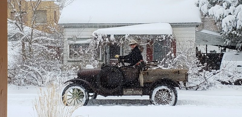

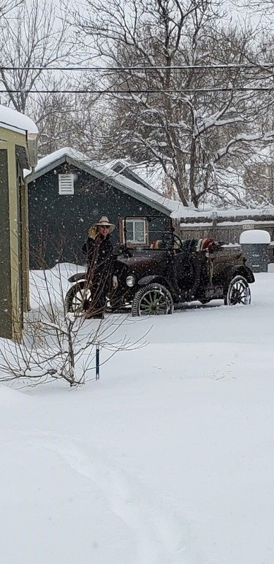

Ok so in Colorado we are getting a bit of snow so I thought I would take the T out for a spin today. It did really well despite not having chains which I now want. Anybody have a set for the 30" x 3.5"? This was my first time in this kind of snow, fun for sure. This will go on the front page of calendar for sure. 13" and still snowing.

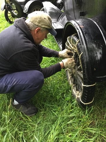

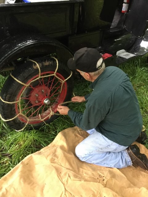

Some fellas use rope for traction

Rich, while we’re waiting, please hold forth on using rope. I know you’ve done it, I’ve always wanted to !
From old pictures, I’d guess the old timers used 5/8 or heavier. The rope in the pic Perry posted (more alliteration 😜) looks too light to me to be much use.
‘Nother thought (? Question?) seems to me hemp or sisal would be far preferable to synthetic fiber rope for the same reason it’s best for pack hitches on horses or mules. It doesn’t stretch as much and will stay put.

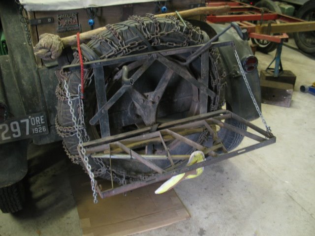

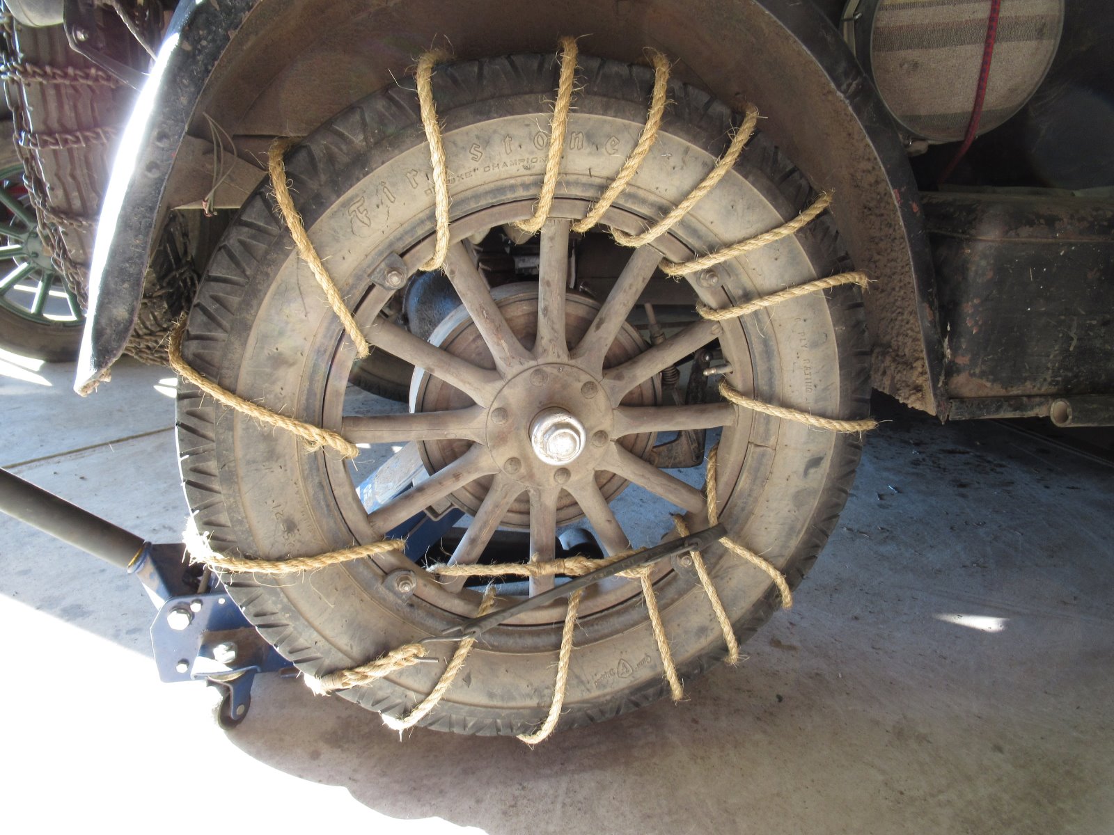

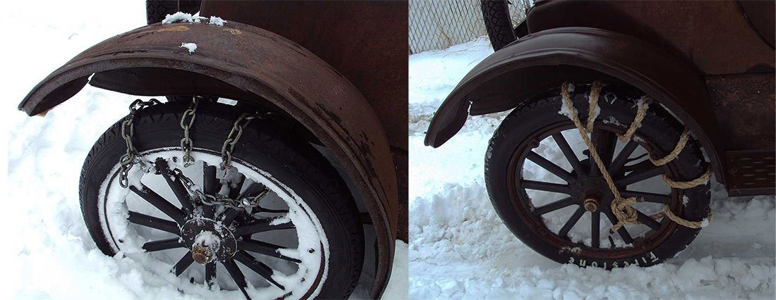

I use 1/2 in rope for sand (5/8 is hard to get tight) and chains for snow, chain grip a lot better in the snow. Either way it is always fun.

Yes, the bigger the better (rope). Here is what I have used to get out of the yard to plowed or traveled roads. If you are on a budget you don't have to go all around the tire. This also keeps from dragging down the momentum of the RPM. The chains or rope will wear down if you get on pavement. I like sisal and believe that is what I bought. The chains tear up fenders when they come loose. The sisal can get wound tightly around the brake drum.

“The rope in the pic Perry posted (more alliteration 😜) looks too light to me to be much use.”
You’re wrong. The rope performed incredibly. We couldn’t get up a muddy steep hill after a night of rain on one of our T camp outs. The T’s went up the hill like tractors after putting those ropes on our tires. That size rope is easier to store under the seat when needed for an emergency.

In Dennis' pic the rope may pull against the valve stem. I always avoid threading a rope 'chain' thru that spoke opening, fwiw, jb

Nothing new there Kenny. I’m ALWAYS wrong. :lol:
Glad to hear it worked well. It sure would be handier than heavier rope !
