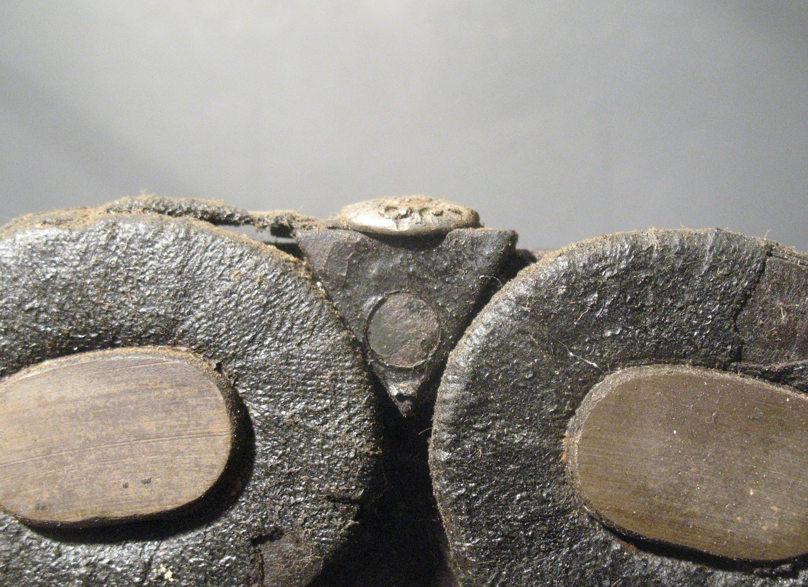

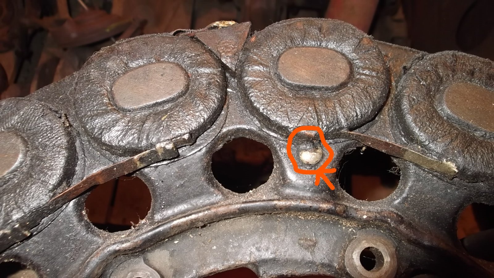

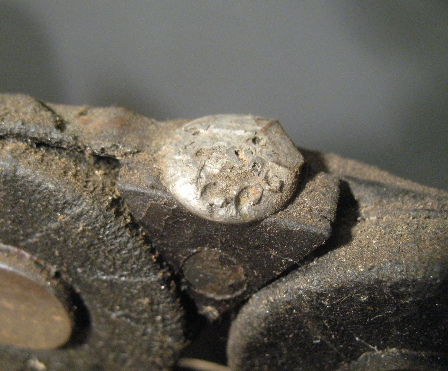

This same, or a very similar, issue surfaced about 8 years ago on the Forum. Turned out that the screw holding the contact button in place was a hair too long. When it got hot, it would expand and touch the iron rivet holding the contact block to the frame, which shorted the whole works. Even though that was the only known case, we immediately switched to shorter screws in all our mags, which still held extremely well in the hard thermoplastic that we make the blocks from.

- Posts: 7351
Re: Magneto issue
Here's what R.V is describing.
At the top of the mag ring is this contact. The pointed, spring loaded shaft from the mag post pokes into the contact button (solder blob). Note the little indentations made by the mag posts that have been used with this ring. Coming from the left you see the copper strip that comes from the nearest coil. A small screw attaches the copper strip to the triangular insulator and the contact button is on top of the screw. If the screw is too long it can contact the rivet you see holding the insulator. When that happens most of the current generated by the magneto goes to ground instead of to the mag post.
