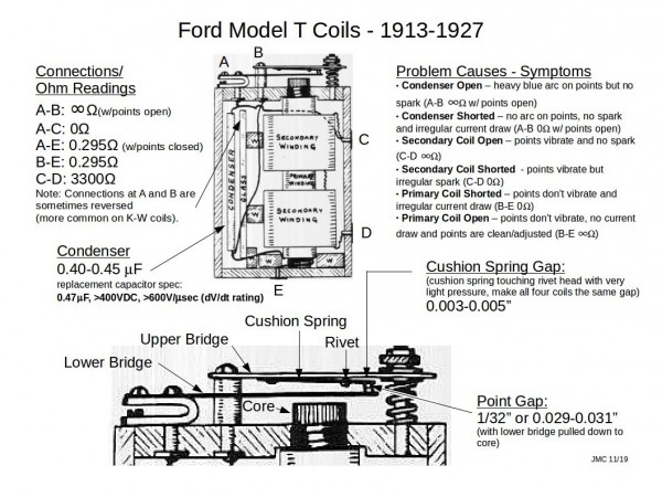

- Posts: 5370
Re: coil point arc
http://www.mtfca.com/discus/messages/33 ... 1364507902
Ignore the spring cushion gap and stick with Fords recommendation.

Re: coil point arc
thanks for the coil diagram as I will check the points gap and inspect them from pitting.
Rebuilding a coil is out of the question due to fumes.
The wiring is correct on the ignition switch.
I will keep you informed of the coils.
