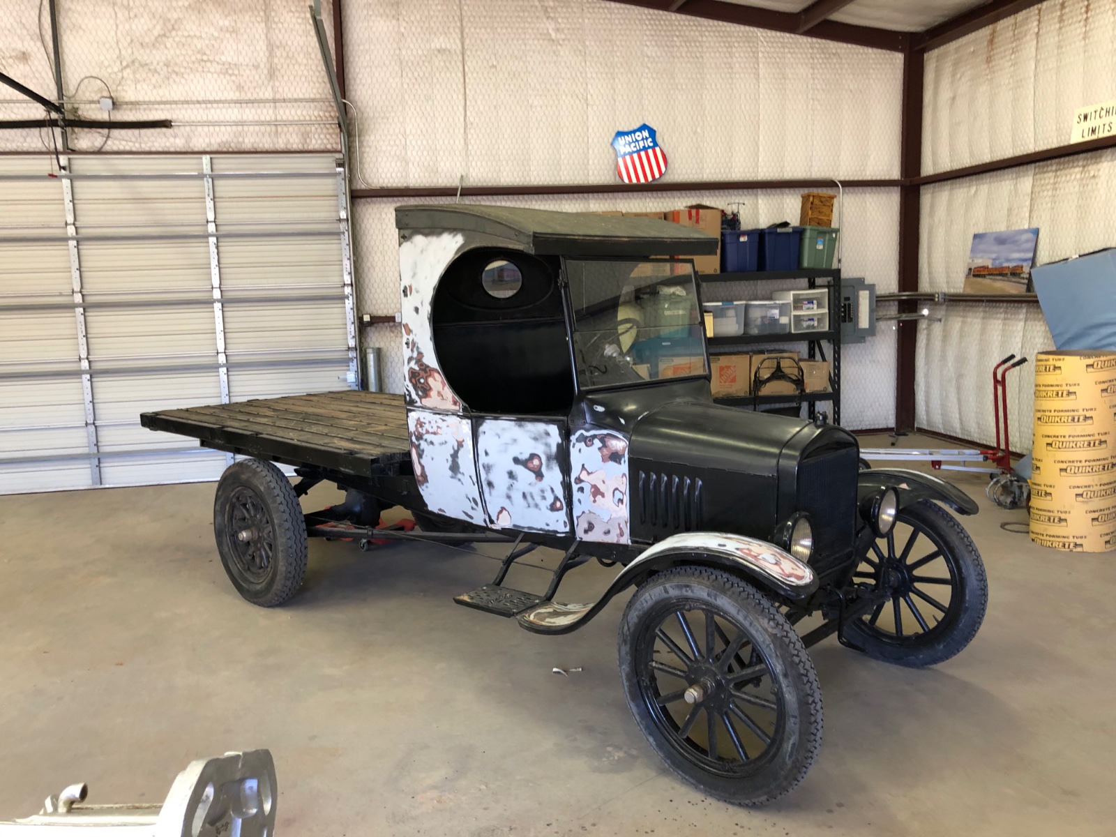

As to what the truck needed, it barely ran when I got it and had been sitting for many years. The body work was showing its signs of age on a poorly done 1970’s restoration and basically had to be taken to bare metal. A rewire job, engine and radiator flush, and lots of body work. The engine sounds good now for the most part but have not had the head off so I may just be hoping against hope that it won’t need as much work as the rest of the truck has.

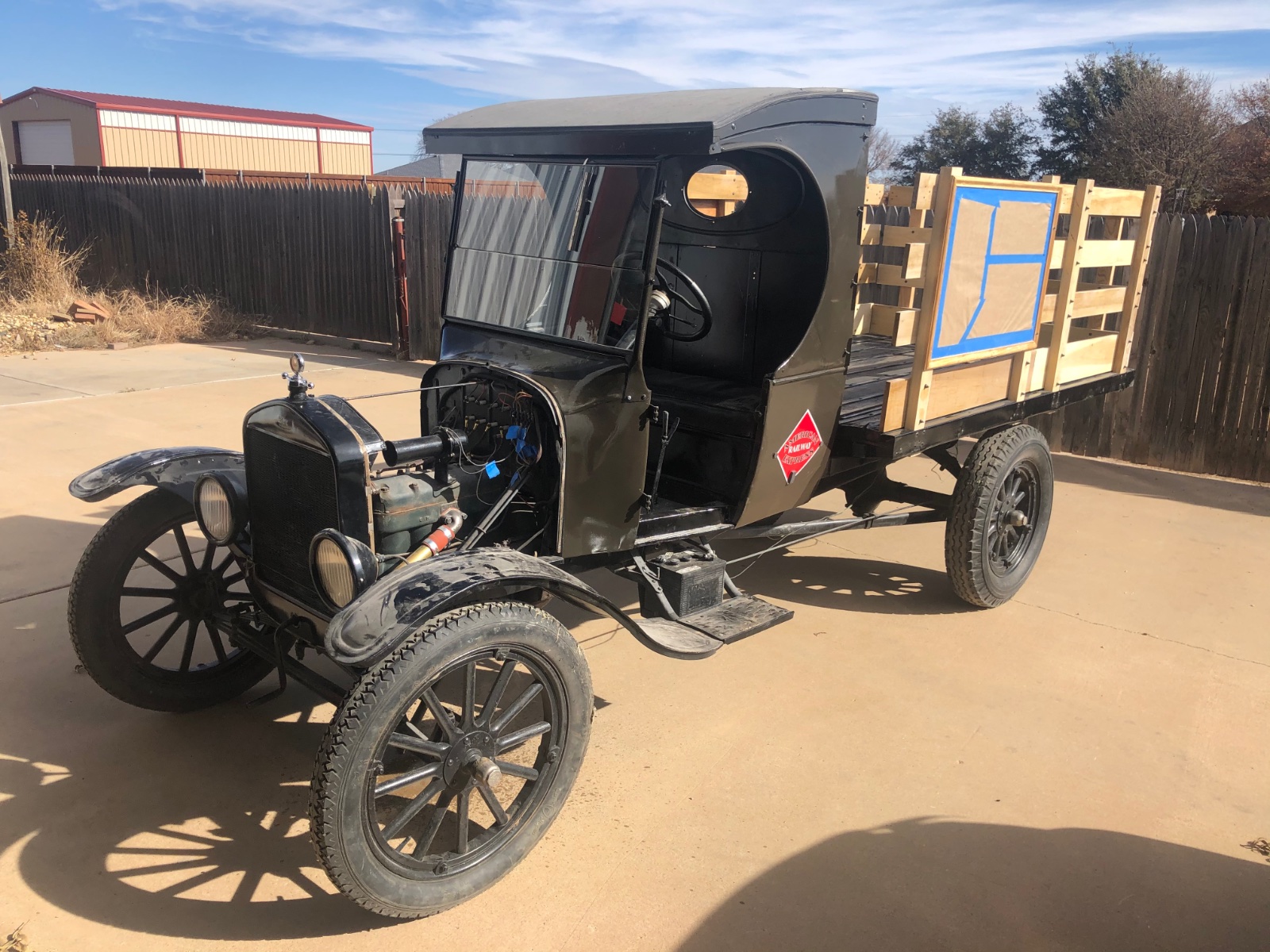

I bought my first house in Lubbock back in ‘77 at 2201 28th St. Also bought a TT Enclosed Cab stakebed up in Plainview. There was a young fellow named Paul Ray Martin that restored a ‘26 T touring on a large cotton farm out of Slaton. You have a really nice looking C Cab there. Even has the correct C Cab upper windshield. Those 8 stakes for the bed are super hard to find. Someone will undoubtedly chime in and inform us they’re available from Lang’s @ $50 each. Do you have an accessory transmission behind the T tranny? If so you won’t have any service brakes if you get it in neutral. Very dangerous !! Whatever you need, just sound off on this Forum. There’s “experts” available 24/7... I’m only an 8-9 hour drive SE of you...

George-I actually found the Ford design steel stakes on Macs in the Model AA truck area. Based on my research, this part was common between AA and TT’s. They are only 39” tall which was shorter than I wanted for the look I was shooting for as American Railway Express delivery truck. I do not have an auxiliary transmission and it only has a standard rear end and brakes. I may install higher speed rear end gears later if I can find them. I did buy a set of repo Rocky Mtn brakes when they did a run of TT brakes earlier this year but have not installed yet. As I have learned, these vehicles are for tinkers so I may never be finished but want to get it presentable and drive-able first.
