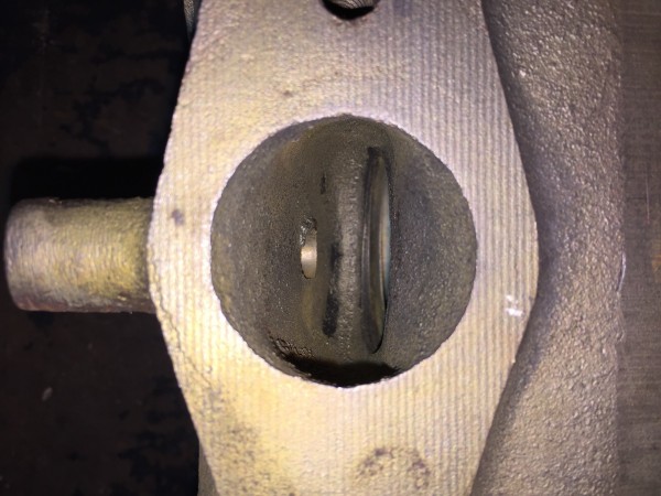

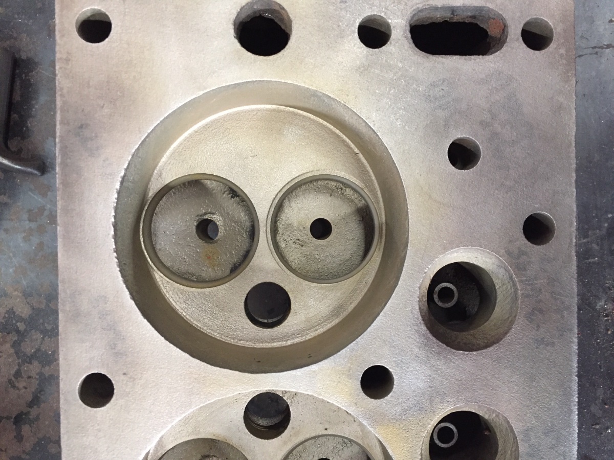

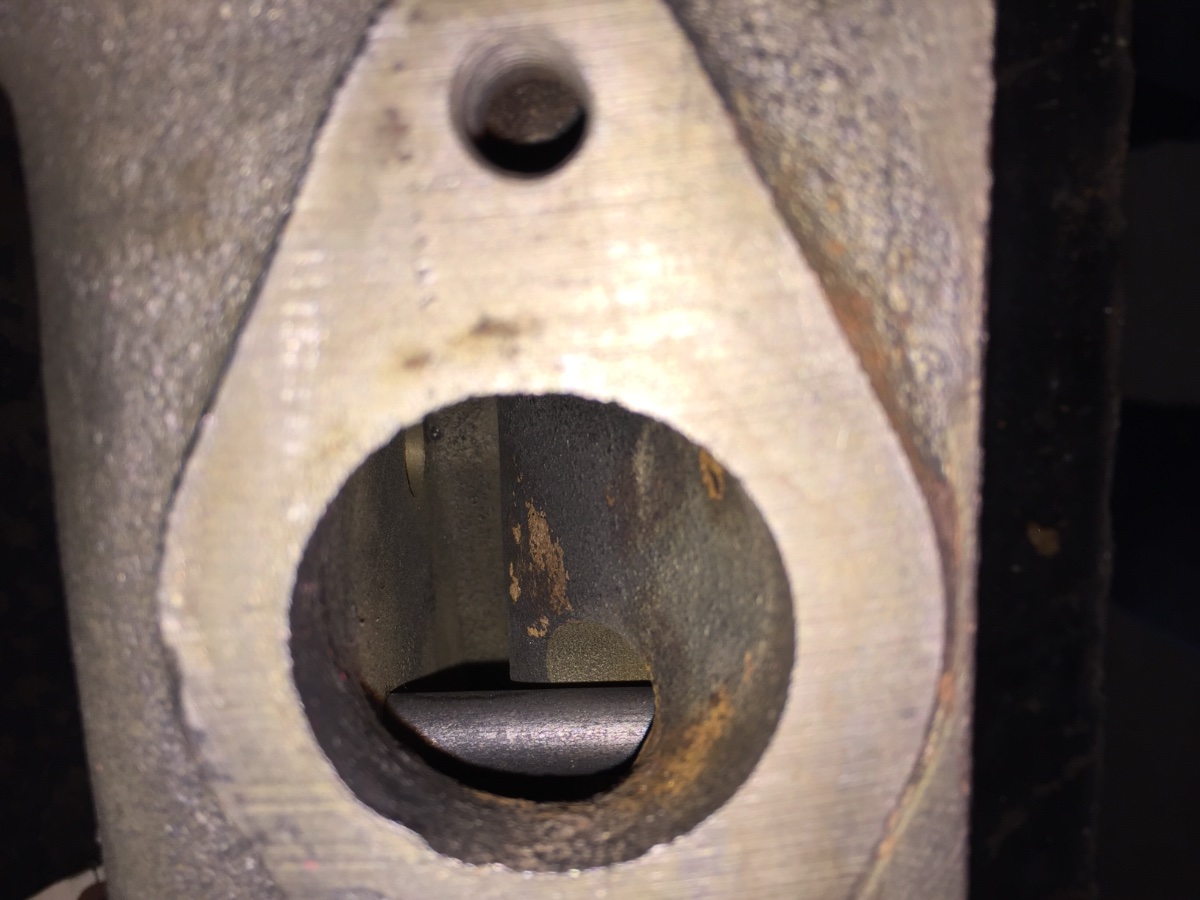

Here is a couple pics of the port layout for the Akron OHV head. While I’m not too excited about the ports being squished flat, I believe this head will flow enough air to improve upon my slightly ;) modified flat head

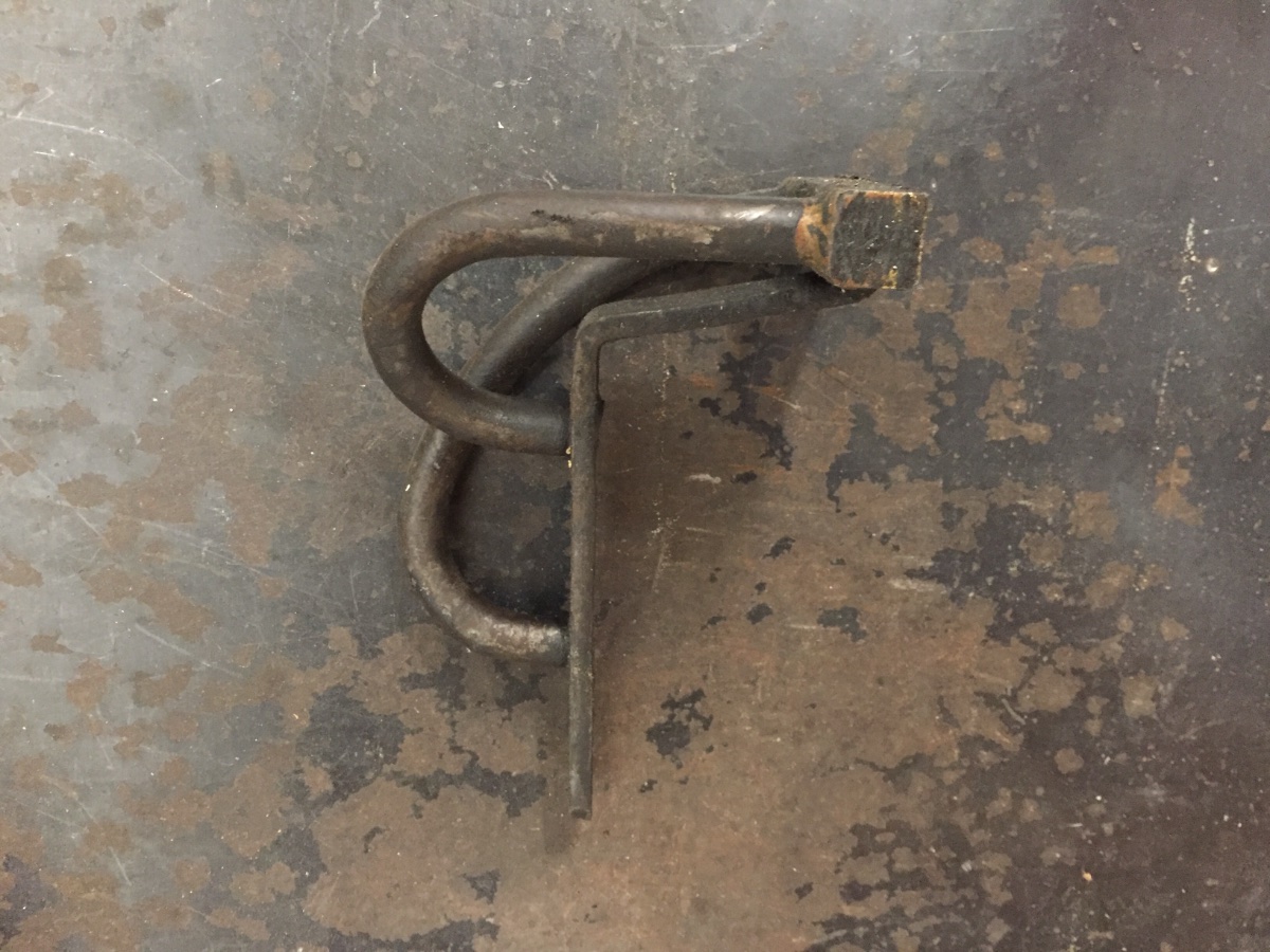

While I do have the correct exhaust manifold, this head came with 2 die cut steel straps to clamp an intake manifold to the head. It had a NH and stock T intake manifold clamped to it when found. The head in Speedy Bills collection is displayed in similar fashion

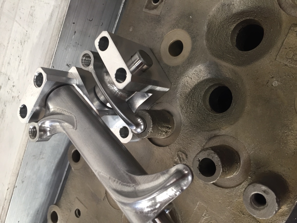

Post by Kevin Pharis » Mon Dec 09, 2019 10:35 pm

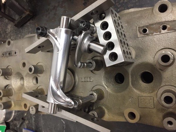

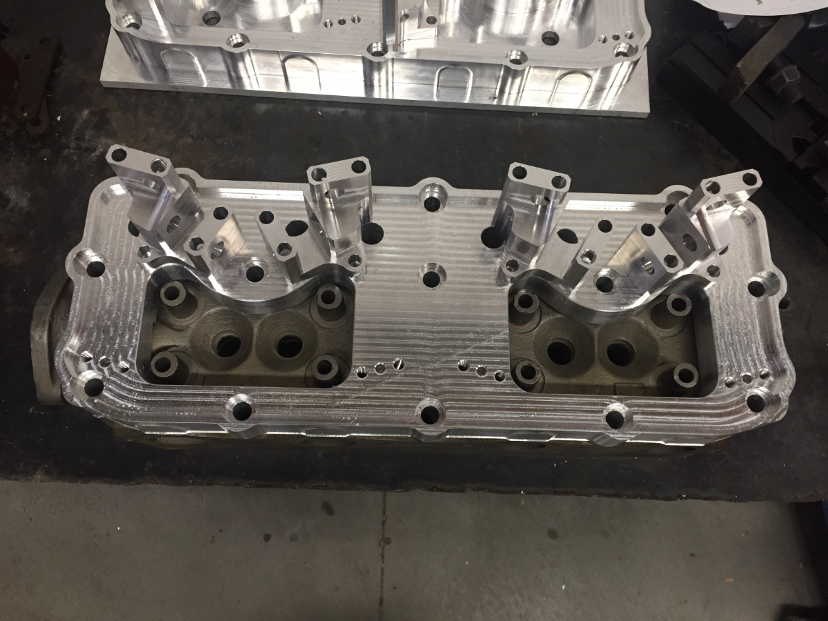

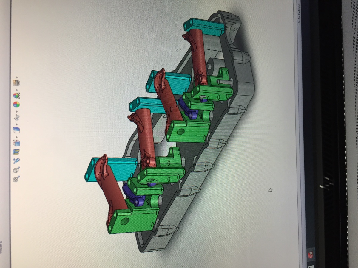

Here we have step 1 of the intake rocker done... now to cut the center bushing bore and cut off the handle
Akron intake rocker
Akron intake rocker

I'd love to see the flow characteristics on the "squished" ports... I wonder if it was an attempt to get a flat dispersal of the combustable mixture to improve burning characteristics?
AndyClary
Posts: 902
First Name: Andrew
Last Name: Clary
Location: Usa
Re: Obscure speedster trivia...?
Post by AndyClary » Tue Dec 10, 2019 3:48 pm
I suspect they were more interested in fitting the car without modifying the firewall.

No doubt this was the major motivation for keeping the profile low.
But if they had made a higher compression version... the ports could have been less squished. Or if they had gone the route of the “A” RAJO (4 valve), with its raised bumps to make room for the intake ports.
Either way... all the early heads suffer from oversized ports and poor airflow characteristics anyway... maybe a lil bit of port velocity will do some good...?

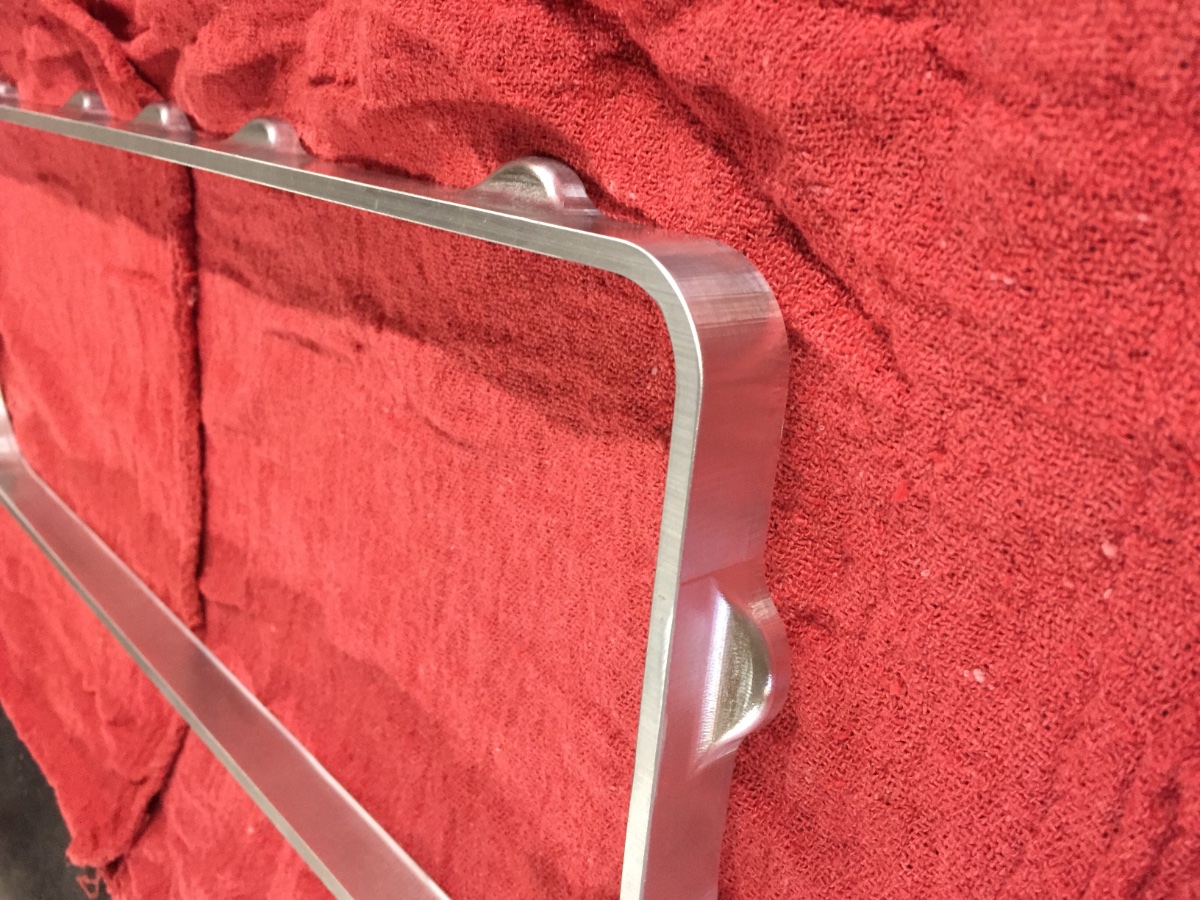

Post by Kevin Pharis » Tue Dec 24, 2019 7:52 pm

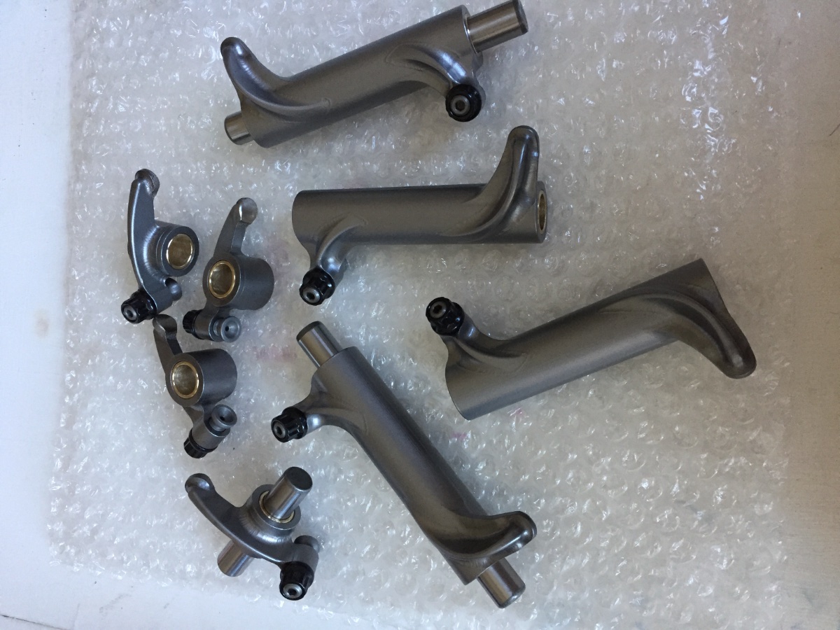

Finished an early Christmas present for myself this morning. The first of many steps...

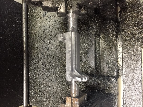

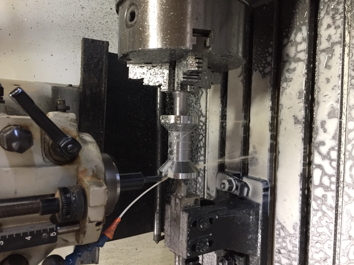

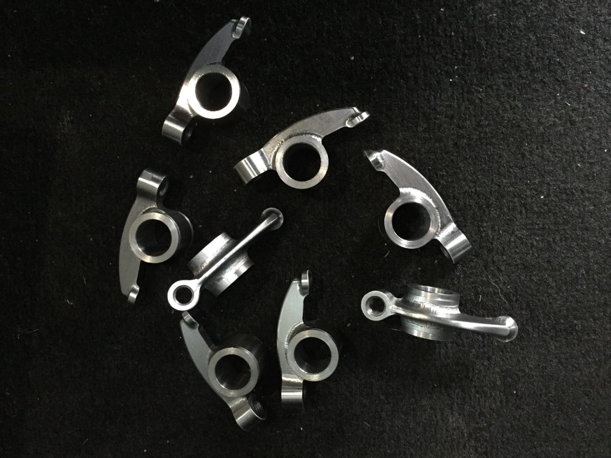

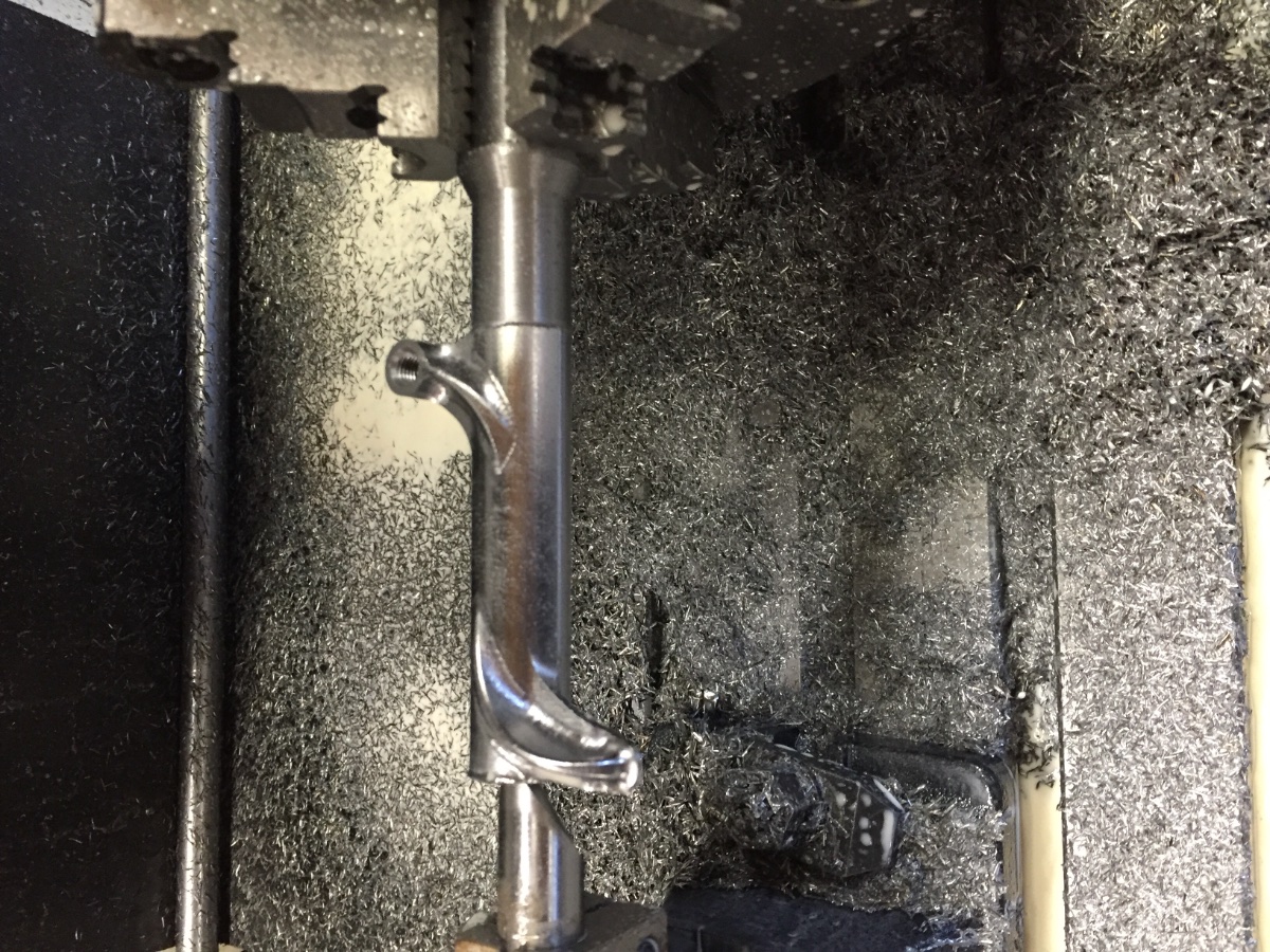

Step two... exhaust rockers!
Start with a big chunk of round bar, then make it a little bit smaller in the lathe
Then off to the mill to start sneaking up on it
Just can’t be afraid to make a little mess 😉

Fortunately Kevin, unlike the rest of us, thinks in the 4th axis. I'm working my way through two.
Andy

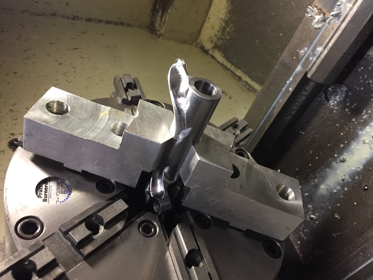

Now back to the lathe for the last bit of work

Kebin, what material are you using and will it require heat treatment?
Andy

AndyClary wrote:
Fri Dec 27, 2019 12:52 am
Andy
Just so happen to have about 15’ of 3” diameter 4130 normalized steel bar laying around... so what better material to use?! 😉
The plan is to use stock T valve springs, so there won’t be much load on the rockers. I figure they’ll be OK as is... but am considering flame hardening the tips to prevent wear at the valve stems. Others may have a more scientific opinion... but I don’t feel there’s a need to overthink this one

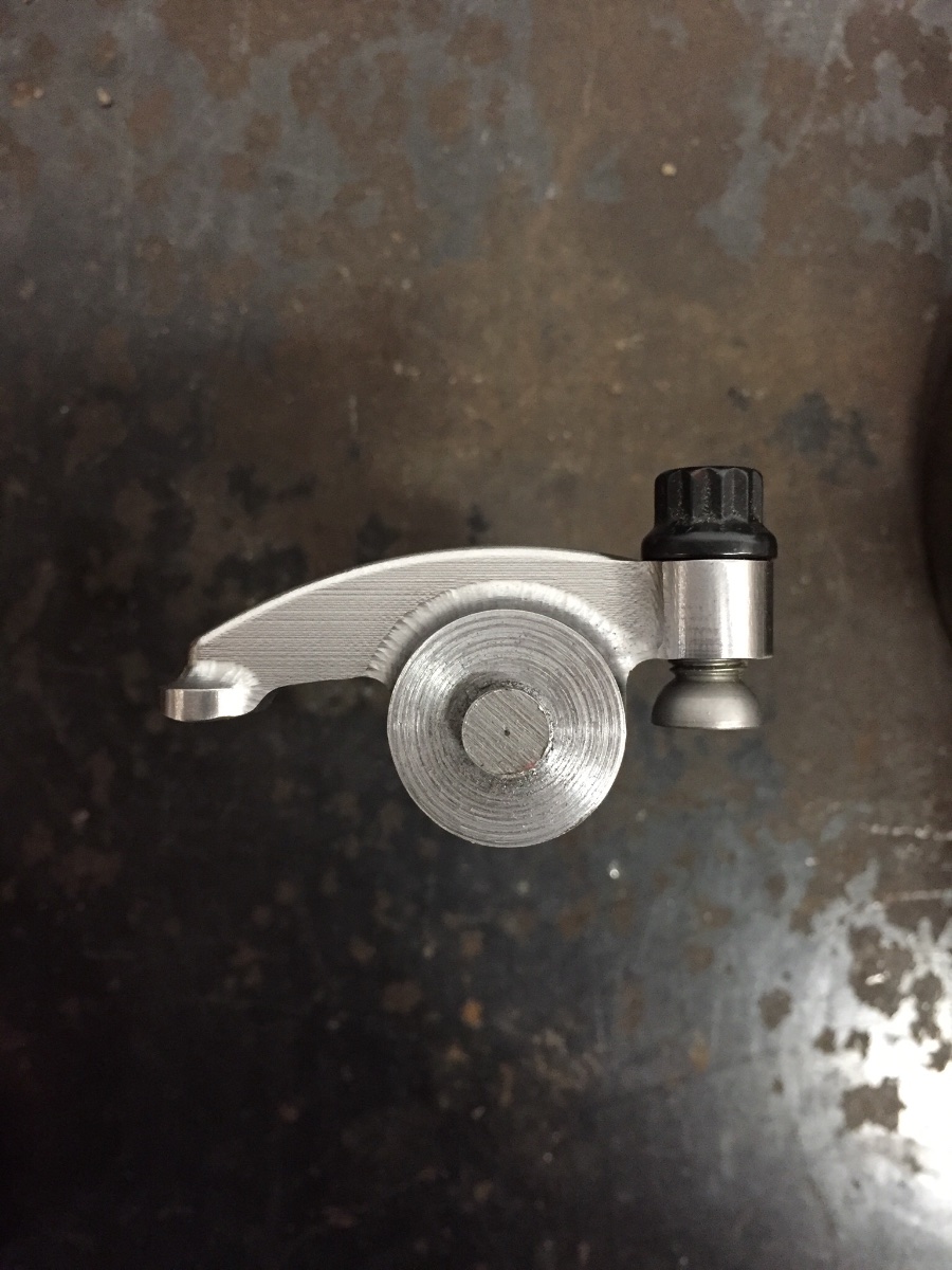

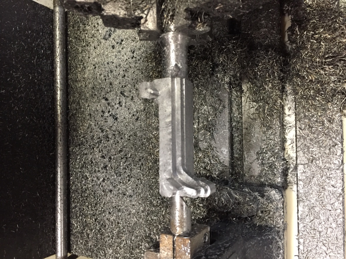

Post by Kevin Pharis » Fri Dec 27, 2019 7:24 pm
After 4 hours in the mill, time to make some room for the bushings... :D

Very Very Nice Work Kevin, Thank You for sharing. Some can not understand what it really takes to make these parts, time, equipment, and knowledge.

I do have to admit that a more modern mill could have done the same work in half the time or less... but that requires the one thing that didn’t make your list... MONEY!!! ;)

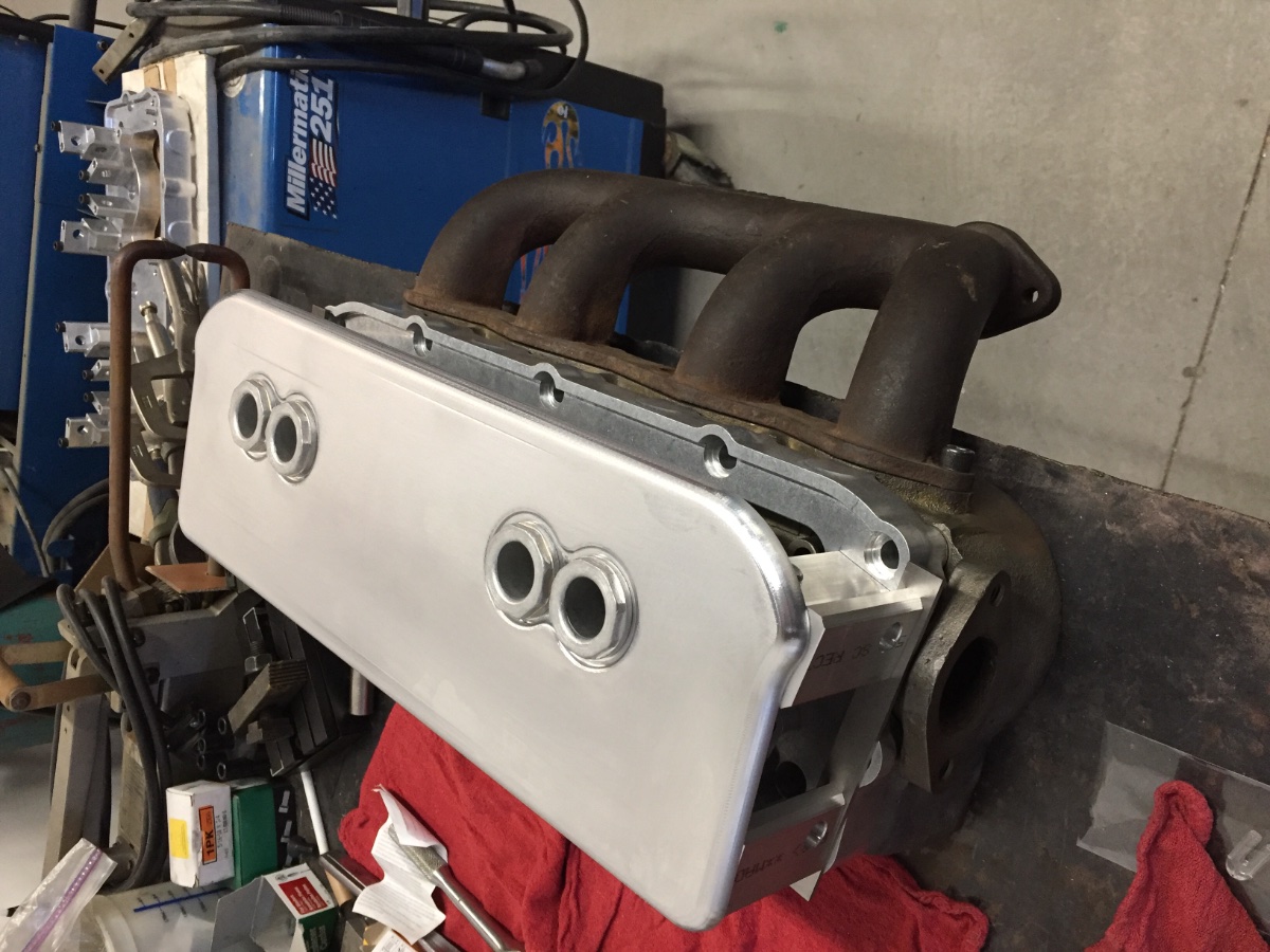

Post by Kevin Pharis » Sat Dec 28, 2019 12:29 am

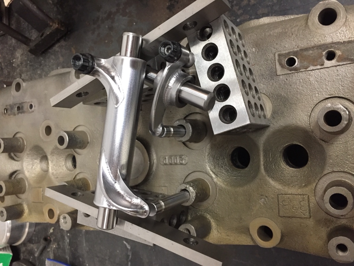

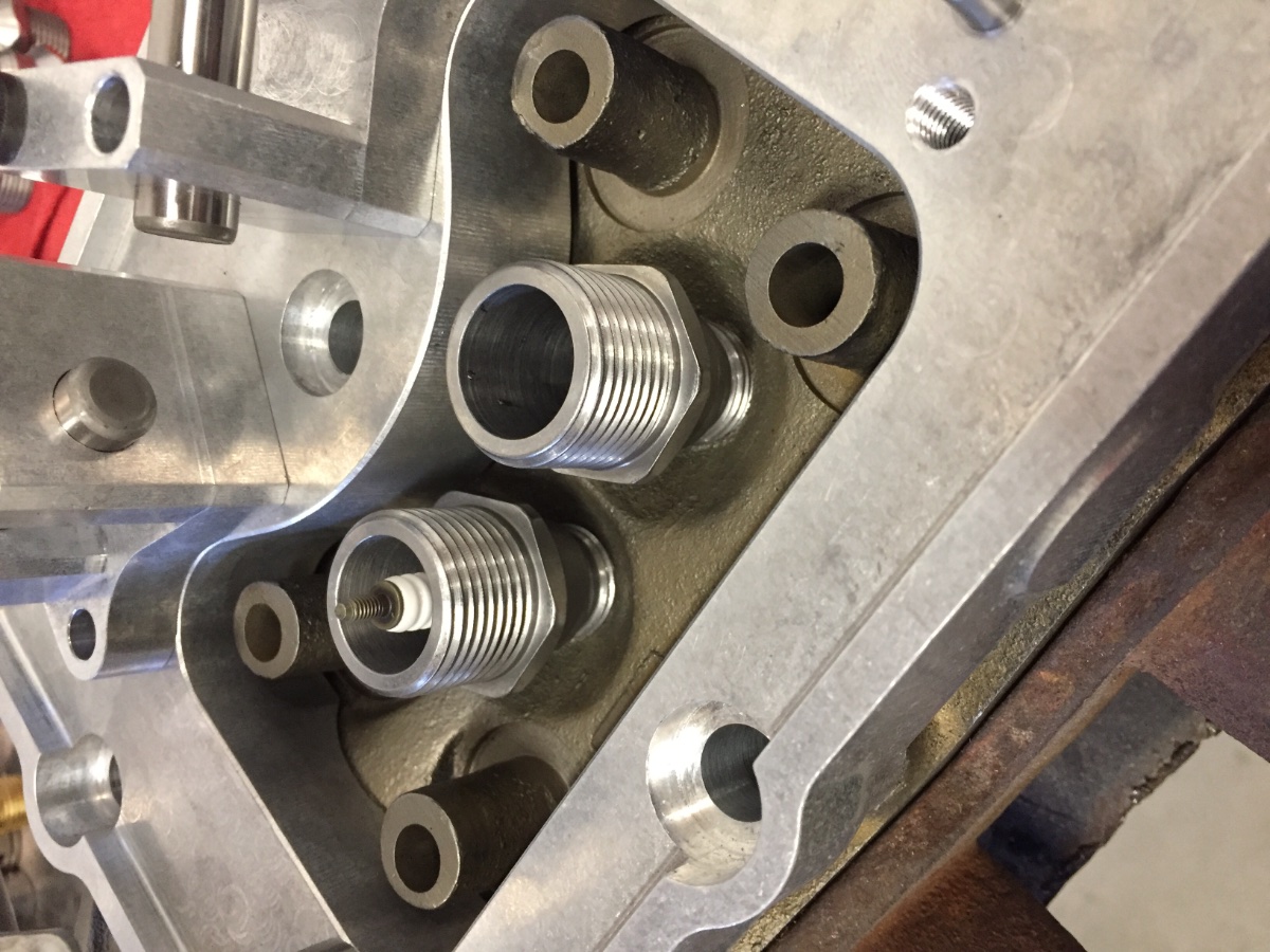

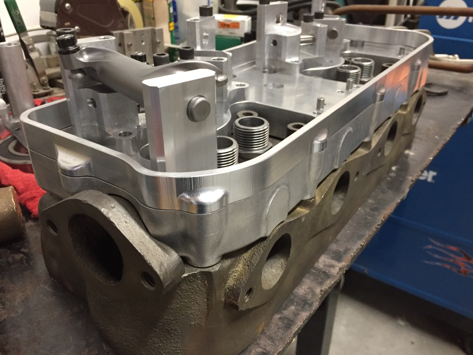

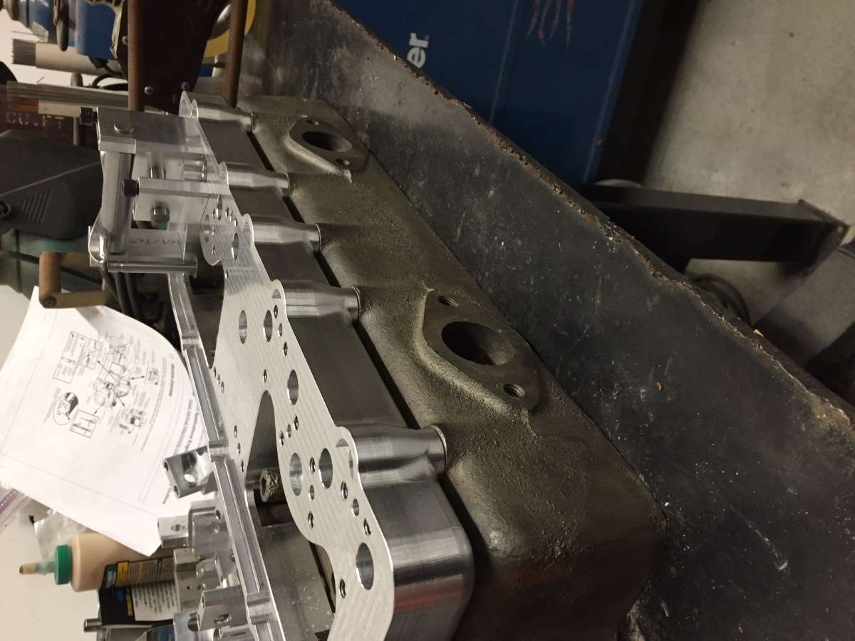

Am far enough along now to mock up the first sanity check...
Then got to thinkin... sanity’s got nothin to do with this project!!!🤪

Wow...Nice engineering on the rockers.

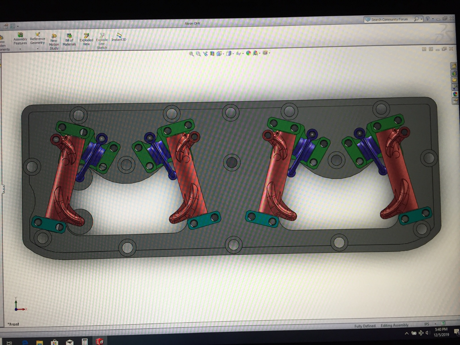

Which car program ate you using and does it give you a mirror image for the even number cylinders?
Andy
Kevin Pharis
Posts: 1645
First Name: Kevin
Last Name: Pharis
Location: Sacramento CA
Post by Kevin Pharis » Sat Dec 28, 2019 5:08 pm
AndyClary wrote:
Sat Dec 28, 2019 2:50 pm
Andy
I have been designing in SolidWorks, and programming with FeatureCAM. I expect that all CAD/CAM softwares have the ability to mirror the design/model at the push of a button... but generating the machine code is a bit more complicated job. All CAM softwares I’ve ever used will force the recalculation of the toolpath after the model has been mirrored, translated, etc... This recalculation is rarely perfect, so I always give it a good look over. The good news... is that the setup and machining operations typically are not lost, and detailed review and edits are all that are required to get the “other side” programmed

Thanks Kevin. I'm going to give Fusion360 a try, they give classes at a local maker's space. They are more into 3d printing but I should get a handle on the CAD.

I’m just starting out with FeatureCAM... it’s my first experience with AutoDesk products. It’s been a bit of culture shock! I have looked over Fision360 some, and it is similar to FeatureCAM as they are both AutoDesk products... but COMPLETELY different workflows! Fusion360 is a somewhat conventional user interactive software, it should be a good fit for someone cutting their teeth in the CAD/CAM world... and it’s free too!

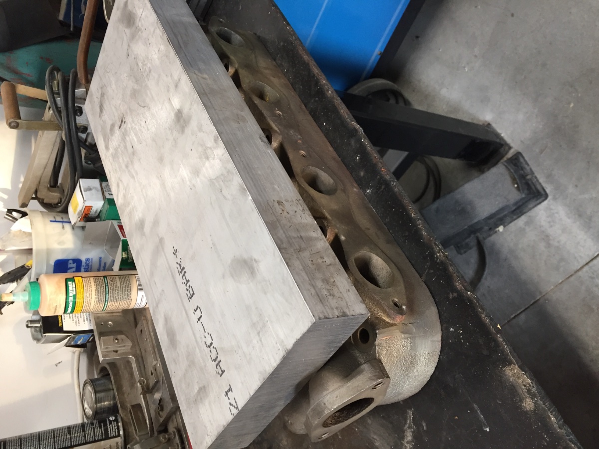

Do you have a 4x8x20 block to mill the valve cover?
Andy

Post by Kevin Pharis » Sat Jan 04, 2020 7:05 pm
AndyClary wrote:
Sat Jan 04, 2020 6:27 pm
Andy
Don’t be ridiculous!! :roll: Would only need to be 4x8x19!! :lol:

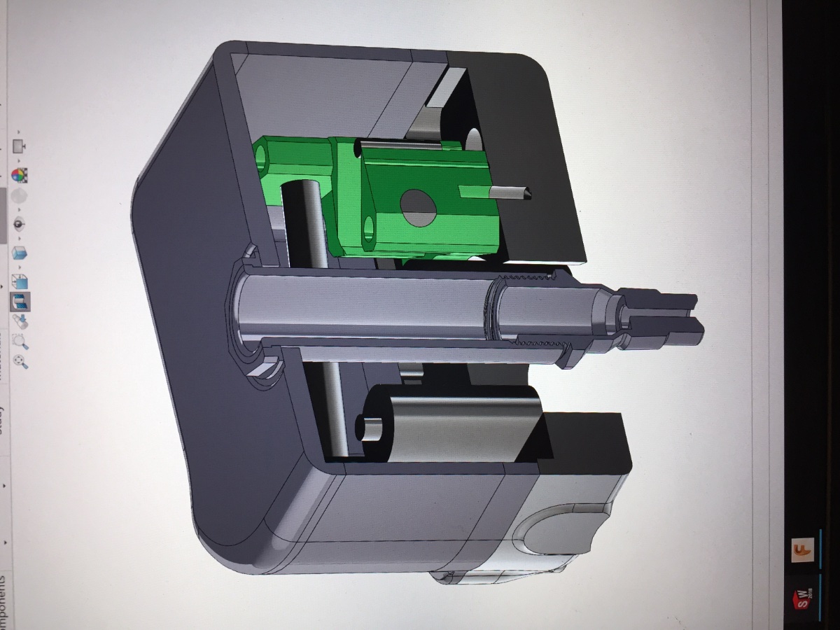

Actually, was thinking about milling the bottom edge out of 1/4” or 3/8” sheet, then forming a cover from aluminum sheet. Don’t really want a folded and welded street rod looking valve cover, but think I could form the sheet to give a better “drawn” look. I still have to work out the spark plug adapters too, as this cover will need to have “Hemi” style spark plug wire tubes.
Kevin Pharis
Posts: 1645
First Name: Kevin
Last Name: Pharis

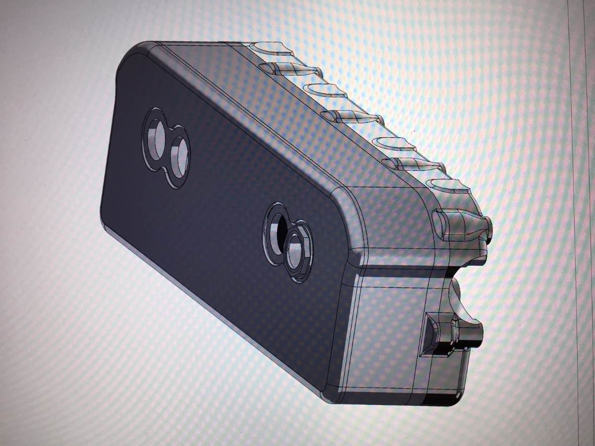

Post by Kevin Pharis » Sat Jan 04, 2020 7:21 pm
Here is a shot of the latest design revision to the adapter plate... was hoping to make the plate appear a bit less “billet” 😬
Kevin Pharis
Posts: 1645
First Name: Kevin
Last Name: Pharis
Post by Kevin Pharis » Sun Jan 05, 2020 8:31 pm
Another fit check... so far so good!👍

Post by Kevin Pharis » Fri Feb 14, 2020 10:44 pm

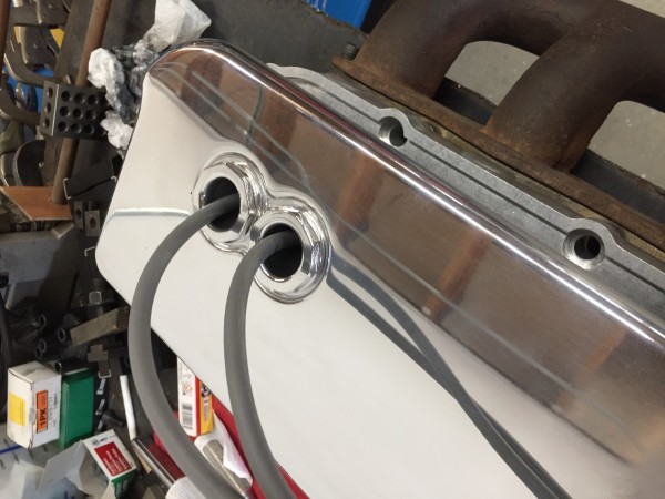

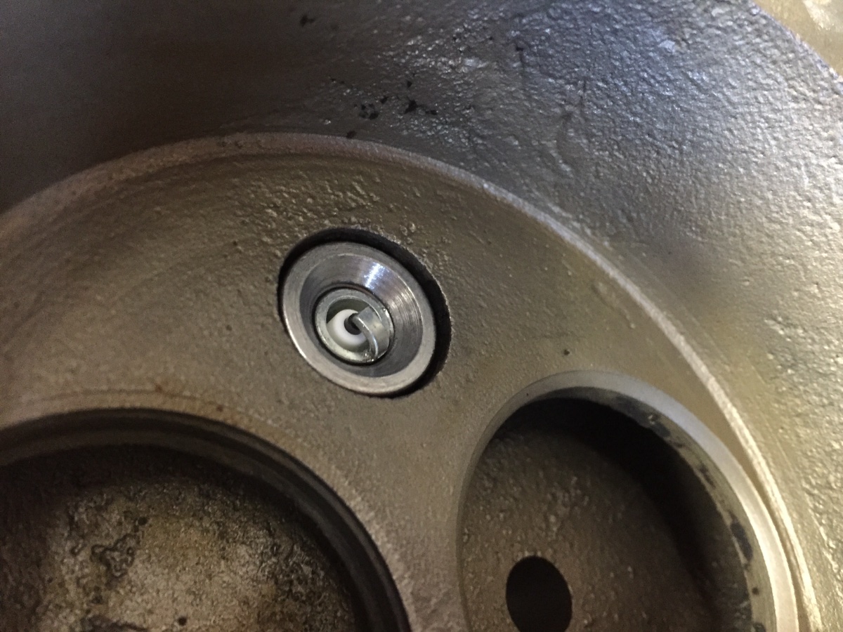

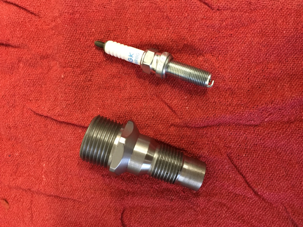

Been “plugging” away at the spark plug adapters. Found these 10mm thread spark plugs with over 1” of reach. Needed the long reach to be able to extend the electrode down into the combustion chamber, rather than being recessed up in a hole.
The extra threaded section is for a spark plug tube that reaches thru the top of the valve cover. The spark plug tubes also double as the valve cover hold downs
Shane Lach
Posts: 246
First Name: Shane
Last Name: Lach
Location: Milford, NH
Post by Shane Lach » Sat Feb 15, 2020 10:14 am
Nicely done! The spark plugs adapters you spoke to me about look great.

Post by Kevin Pharis » Sun Feb 23, 2020 4:57 pm
The top panel of the valve cover is done... is it starting to look like the picture yet??
The top panel has 1/8” of crown in it to combat the “billet” look. I should have made a vacuum plate to suck the cover down and prevent vibration during machining... but I didn’t! Oh well! So there a few grooves and gouges but once they are blended out and polished they will simply be waves in the finish and will actually help the cover look less “billet”
The valve cover will be a welded 3 piece assembly when finished. The top panel, a machined base ring to blend the top and bottom profiles, and the current plan is to bend a 2” wide strap to connect the 2 pieces. I considered a casting, but it would have been almost just as much effort to build the required pattern. All this effort to only yield 2 pieces... not worth it!

Post by AndyClary » Sun Feb 23, 2020 8:29 pm
I'm surprised it's not see through so the masses can appreciate your rocker arms.
Andy
Kevin Pharis
Posts: 1645
First Name: Kevin
Last Name: Pharis
Post by Kevin Pharis » Sun Feb 23, 2020 9:13 pm
I considered the see thru option at first... but got derailed once I realized how complex the wiper mechanism would need to be... :lol:

Post by Kevin Pharis » Sat Feb 29, 2020 12:45 pm
Back in town now... and found this waiting for me :D

Post by AndyClary » Sun Mar 01, 2020 10:06 am
Is that a coating or heat treatment? They look really good.
Andy
Kevin Pharis
Posts: 1645
First Name: Kevin
Last Name: Pharis
Post by Kevin Pharis » Sun Mar 01, 2020 6:25 pm
They were flame hardened at the tips, and then bead blasted. I think what you are seeing is a thin layer of oil (likely hone oil) that makes em glisten in the pic

I am going to be really curious to hear how the Akron head performs with the rocker arm conversion. They really never had a chance with the silly beads and tubes system. (Yeah I know they used ball bearings)

Post by Kevin Pharis » Sun Mar 01, 2020 11:04 pm
Of course I am expecting nothing short of NASCAR performance... ;) But am willing to settle for comparable performance and reliability to my current heavily modified flathead... only without the detonation and heating issues!
I relate the heating issues to the Sherman flat head not circulating water to the rear cylinders well, and the detonation most likely is a result of excessive dynamic compression (about 170 psi) 😬
This head will get swapped in place of the Sherman, along with a new cam to account for the 1.5:1 rockers, and new pistons to maintain the 7.5:1 static compression ratio.

Post by Kevin Pharis » Sat Mar 07, 2020 8:14 pm
Found some time today to make the base ring for the valve cover assembly. The base ring is cut from aluminum plate in a single operation.
Now all that is left to do is bend up a strip of 3/16” x 2” aluminum to match the outer profile. And after a couple hours of welding should yield something that looks like a valve cover. And after a few more hours of grinding and polishing... should be able to comb my hair in it😉
