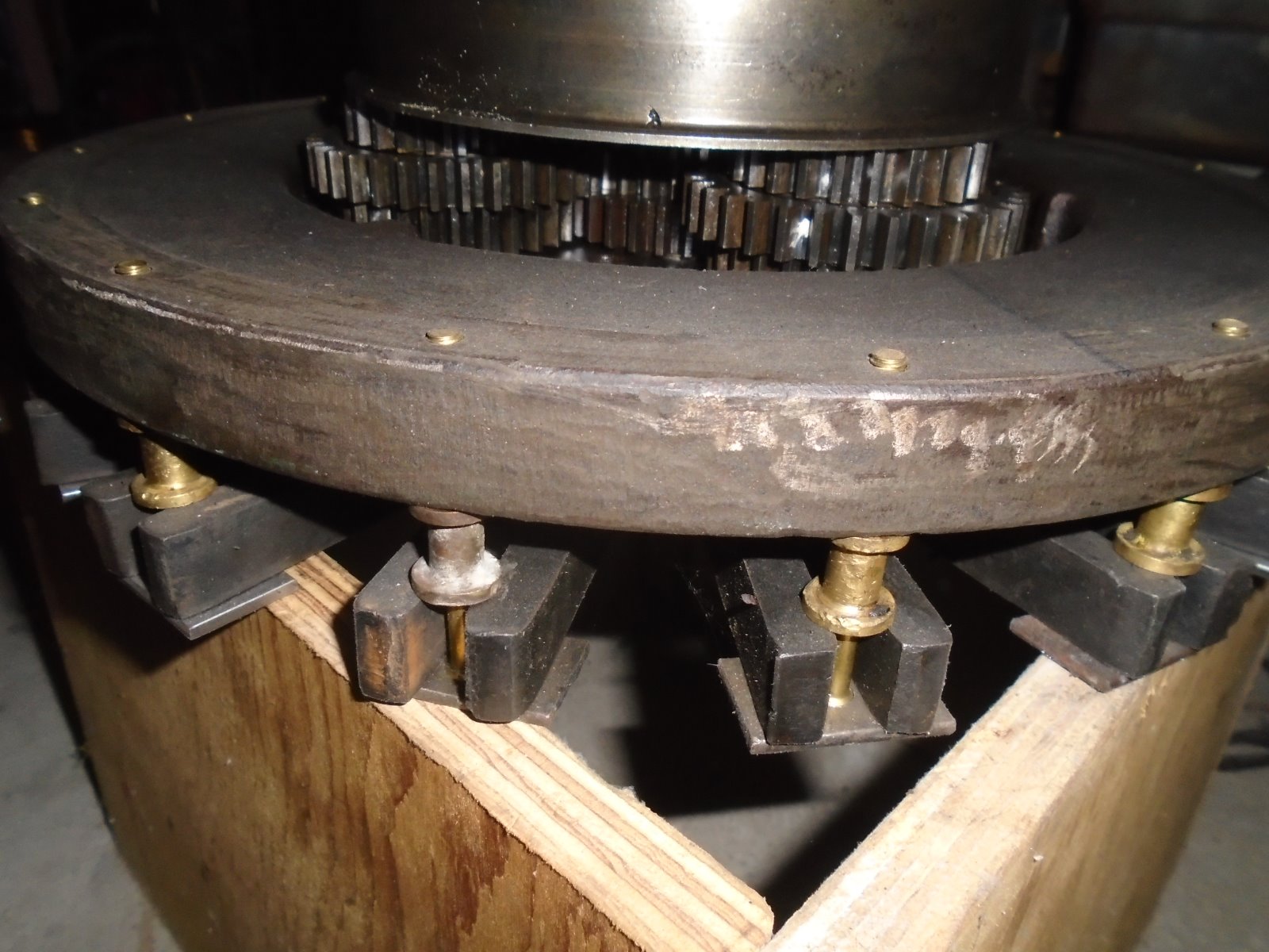

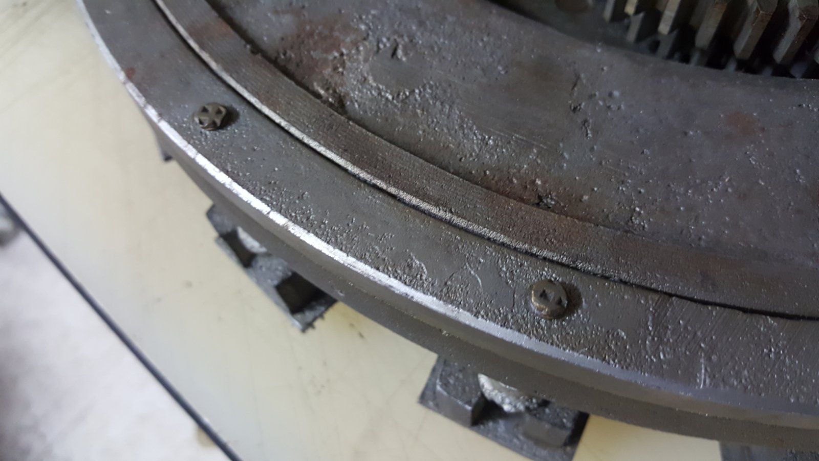

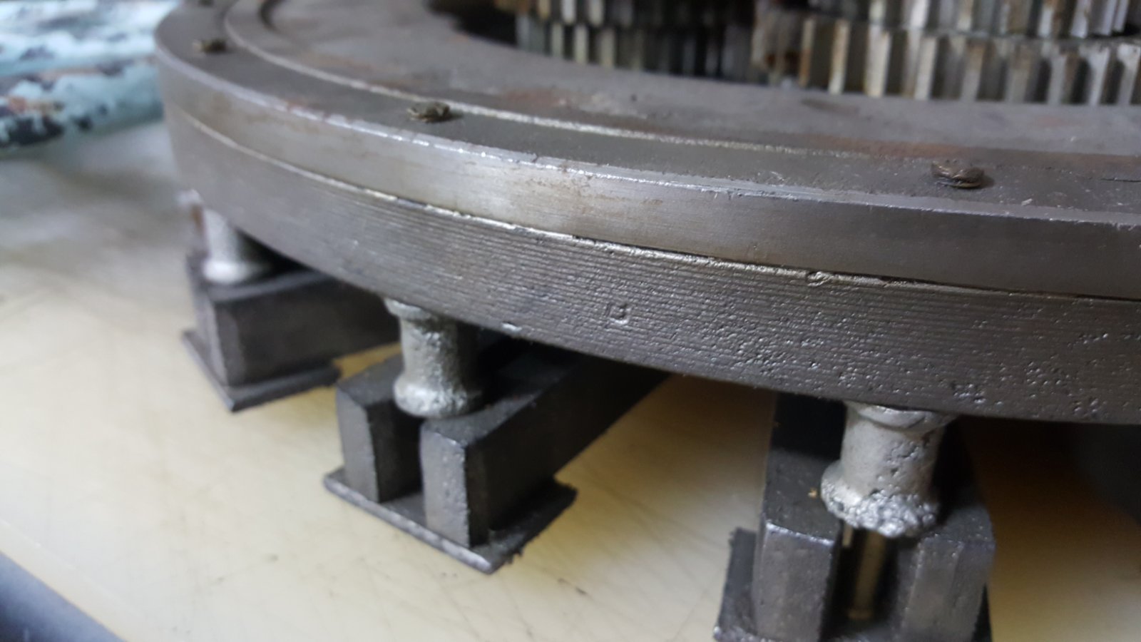

In the course of rebuilding my engine and reworking the magnets I'd like to add a flywheel ring gear and notch the mag ring in the event that I want to add a starter at a later date. The flywheel seems to be turned to accept a ring gear, but in place of that ring gear is a steel ring with no teeth. Assuming this is what they did on non-starter cars during the starter era, Is it simply a matter of removing that plain ring and installing a proper ring gear or have I got something else going on here?

The 8-5-28 parts book shows no such thing. I suspect aftermarket, though I don't know why anybody would replace a ring gear with something like that. From the pictures it looks like all you would need to install a ring gear would be a set of new screws.

That is quite an interesting feature - the "waffle" stamping of the brass screws is definitely Ford factory work - I've torn down too many T power plants to keep count & have never seen that ring on one !

There were several makers of these flywheels even Dodge made them for Fords, it is possible that the foundry made too many of the ring gear type and rather than dispose of them converted them to
non- starter type. I can not see any aftermarket purpose for the conversion. 15 and 26 flywheels

So does the flywheel have the starter era Ford ID no. on it? I’m thinking the ID no. would be for the starter era flywheel since the fly wheel is machined for a ring gear. Or so it seems.
Does the transmission cover have the starter accommodation?
Somewhere down the line things were changed. Or so it seems!?

I think you have something else going on there. The earliest flywheels with ring gears had two dowel pins 180 degrees apart from each other that acted as keys as a safeguard to prevent the action of the starter from shearing the 16 brass screws. These are only found on the very earliest starter type engines. If your flywheel and blank “gear” don’t have provisions for the dowel pins, then it probably isn’t something “transitional”.

Wow, first one I have ever seen!

Thanks for the input thus far. Humor me for trying to approach this from a different angle as I'm not as familiar with the later cars. In the "starter era" where a starter was an option, 1919 and later, what did you get when you ordered a non-starter car? Did they make two different flywheels?

I wonder in this case if it isn't the very definition of "transitional". Steve Tomasso pointed out the factory appearance of stippling-type peining...a feature that I too mentioned to Walter prior to his posting this interesting bit of mechanical history. I wonder if this actually predates the starter option by perhaps a few weeks or months after flywheels were machined but starters or ring gears were not on the line yet.
My dad has a '19 hack that has Liberty electric ammeter and (had a) very early generator with non-removable cover (the generator which sadly disappeared during a motor rebuild). I wonder if very early on, there were modified flywheels coming down the line and no starters/ring gears on the line to fit the bill...those magnet screws need something to screw into. I'm not ignoring the dowel pins on early ring gears...just wondering if this doesn't actually predate them for an extremely short period for a very narrow range of vehicles...All pure speculation, of course, but the peining on the screws sets me down this path.
But for that stippled peining, I'd dismiss this a depression-era fix/hodge-podge of some sort, but I can't just yet.

This is all very interesting. Given what we know about Henry Ford's frugality, it would seem to me that when starter cars were introduced in 1919 he would use the same flywheel for all, simply installing the ring gear on starter equipped cars and not on non-starter cars. I'm having trouble discerning what purpose the "blank" ring gear may have served, aftermarket or otherwise.
I don't know much about post-1919 non-starter cars, so my thinking could be wrong. Were different flywheels used?

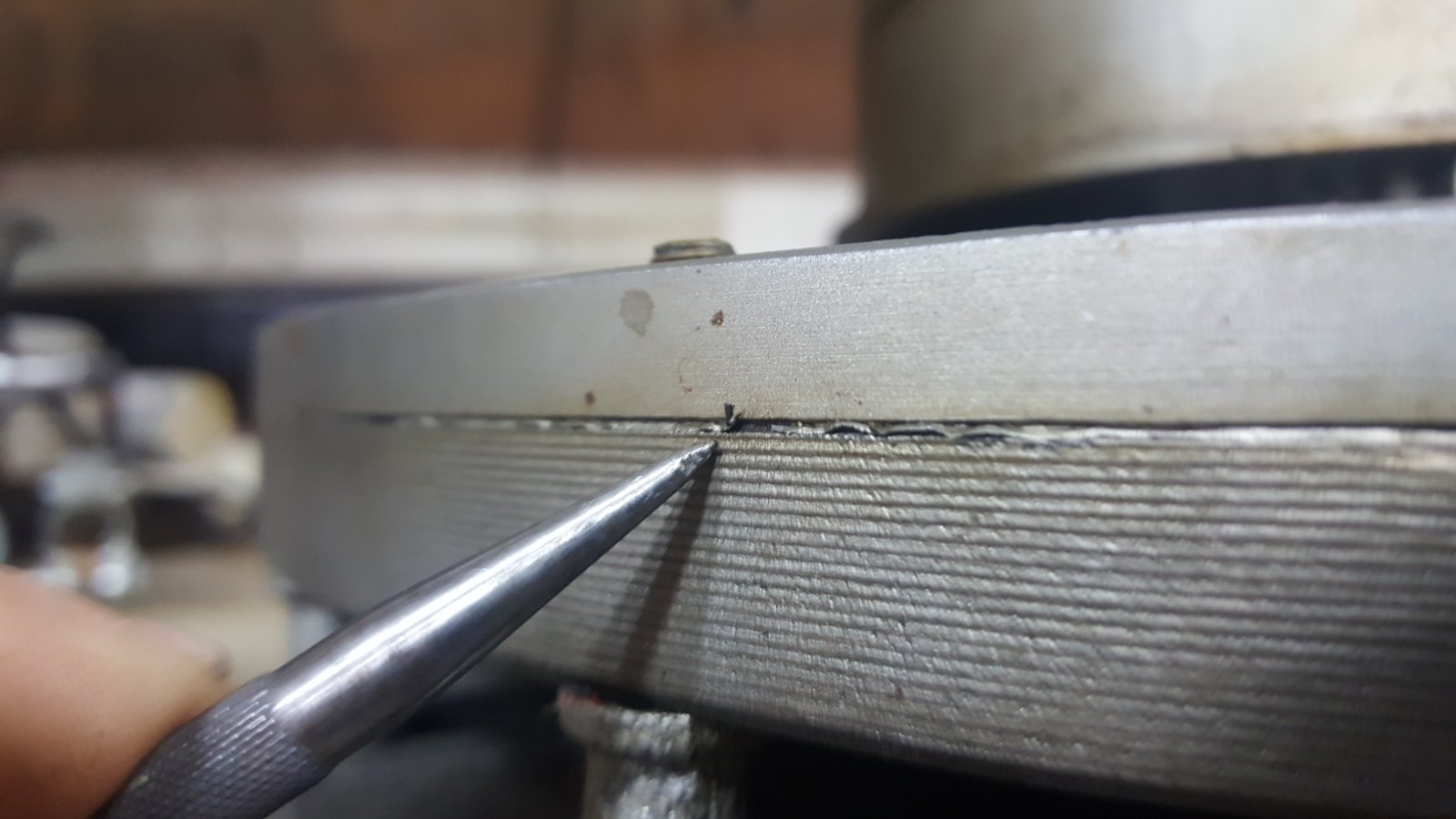

To add to this further, I'm going to leave out of it what "year" engine this is. Even good complete stuff has had parts switched out and in this case this engine is an amateur "rebuild" that I'm going through and reworking the mistakes. The parts on the whole unit, both internal and external, range from 1913 to about 1920, so no sense in going down that road other than to examine the details of the specific part in question.

the magnet keeper screws screw into the ring gear. If it was absent (and the flywheel was machined to accept one) there would be no method of fastening the keepers, so the "blank" or dummy ring gear serves a function.

Without knowing what was and was not available in the way of factory parts, this is one of the things I was wondering. Even without a big lathe, my Van Norman Rotary Broach (which is made to service flywheels) would be able to take off the teeth with a little special effort. Perhaps a screwed up ring gear flywheel was destined for a non-starter car and they just didn't care to have the teeth in there for no reason.

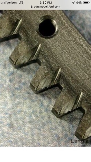

I'm going to quote myself here! Can somebody post a close-up of the gashed side of the teeth of a known original ring gear? On the photos of the reproductions I see the gash runs so close to the screw holes that I don't think it would machine away. My ring doesn't show the remains of any gashes unless it's flipped over, but even then I think I'd see evidence of that on the edge. Maybe Ford didn't gash them quite as close.

Just curious, does the ring line up perfectly with the flywheel? Is there a "lip" anywhere on the ring/flywheel where they join together that overlaps one another? If not, I would think Mr Bell is correct about the lathe. If not then added at the factory(?)

Since the brad marks on the magnet screws look like factory bradding marks the ring gear could be a turned down ring gear. Just out of curiosity if it is a factory turned down ring gear it should have Ford on it and “maybe” a Ford no. on it? I can’t remember if they had Ford markings or not. But if it does that would be a definite clue that the flywheel was turned down at the factory. Just a guess.

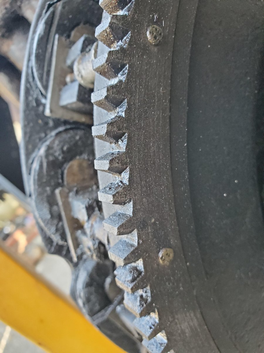

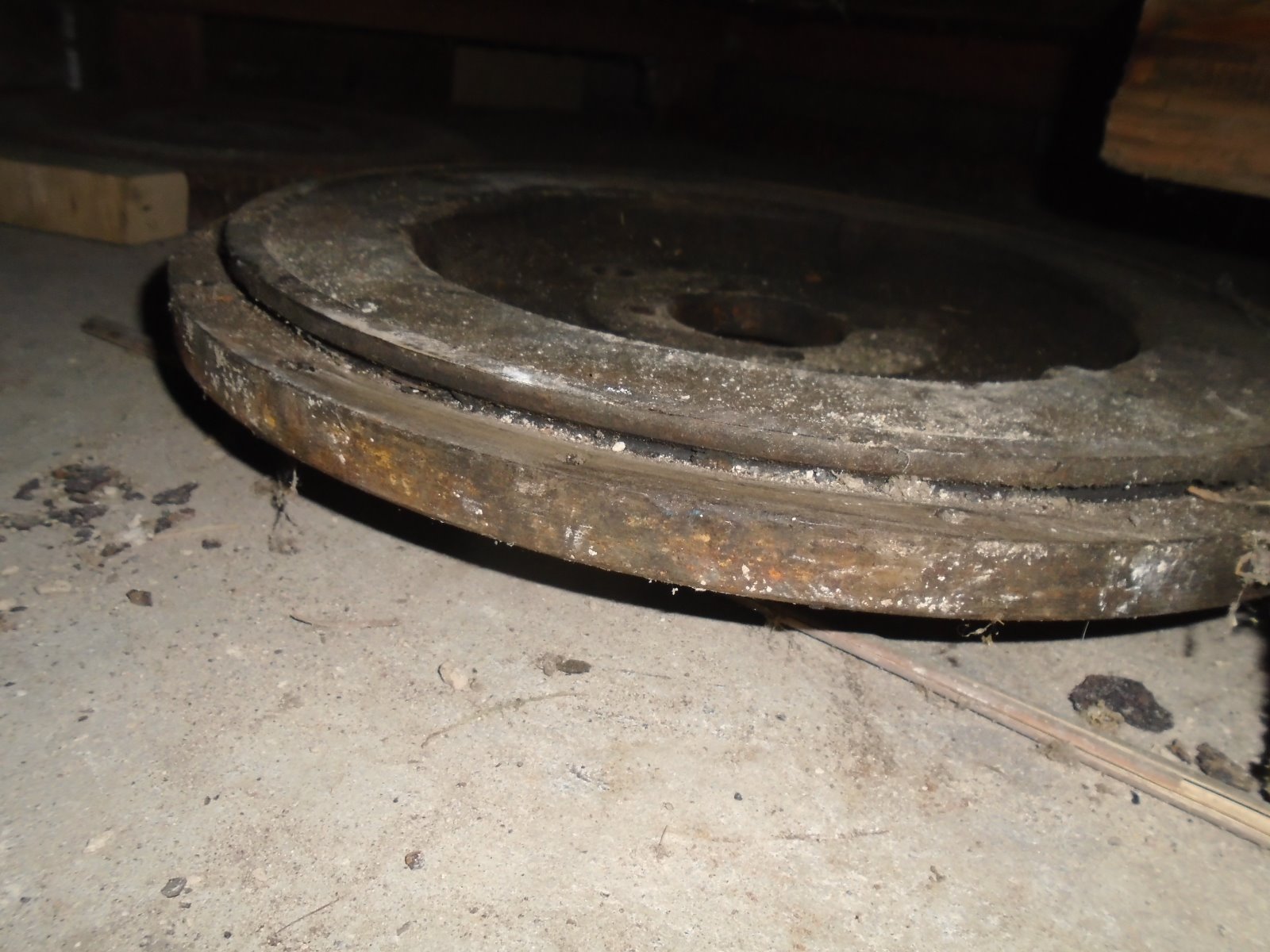

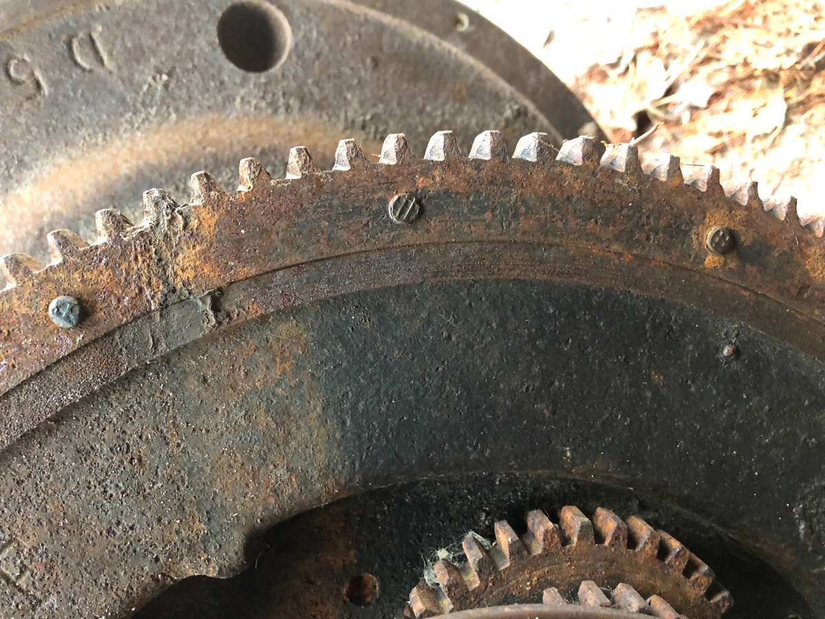

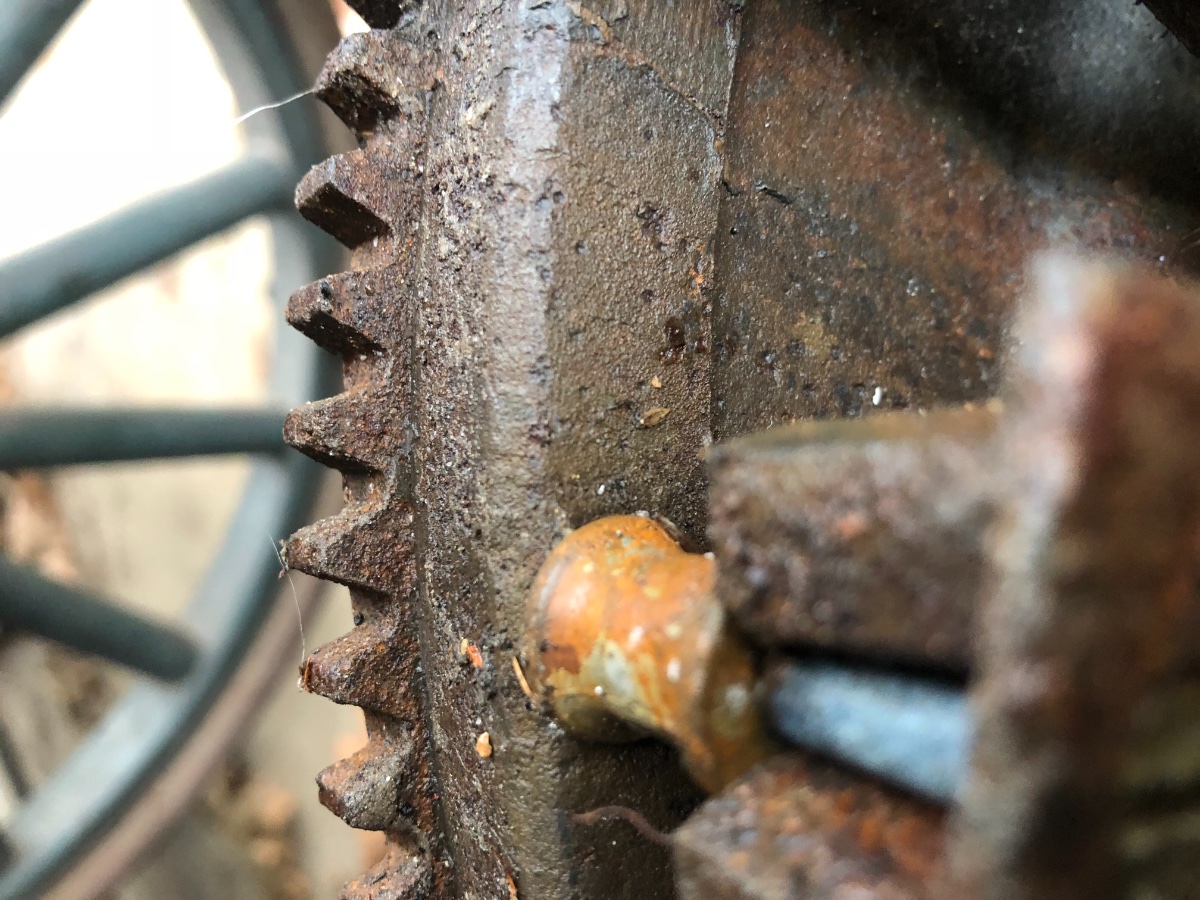

Here are pictures of both sides of a presumably original ring gear and a pic of a reproduction. It looks like it roils be possible to machine an original and the gash marks not be present.

Thanks for the photos, Corey. I agree that based on what you show there that no gash marks would be present were the teeth to be machined away from an original ring gear.

Sure looks factory to me. I didn't know Ford was using aluminum magnet spacers that early?

Coming back to this thread and studying the photos at highest magnification, I would be inclined to rule out the teeth having been turned off of the gear post installation. First, it makes no sense as nothing is gained, second it would be all but impossible to turn off the teeth in a lathe (and it was a lathe as a mill leaves an entirely different lay on the metal), as there is "zero" touch on the cast iron flywheel from the lathe tool. It would be very difficult to have done such a perfect job on the OD of the "ring" gear in matching the OD without having the tool at least touch the cast iron...and again, why would any mechanic/machinist make that extrordinary effort of precision/perfection if they were simply trying to remove teeth? Dead nuts OD would be the least of their worries, not to mention it would be a significant undertaking on quite a large lathe to accomplish all of this.
That thing was made this way and installed, and by all appearances/evidence, installed at the FORD factory or agency.
I make the effort to duplicate the stippled peining on my work, but cannot imagine anyone, certainly back when this was installed, in attempting to duplicate the factory tool. Time is money. In a normal shop, two whacks with a ball pein hammer and it's upset enough to move on to the next one.

On a secondary note I have in my barn a flywheel that came off a 1919 equipped with ring gear and it had several dowel pins (not just 2 of them at 180 degrees apart) very neatly placed around the perimeter to place the ring gear in a precise location but later Ford simply used the magnet keeper screws. Dowel pins most likely denote a 1919 model but I have not verified that via a Ford Archived drawing.

I[ am in the process of tearing down my nonelectric 1921. I found an original Ford script head gasket and standard bore pictons. This engine is well past being worn out. :-) I assume that it has never been torn down before. At any rate here is a picture of my no stater flywheel with a virgin ring gear on it.
Sorry. This site won't post my picture saying it is too big.

For what it's worth, I have a 1921 TT that never had a starter but was equipped with a ring gear and starter hogshead. It also had no holes drilled for a starter foot switch to mount or holes in the running board brackets to accommodate a battery carrier. I think it is strange they seemed to differentiate frames as starter or non starter given the lack of these holes.

(This is the photo Chris was trying to attach.)

I'm glad for the added discussion as it has caused me to look closer. Also, John's input regarding undersized driveshafts is interesting whether or not it is directly applicable here. I wasn't aware of that.
With respect to machining, as I mentioned above, a Van Norman Rotary Broach (which used to be a common piece of equipment in engine machine shops prior to aluminum heads becoming so popular) could be set up to cut the teeth off a ring gear without the need for a large swing lathe. In one of its forms it is essentially a reconfigured vertical spindle Bullard lathe.
Also, the ring does protrude from the o.d. of the iron flywheel about 0.003 to 0.005 all around. That said, I started going around it really close and now see something that I didn't notice before -- sections where there looks to be a rolled burr on the flywheel side of the ring. In the attached I picked out a piece and am pointing at it so you can see it better.
So with that I'm sort of leaning toward it being a turned down ring gear. As to who did it I cannot say but, if after the factory, somebody like me might. It doesn't make sense from a practical standpoint, but if it was shot, it was going in a non-starter engine, I didn't want to get my hands cut up handling it, and I had the machine laying around that could cut it, I would spend the time do it. The set-up time is less than the time it takes for a potential cut from a gnarly ring gear to heal!
Posts: 6817
Re: Is this a "dummy" flywheel ring gear for a non-starter car?
Post by Scott_Conger » Thu Dec 12, 2019 1:30 pm
That is some compelling evidence, I'll admit!

Sorry I didn't see that before. There are only sections of it and I had to spin it around to find that.
