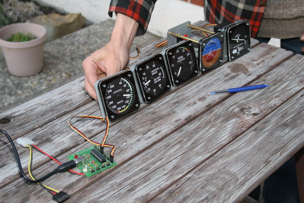

FWIW, as I like things to be 'period', I'm not sure how keen I would be on a digital readout, although that would probably be the easiest. However some time ago I developed some instruments for a Flight Training Device (a.k.a. flight simulator) that were a reasonable facsimile of the actual instruments we use in a 'plane. I attach an image of some of these instruments here:
It occurred to me that it shouldn't be too hard to do something similar that looked like a 'period' instrument for a T. One could then write some code for an Arduino or similar that would sense/calculate road or engine speed and drive a suitable pointer in the instrument (via a stepper motor or servo).

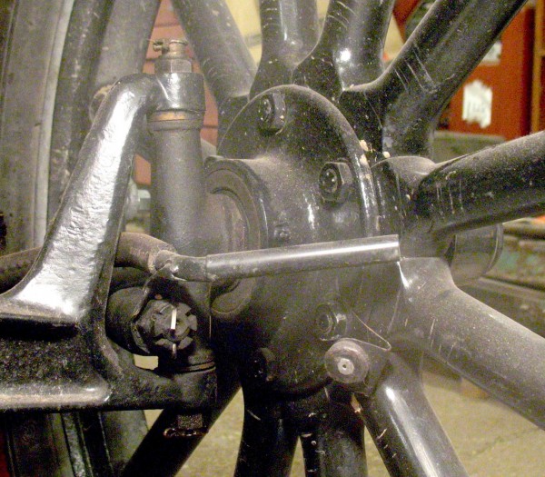

...something like a hall-effect sensor and a magnet on a spoke...
This works great, until it doesn't. I've been using a bike speedometer with the sensor mounted on a bracket by by the left front wheel and a magnet on the wheel. I've found that sooner or later road hazards damage or destroy the sensor. In the last failure I found that the sensor was completely gone. So recently I installed a sensor inside the rear brake drum with the magnet held by a hub bolt. We'll see how well that setup survives.

- Steve Jeff, that sounds a good idea. I had envisaged utilising existing spoke bolts, but what you're doing gives some protection. That said I've had another idea around this that might make it easier/better still, just need to think it through a bit more

Here's the speedometer setup on my touring. I believe the only reason it's still there is that I haven't driven this car on any trips like the runabout. This sensor will be going inside a brake drum too.
