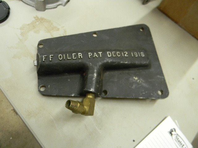

Ford Faithful for an outside oil line?
ModelTWoods
Topic author - Posts: 1578
- First Name: Terry
- Last Name: Woods
How many T owners use a Ford Faithful transmission inspection door auxiliary oiling kit; either an original or a new reproduction? I know that many are going to say forget it and use one of the new high volume kits that require drilling the hogshead, but if you don't want to ruin a hogshead and you want to be period correct, one of these is a possible solution. Fred Houston used to say that using the original large funnel inside line, plus one of the accessory inside lines (held in place by the crankcase inspection cover) and used on both the driver's and passenger's line of the engine, PLUS a mag post oil line kit would provide plenty of oil to the front of the engine. It seems the Ford Faithful might even be better than a mag post oil line kit. What are your opinions?

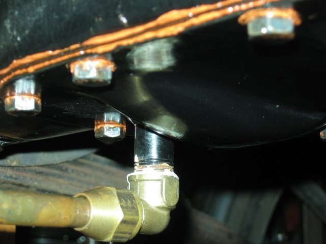

Re: Ford Faithful for an outside oil line?

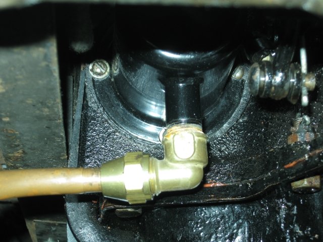

This is the one I use. Incredible amount of oil.
I use ione like John's pictured
1 piece cast door these where made by Max Edmonds in 70ss and 80s
No holes to drill and run hollow bolt like the mag post oiler
Bendix is my second favorite way but usually not an option
as most of my T's are non starter

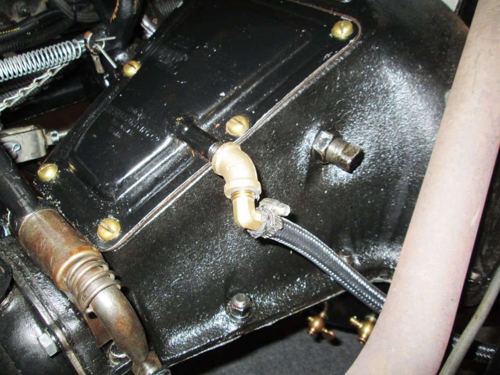

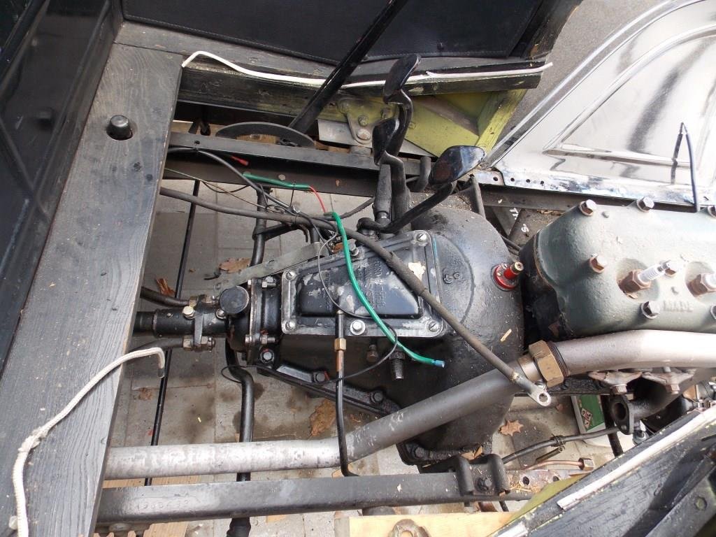

Here is what I found, last year, as I bought the "1915" touring.
I don't like it because the oilline goes over the exhaust.
Andre
Belgium
Andre
Belgium

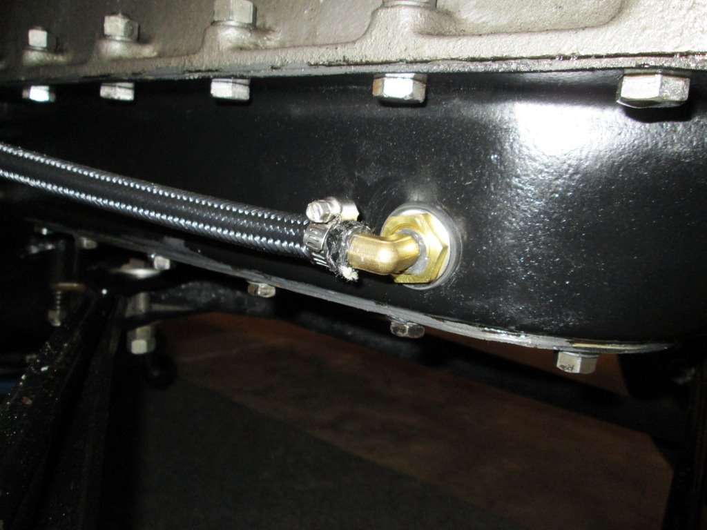

Is there such a thing as "too much" oil heading for the number 1 connecting rod? I run the ubiquitous mag post oiler and a Bendix cover oil line as well running from the Bendix cover to the lower inspection pan, coming in just at the start of the radius for the number 1 valley.
I also modified the inspection cover like the one that was shown and discussed by Terry Horlick in the thread that is linked below. Unfortunately I do not have any pictures of my version of his "mountain pan" that is in my T. I think that with the original internal oil line, mag post oiler, Bendix cover oil line and the modified inspection pan I am doing O.K. but more oil is always better for that number 1 rod, especially if you run/drive on hills. Ten years of driving through Northern Michigan hills and no problems as of yet (knock-on-wood, kenehora). If I were going to add another, I would opt for the internal oil line that attaches to the inspection pan bolts.
Andre - the oil line should exit the oiler & go under the pipe and yes, I run original Ford Faithful Oiler's on all 5 of our T's - built in debris screen and with the topography here in the Pacific Northwest, a little lubrication insurance to the front of the engine is good !

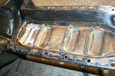

Jeff, If it really is that steep, then you are still probably not getting the oil to the front that you think you are, and even if you were, it's not staying where you need it for long enough.
Consider placing dams into your pan.
Something along that line is here: http://www.mtfca.com/discus/messages/25 ... 1344799117

AdminJeff
Yup, it's really that Steep. Ask Andy Clary or Steve Nelson.Scott_Conger wrote: ↑Fri Dec 13, 2019 11:21 pmJeff, If it really is that steep, then you are still probably not getting the oil to the front that you think you are, and even if you were, it's not staying where you need it for long enough.
Consider placing dams into your pan. Something along that line is here: http://www.mtfca.com/discus/messages/25 ... 1344799117

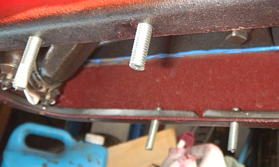

Ok, now Terry Horlick has a pretty interesting idea... I have a few extra 4 dips. I think I'll start on this mod. It also looks like the dam on #4 could be built into the back horseshoe instead of brazing it to the pan. I also have some extra pans and horseshoes so ill experiment with that.
. What I found even more intriguing in that post was this idea for "horseshoe handles". Makes me want to go right out and change my oil!
. And this looks like a cool project for my "new" lathe. Layden Butler found these in his dads toolbox. Spring on the side, so you just push the plate up in place and it is held while you start the bolts.
I'm really glad Chris and I take the time to maintain the old site info. There really is invaluable insight there, and I'm always discovering new stuff.
