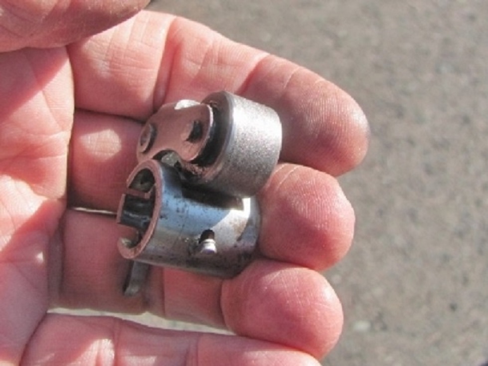

I had the same symptoms - turned out to be a defective brush on my new day timer. Now I carry a spare.
- Posts: 4084
Re: Running poorly.
If you're running an original, might be the issue. Likely the roller rotor is now pitted and running poorly making for lack of proper timing to the coils and the fire to the plugs is reduced.
This one caused similar running symptoms at speed, during a tour few years ago, replacement with a newer one and troubles solved.

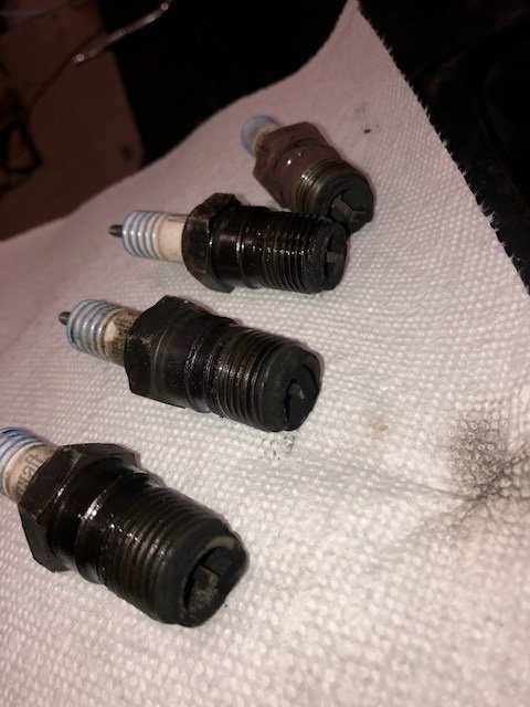

Plugs are all sooty. I cleaned them, re-gapped and put them back in. Running too rich?
-- IV
-- IV
- Posts: 6799
Re: Running poorly.
YUP
- Posts: 4472
Re: Running poorly.
Don't worry a whole lot about running rich until you solve the misfire problem, (although the solution for both may be one in the same). A misfiring ignition, (versus carburetor or fuel issues), will in itself cause the engine to run rich. If a plug is not firing every time, as it should, fuel will build up and when firing actually occurs, the result will be an overly rich mixture due to the accumulation of unburned fuel..

Your plugs were pretty sooted up. They couldn’t have been giving good performance in that condition. I’ve found that my car likes to run at 3/4 of a turn out or even slightly less. I’d been running it at over one turn out because that’s what I’d been told to do and it was consistently fouling my plugs. I’d get about 30 minutes of good run time then it would start running bad.

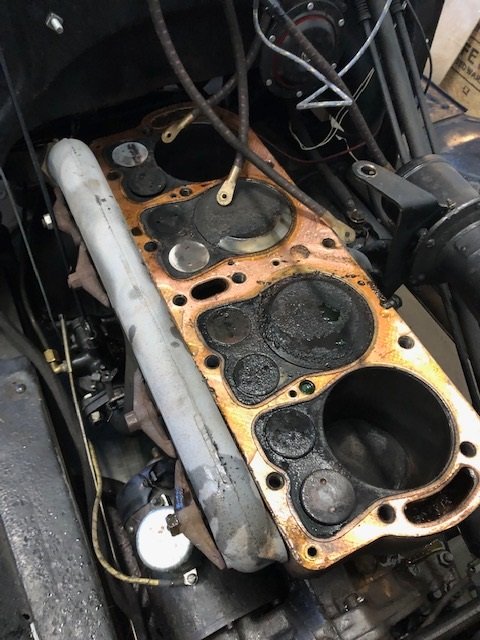

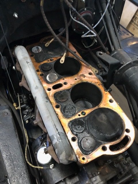

Which size aluminum pistons? https://www.modeltford.com/pl.aspx?t=s& ... ton&page=1 I have new valves just not installed.
JTT3 wrote: ↑Thu Jan 09, 2020 1:44 pmIgnacio, I think the coils might be a problem but I’m betting on your valves. Do a compression test to see if that’s the major issue. Remember you’re still running those old two piece valves. While your have it down you might want to go with aluminum pistons. It’s time you should replace the valves none the less. I know it’s a headache but pay the piper now than while you’re stranded. Best of luck, John
- Posts: 1967
- Last Name: Tannehill
- Location: Hot Coffee, MS
- Board Member Since: 2002
Re: Running poorly.
You don’t have to do the pistons but if you did you’ll have to see what the bore is on each cylinder. That will tell you what you’ll need. To do that you’ll have to send it to a builder. Your still going to have to remove the engine because you’ll have to replace the lifters along with the valves. You time is more valuable than what it would cost you to have a competent model t builder do it. Best my friend, John
ivaldes1
Topic author - Posts: 960
- Joined: Mon Jan 07, 2019 1:32 am
- First Name: Ignacio
- Last Name: Valdes
- Location: Houston, Tx
Re: Running poorly.
Thanks brother, I did measure the cylinder in the past: Cylinder Upper measurement 3.7640 inches.
Cylinder Lower measurement 3.7525 inches.
Trip down memory lane: http://www.mtfca.com/discus/messages/70 ... 1490898491
I also think the cylinders were standard. Do I need to send it to a pro builder anyway? Ross Lilleker is in College Stations.
JTT3 wrote: ↑Thu Jan 09, 2020 7:11 pmYou don’t have to do the pistons but if you did you’ll have to see what the bore is on each cylinder. That will tell you what you’ll need. To do that you’ll have to send it to a builder. Your still going to have to remove the engine because you’ll have to replace the lifters along with the valves. You time is more valuable than what it would cost you to have a competent model t builder do it. Best my friend, John

It is a lot better but it still detonates some at 27 mph and when I turn it off after driving it detonates once. Plug #2 was still sooted. Just to be sure I changed out the plugs for new ones. No change. Sounds like I have a valve problem and the head needs to come off to check? -- IV

Head is off. The valves look ok except number 1 and number 2 are more heavily sooted, number 3 and number 4 are less. The two adjacent exhaust valves on 1 and 2 are sooted. Maybe I should have just kept driving it to clean it out after it had run poorly for awhile? Pictures below are with 1 and 4 up and 2 and 3 up. The engine top and head was scoured clean 3 years ago with a wire brush. -- IV

Looks like you have burn't exhaust valves on 3 and 4, I suspect a bad intake gasket on 3and4.
- Posts: 4682
Re: Running poorly.
I think I would replace all the valves and lap the valve seats while you have it apart. Looks like you have the original 2 piece valves. Not many folks still use those in a rebuild. If you keep driving your car and I know you will the valves might need to be changed. They may or may not come apart but after 90+ years something might happen.

Well,....SHOOT! Egg on my face!!! Now that I look at the photo closer, that "dark spot" might just be a shadow! I didn't notice that when I blew the photo up larger for a close look. I'd still replace the valves tho' as others have suggested.
