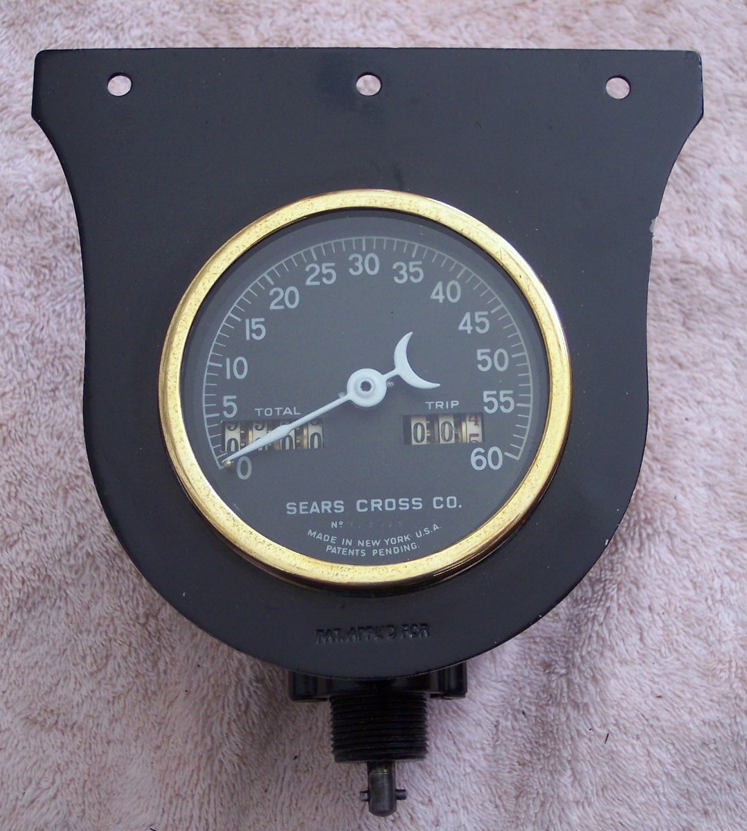

Since you don't have a dashboard, the most common application was to use a "drop down" bracket that mounted to the cowl, just below the windshield. There were several manufacturers that provided this type of setup (Sears-Cross shown), with Stewart Warner being the most common. Here are a couple of photos of the type you could used. Also, Stewart Warner offered a dashboard for the Ford that mounted the speedometer (see the variety of dashboards in photo). I hope this helps.
Russ Furstnow
Russ Furstnow
