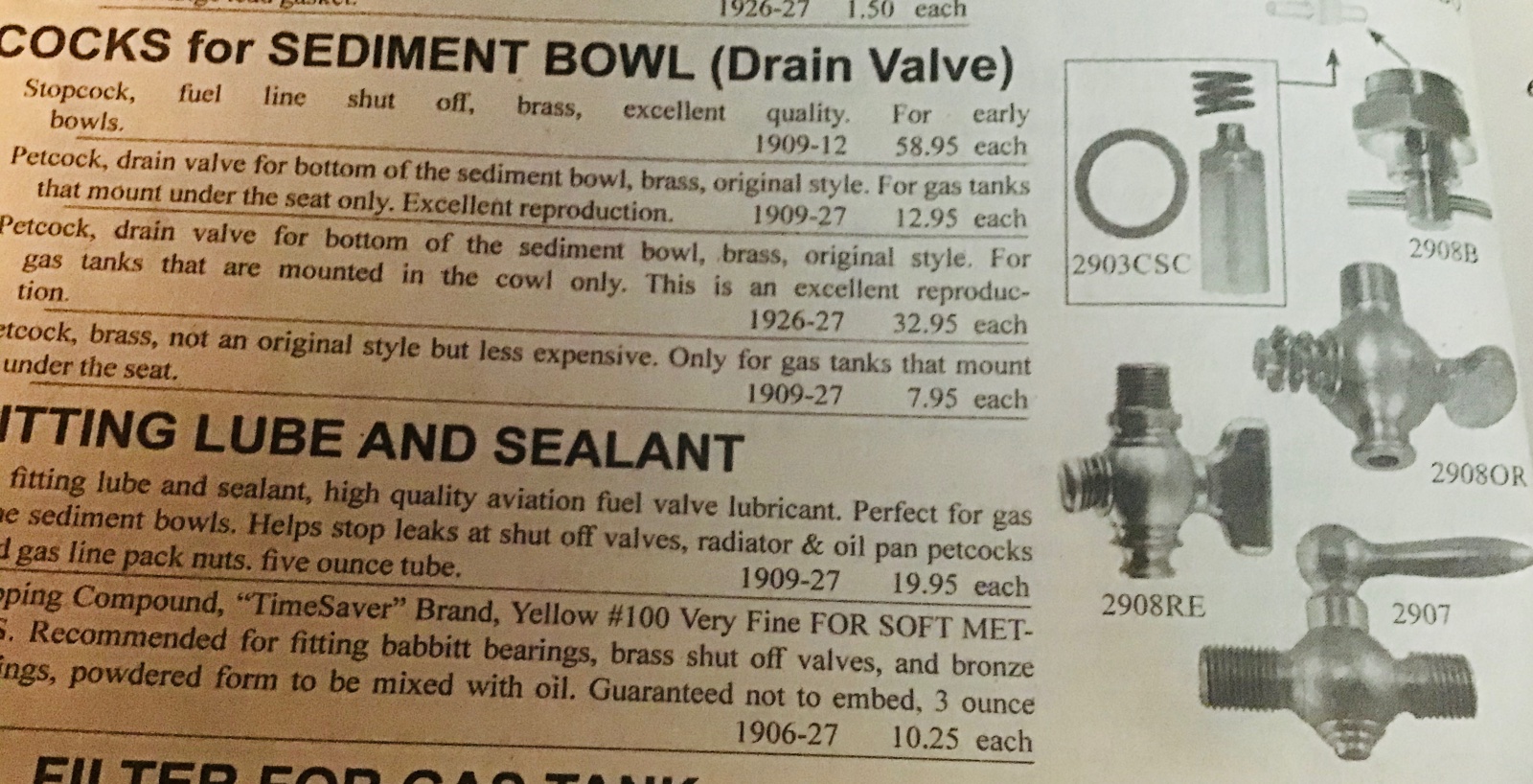

Correct repro part is the 2907 for your early sediment bulb.

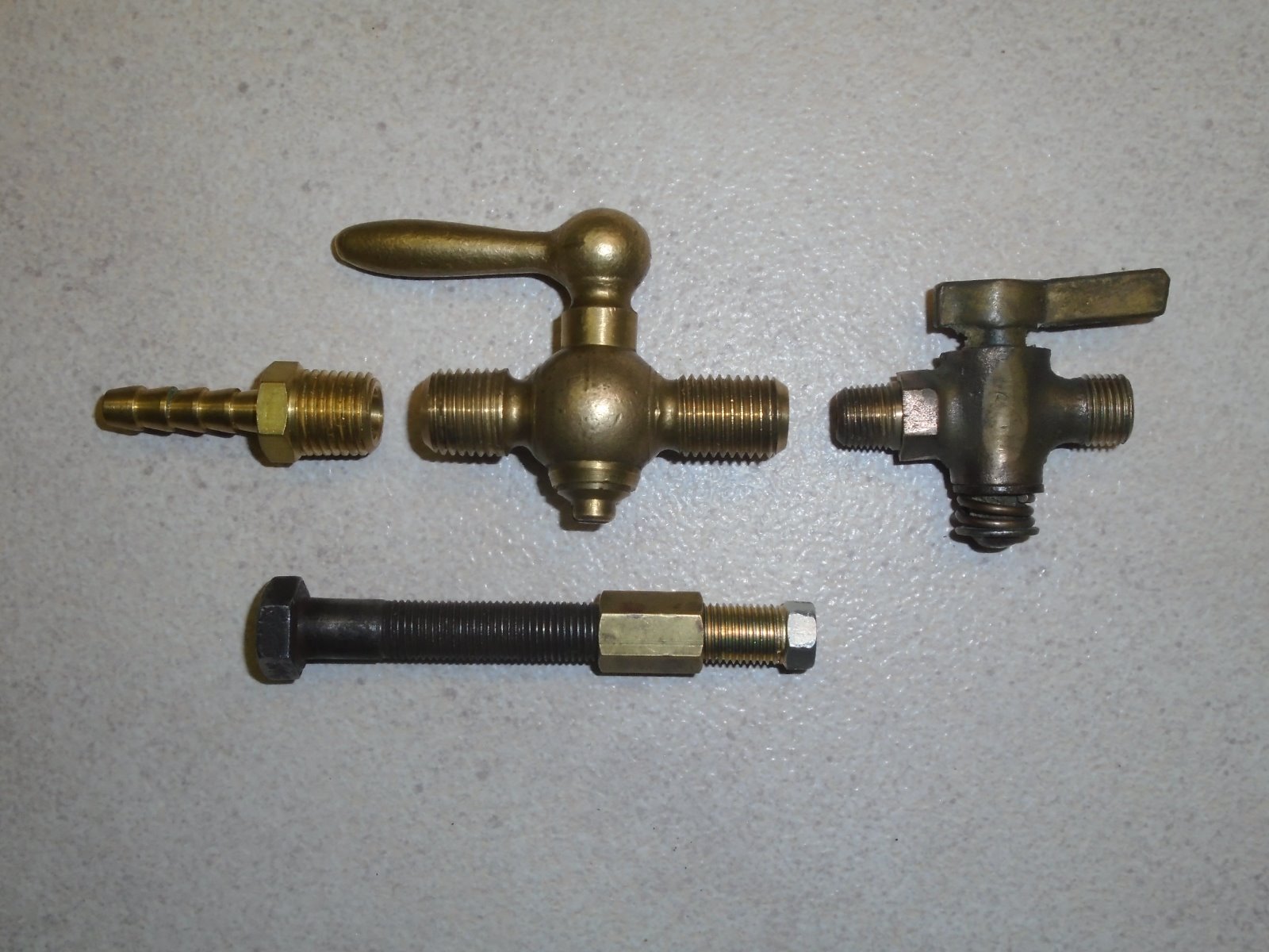

Many times the jockeys in the hardware store don't much about these fittings and likewise in the auto parts stores too. There are 1/4 pipe taper threads and 1/4 pipe running threads and to the untrained eye they look the same. 1/4 pipe threads are 18 threads per inch, but will measure as 1/2 inch. The running threads are designed to seal when bottomed out. Some female threads are also tapered, a male running thread should not be put into a tapered female, it will go in part way and then bind up and leak.
There is also a system of tube fittings that go by the tube size and many are machine threads. A 3/16 tube fitting looks very close to 1/8 pipe however the tube fitting is a 3/8 fine machine thread. I have had countless discussions at the auto parts store over this issue and almost every time they ask me to come behind the counter and get the fittings myself. Fuel lines should not rely on a taper fit they should be a running thread fit and seal when bottomed out. With a taper fitting over tightening can crack the fitting. Gasoline will get through where water won't.

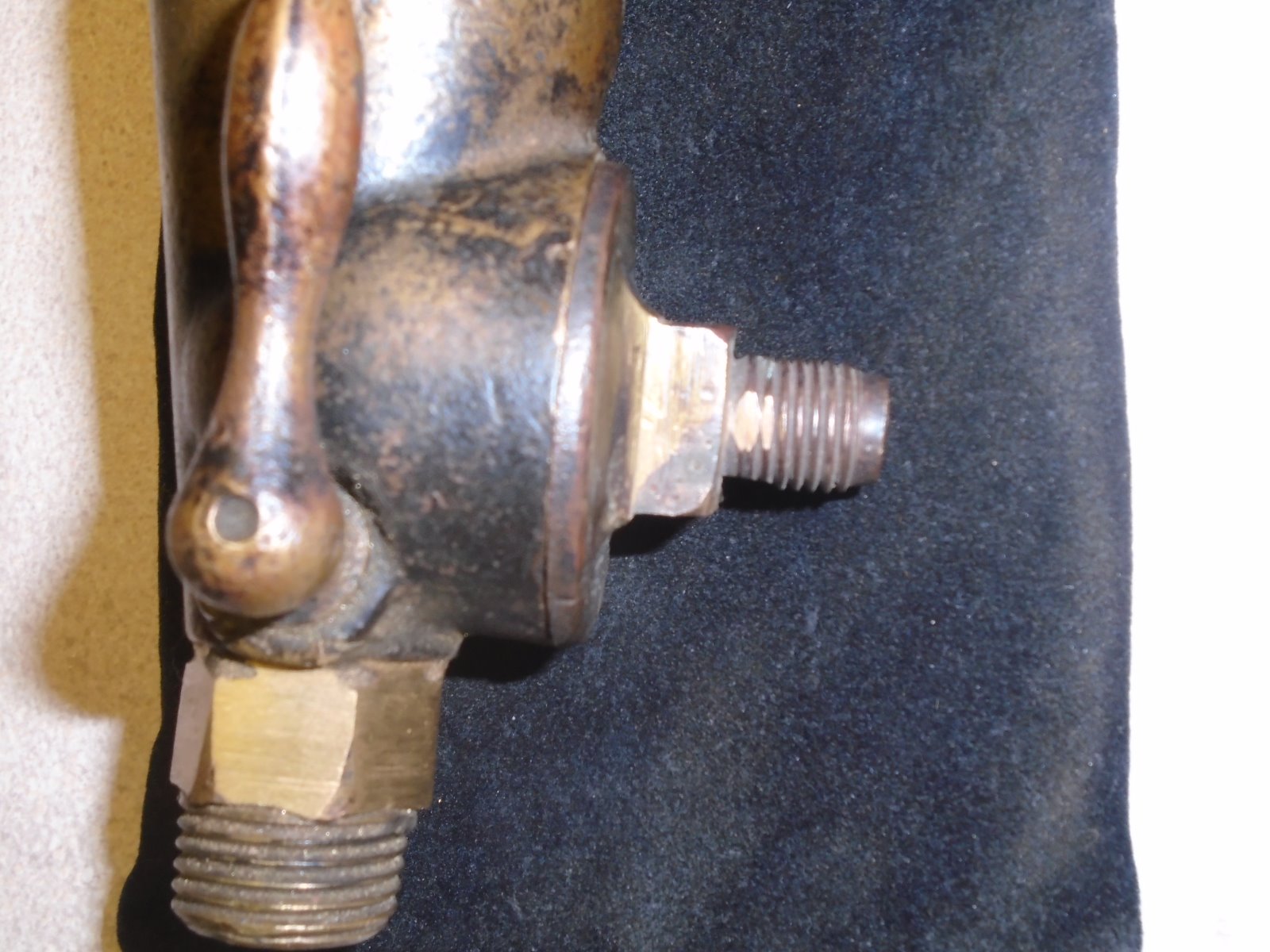

Re: gas valve thread size
I have an early brass fuel valve and the fitting into the tank is NPT however the fuel outlet is a running thread and seats by bottoming out against a flair. The original fitting on my 26 was a rubber hose with a moulded flair fitting. It was completely rotted out and I could not ever find the same fitting. I had to use a conglomerate of fittings to make it work and then the valve would leak and I had to fit in the line an accessory shutoff valve that required more bastardized fittings.
- Posts: 6803
Yes, as I mentioned before, that is a 1/2-18 straight thread. It is the same thread as is on the unobtainable (for now) shut off that Art is looking for. It is not intended to be married up to a flared pipe. You've seen them that way, I've seen them that way, and they are all wrong. It is counterbored to accept 1/8 pipe with a felt packing and a PN 2910 packing nut.
to be clear: that outlet on the sediment bowl is not a flare fitting.
Flare fittings are intended (typically) high pressure, rigid applications of which this is not.
