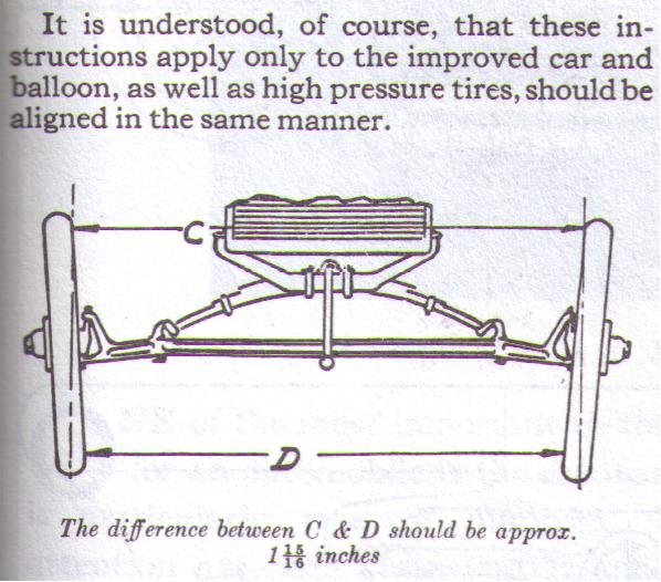

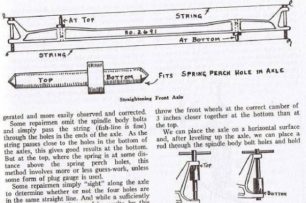

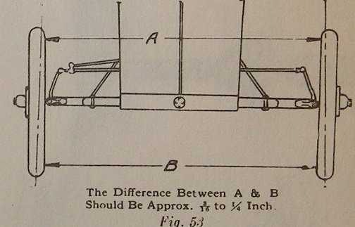

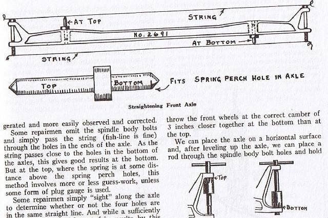

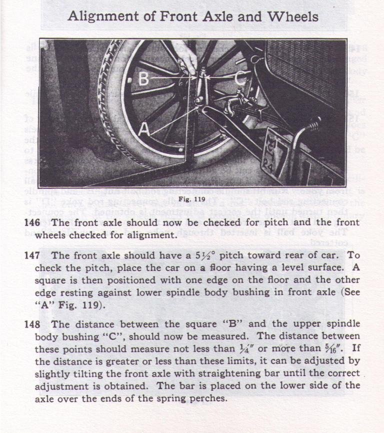

I am looking for that diagram of the front end alignment.
I have seen it before but don't know where to find it.
Herb
Posts: 6587
Re: Need heip on front end alignment.
Post by TRDxB2 » Sun Dec 15, 2019 12:23 am
Front end alignment diagrams and some how to's
https://modeltfordfix.com/front-axle-al ... el-t-ford/
https://www.nwvs.org/Technical/MTFCA/Ar ... Wobble.pdf
