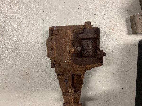

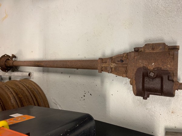

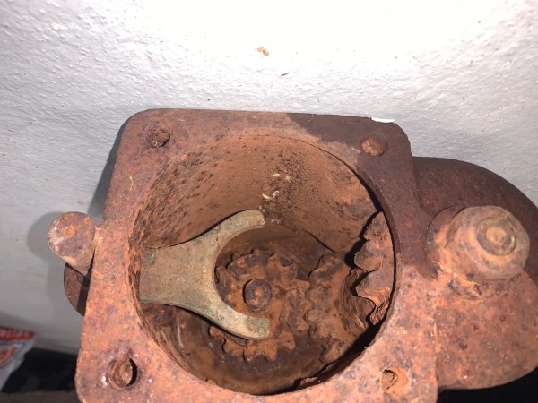

Hi All
What type of Moore do I have here and what is missing please
Cheers
Andrew
Moore gearbox

Pinion section, shift rod and control lever.
- Posts: 6901
Re: Moore gearbox
The pinion bearing and housing are standard Ford items. You are missing the output shaft, driven gear and the selector dog.
