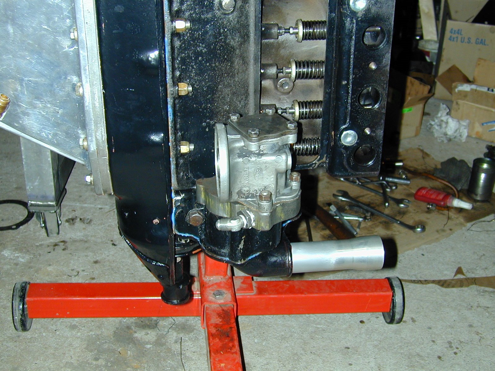

This is an overhead but gives you the idea. I do have the mounts for flat heads as well.
All the Best,
Hank

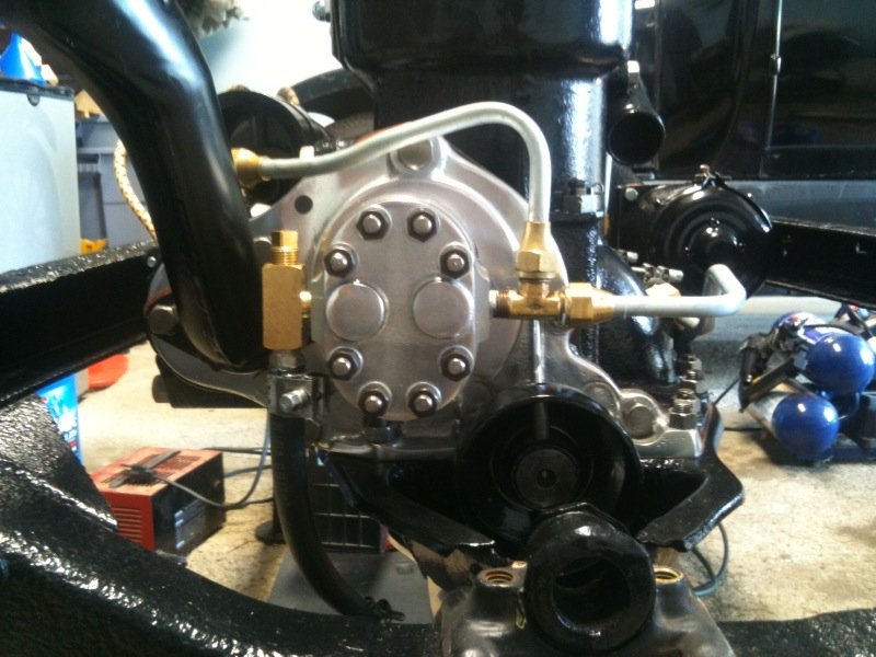

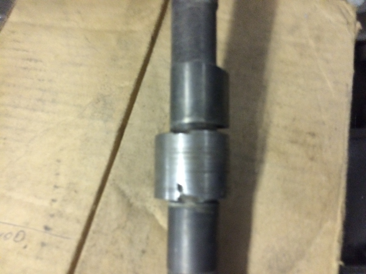

Here is a shot of the B-210 pump I’ve been running on my T for bout 10 years now. Didn’t like the fitting sizes or locations on the adapter pictured above, so made my own. You can see the special built check valve and the bulkhead fitting to pass thru the pan behind the carb air horn. I sumped my pan for several reasons, but it did make ample clearance for the required plumbing.
Pump has never lost its prime over the years, and always provides plenty of pressure 40 psi at idle. And that’s after I cut down the bypass spring to lower the pressure from >60 psi!
Remember that this discussion can have an extreme snowball effect, and is not for the faint of heart. Plan this project carefully, and remember... this is not a speed accessory! This is a required modification only when the engine is expected to perform waaaay beyond its design limits

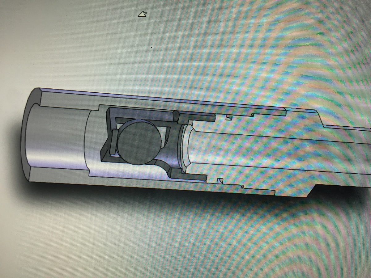

I’ve never come across an “off the shelf” solution that seemed like a good fit. Have seen some as simple as a few strategically assembled pipe fittings. For this motor I wanted something a bit cleaner... and it only cost me dozens of hours...!
If I remember correctly... there is a captured .500” ball in that aluminum housing that is gravity seated

Here is a cross sectional view of the check valve in the pic

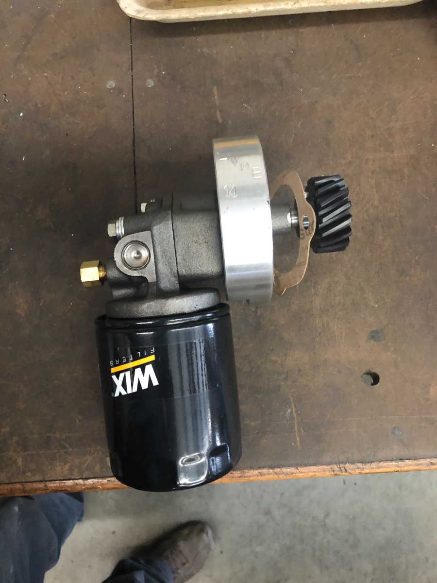

I will dig one out of my barn stash for you and take photos. Dad made one years back that was belt driven from a small marine brass water pump, worked excellent! He made a by pass switch you depressed on initial start up until oil pressure was achieved, if you loss oil pressure due to a broken belt, engine would kill and red oil light came on. Just ideas!

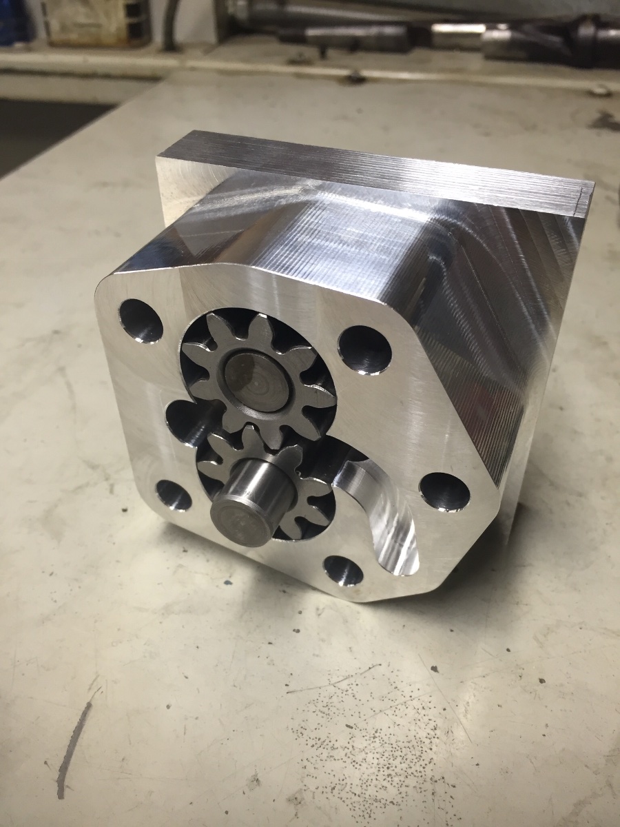

I have made many of these pump set ups for my cars. It is a small gear pump bought at a machinery surplus sale driven off the front of the generator gear. I machined a flat surface on the timing gear cover, fitted a small plate to screw the pump to. A roll pin thru the generator gear fits a slot in the pump shaft. They self prime and I have used one on my Fronty for 35 years trouble free. Les

Very Nice Les!!!!

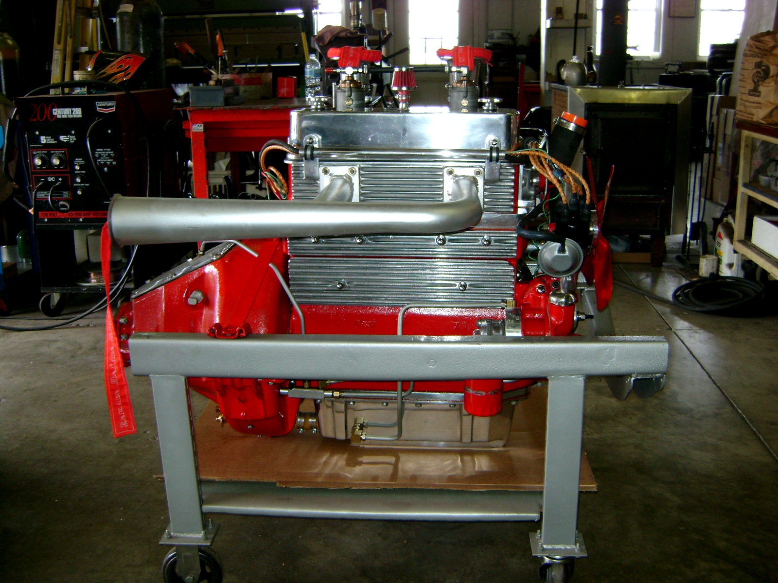

Further to Kevin’s comment about elevation, I have a installation mostly done using a Flathead V8 pump on the back end of the camshaft. Yes, Stipe made me a cam with a extended back end.
I also have a era marine conversion that has a pump gear driven by the crank gear.
I guess I need to take some pictures!!

Re: Oil pump
I know I've probably beat to death posts of my oil pump alternative, but here they are again. Uses the gears from a small block Chevy, magneto side drive so no generator. Enjoy

Re: Oil pump
Joe just keep beating me, I love that kind of pain!!!!
Just Beautiful Work, Keep it up!
Hank

Re: Oil pump
Those VW pumps have great gears in em. Here is a pump I made for a ‘26 Cleveland that utilized the VW gear set. Don’t seem to have a pic of the pump finished...

- Location: North Ridgeville, OH
Re: Oil pump
Outstanding job. CNC Vertical machining center?

Re: Oil pump
A lot of very nice machine work!!! I really like the picture of the heavy duty oil pan with all that hanging and all the extra power i think that pan is a good foundation!!!

Re: Oil pump
That Cleveland pump was made on my ‘ol Bridgeport type CNC conversion mill. In computer years, it was almost as old as our T’s! I’ve upgraded since (some call it “Millzilla”), to a much more capable and rigid “bed mill” design machine. Not only is it half the age of the ‘ol one, faster, tighter, higher RPM, but also allows to addition of an auxiliary rotary table unit. So far, it does a better job than you want to do without a cabinet around it to contain the mess!

Re: Oil pump
Bud,
Sumping the pan was a bit eerie as I lost the inspection cover... but came to the realization that the motor would simply need to come out if any problems arose. The motor was babbited without shims, so there really is no “maintenance” to be done in there anyway. Knock on wood, the motor hasn’t had to come out after almost 10 years of abuse and neglect. However, I intend to “freshen up” the motor when I change over from the Sherman flathead, to the Akron OHV someday...

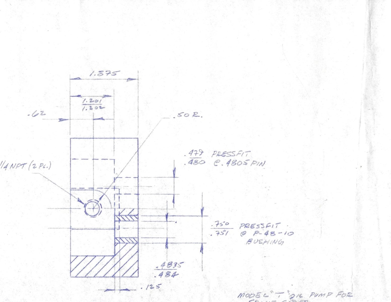

Re: Oil pump
So I stopped at a local engine rebuild shop and “scrounged” a used small block Chevy pump to examine the gears etc for design purposes. It certainly looks like they will be a good fit for the aluminum castings I have!
henryford2
- Posts: 826
- Joined: Sun Jan 06, 2019 4:14 pm
- First Name: Joseph
- Last Name: Andulics
- * REQUIRED* Type and Year of Model Ts owned: 1926 Fordor, 1926 Truck, 1927 Roadster GOW, RAJO Sprint car
Re: Oil pump
Les, give me a day, but I believe I have the drawings that I used in making the oil pump with the Chevy gears and the castings you have. They are hand drawn (done before I began using CAD).

henryford2
- Posts: 826
Re: Oil pump
Les here you go. I drew these looong ago, I may or may not have updated them after machining the one I made, so proceed cautiously. I do remember I set the end clearance on the gears using a thin metal shim between the cover and the housing. I had lapped the mating surface of each of those, when assembled them with the metal shim I've never had a leak. Enjoy
Les Schubert
- Posts: 1364
- First Name: Les
- Last Name: Schubert
- Location: Calgary
Re: Oil pump
Joe
Thank you very much
Thank you very much

Re: Oil pump
Finally found a picture of the Cortina oil pump on my '27 engine. Sorry it took so long.
