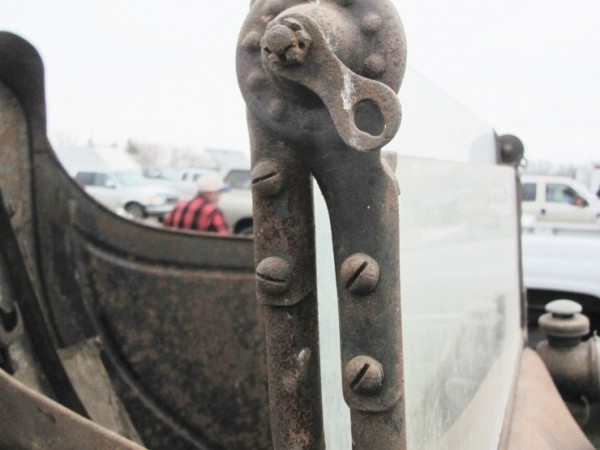

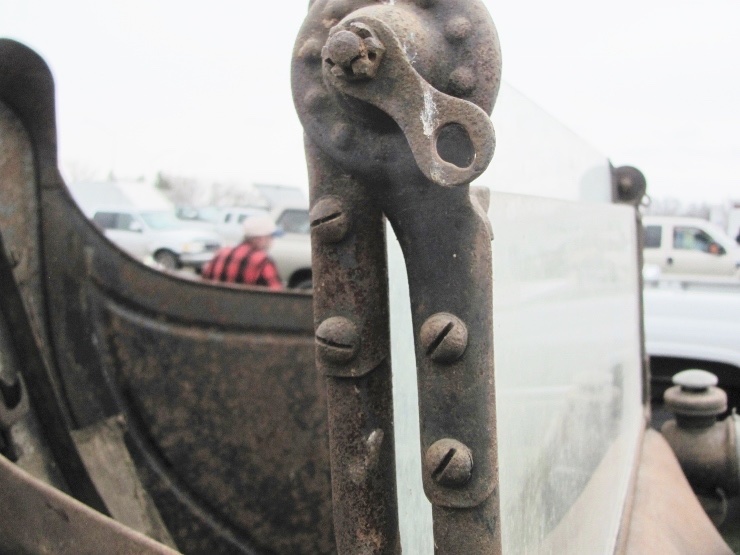

Post by Steve Jelf » Thu Dec 19, 2019 11:08 am
Cast...
...or stamped?

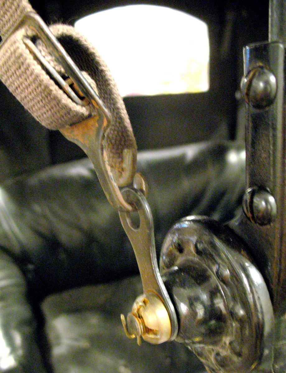

The stamped design for the cotton web top to windshield strap came out in 1920. Ford designated it "A2" and the earlier forged design, which was continued alongside the new stamped design, was "A1". However, about 95% of 1915 cars had leather top to windshield straps, with the earlier forged buckle hook.

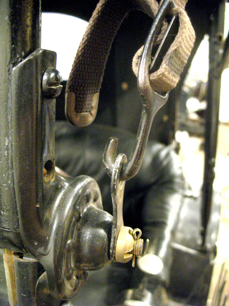

Like R.V. posted, original 1915's show leather straps with the cast iron belt buckle type hook.

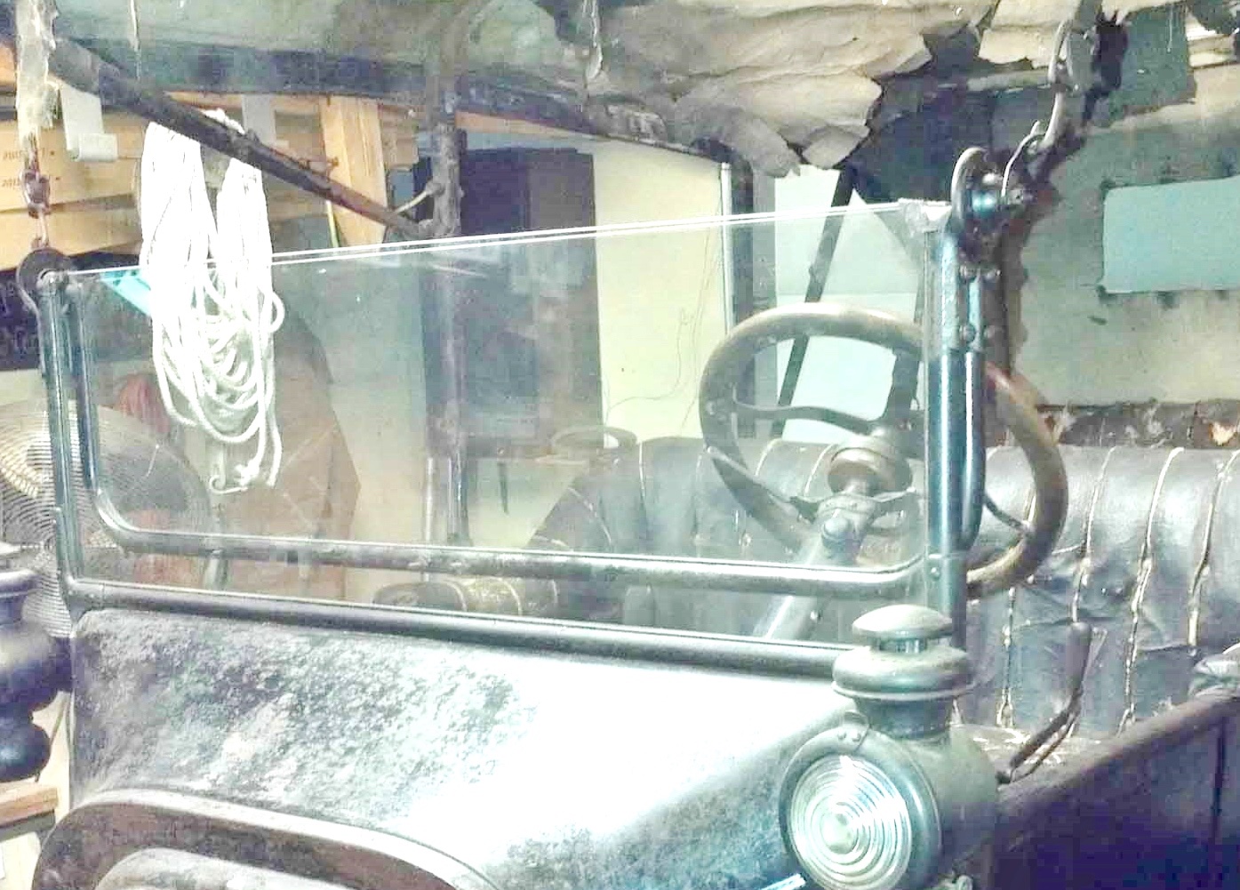

Makes sense too with the wear on this stamped steel windshield dogbone, note the wallow from the cast iron hook wiggling on that steel ;)

Steve-
I have the type in your top photo on my 1915.
Forger hook used with cloth webbing.
Made by Anchor.

Please forgive me if I'm wrong, but the bottom photo that Dan posted doesn't appear to be a 1915.
Posts: 5433
Re: Which hook for 1915?
Post by RajoRacer » Fri Dec 20, 2019 11:08 am
Offset hinges - '17 & later, I believe.
