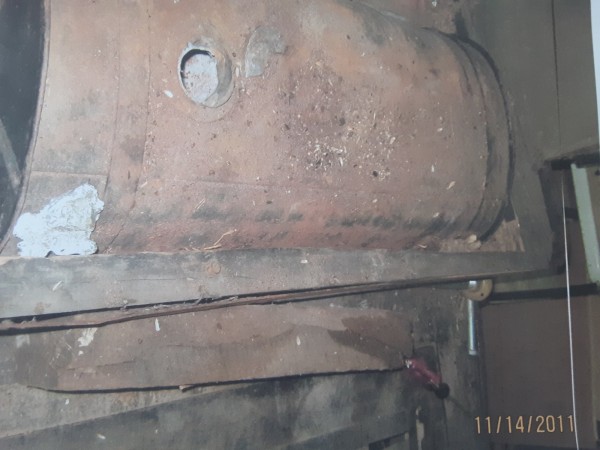

Hi all, l am at the point of bolting the body down on the 20 coupe I've been working on since 2011. It seems to me that the tank is to high for the seat, so I looked back at the pictures I took while taking it apart and it looks like that is the way it was. So wondering if there is someone out there with the oval tank under the seat in a coupe that can tell me if this is correct. Thanks George

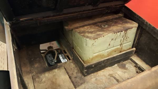

Here is a picture of a '21 Coupe gas tank it is in the turtle deck just like my '22 Coupe.
21 Coupe 3.jpg (34.35 KiB) Viewed 5785 times

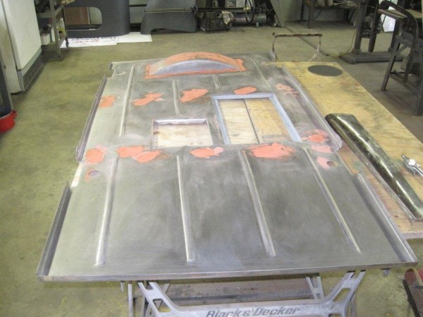

The turtle deck floor was part of the entire floor pan for the whole car
As you can see the gas tank and the battery had a hole in the pan. The hole for the gas tank allowed the fuel line and sediment bulb to hang below the car

The original floor pans reinforcement bead rolls were "X" shaped and not straight like mine are rolled. The speed shop where I took the metal to be rolled started to roll the floor pan before I arrived and already had two runs done. I wanted them to provide me with new metal and make the proper "X" design but that is another story. The metal pan runs under the seat and into the turtle deck. The hump is positioned over the rear spring. From the front seat forward to the firewall is the standard wooden floor board set up. I'll post two pictures.
