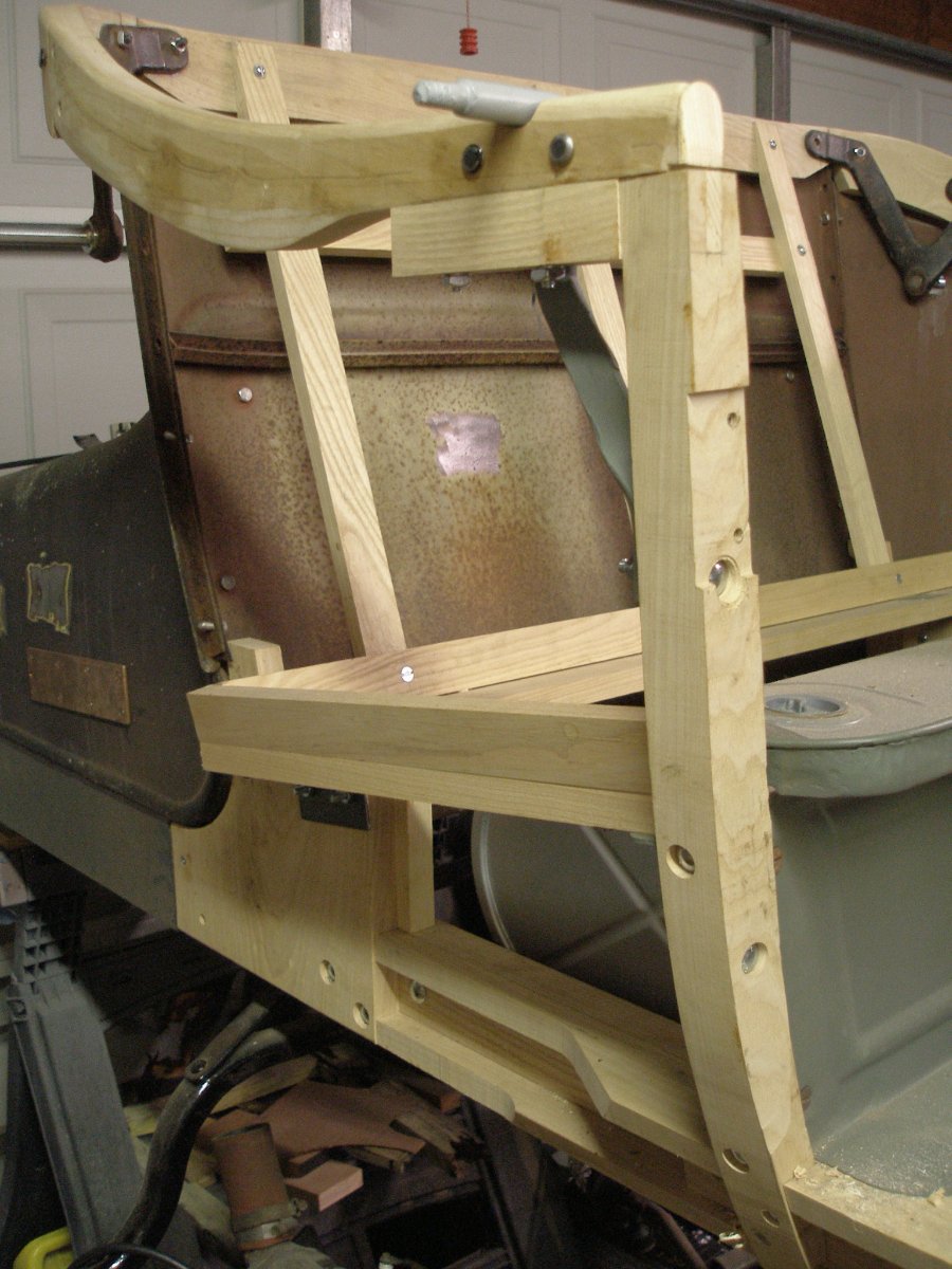

There was an article in Vol. 22 #6 (Nov./Dec. 1987) of The Vintage Ford about re-wooding a '23 roadster, with lots of photos. It may be of some help to you. Copies may still be available from the MTFCA.
- Posts: 6600
Re: 23 Roadster needs wood repair: Any suggestions?
RV's article was excellent and helped me out on my '23
anyone doing full or partial wood replacement is welcome to email me privately for photos...I have lots. Here's an example:
R.V. is being really modest...he wrote that article and did the rewooding on his 1923 (a low cowl roadster).
The club allows us to share his article to help promote the hobby as well as to help get a few more T's back on the road. If you would like a free scanned copy, for non-commercial use, drop me an e-mail with "send 1923 Roadster Rewooding" or similar subject and I will send you a copy. Please be sure to include your e-mail address as I don't know of any way to attach a document to a private message. My e-mail address is listed in my profile or you can also send me a Private Message -- but remember to include your e-mail.

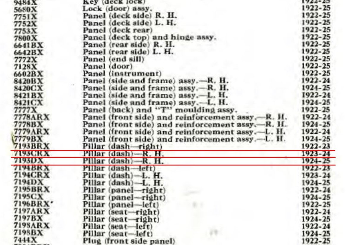

Hap, the reason for the two different pillars on your list is the 23 roadsters have a wooden pillar where the door attaches whereas the 24-25, I believe, have a steel pillar there.
Stephen

Hap, you're being very kind. While I did write the article, in re-reading it over the years I cringe at some of the errors I made in it, such as mis-identifying the years of component parts such as brackets. I think the main value of the article is the photos. But I do appreciate the generous words and am especially glad to hear that some folks were helped in their restorations, which was the point of the whole thing.
