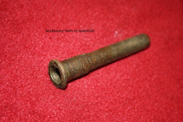

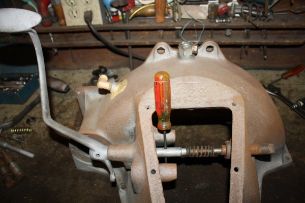

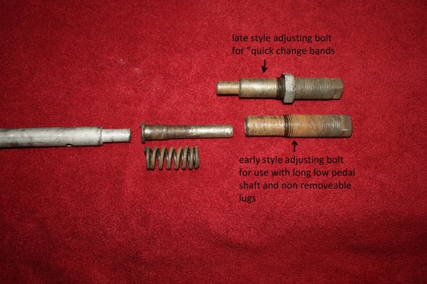

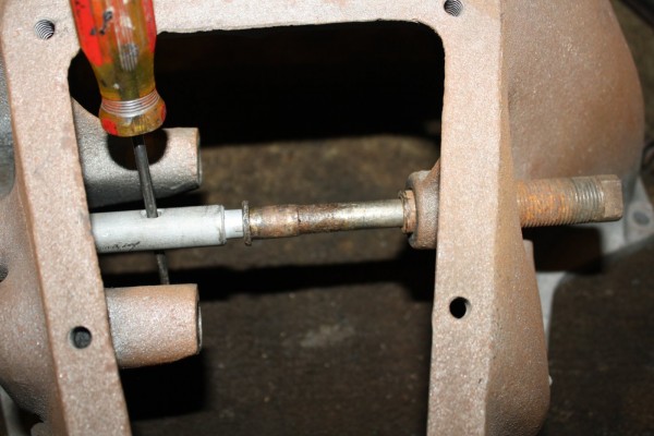

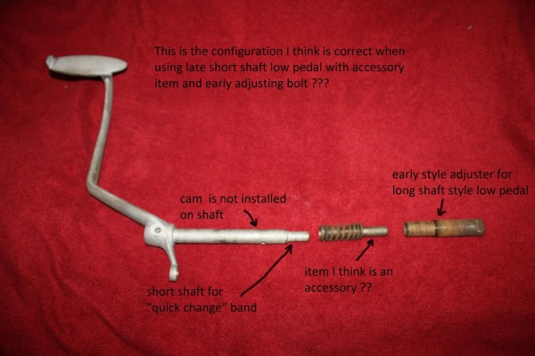

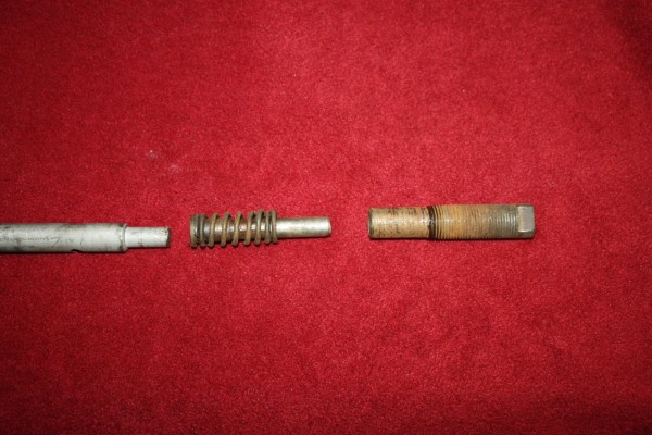

While restoring the hogs head for the speedster project, I found a neat accessory item in my parts stash. I have only seen two of these and I have both of them .. I think I understand how it fits into the hogs head. It appears to be an item to achieve the same effect as a long low speed pedal shaft when using quick change bands. ??? The early long low speed shaft went all the way across the hogs head and was supported by the hollow adjusting bolt. It made for a much more solid assembly. This item appears to try and achieve the same full support ??
Has anyone seen anymore of these?? Has anyone used this item ?? Does anyone have an ad for this item??
I have played around with it on the bench and it appears that it should install fairly easily when the hogshead is in place on the engine.
Any input will be appreciated, as I probably will use it, unless someone has a horror story ...

Nobody has seen one of these ?. I was hoping someone has used one.

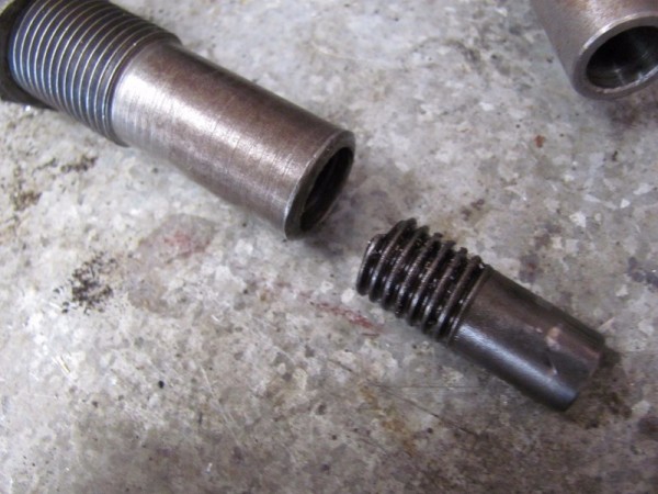

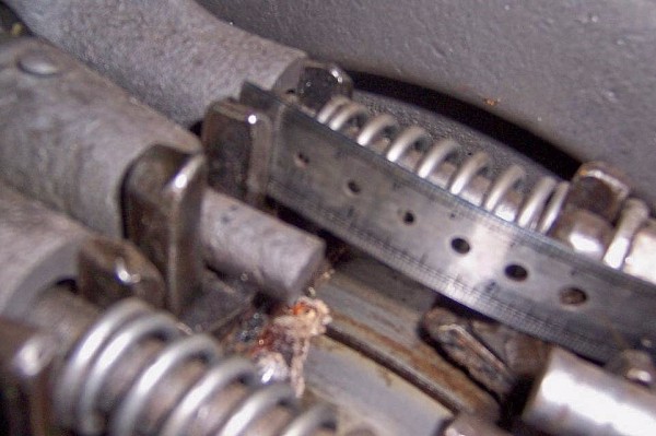

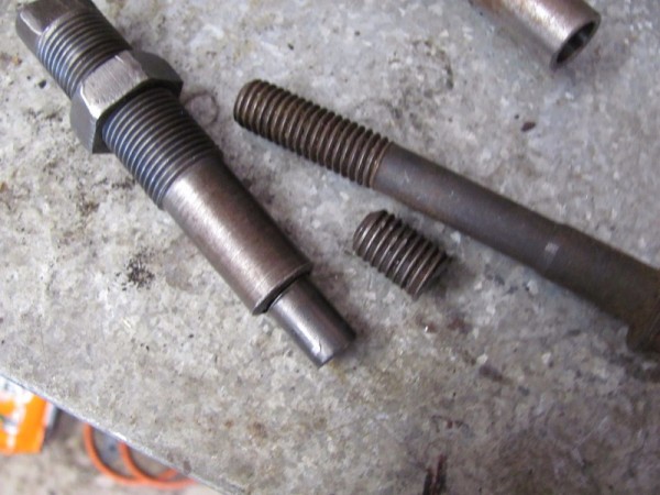

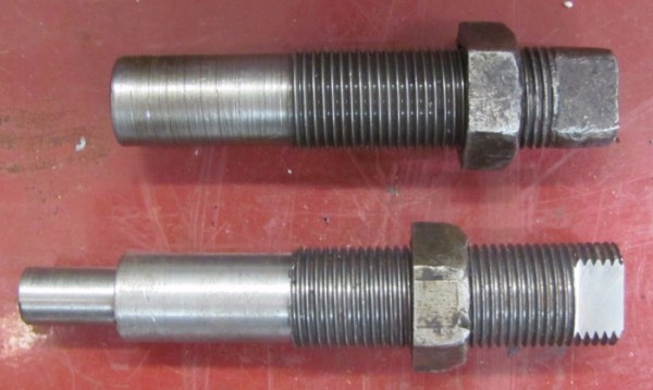

Never have seen one. Still don't know reason for use. Seems that 'accessory' separate shaft piece would have to have exacting dimensions, otherwise that thing would just bottom out on the cut-off 'stub' end of the earlier low speed shaft, and then bottom out into the early adjusting screw hollow end.
Result would be the adjusting screw couldn't push any more with its flange on the ear of the band ...to tighten up the band.
Have made an earlier hollow shaft adjusting screw in the new style, by Loctite of a threaded stub into the hollow end. Had to be sure the length was same a new style screw. If not, it could butt up to the cut-off pedal shaft, as Ford recommended to shorten to aprox. 7/8" stub, so a gap is needed between the parts used for the demountable-ear bands.

while I'm a fan of the old style pedal shaft for aluminum hog's heads, I, too, am dubious of this accessory's utility. However, I think you're mistaken in your belief that it would be jamed up. With the spring under any kind of compression, the female end of the stub shaft will remain firmly pressed against the pedal shaft...leaving the other end free to ride in the adjustment screw as did the original longer shaft. Whether or not it adds or aids in stability of the shaft anywhere near it's longer cousin, is doubtful.
I almost wonder if it is not to ease the mind that your spring is not going to "fly off" if things go slack in the transmission.
Like so many lesser accessories of the day, it appears to be a soulution looking for a problem.

Thinking about your statement: I almost wonder if it is not to ease the mind that your spring is not going to "fly off" if things go slack in the transmission., that leads me to think aha.
Do now think this little shaft gizmo is an accessory sold with certain brands of demountable-ear bands, way before Ford offered demountable style in 1925!
With the Ford version, a new Adjusting Screw was mandated, so if you sawed off your earlier long low speed shaft, you had to modify the old style hollow Adj. Screw.
This accessory piece would do that for you, as the new Ford adj. screw didn't exist yet.... just slip that accessory piece on the shortened low speed shaft and proceed with band re-install.
One example of aftermarket demountable bands, 1924, others were earlier.
Ford came out in 1925, that is when the new style Adj. screw was available.
That way you wouldn't have to modify the earlier Adj. screw to work with any demountable bands.

Dan, I think you are correct. I never thought about it being part of an accessory set of bands. While going thru my stash of bands I found a few odd ball sets of "button style" bands. They have lugs like shown in the above ad. The lugs have a "step" at the end of the lug. The lugs also do not fit Ford button style bands.
The part in question is well made and fits snugly and works smoothly, but I agree that the "gain" in function is still lacking when compared to a stock Ford long shaft clutch pedal.
I think it is going to be added to the accessory collection.
Ill be using a stock Ford quick Chang band setup.
