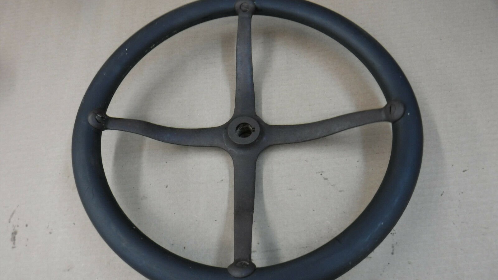

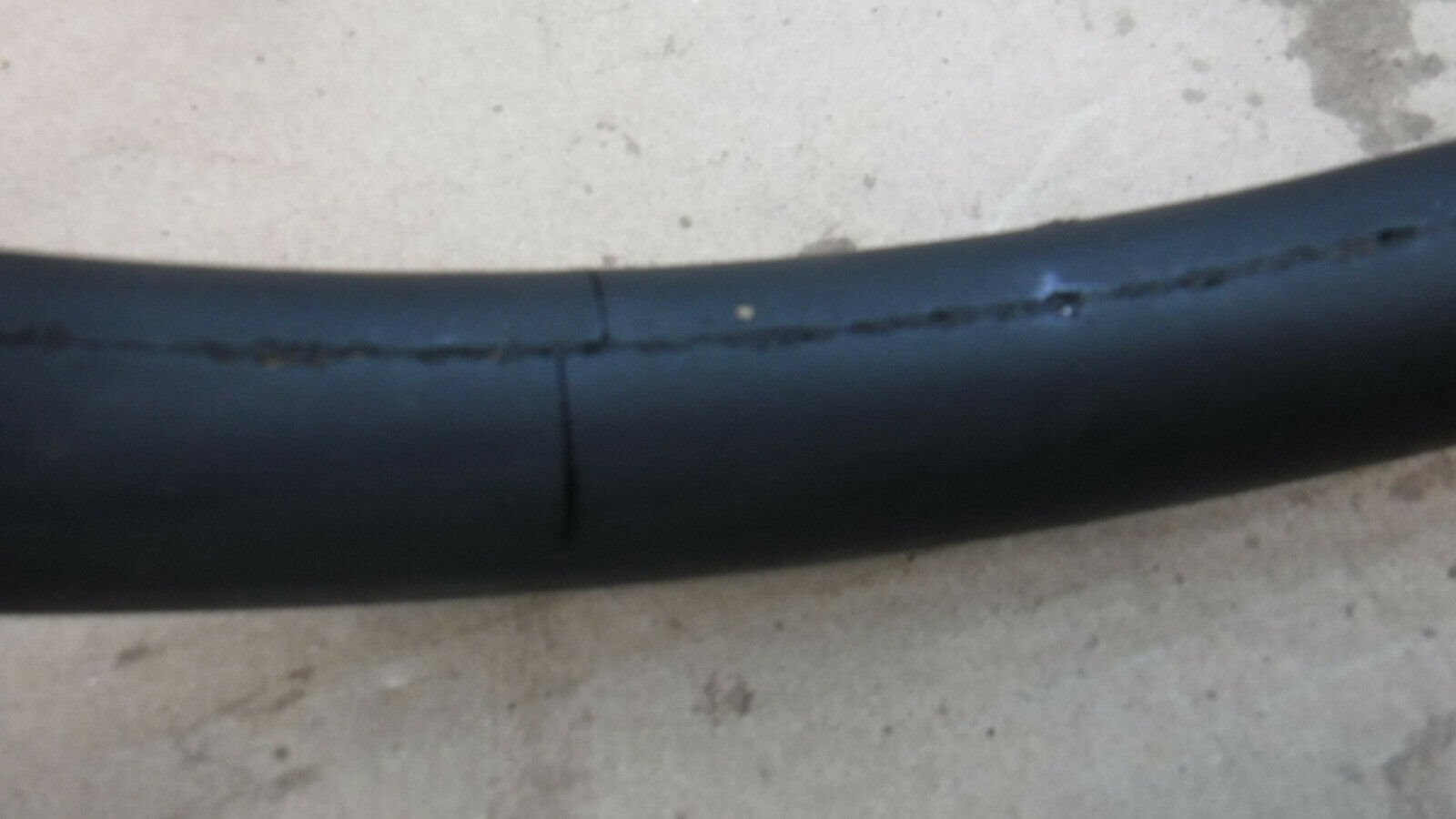

]Hi,
Newbie to posting , been lurking for years.
I have a 1919 coupe and the steering wheel is Fordite and it is cracking.
Been thinking about grinding out the crack and using JB weld.
This is a 15 inch wheel and has T902 and FORD in block letters stamped on the backside.
I would like to keep the original wheel on the car any help would be appreciated.
Thank you

Re: Fordite steering wheel repair
Your plan of attack should do the trick. Coat well with a SEMs brand flexible primer in thin coats before putting on the color and sand smooth.
Thanks Henry
I didn't know how this material would react to being ground on.
Looks like sawdust down inside the crack.
Thanks,
Thanks,
I have heard of a method, but have not yet personally tried, where folks take an irreparably broken Fordite rim and use coarse sandpaper or a wood rasp to make a pile of Fordite dust from it that they then mix with epoxy or other glue and use as filler for cosmetic cracks and dings after cleaning and roughing the damaged area thoroughly. It sounds like it would work well, as there would be no problem matching the appearance of the filler material to the rim under repair. As I said, I haven't tried it but I have a scarce 15" rim for my '20 that I plan to try this method on.

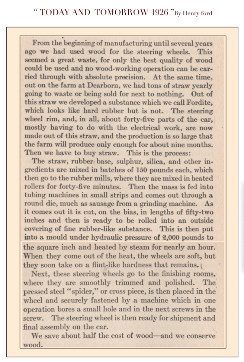

Here is an excerpt for one of Henry Fords books. "TODAY AND TOMORROW " published in 1926.
Best regards, John Page, Australia.
Yes,
I have searched Google for Fordite and came up with old automotive paint...
I have also read about it in Bruce McCalley's Model T book.
What is your experience with grinding on it.
Does it melt or cut / grind easily.
Thanks,
Randy

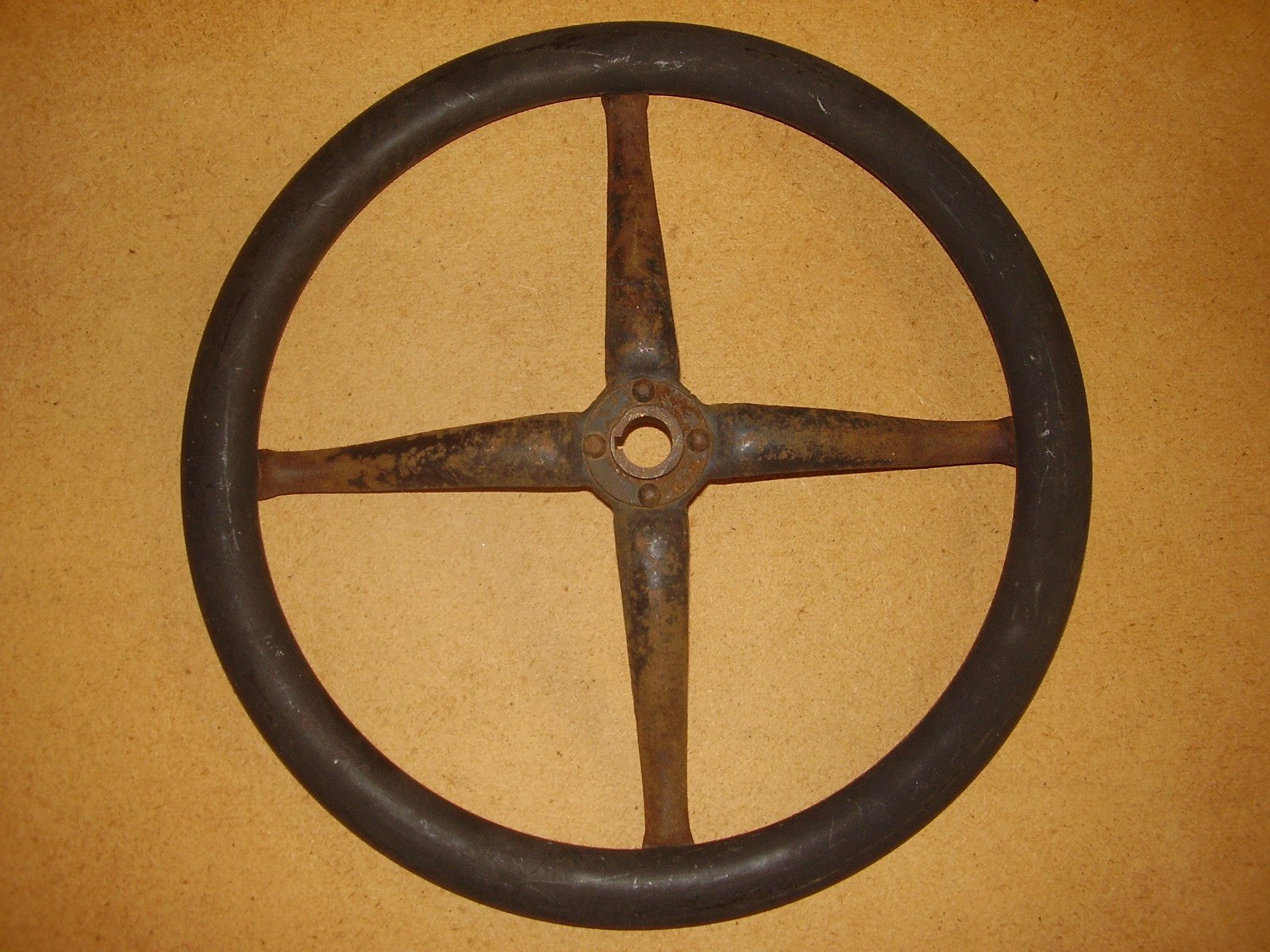

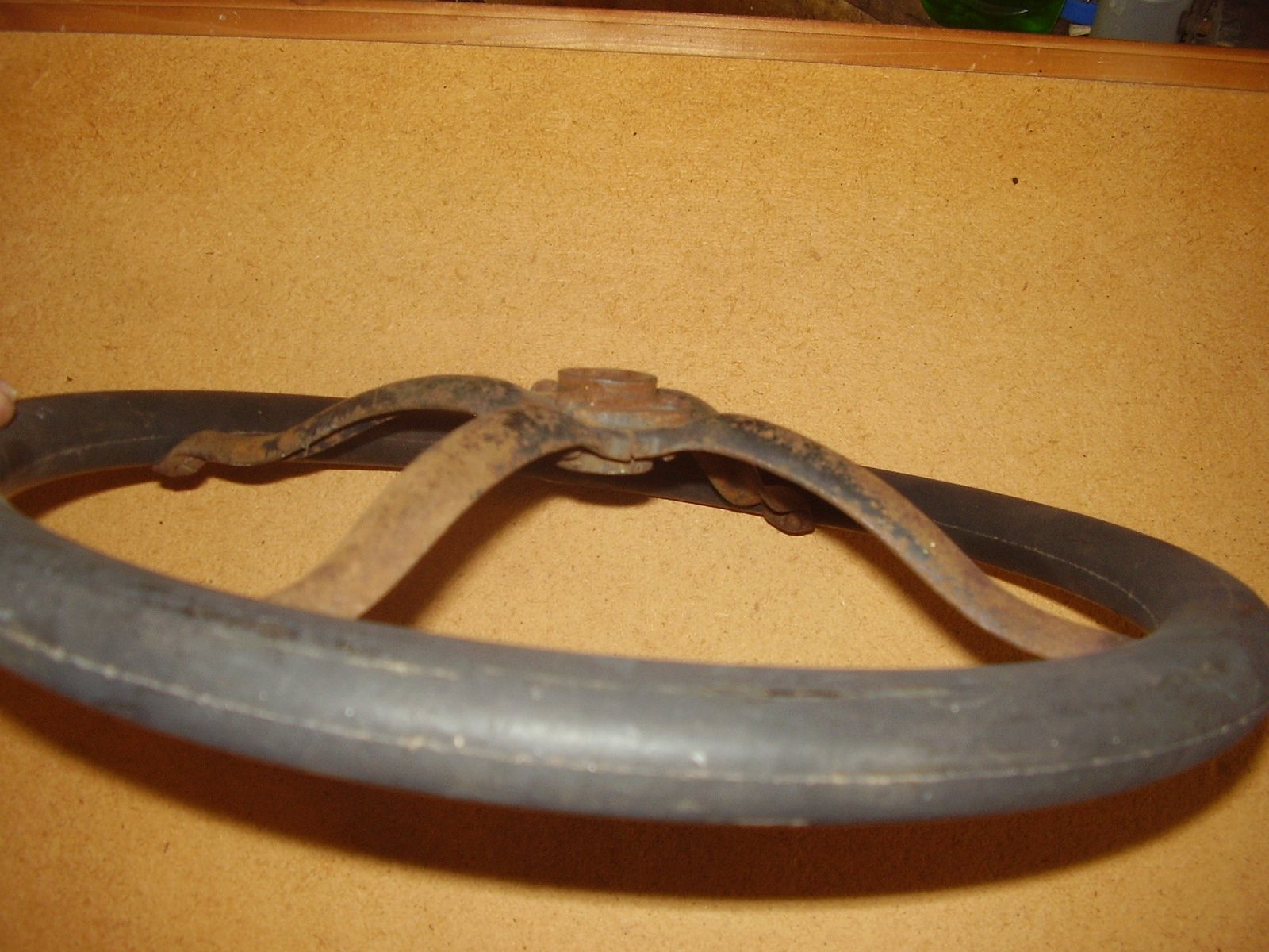

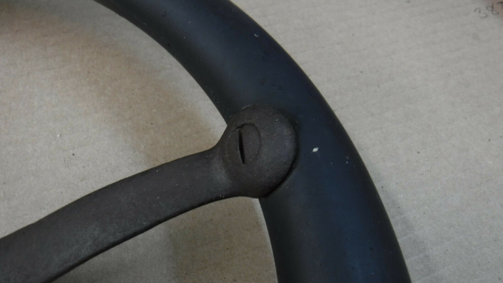

The 15" wheel that I have (actually I several) and which Steve T. cites is really quite unique. The pressed steel spider has a significantly higher profile, resulting in a deeper "dish", than the familiar 16" spider used in later 1920-25. When I was looking for one of these for my April 1920 touring, one fellow told me that that wheel was "Canadian." I found the drawing and release info at the Archives, and it was definitely a US production part, though it may have appeared in Canadian production as well. (FWIW, my dad's 1923 Canadian coupe, a true unrestored survivor, still has a forged spider, with the horn button of course.)
Here are some photos. Note the deeper "dish" in the side view. The rim looks warped in that photo but it's not; just a trick of the perspective.
Thanks R.V. Anderson for the photos.
The outside of my wheel has a line around it like yours.
Looks like you can see the inside material of the wheel.
There is also a line or seam / crack on the inside of the wheel.
This is what I was going to cut and fill in an attempt to make it stronger or last longer.
Just didn't want it to fall apart one day.
Thanks,
Randy

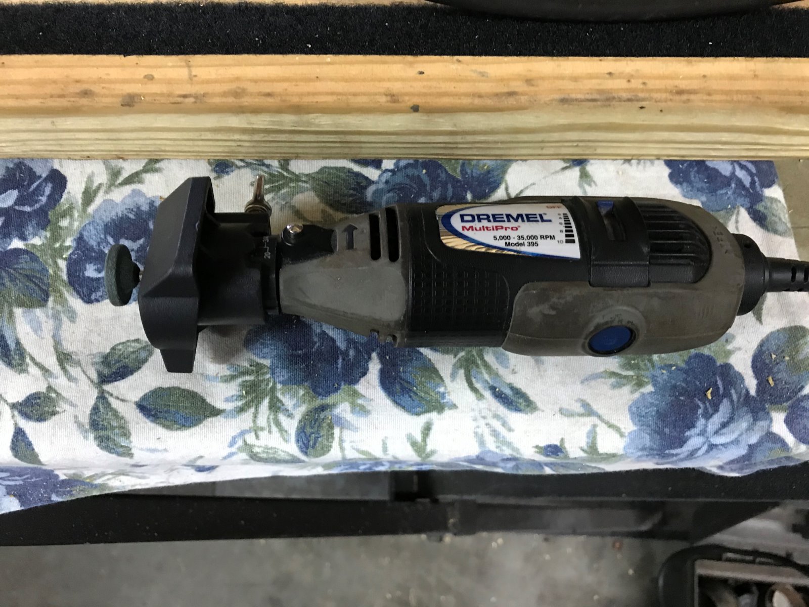

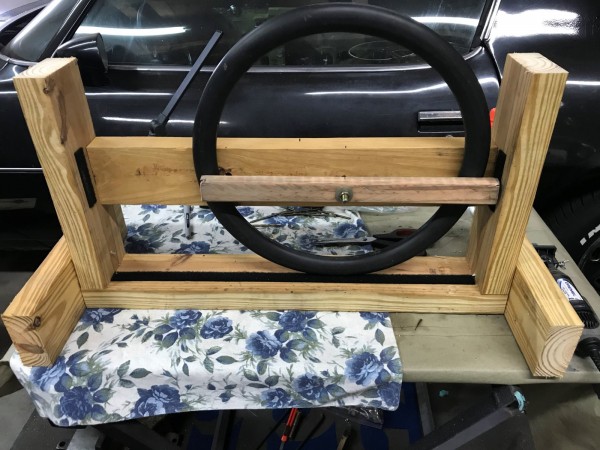

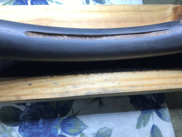

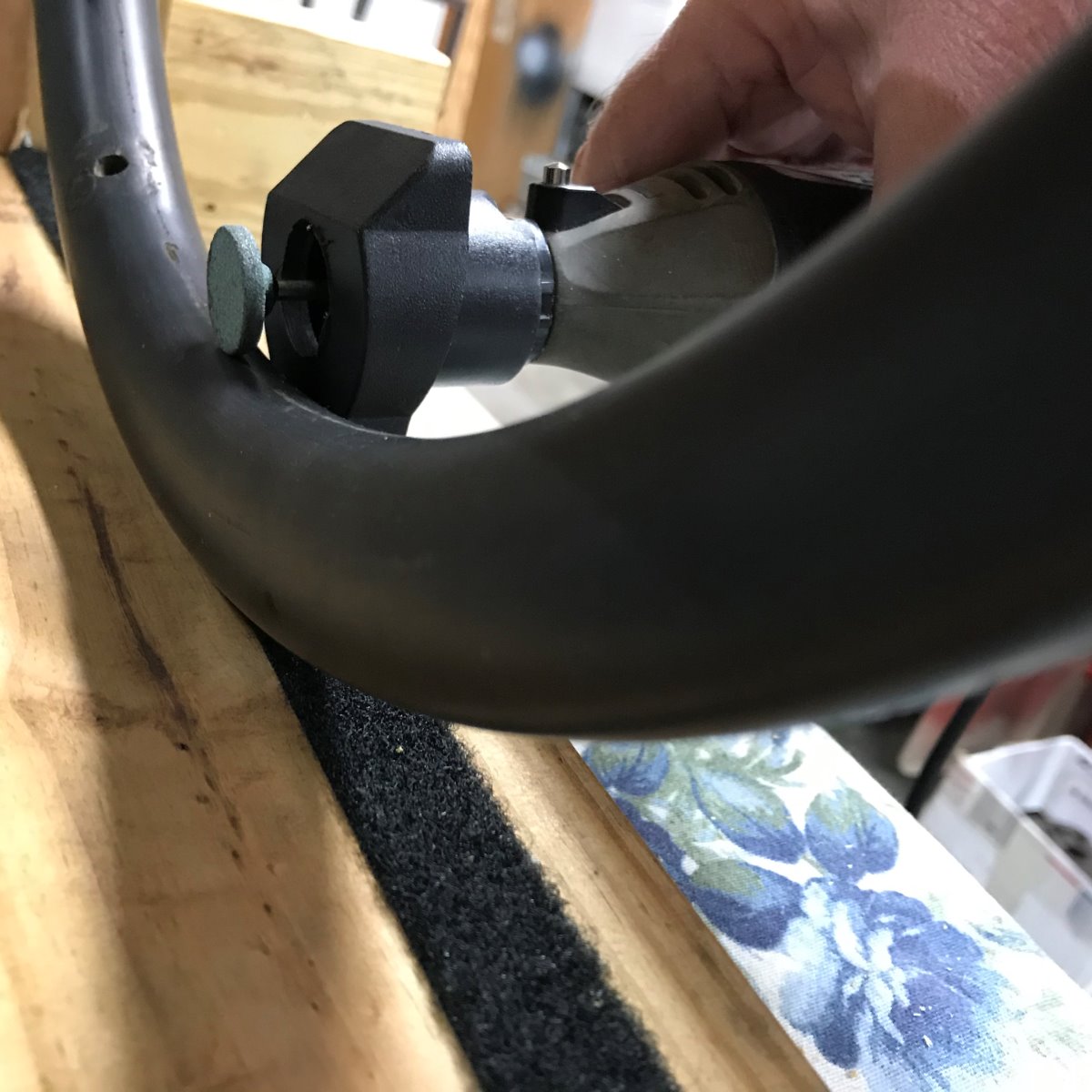

Hi again,
I made a jig to hold the wheel.
Started grinding out the seam crack to fill and sand.
Other than a horrible smell and lots of dust, seems to be going well.
Looking forward to the end result.
Thanks again for all the info.
Randy Hilyer
