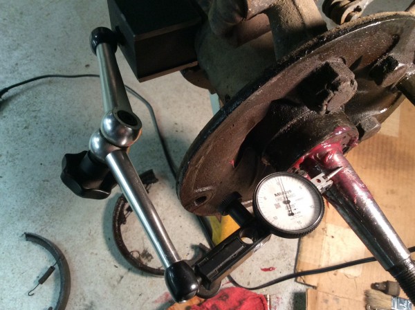

Well I found the problem was a bent axle. Looks like I need to rebuild rear end.
I have a Ford bearing sleeve from the other side. I measured the thickness of an unworn area. It was the same thickness as the reproduction sleeve.
John
