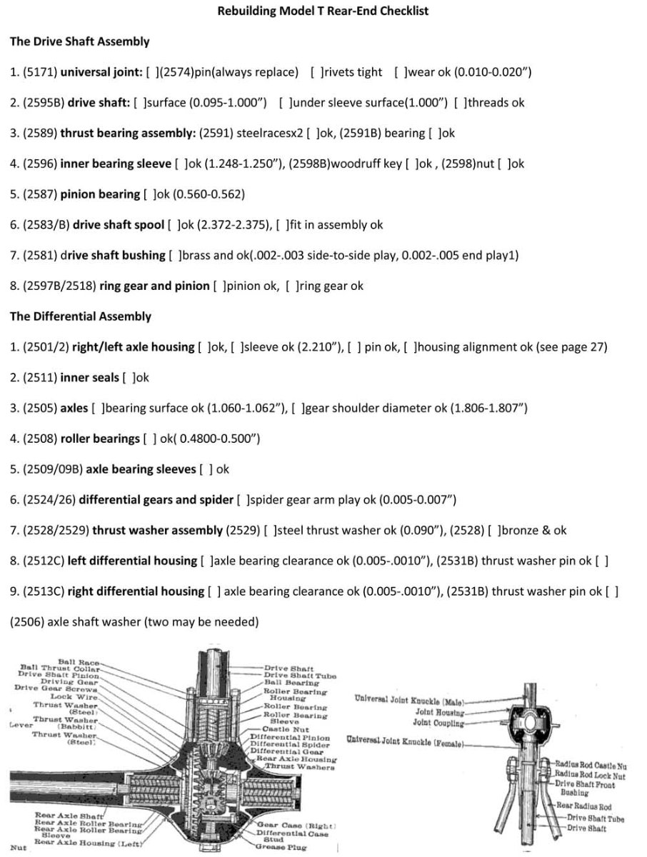

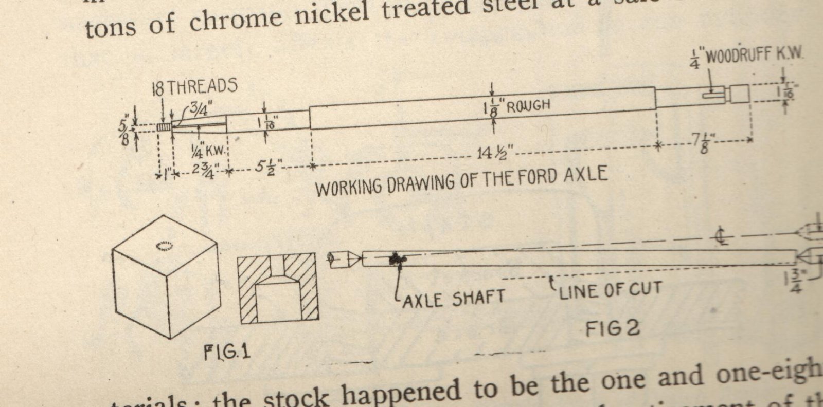

What is the standard and minimum diameter of the axle shaft where the Hyatt rides !
- Posts: 5597
Re: What is the Axle shaft diameter ?
1.062, I believe.
- Posts: 6587
From previous authors 1.060 -1.062

Thanks for the replies !
I have the books now, but the one spec sheet is much handier
I measured 1.060 on my only Hyatt location, the right inner of my Ruckstell.
The bearing measures .497-.498, most on the larger side and smooth and even.
Have early safety hubs and bearings on the outer locations.
