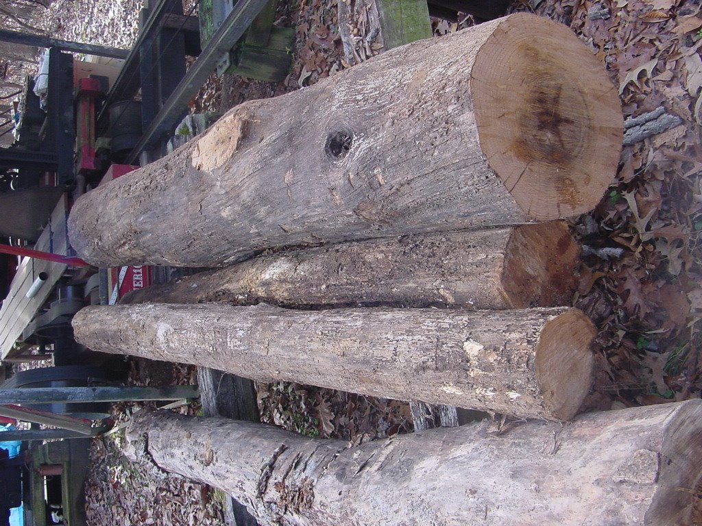

I will just call this a build thread.

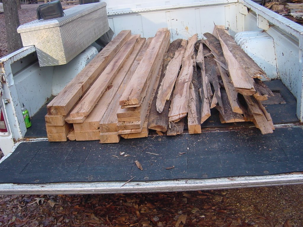

I must admit,speedster kits come about a little differnt around Mack's Garage.
First, the family buys land in 1969 with a bunch of trees on it and then 1 of them dies about 2010 and falls on a nieghbors fence about 2017
Then I bring the logs out from the woods and they lay around a while longer.
Do you see a speedster yet? :D

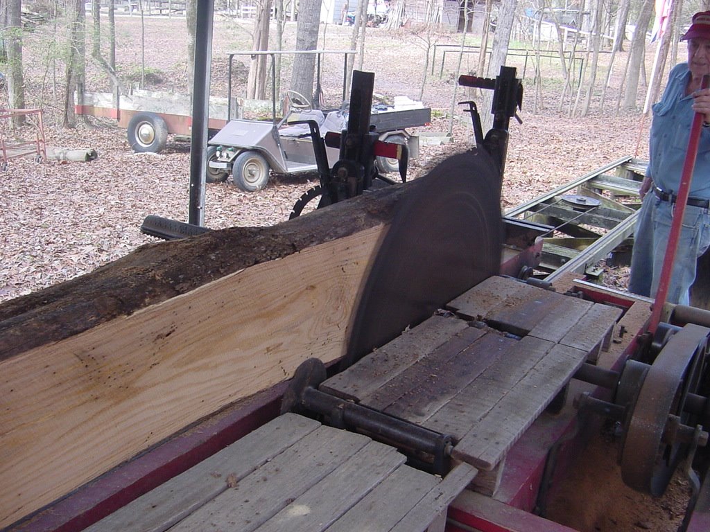

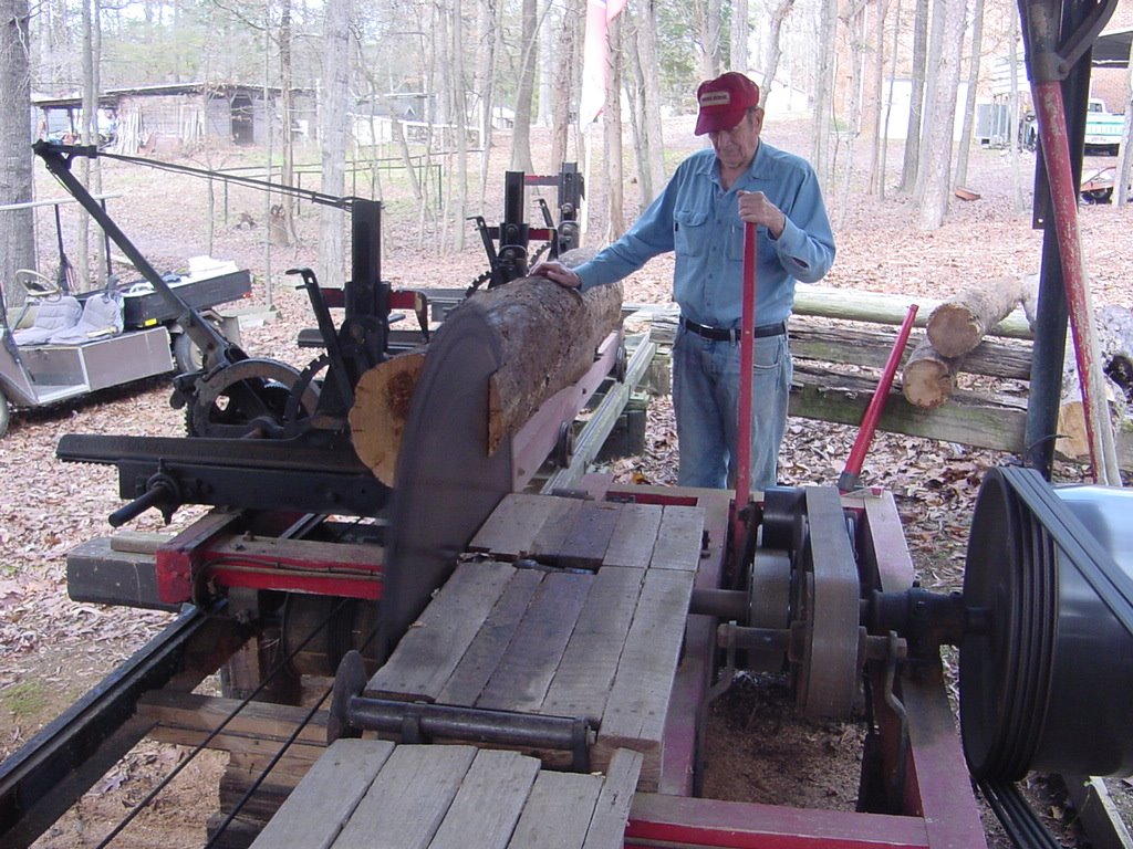

My dad sawed the biggest log to make sure I got about 5 2x4's and the other stuff I felt I needed. I have about 14 1x12's already cut but for whatever reason the guy that sawed them for me did not leave any 1x4's or anything.The log I got them from was WAY to big for me and my 85 year old dad to handle.I actually had the guy come up with his Caterpiller rubber tired loader to pick it up.It wa about 22 inches accross and green.
.But we managed these.You wouldn't think anything useful could come from these logs.
So now I should have enough lumber to make the speedster body for sure.
I sawed the 2 small logs myself with my dad offbearing the slabs.

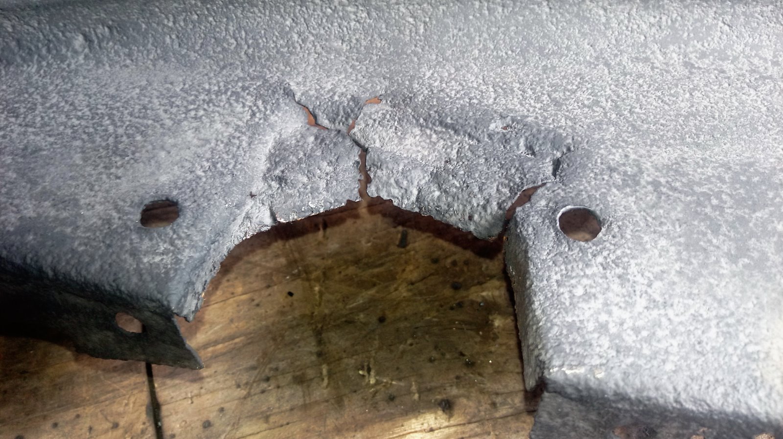

I took the fenders,and trunk and stuff to get sandblasted this morning.I am trying a different company this time.May not have been a good idea but we will see. he quoted nearly 300 bucks for 3 fenders,4 running boards, the trunk,splash aprons radiator shroud,and running board brackets for the chassis. Said the rust was old and heavy.DUH< it is 100 year old stuff! There was a 55 ford truck cab being unloaded as I was unloading.They do alot of car parts.
That was my entire budget for January nearly was the 300 bucks! Hopefully ebay sales will pickup!

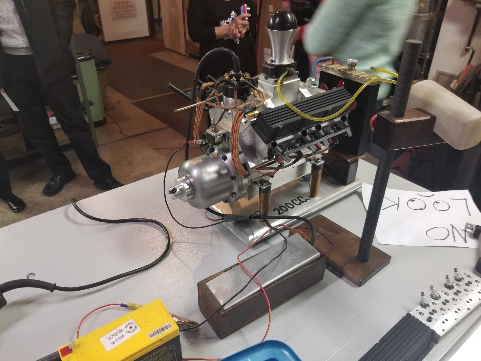

Well,actually I do have a freind that builds his own model engines,like a working model of the 4 cylinder Snow engine and such.He has ask me to come help him cast some aluminum parts for a project next spring.
If I was younger,I would be building me a daily driver in my shop. Cab and all.But i aint in the shape to do it now.I just piddle.
If I had my shop and plenty of money in my youth,I woulda been turning out a lot of wierd stuff! :lol:

A friend built this V-8 from scratch. Sparkplugs and plug wires are the only thing he did not build. Oh ya, the radiator is a heater core. Over 2000 hours to build it. Running race fuel in it and it has that V-8 sound.

Love it!

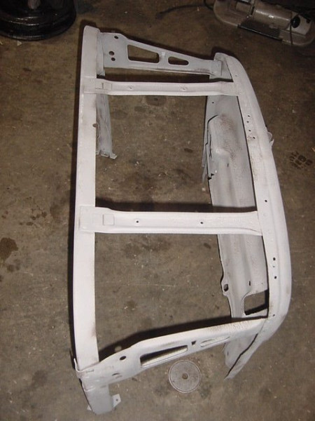

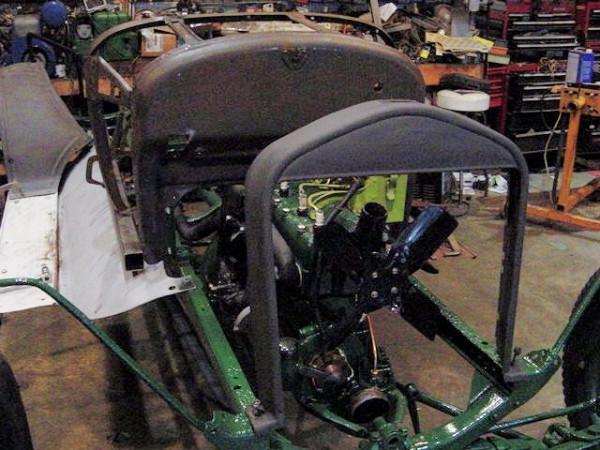

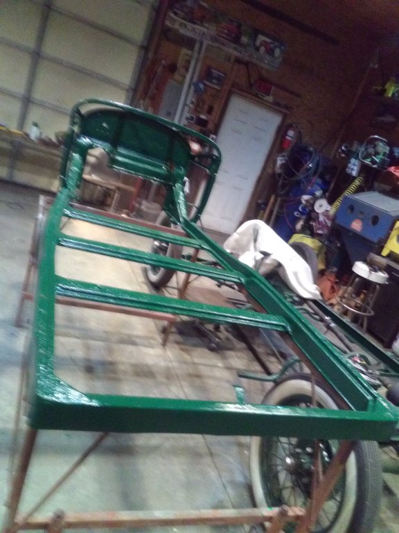

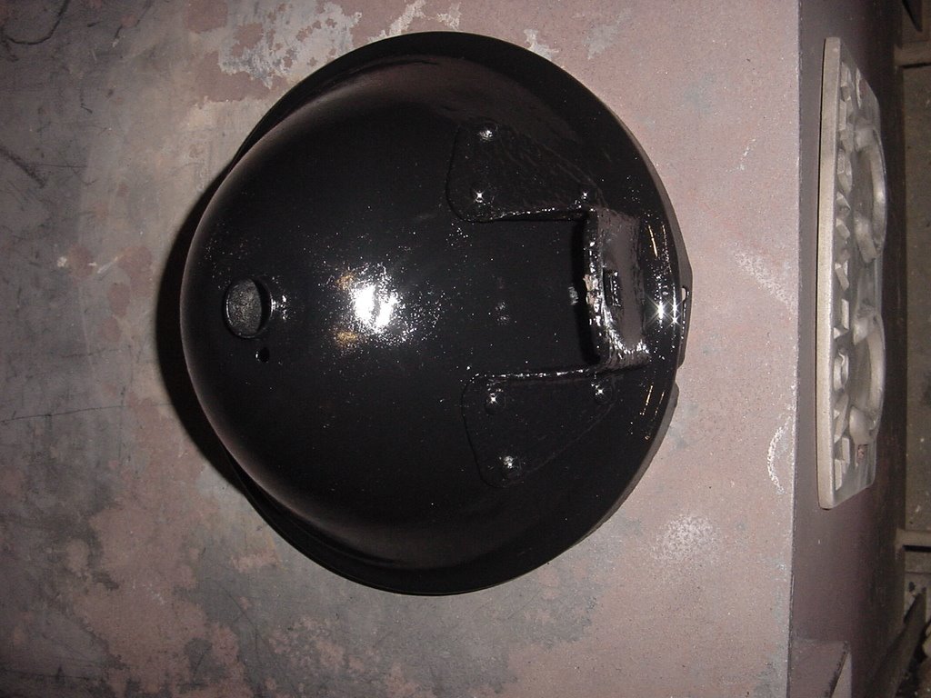

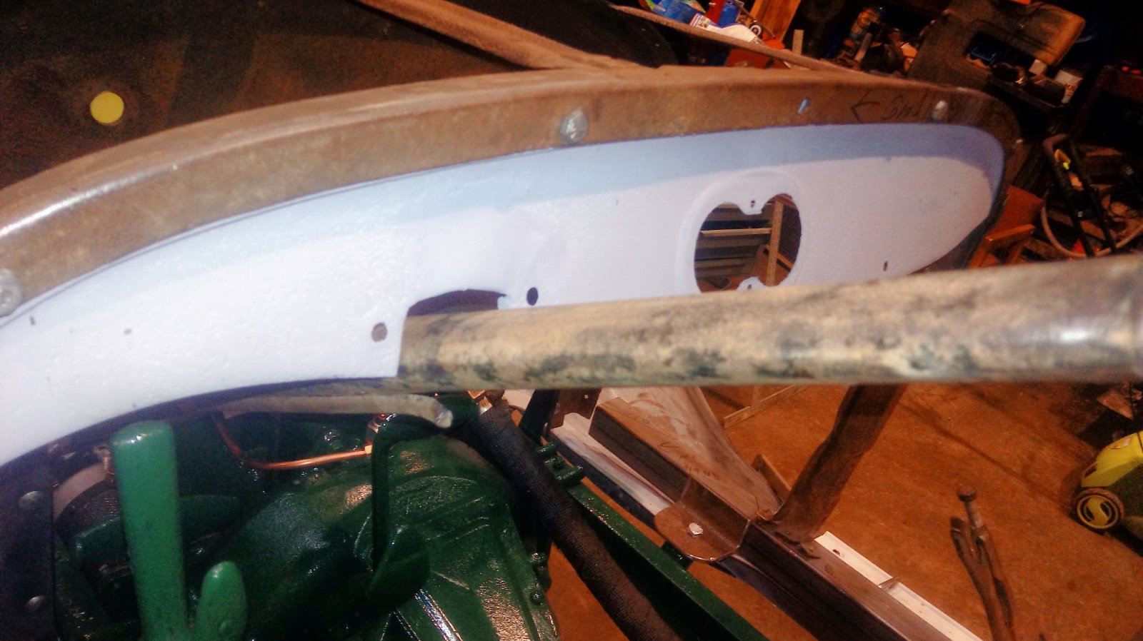

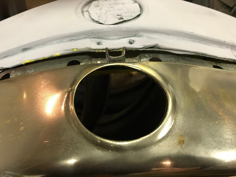

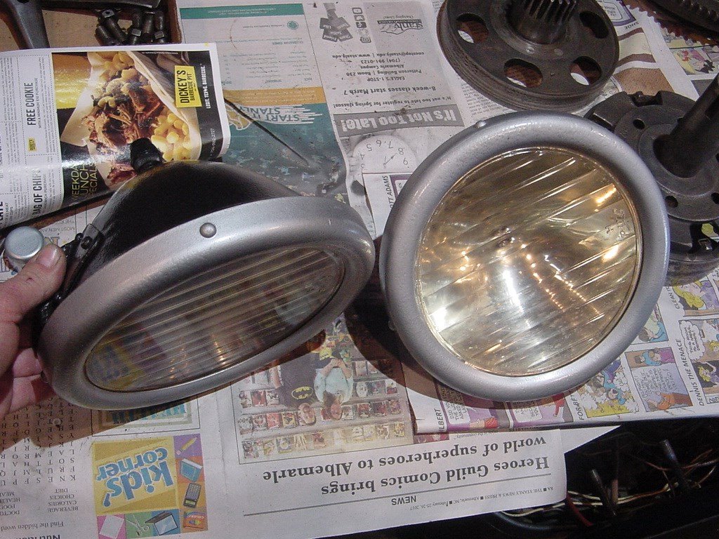

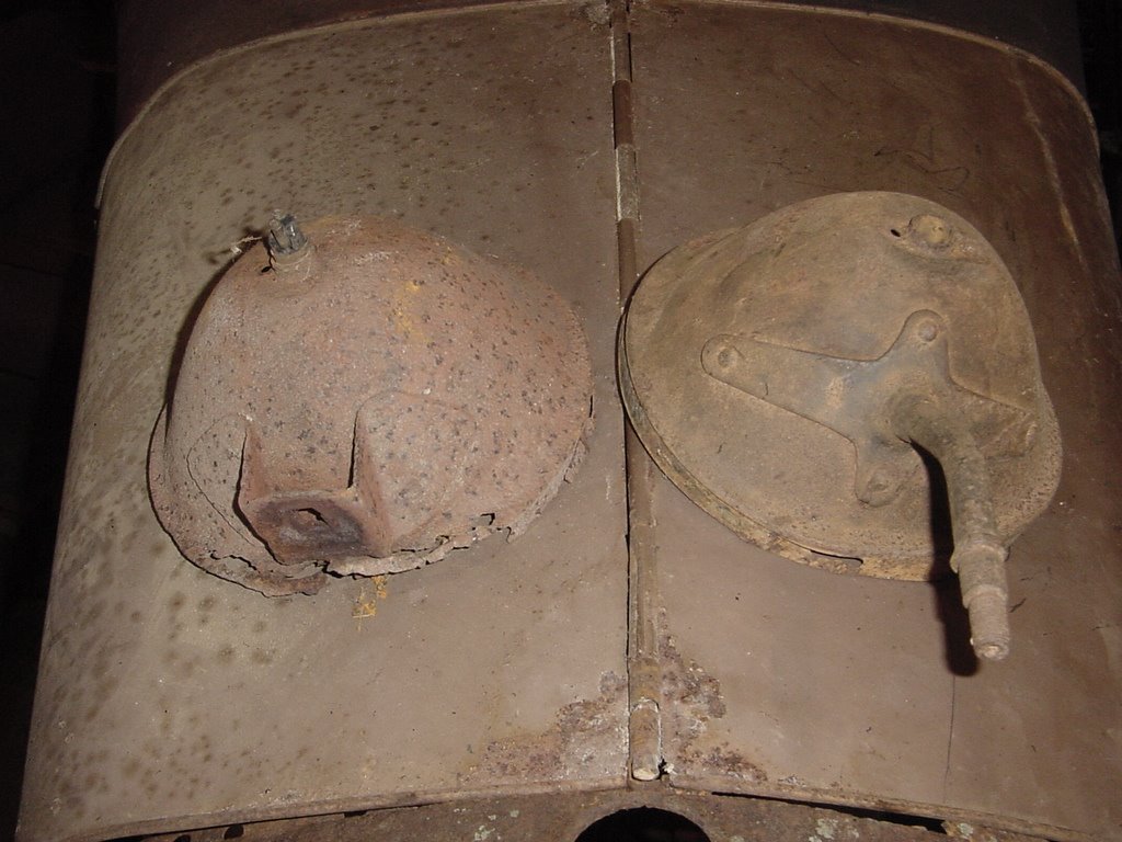

I have just been piddling on this project the past couple weeks. Finally after alot of head scratching,decided to try to use the original cowl that came with the 26 chassis.I found a decent 26 hood in my stash I have NO idea where it came from or what But that and the cowl will fix me up.I only have 1 high radiator and the old radiator shroud which is rough but I will see what I can do with them.

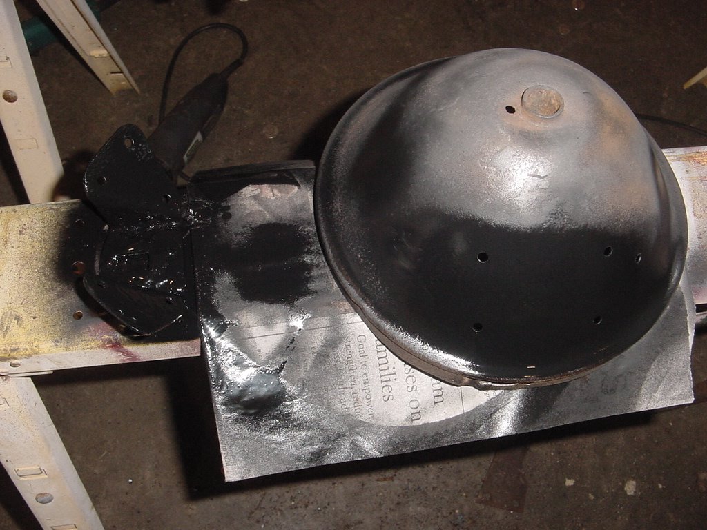

In the mean time,I wanted to play with head lights.The buckets were shot,the bar is usable along with the brackets on the buckets.
So here is what I did.

I am covered on the headlights.I had the 2 buckets from the 26 chassis and several of the normal older type and I have both brackets installed on both buckets now.Gota put 1 in the electrolosis bucket and clean it.By the way, I did rivot the brackets on the buckets, not bolts.I went to Tractor supply and bought a little box of rivots used on sickle bar mowers and had to cut them off a bit.
I kinda changed my direction on this thing to include as much of the original parts that came with the chassis as I could with in reason.

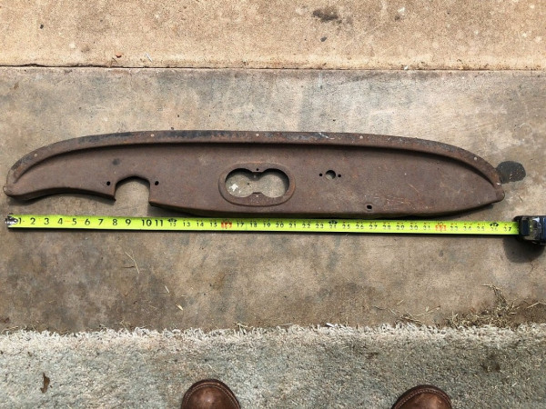

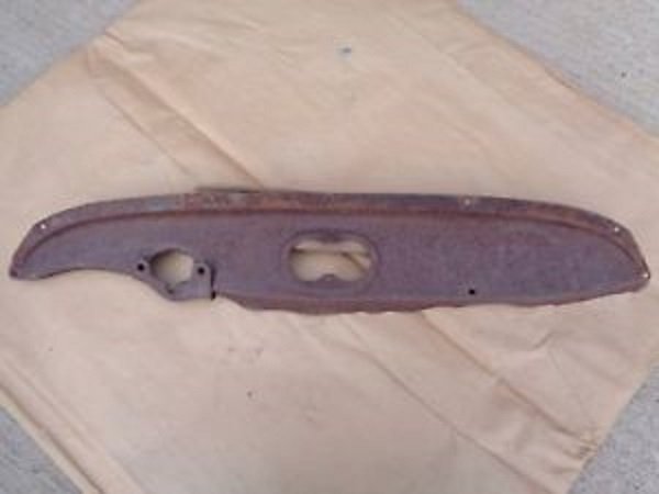

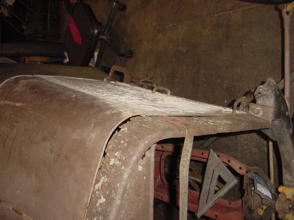

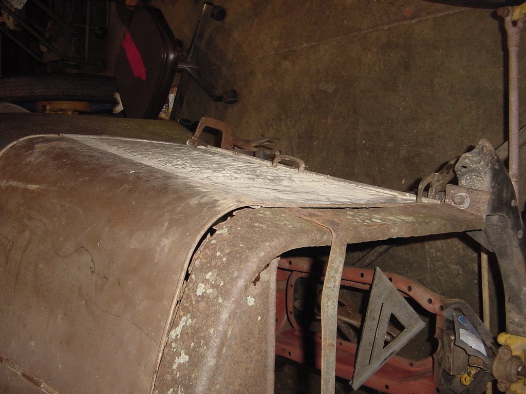

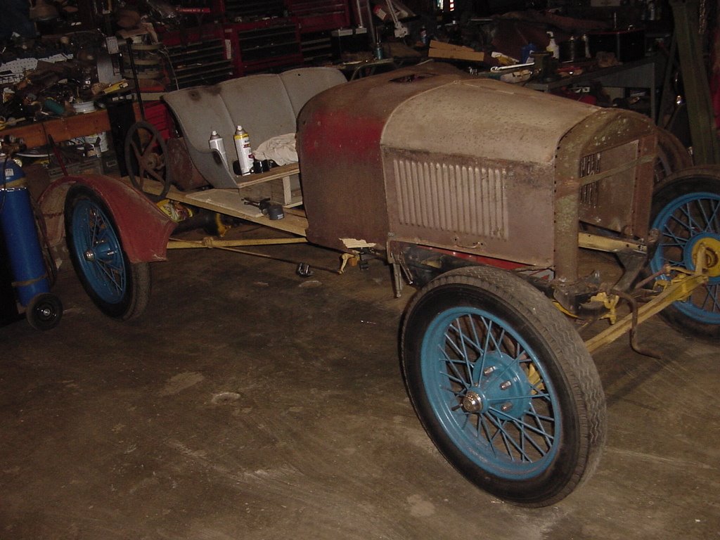

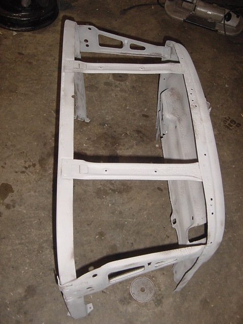

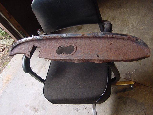

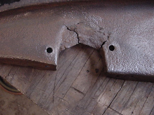

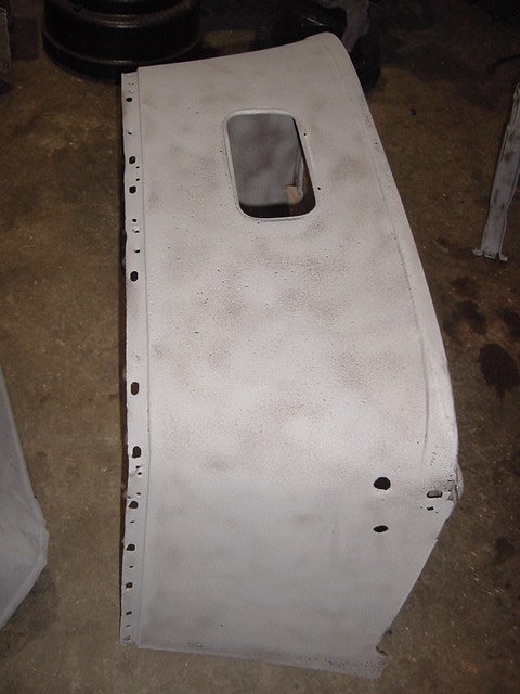

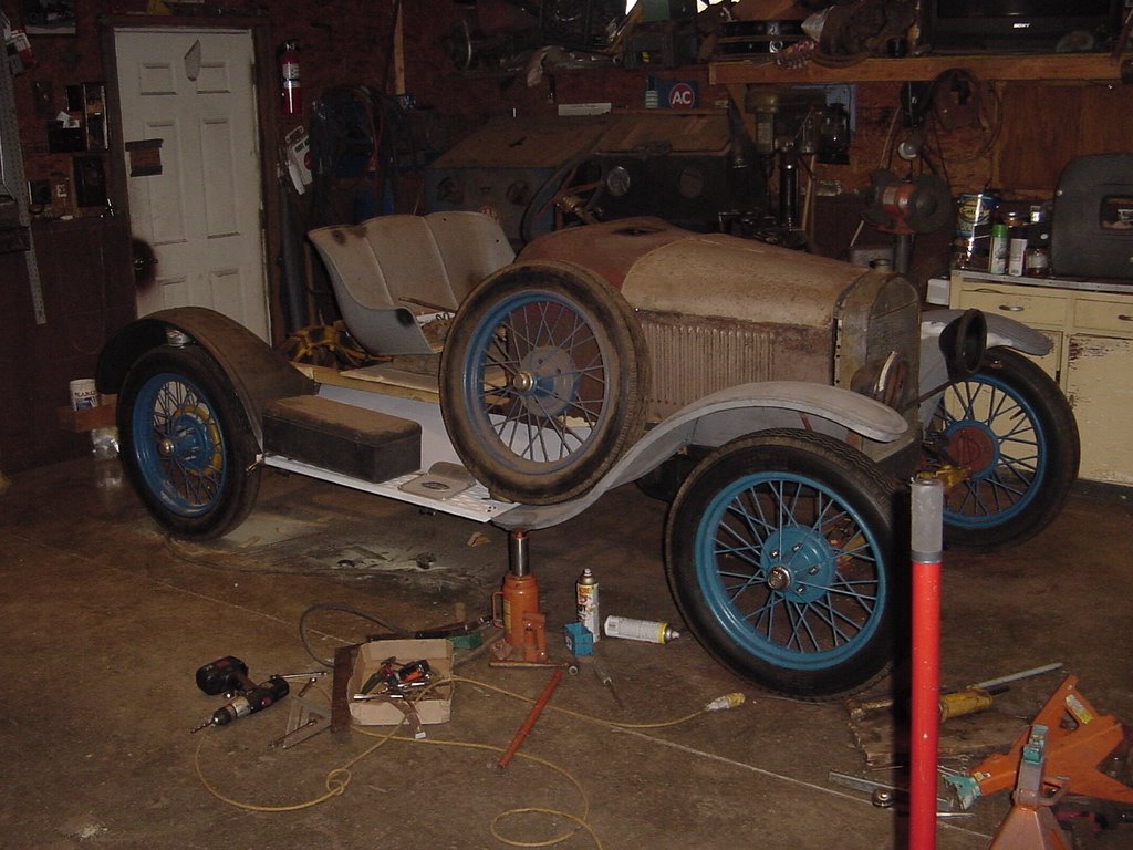

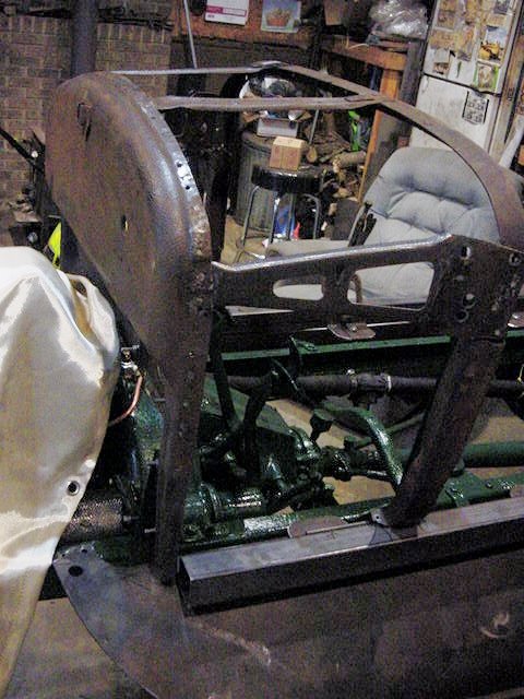

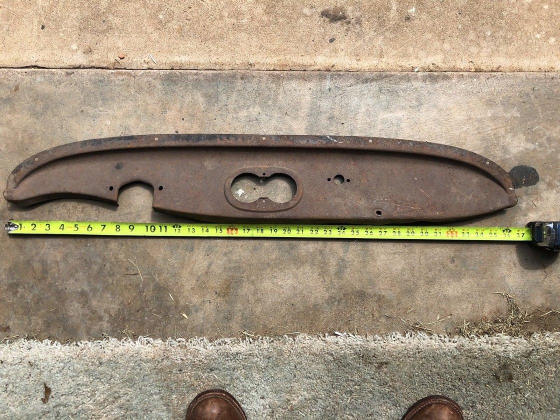

I thought I would post these so folks might could help me fiqure out if by some chance this is the right shell or ?
Anyhow,this cowl sheet metal came with the chassis,this hood was in my stash,the shell,close as I could find in my stash.
I aint sure if it is right and it is about rougher than even I want to tackle.
Bear in mind I will be using 25 style fenders and such so that won't be a match to this sheet metal but I think I can make all that work,it is just the rad shell I am concerned about.Thus the reason I posted a ad for a cheap 1 that I will Know for certian is for the 26-7 application.
Posts: 4411
Re: Speedster build.
Post by Wayne Sheldon » Sun Jan 12, 2020 3:43 pm
That should make a fine speedster! I don't think that shell looks too bad. Although a better one would take less time to rework and make nice. The fit between it and the hood and cowl looks good to me.
I wish I had a better shell to offer, but almost everything I have is low style, too early. The only high shell I do have is a '26/'27 nickel plated one in terrible condition. Bent, broken, and upper panel missing. I do have a project I was planning to use it on, but that project was set aside over ten years ago.

I have two high shells. The lacing holes for the one being painted has notches and the nickle one are round. I tried to line up the sides as best I could. There is a noticeable difference in the crown (see photos). Now my shells aren't perfect but wouldn't this difference cause a hood to sit differently on a shell assuming the side panels were freely hanging.

Post by tdump » Sun Jan 12, 2020 6:21 pm
Thank you,that is what I needed to see,so there is a difference in tje 2 shells
Thank you for posting those 2 pics.Now I know that I need 1.
This shell is not to bad,but I would hate to fix it and it not fit.
I have a perfect low shell with it's little piece along the bottom and a really nice radiator for it.But the hood was going to be a night mare.I had worked on that problem a couple years back.Trying to extend a few pieces of old hood panels I had laying around to make them a 1 and a bit more longer to line up with the wood fire wall. After messing with this thing and hauling my T pickup on the trailer last week,I decided that wood firewall was just not strong enough. I watched the steering column on my pickup kinda shake some times.Made me think,"Hum,wood wouldn't take that much." I am going to put a steering column brace on the pickup as soon as I can figure out why it won't lay flat against the firewall and lay on the column correctly at the same time. :? Same was happening this speedster column,the brace will not fit correctly on both ends with the plywood firewall.But with this 26 cowl,it has a brace built into the dash panel.Problem solved.

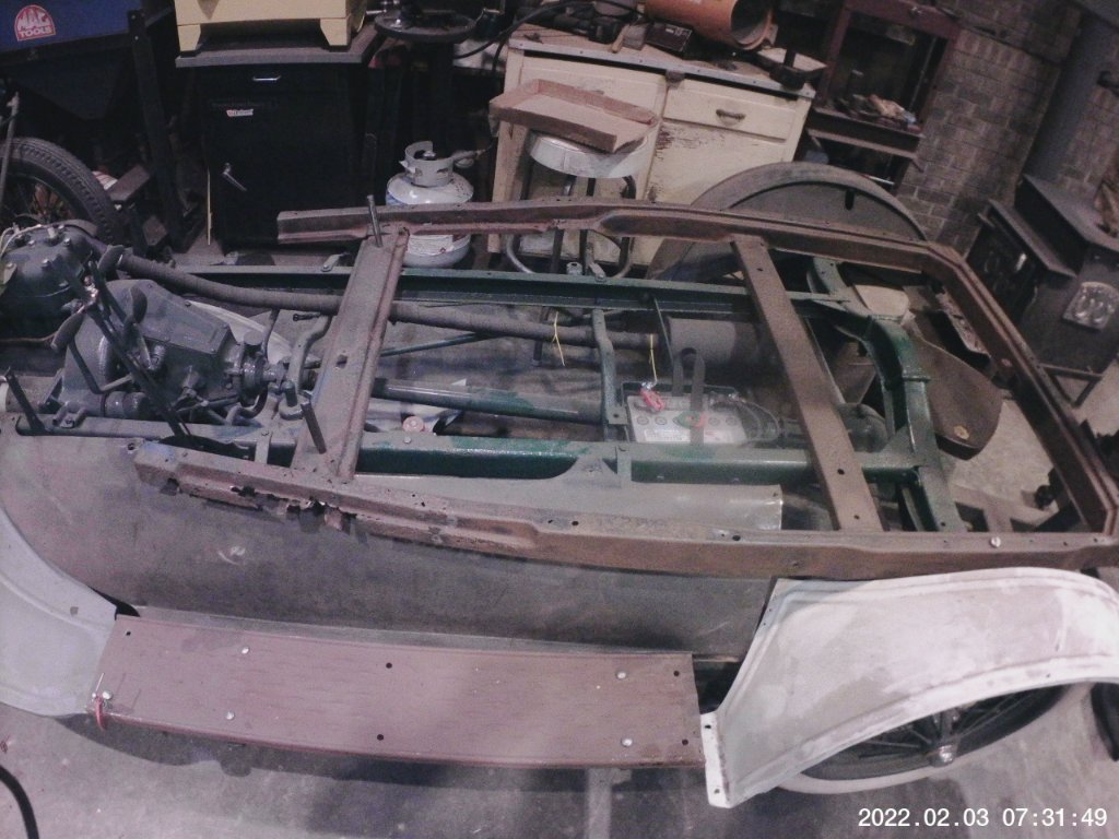

Post by tdump » Sat Feb 01, 2020 6:23 pm

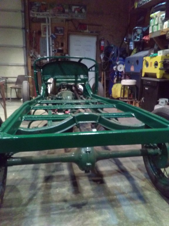

Well,here is a bit of progress. Can't see it really but the front fender mounting has been figured out, new king pins and bushings and all the cotter pins in the front end. Figuring out lay out of the rear fender as I want them lower and more centered over the wheels than stock.running boards will be shorter as well as the splash aprons. All the parts I am using are not of the fineist quality so it is not like I am butchering good parts.this stuff was RUSTY and is pitted,cracked and bent. Alot of work.
BUT it will come along.

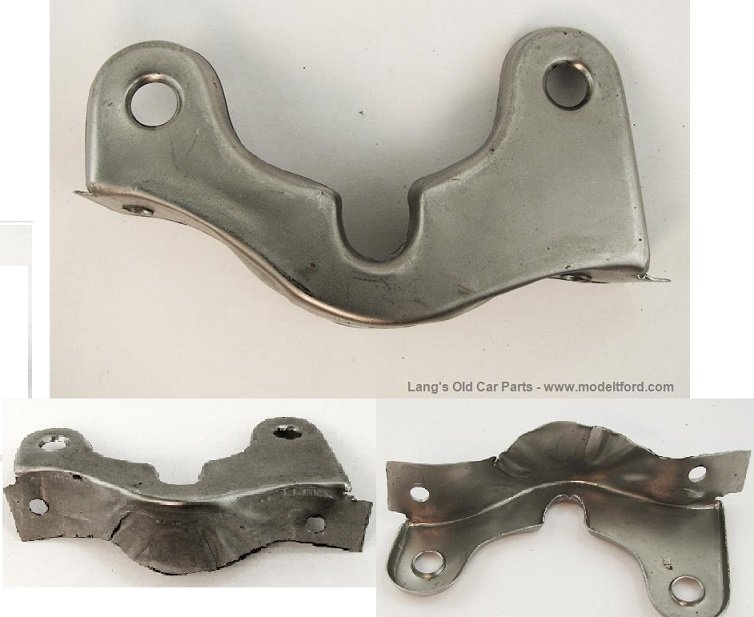

I am not in cahoots with any Model A folks but if I had 2 old spare tire wells from 28-9 model A it would sure make another idea alot easier to make happen. :D

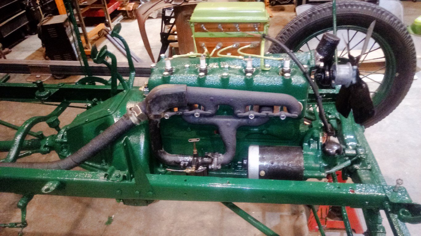

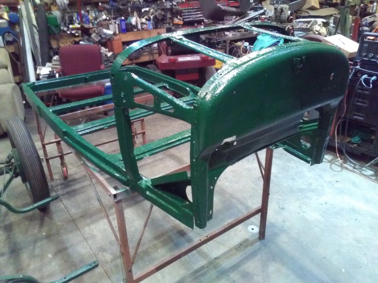

Post by tdump » Sun Feb 23, 2020 5:58 pm

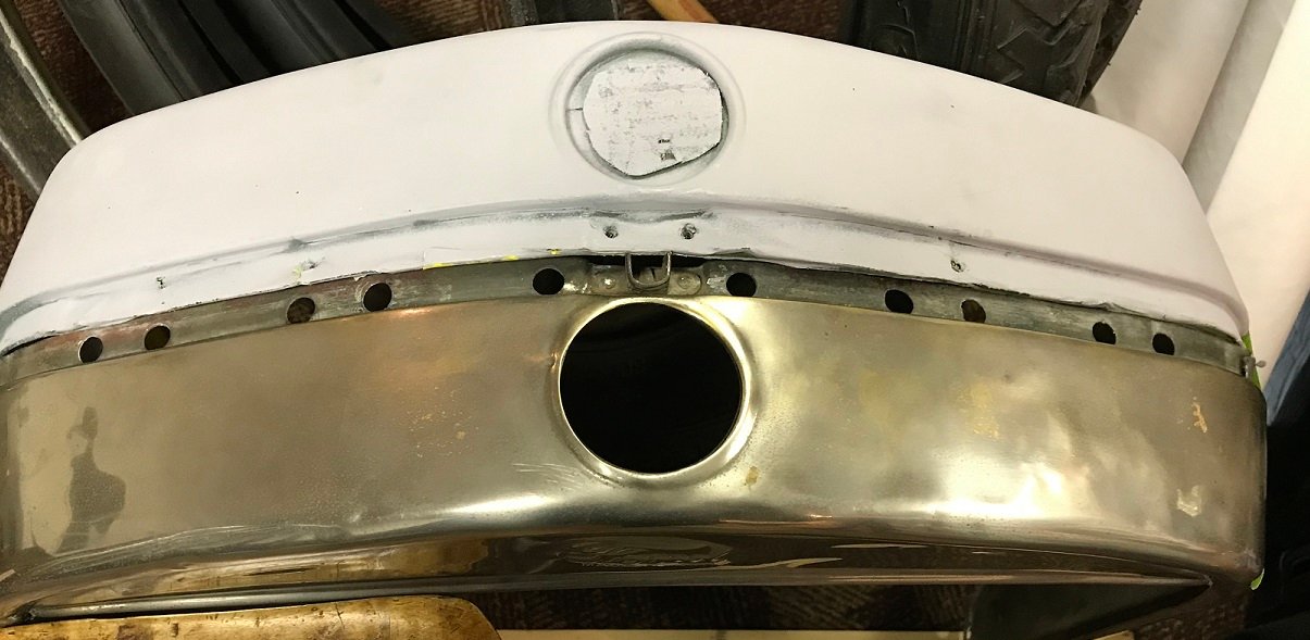

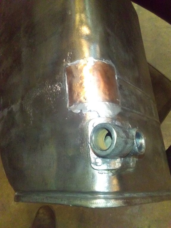

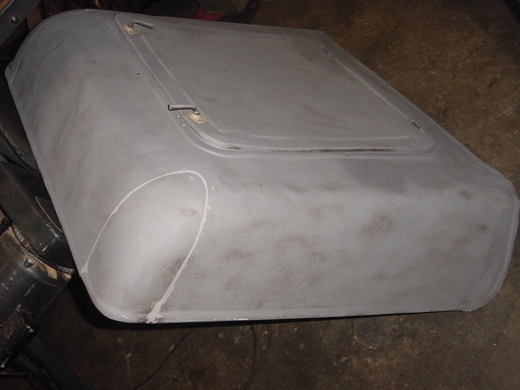

Well that steel shell that didn't look real bad after a few days in the electrolosis tank ,i think most of it is still in the tank!
I found a brass- was nickle plated shell in my junk that was BADLY bent and had a hole in it and such.I have pecked on it some and brazed the hole up. If push comes to shove I will finish it and paint it and hope for the best.
Head light buckets are painted along with rims. Just using regular paint,nothing fancy.
Tax refund is coming next week,and I have my parts list wrote up but I can't go broke! I will get some of the parts I need this month and some next month.
Removing the old bushings is all that is left to do before the transmission can be rebushed and put together.Had to scare up parts from 3 different 1's to get usable parts.
Starter is ready for it's new rear bushing,generator ready for a insolator and new cutout. I got all new stainless valves in the engine last week.
Shame I had to change the old 1's they were perfect shape,like they had never been run,ANd my adjustment was MUCH better with the old 1's. The new 1's are short and didn't allow me to get a good adjustment,I think most are around 15 to 18 thousandths.
Just alot of small task done.

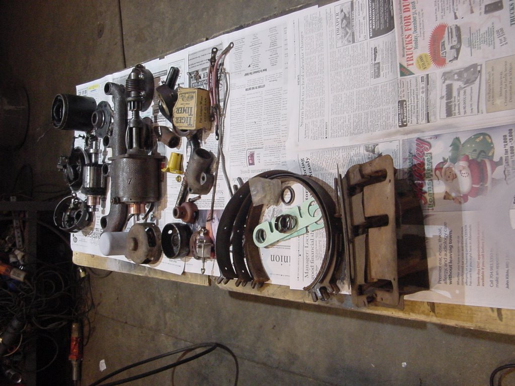

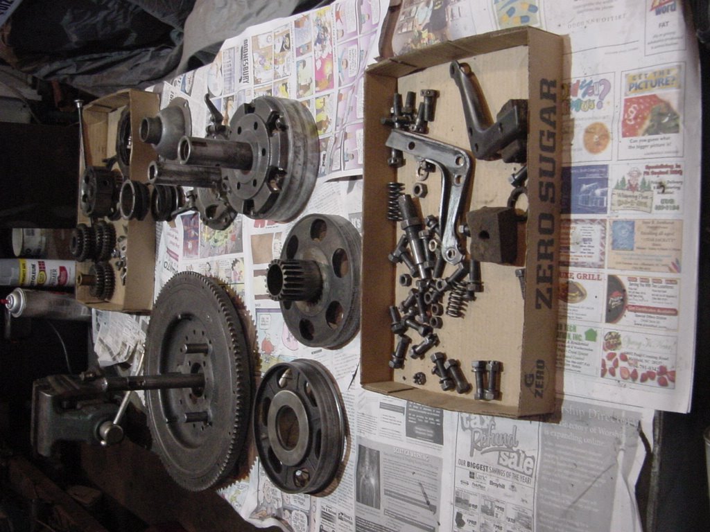

Well,I got my batch of parts for March work saturday. Will be able to fix the transmission and mount it up in the coming weeks.I got the screws for magnets and bushings for the transmission and the little peices for starter and generator and such.I will be able to make visable progress this month. I thought I would show the final appearence on the headlight job.

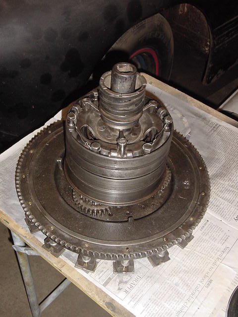

Post by tdump » Mon Mar 16, 2020 10:36 pm
Well I have a nice little hernia now I think from picking this thing up and putting it in the press to compress the clutch spring.
But at least this part of the jig saw puzzle was assembled over the weekend.
I know my methods and such can't produce a 100% back to factory spec transmission.BUT the way I figure it I took parts and made a good transmission that should in theory operate like it had a few 1000 miles on it. Perhaps not "perfect" but functional. and affordable for my very limited budget.

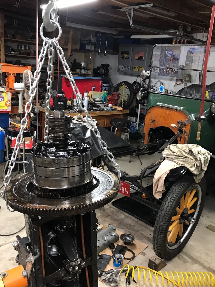

There are 2 questions I need to ask, this thing is heavy,I actually did hurt myself lifting it. I have a shop crane,a chain fall and the engine is on a stand although I will need to level it as the engine is tilted back slightly.
How do you safely lift the trans on and off the engine for setting the air gap?
And my dad ask a good question, what keeps the brass screws from backing out slightly when you peen the backside? Which i know I need to do yet,but since he ask, and I couldn't answer,I figured i would ask here.

Post by Wayne Sheldon » Mon Mar 16, 2020 10:54 pm
The brass screws should extend about 1/16 inch or only slightly more beyond the surface of the gear. A simple light hit or two with a medium ball peen hammer should be sufficient to keep the screws from backing out. Ford factory used a "waffle" punch, which gives a better spread. A center punch could help also. However you chose to do it, the screw should be spread SLIGHTLY to where it exits from the ring gear. It should NOT be beaten down or hit hard! That could result in a fracture of the ring gear, or the brass screw below the surface of the gear which could allow the peened end to fall off and allow the screw to back out without warning. You don't want that!

ok, thanks . I finally got the engine on a stand that it is level on instead of leaned back.
So now I am trying to figure out how to safely lift the transmssion.I am not in pain but that little knot that has come up in not so good a place is letting me know it is there and does not want to be disturbed. :o
Posts: 4411
Post by Wayne Sheldon » Tue Mar 17, 2020 7:04 pm
Always be very careful with lifting! I have never had any real back problems, and often lifted things one shouldn't. However, I have known many people with serious back issues, including my wife, my father, and two of my longtime best friends (one missed my wedding 43 years ago because he was in traction at the time!). As I get older, I find I can no longer lift or carry many of the things I used to.
Ramps, levers, any sort of hoists, and hand trucks (dollies), are all all your friends! A little creative placement and leverage can work wonders! Be careful with things like come-alongs and ropes with pulleys that whatever they are attached to above is strong enough and secure! Also make certain they are not lifting more than they are designed to! (Come-alongs generally are not rated for direct lifting, but actually can if proper care is taken and the pulling cable goes at least two turns around the ratcheted shaft.) We don't want transmissions landing on your foot, or worse. A "two ton" come-along should NEVER be used to lift more than about three hundred pounds! Horizontal "pull" is NOT the same as "lift". (That is why the manufacturer's lawyers say "never used to lift".)
I don't use it very often, but my Harbor Freight heavy duty engine hoist has paid for itself several times over. The biggest problem with it, is that it really doesn't lift high enough. A roughly four foot lift can't reach a three foot high workbench with a foot and a half tall motor!
Be careful my friend!

Best way to handle the trans is to use a ring with three chains hooked into the Magnet bolt holes.

so you took 3 brass screws out of the flywheel and used those holes?
jsaylor
Posts: 445
Last Name: Saylor
Location: Citrus Heights, Ca
Post by jsaylor » Wed Mar 18, 2020 2:51 pm
Yes. I took some "S" hooks from the hardware store and bent one end and hooked into the magnet, ring gear holes. For the ring on top make sure to get one rated to hold the weight. I think the one I found was rated for 900 lbs. Open the end of the chain up to put on the ring and close. I took this shot when i was taking the transmission off for rebuild.

Post by tdump » Wed Apr 15, 2020 8:17 pm
No pics at this time but engine is in the frame.
I got a good repairable radiator shell today in the mail ! Thanks Dale!
Made a good trade on a reverse eye rear spring that will be taken care of as soon as all this stay at home order thing is history.

Post by dlmyers » Thu Apr 16, 2020 9:16 am
You're welcome, Mack. I'm happy it's going to be used.
The old forums are a gold mine of information.

No pictures but the transmission hoghead is on,starter is on and it sputtered on a quick squirt of starting fluid after I spun the engine over a good bit with the plugs out. Plenty of compression that is for sure.Also when plugs were out, tried the pedels, got 2 forwards and 1 reverse! I have been a little iffy on having the rear axle right but not worried now.

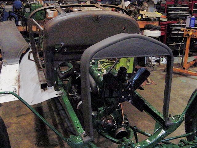

Post by tdump » Thu Apr 30, 2020 9:10 pm
Well this photo looks to be a 100 years old but I just took it.I had to lighten it up with software.
But the chassis is painted, The fenders will also be the dark green,the hood,rad shell,cowl and such will be the color of the coil box.
a much lighter greenish.Can't remember the color name.
Gota long ways to go. I switched out the wheels to my pickup as the blue wheels were not going to look right.and the pickup could have purty much any color wheels and not clash. So that is why the wheels and tires may look familar to you.
I wanted british raceing green but that would be exspensive and the chassis has pits in it anyway. It will be ok I think. I wish I could find the photo of the brass speedster I found online that gave me the idea for this paint scheme. it was a brass car.
Anyhow,here is a bad photo.Also,a pic of the chair that broke from under me,I am still hurting from that! If you have a chair like this, PITCH IT INTO THE DUMPSTER!

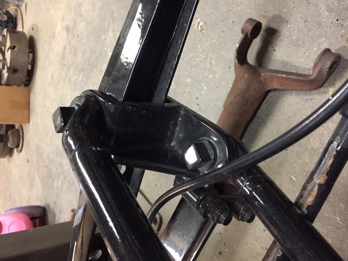

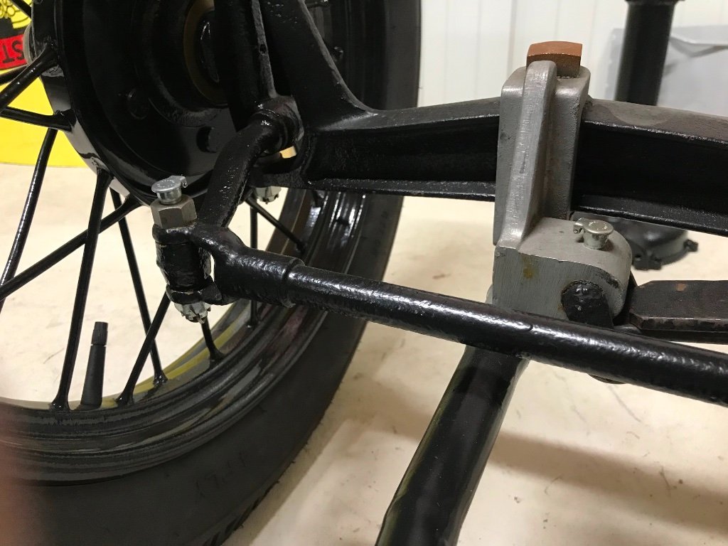

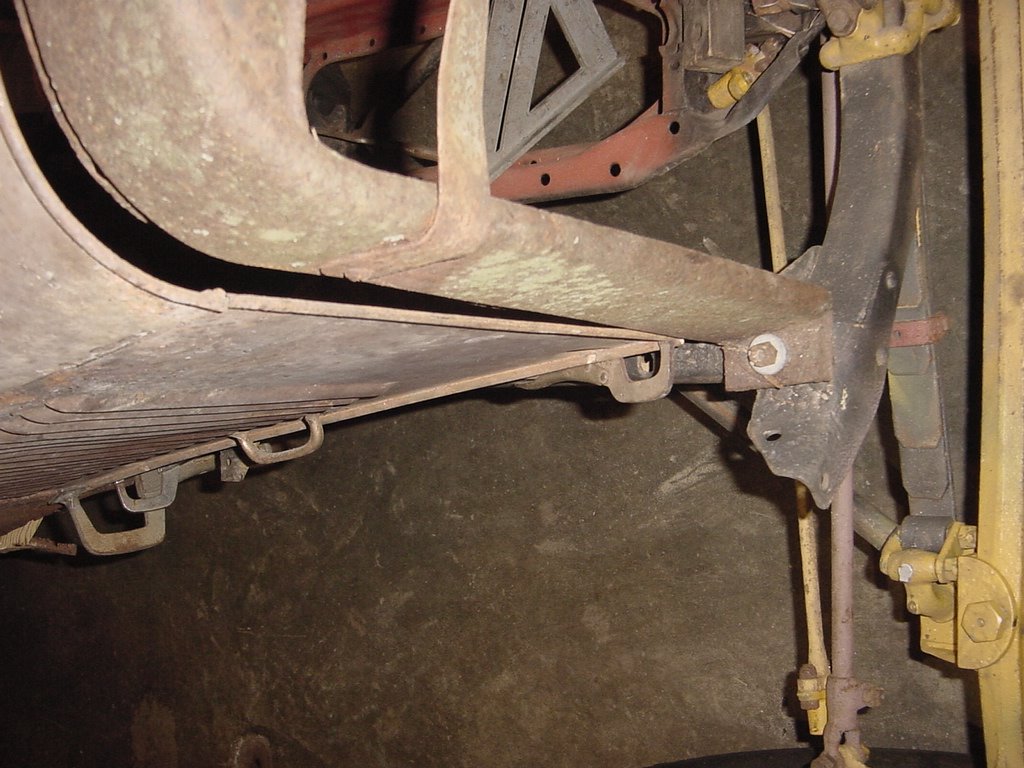

Post by tdump » Thu May 07, 2020 10:35 pm
just a progress photo or 2
Kevin Pharis
Posts: 1656
First Name: Kevin
Last Name: Pharis
Location: Sacramento CA
Post by Kevin Pharis » Fri May 08, 2020 10:02 am

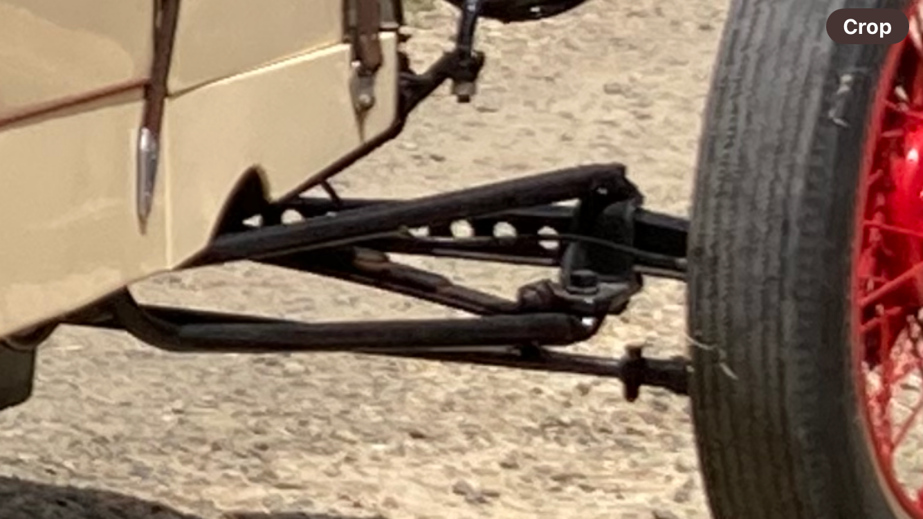

Was lookin over yur pics and noticed a familiar situation...
I ran this exact same lowering setup in my speedster for a while (home made Laurel lowering brackets with a cut down spring perch and a late wishbone). If you run fenders you may never notice... but you are going to have a LOT of caster in the front axle. By moving the front axle in front of the spring perch, there is now substantial leverage to twist the front spring and wishbone ends causing the caster angle to change dependent on load.
If you put a block of wood on your floor jack, and lift the chassis from the front spring mount... you will see the front axle caster angle change dramatically as the weight on the front axle changes. A simple double wishbone attached to the top of the axle will remedy the situation, and make for a much safer design. I eventually made new brackets to eliminate the cut down perches, but still run the same double wishbone
Posts: 4478
Post by Jerry VanOoteghem » Fri May 08, 2020 10:11 am
The increased caster from lowering the front end also makes it very hard to steer. I converted mine to 5-1 steering gears to help compensate, which helped a lot, but you still get a workout on a long drive.

Post by tdump » Fri May 08, 2020 4:10 pm
Double wish bone? Um, now would be a good time to educatae me on that since it is not finished yet!
5 to 1 steering already fixed for it.To be honest, i wish I had NOT changed to that on the pickup,as with the big steering wheel it seems almost to sensitive in the steering.

Post by tdump » Mon May 25, 2020 9:25 pm
Hours spent to get the cowl useable. Parts of 3 to make 1! most of this cowl I am trying to use is from this chassis. But the others were cut off as in for a short dog tractor or whatever best I can tell.
Strange how it was all torn up around where the gas tank comes out,a long crack along the bottom of it,holes and cracks all around where the steering column mounts.And the other 2 were WORSE than this 1. I don't know how they get in such a shape.I rivoted in the side pieces as the old 1's were bent, and the other cowl had good 1's.
Lousy pictures but progress is very slow.You will notice some 2x2 tubeing clamped onto the chassis.I am working out in my mind how to make a subframe.But I have to get the other peices decent before hand.
ALSO, A 1926 dash panel. Does anyone have a close up picture of what the slot-hole for the steering column is supposed to look like?
This is the only dash I have and it is not in "perfect shape" to say the least but I can repair it. I kinda wanted to use that nice insturment cluster with a switch on it but I hate to cut this dash up after I do all the work to fix it!
The radiator shell is turning out good. Needs some more high build primer,several coats,and sanding. Came clean using electrolosis .
Posts: 6587
Post by TRDxB2 » Mon May 25, 2020 9:39 pm
couple of pictures
26-27 roadster dash.jpg (22.25 KiB) Viewed 30678 times

Post by tdump » Mon May 25, 2020 10:52 pm
Ok,so I will need to make that little bolted on peice,Best I can tell the coiumn is just loose in the hole?
It appears the curved portion of that hole for the column has a lip turned to the inside for strength best I can tell from the pic.
Mark Nunn
Posts: 1290
Last Name: Nunn
Location: Bennington, NE
Post by Mark Nunn » Tue May 26, 2020 2:15 pm
The column in my '26 Runabout passes through the hole and does not touch the metal dash. You are correct that there is a flange, about 1/4" deep around the hole. The part that goes under column also has two holes in its bottom flange for screws. They go through the two holes under your dash.

Post by tdump » Thu May 28, 2020 7:54 pm
Ok,I think I have the top of the opening a bit to "square" and will have to kinda hammer a curveature into it to make it wrap around the colum a bit nicer but I got some done.A couple days in the electrolsis tub and a wire brush on a grinder made it clean and bare.I cut out a portion and welded in new metal. Won't have to use much filler but the whole surface has light pitting so it will need it..I hate that stuff but when you are making chicken salad out of chicken manure you sometimes add seasoning to cover the smell! :lol:
Posts: 6587
Post by TRDxB2 » Thu May 28, 2020 9:14 pm
Here is a picture of the bracket that goes on he underside of the dash to support the steering column. The dip is for the horn wire

Post by tdump » Thu May 28, 2020 11:11 pm
OK that is what I needed to see.Thank you Sir!
:D Looks like a bit of hammering and bending to make that!

Post by tdump » Thu Jan 13, 2022 6:15 pm
Long overdue,but I did get the cowl and a roadster turtle deck sandblasted this week.I had got busy doing other things and just haven't done much at all to this project. Partly because these parts were rusty and my vat for electrolosis was to small.
BUT for what it cost to get these 3 pieces blasted :shock: ,I am now looking for some kind of a plastic tank big enough for parts of this type!

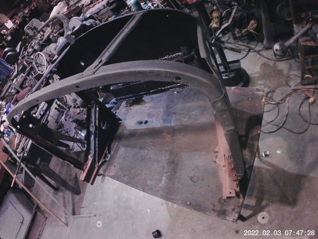

Post by tdump » Thu Feb 03, 2022 7:58 pm
Well I finally got both sides of the bottom of the cowl frame work finished today.
There is parts from 4 different 1's on this 1 frame work!
I do have a couple questions.
1, how thick are the wooden blocks used between the body frame work and the chassis?
2, is there any kind of washer or anything between the very front body mounts and the chassis?
3, Why isn't there body mounts riveted to the chassis for that last crossmember in the body frame work? This frame work came with the chassis and there was bolts in the holes that I had to cut off. So I can't understand the lack of rivet holes in the chassis or body mounts.
I have got to make a crossmember for the 1 that is missing and replace a few rusted sections of the body frame work before I can use it. I have scratched my head long enough and couldn't come up with a frame work idea that seemed feesable,so I dug the old frame work from out behind the barn.the front section of this body frame work was rusted off, and more will be removed when I weld the parts on the cowl to it.
As for the rear fenders,I am going to be cutting down a set like i did for my pickup. Alot of work to make the back side straight like the outside.kinda like a pickup fender.
requires a bad fender for parts to cut out of it to weld into the usable fenders.I don't have any 26-7 sheet metal and don't like the looks of it anyway,to modern looking for a T :)
Also,for the folks with Keen eyes,no those are not 26-7 splash aprons. It took me several hours of welding and grinding to move the rear mounting hole on a 25 back set of aprons so they would bolt to the 26 chassis.

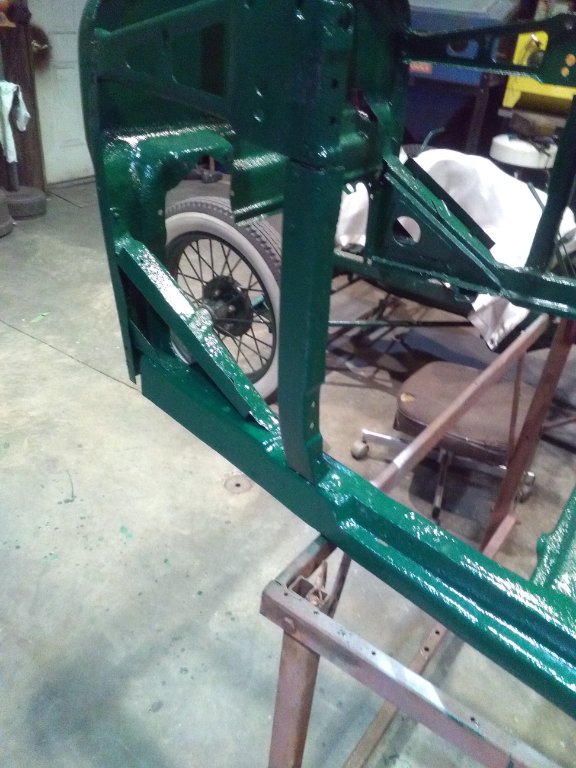

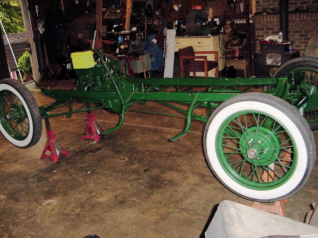

Post by tdump » Sun Jul 10, 2022 10:55 pm
Well a good bit has been done since the last post.pictures are in the wrong order,
I can't put into words how many hours I have in this frame work but it is now painted and finished ,ready for the cowl sheet metal to be repaired and installed. It is just stored on the chassis, I am thinking it will be easier to install the sheet metal cowl and fuel tank and etc while it is on the table frame when I get those parts ready.
Oh yea,in case you are wondering why GREEN, the brass car that inspired my color choice,I finally found a pick,
I have NO idea who's car it is,but this is what gave me the color idea. I wanted something different.

Post by DHort » Mon Jul 11, 2022 12:39 am
Just my opinion, but I am thinking if the hubs were black and the rims were black it would make the natural spokes and the whitewalls stand out a lot more. I love the two colors of green in that picture. They go together well. Ask a woman who knows color. That is why I check with my daughter to see if the colors match and are balanced. Again, just what I see. I love what you have done so far.

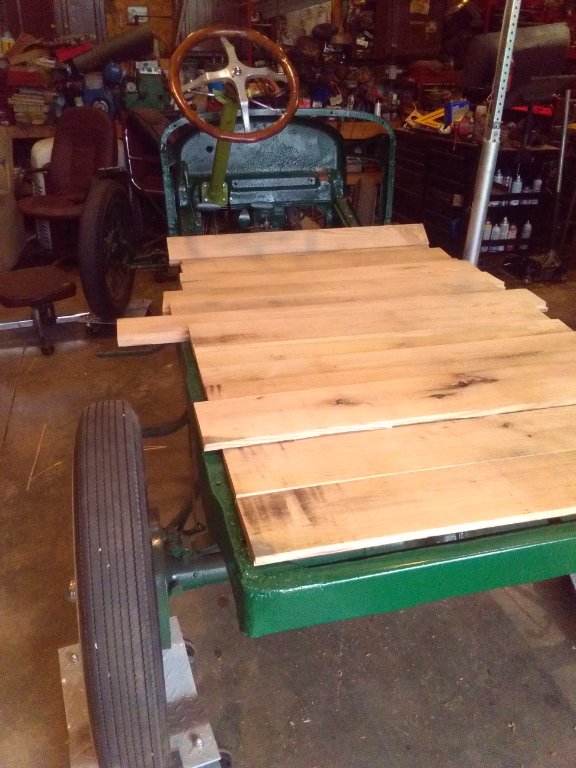

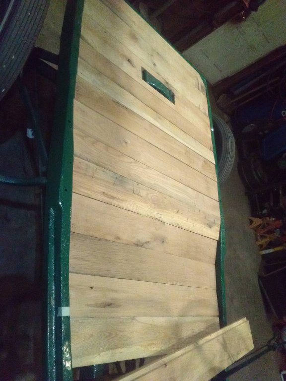

Post by tdump » Wed Feb 08, 2023 7:27 pm
I know this does not look like much but I finally got to start piddling again at this thing.
I got the body frame work bolted to the chassis. Steering colum bolted in, and I have made a BUNCH of wood shavings.
I had a stack of white oak lumber dad and me had cut back in 1995 that I was going to use on my 1 ton T truck project for a flat bed.Well,it twisted warped and etc,and plus I found the dump bed,and the rest is history, but that lumber was still stacked up behind the shop. I decided to use it for this project since I needed short peices and could deal with twisted and warped wood that way.
there is ALOT more work to go but it is a start.
The boards will set down inside the frame work,resting on a 5/8ths "lip". I will also put a strip of wood attached to the frame work to further support the wood going sideways.
Hard to explain but it might make sense after I get started.My planner failed and I had to borrow 1 to finish,I will have to slide the stuff back thru on a light pass just to clean up some spots. The feed gear box is shot,the gears were slipping,letting the blade sit in 1 place to long.

Post by tdump » Sat Mar 18, 2023 8:52 pm
Well here is a update on the wood,most of it is roughly fitted .
And a photo of my gas tank solder job!

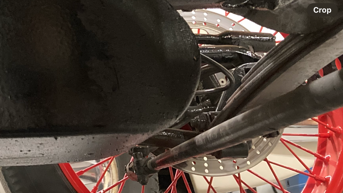

Post by tdump » Mon Feb 24, 2025 6:31 pm

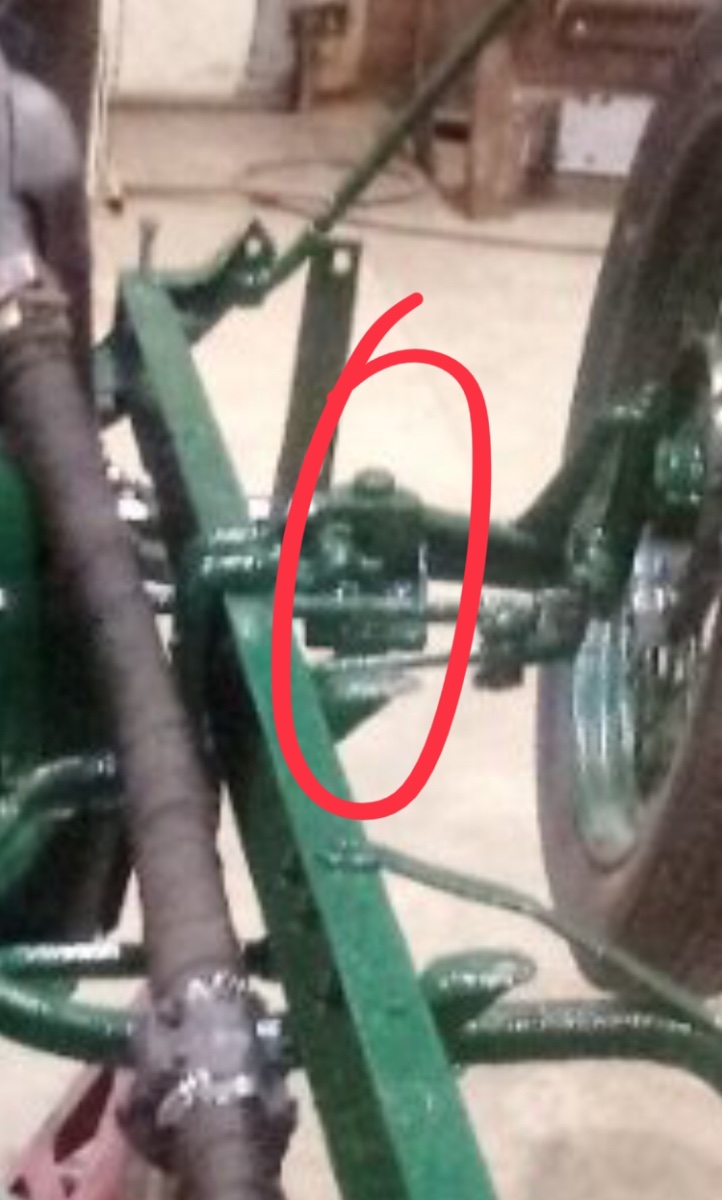

Well this thing has sat around for a while untouched, I finally did get the splash aprons and some old running boards bolted in place. Finally gave up and just went and paid the 225 to have the fuel tank done and got it back today. they used Redcote,which I HATE, i was hoping they had used Por15.
redcote will die the gasoline. and if it does that ,that means to me it is breaking down. But they garrenteed it to be functional and they are the only game in town for this type work. I hated to spend the money as i felt it was way to much for the small tank that really was not bad inside. I just wanted to make SURE i didn't have any problems later as the tank is no fun to get out of a assembled car
I also have discovered to my dismay, I will not be able to use the lowering brackets I made for the front axle. When I first assembled all that stuff, I did not have the engine in it, just by chance I looked down at the tie rod and wishbone and NOPE aint gonna work WAY to close. I have looked at 2 books on speedsters and can't see any solution to the issue but to find a good pair of 26-7 spring perches and just be happy with the reverse eye springs front and rear giving me a inch of lowering.

Post by babychadwick » Thu Feb 27, 2025 7:45 am
Any reason you cant bend the tierod to clear or cut the wishbone and relocate to the frame? Model A tie rod ends work well for this, good idea also to attach to top and bottom of the axle.
Other methods for lowering would be a drop axle (varied amount) or chevy spindles.
Kevin Pharis
Posts: 1656
First Name: Kevin
Last Name: Pharis
Post by Kevin Pharis » Thu Feb 27, 2025 10:08 am
Overland tie rods had heavy Z brackets to lower the tie rod about 2” below the steering arms. They are a bit larger than T stuff, but you may consider making something similar. T steering arms can be reshaped with a little heat, but they will get short quick so may not be a good option.
Model A steering arms are an easy swap. They require a couple extra mods and you would need to run the A rod ends. Did this on my speedster and all works good. For additional clearance I cut the arms in half and flipped the ball to the bottom. This lowers the tie rod about 2-1/2”. The tie rod just barely clears the wishbone… just don’t have any room for paint! These pics don’t show much, but it’s the best I’ve got right now
Post by Ed Fuller » Thu Feb 27, 2025 5:19 pm
You can also gain some clearance by swapping the steering arms side to side and flipping them. I had to do that on my speedster. I have a set of Laurel style brackets on it.
