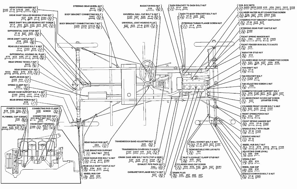

Does anyone have a diagram of what bolts and/or brackets go where? Suppliers have part number to application but lack information on dimensions. If you have some info please post it to this thread. If a list isn't available I will make one. I have several sets of data but they all lack the bolt dimensions (diameter, length, treads, etc). Same is true for body o frame brackets etc This diagram shows were things go, tools used, and head size but no part#
this is a list of parts hardware but lacks dimensions.

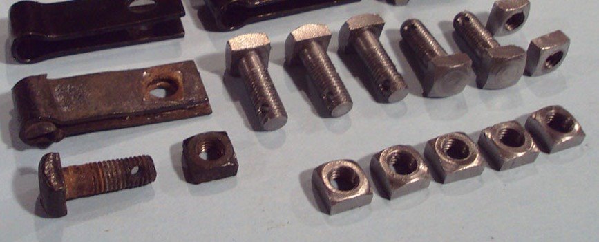

They are a 1/4-28 square head bolt, I think 1/2" across the flats. I don't know how thick the head should be.
Although they are drilled for a cotter pin, they use square nuts! The parts catalogs say they are 9/16" long, RV says they should be 25/32" long.
I believe this is a picture of Rich Eagle's craftsmanship, along with an original on the left. He said the original in the photo is 0.720" long, but he said that he would expect some variation.
I have not seen a drawing for these bolts, but it only goes through the frame and a thin piece of sheet metal for the pan. A couple of them also hold the gas lamp clamps which might add a total of another 1/16" so I were to manufacture them, I'd be inclined to go with 9/16" long.
Keith
Keith
Re: Early Body Bolts
FWIW I just measured the head of nut and bolt and they are 3/8" across flats. The bolt head is .178 high and nut is .186 high. This is the rusty bolt and nut shown at lower left. They were taken from a 1913 frame with the tube clamps. No pans were present at that time but I am assuming those were the original bolt and nut. My '14 frame had the same although the bolt was a smidgen longer, .740.
