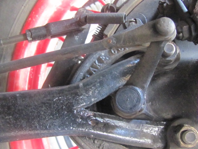

IMO, think the reproduction R-M brake castings are the same, but there are Left and Rights. Think that subtle changes in factory '26-'27 radius rods can be the issue. These Improved Car rods are different than earlier.
On my R-M install, had to grind a small area where the casting was impinging on the radius rod yoke. That let the casting sit flush. Easy fix.

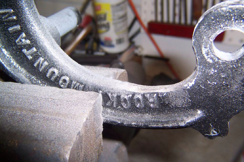

This is the '26-'27 casting for mounting over the radius rod , you can see the "R-M" logo extends to the curved end of the casting. This is the one side that needed clearance over the radius rod, to allow it to fit flush. Simple work, likely the fit was too tight due to the casting 'draft' that occurs when you cast parts, you need the part to remove from the mold, so an overhand is on most edges due to this draft.
'26-'27 repro R-M

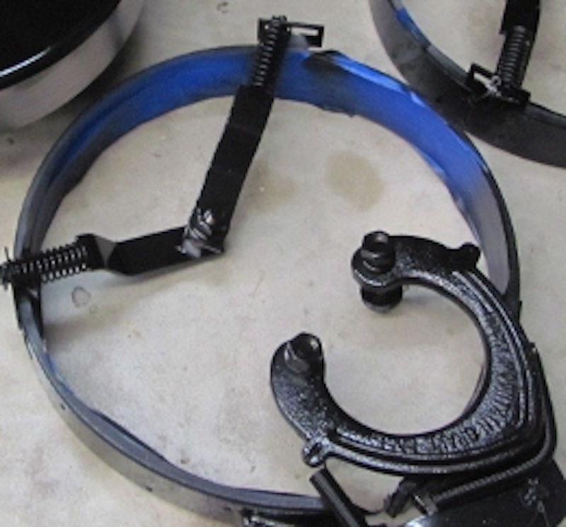

Here is the casting for the '09-'25 repro R-M brakes, it is more circular and has the 'R-M" logo at the top of the casting frame.
'26-'27 repro R-M
