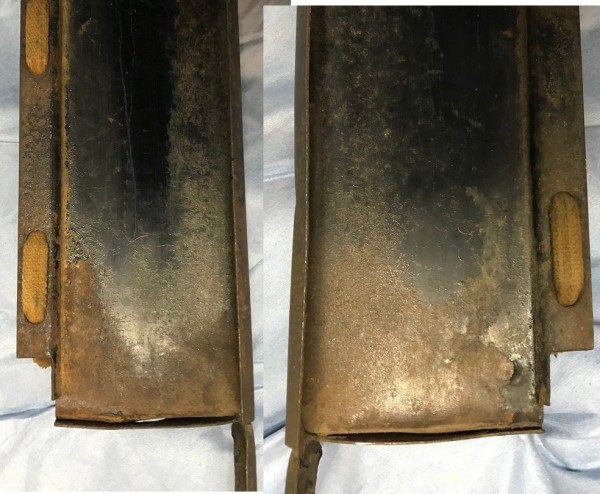

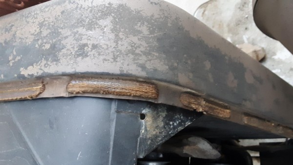

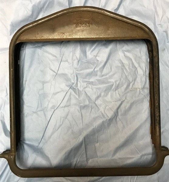

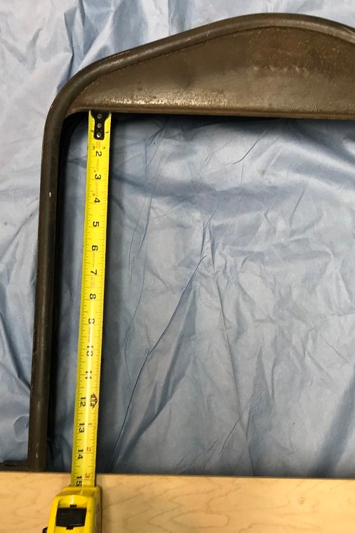

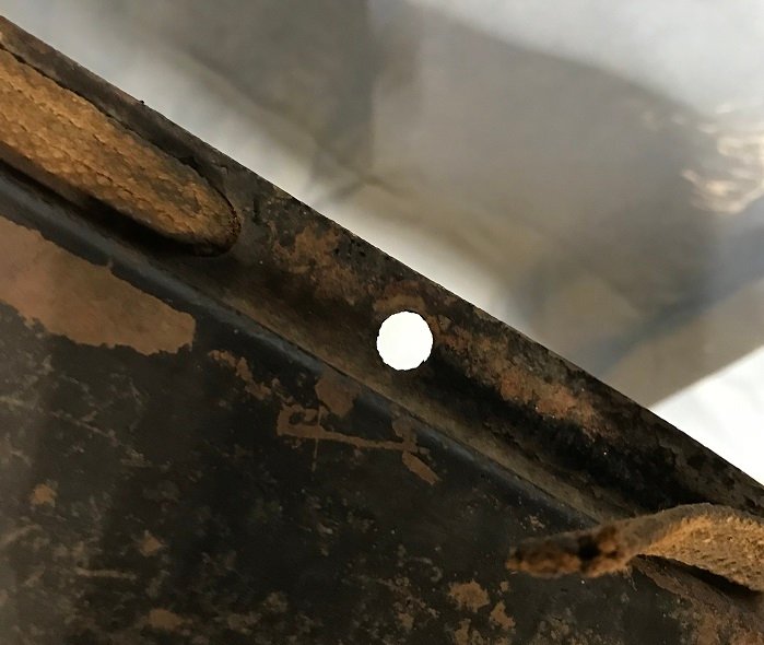

Trying to identify the year this radiator shell is applicable to. Its a low shell with an apron and round lacing holes.
Low shell 1917-24 and some '25. Unsure what the proper terminology for the trim across the bottom is and when this style was applicable. The T Encyclopedia reference to a SKIRT starting in '25. Lang's using the term APRON for different styles. Some reference was to a valance. Also understood that the round lacing holes were '26 (maybe '25 too). HELP! - what is it.

Re: What Year Radiator Shell
Low radiator 1917to1923&1/2. High radiator, 1923&1/2 to 1925. 1926/27 also high, a little different shell.

The low hood dates are clear what puzzles me is the round lacing holes. Do they make sense for a low hood? If so what year 24 1/2? Thought I read that they were introduced in late '25 or '26

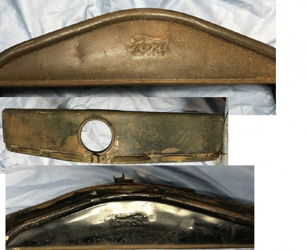

I believe it could be a repop...the Ford script doesn’t look as crisp and defined as an original.

Topic author - Posts: 6560
Here is a better picture of the top, other was kind of dark around the script. Was also wondering how far down the lacing holes are supposed to go.
I am fairly certain that round holes were used on at least a significant number of 1917 model year radiator shells. I have seen them on original and restored from original cars. I had one such shell that also had only the small bolt size hole for the radiator mounting. It certainly appeared to be original old real Ford.
How long they were used? Whether it was all or some for how long? Has been asked on the forum in the past without a definitive answer. So I don't have an answer for that.
Considering the several million model T Fords built with the low style hood and radiator? The percentage of shells with small round hood lacing holes is small, probably well below ten percent. But they are out there. Why Ford went back to the small round hood lacing holes for some of '26/'27? I don't have an answer for that either.
I have a September 1916 built touring with round lacing holes and no skirt / apron/ etc.

Frank, you've posted every picture possible, except for what you're referring to as a "skirt".
Post that.
If it has anything like this: https://www.modeltford.com/item/3977BQ.aspx, then it is a marriage
If it has anything like this: https://www.modeltford.com/item/3977A.aspx, it is not
And, original shells with both square and round holes: http://www.mtfca.com/discus/messages/50 ... 1436405212
Here are a couple of pics of the shell on my unrestored '22 touring, built July 26th. I'm the third owner and have no reason to think that this isn't the original shell to the car. It has the round holes for the lacing. One pic shows what I am guessing is what you are referring to as a skirt. This is correct for all the low radiator cars.

Thinks to you all. Conclusion: the shell is for 1916-1924 with uncommon round lacing holes.

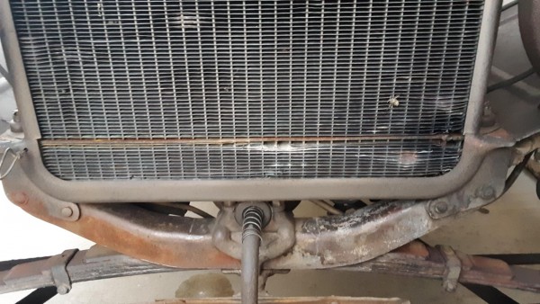

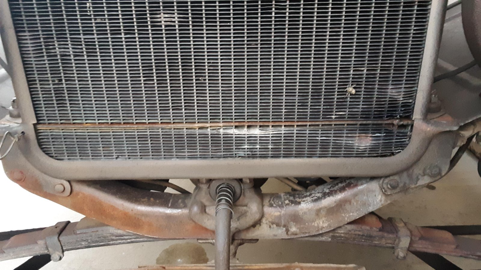

Here is a picture of the shell with the whatchamacallit on my shell. (called a trip strip in 1926) I'd call this a valance
What you are calling a valance, Ford called a Radiator Apron part # 3977 1923-25. That is from Ford Parts List August 5 1028.
The shell is part # 3947-B, Radiator Shell, 1917-23.
# 3977 came out in late 1923 cars with HIGH Radiators. Dan
