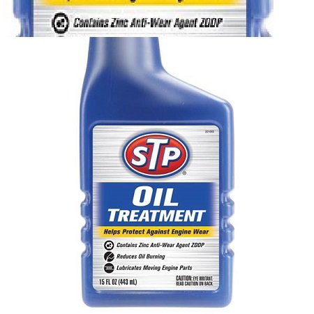

STP thinned down with oil works great in a roller timer! No, you don’t use STP without thinning it down. Best to read the post to understand it. It makes the oil super slick and lessen friction. Pretty simple to understand. Never say never about anything until you try it. You might actually like it. And again to each his own.

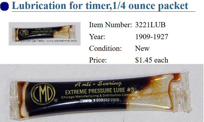

Wouldn't Distributor Cam Lube directly on the surfaces needing lubrication work? Remember getting small capsule with the points back in the '60s-' 70s. A dab kept the cam lubricated for couple of thousand miles.
- Posts: 5625
Re: Modern advances in the lubrication of the original roller type timer
I remember those little "capsules" - I thought is was Vaseline.

John. Your idea sounds good. In your experience, what would you estimate the STP to Oil to Grease mixture ratios? Jim Patrick
- Posts: 4701
I would use some light grease or.some heavy oil and then add the STP till you get a fairly thin consistency. If you don’t want to use grease then pour out some 20 or 30 weight oil in a cup and then mix the STP into it at your own discretion.
Remember it’s the STP that gives the extra “slickness” to the oil and that’s what helps to cut down the wear.
Since STP came out years ago there have been other additives that have been developed to decrease engine wear. They would probably work also.
- Posts: 6611
Why wouldn't you use this?
Not sure which STP formula you are referring to but the original contains Zinc which is a relatively good conductor.
- Attachments
- STP.jpg (32.9 KiB) Viewed 8830 times

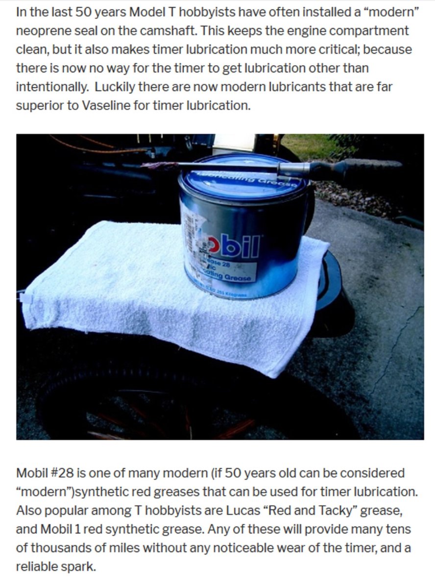

- Posts: 7413
If I remember Royce's comment correctly, I believe he said he uses Mobil red grease. I use New Day timers, so I have no advice on timer lubricants.

- Posts: 6835
Steve
I too, have swapped over to Mobile, having read Royce's words. Was working on a pristine early two piece timer for a friend and used it on his timer and have put 1 season on one of my ANCO timers with it. Used to use White (lithium) grease which worked fine for years (so what the heck am I doing switching???). Anyway, I'm on the Mobile bandwagon only because after buying a tube of the stuff, I have a 400 year supply of it.
