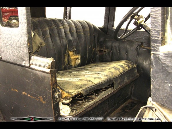

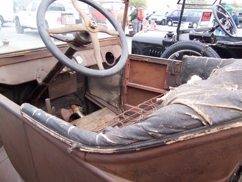

These may help, pulled these copies from earlier forum posts. Are '24 but '23 would be most similar. At least shows horizontal line of the back rest upholstery buttons and outer top corner on original material.
