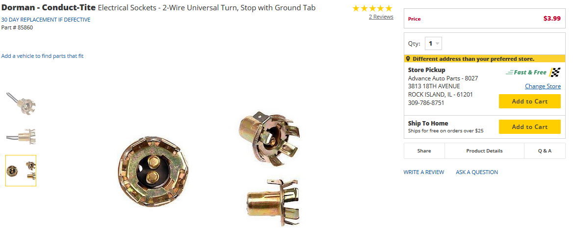

If You rewind the starter for 12 volts or replace the starter with a 12 volt one. that will be more expensive. If the 6 volt Generator is good add a fun projects voltage regulator to replace the cutout. They also sell 6 to 12 volt converters that are cheap and will power Your 12 volt devices. I have two Ts one is 12 volt the other 6 volt. with a good 6 volt battery and proper size 6 volt battery cables the Truck starts just fine in cold weather. The starter on the touring is 6 volt and on 12 volts it winds up like a jet engine. They make a number of good 6 volt replacement bulbs now that are much brighter than the stock and after market incandescent bulbs. draw very little current with My headlights on Bright You can just barley see the amp meter needle move. Ford did not change to 12 volt electrical systems until 1956 ? a year after Chevy did in 1955 ? If My memory is correct.
Your car Your choice.
Good Luck.
Good Luck.

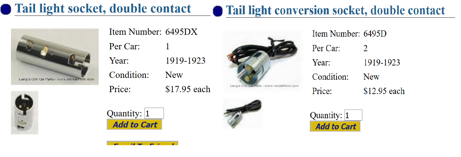

There are several methods to convert to a dbl contact tail lights -
Or be creative and DIY
take the guts out of one like this and put it in the T tail light can
https://www.ebay.com/itm/2-Trailer-Truc ... 2366819320

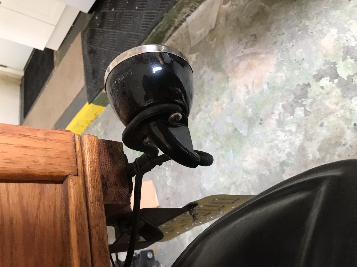

I made up this LED brake, turn and hazard light combo. I wired it with a trailer plug and made it removable. The 6 volt system works good with LED's and they are plenty bright in the daylight to make driving safer. I wanted it removable for going to shows where originality is expected.

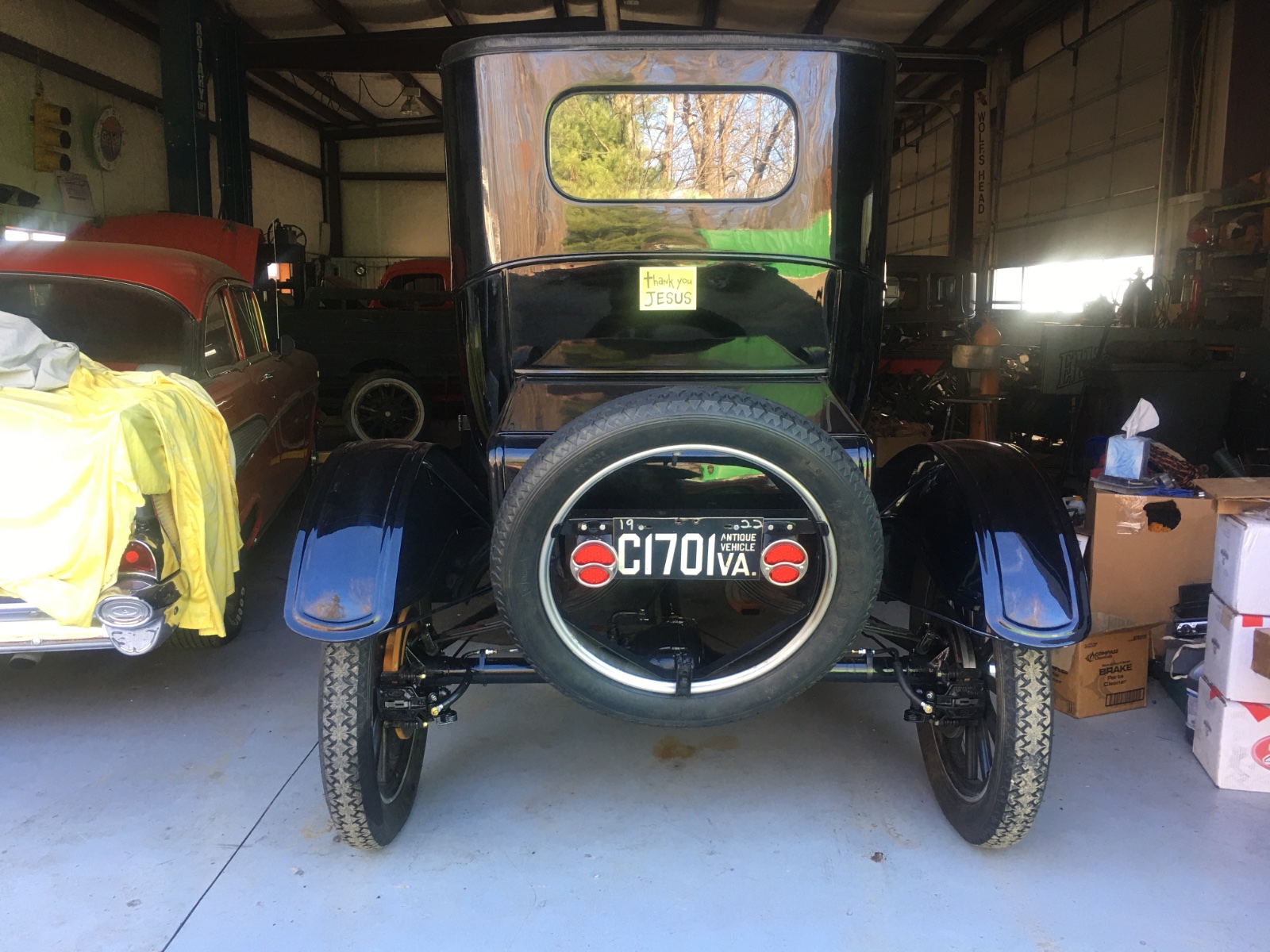

- Location: lambsburg va
Re: Tail lights, brake lights, and turn signals
Made some brackets for model A
