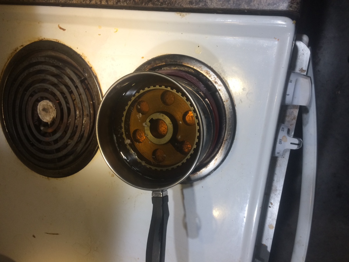

Post by D.Yoder » Fri Jan 03, 2020 8:39 pm
A little heat helps installation.

Post by Steve Jelf » Sat Jan 04, 2020 9:45 am
What is it?

Some of the newer modern transmissions have a press-fit on internal bearing to shaft fit. A special fixture is needed for disassembly and you use heat transfer plugs for assembly.
Plugs are heated to 450F degrees, usually on a hot plate and then put inside the bearings for a few minutes and everything slides together with ease. Without doing this you can break the cases...

Post by Steve Jelf » Sat Jan 04, 2020 10:49 am
It's not Model T, so I was thinking maybe some other make or pre-T Ford.

Post by old_charley » Sat Jan 04, 2020 11:24 am
Looks to be the clutch disc drum from the turbo 400 clutch disc setup in Lang's catalog

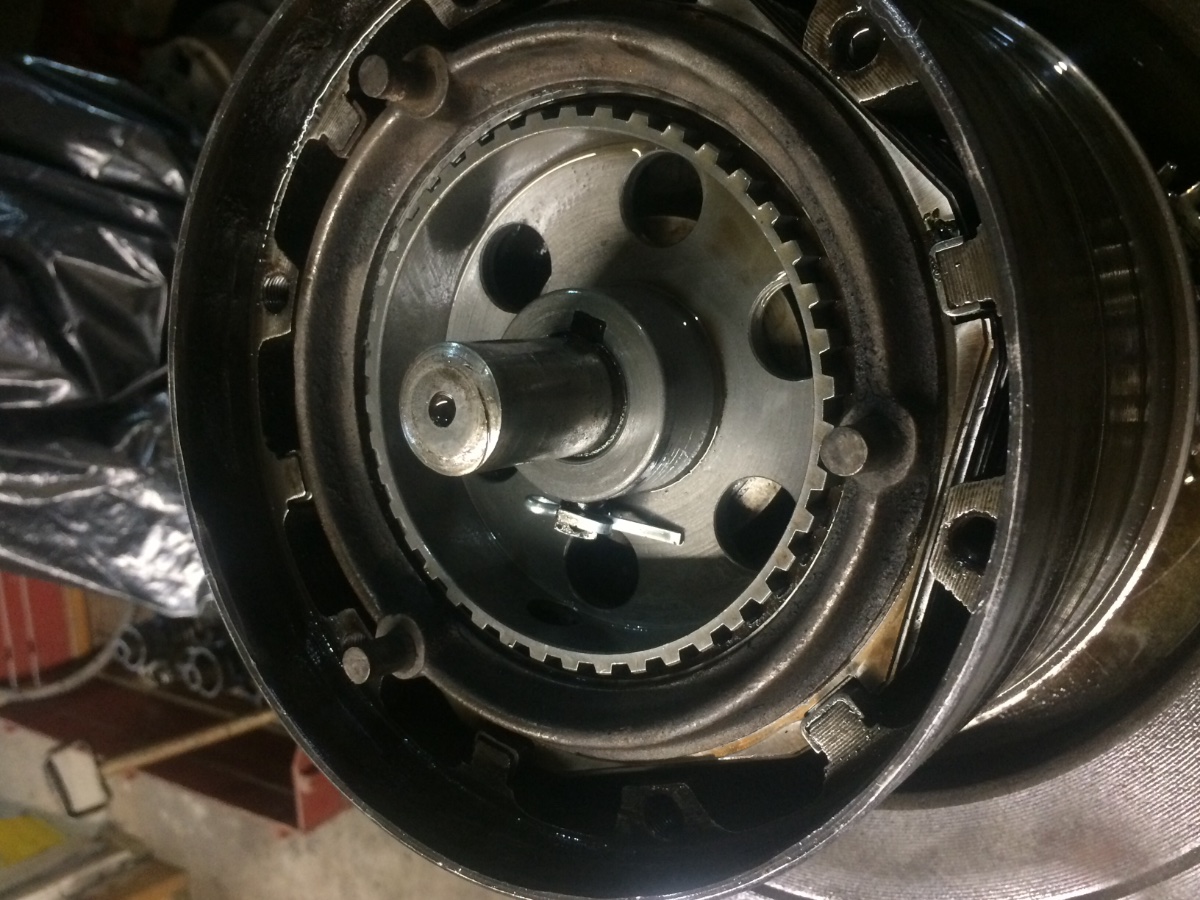

Post by D.Yoder » Sat Jan 04, 2020 11:57 am
Turbo 400 clutch disk.
Now cooking 26/27 tail shafts in lye water

Post by D.Yoder » Sat Jan 04, 2020 12:15 pm
Turbo400
Turbo400

Dean, Could you please tell us why you use lye water instead of regular water to cook the '26 - '27 tailshafts?

Re: Super is ready
Post by D.Yoder » Sat Jan 04, 2020 1:39 pm
Lye to de grease and removes rust.
Very caustic do outside !
