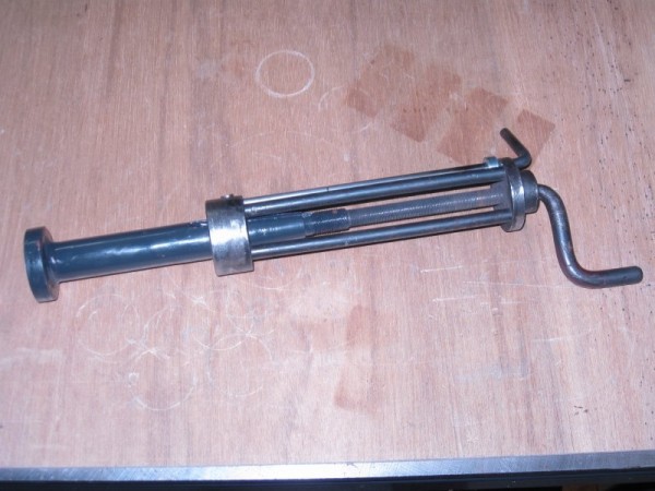

I need a dummy axle for the Cantrell Miller sleeve puller so I can remove sleeves out of a single housing. Someone told me that someone on here reproduced these.

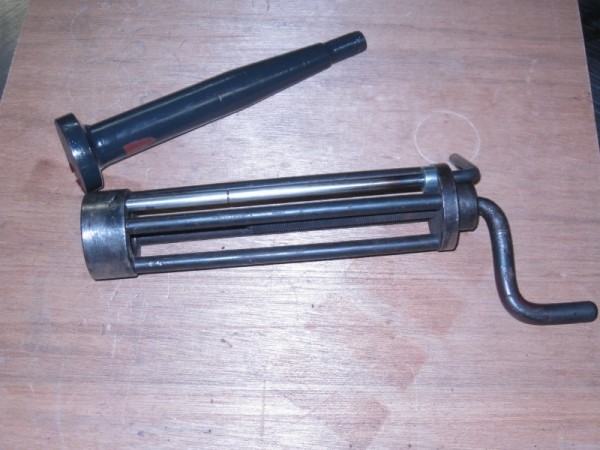

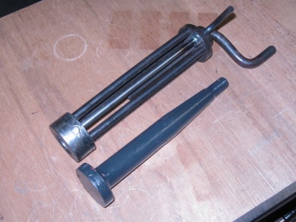

I believe that it was Scott Conger that had made some. If you have an old won-out axle and a couple of 2" OD washers, you can make one:
I had welded the washers together and than welded them to the cut off portion of the old worn out axle.
