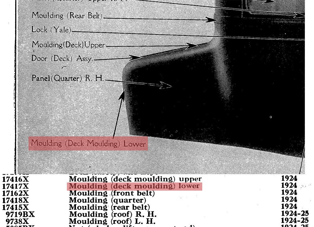

Re: 24 coupe moulding
If I understand you the moldings you refer to are these highlighted in red.
I don't have the answer but am surprised the listing is only for 1924.
