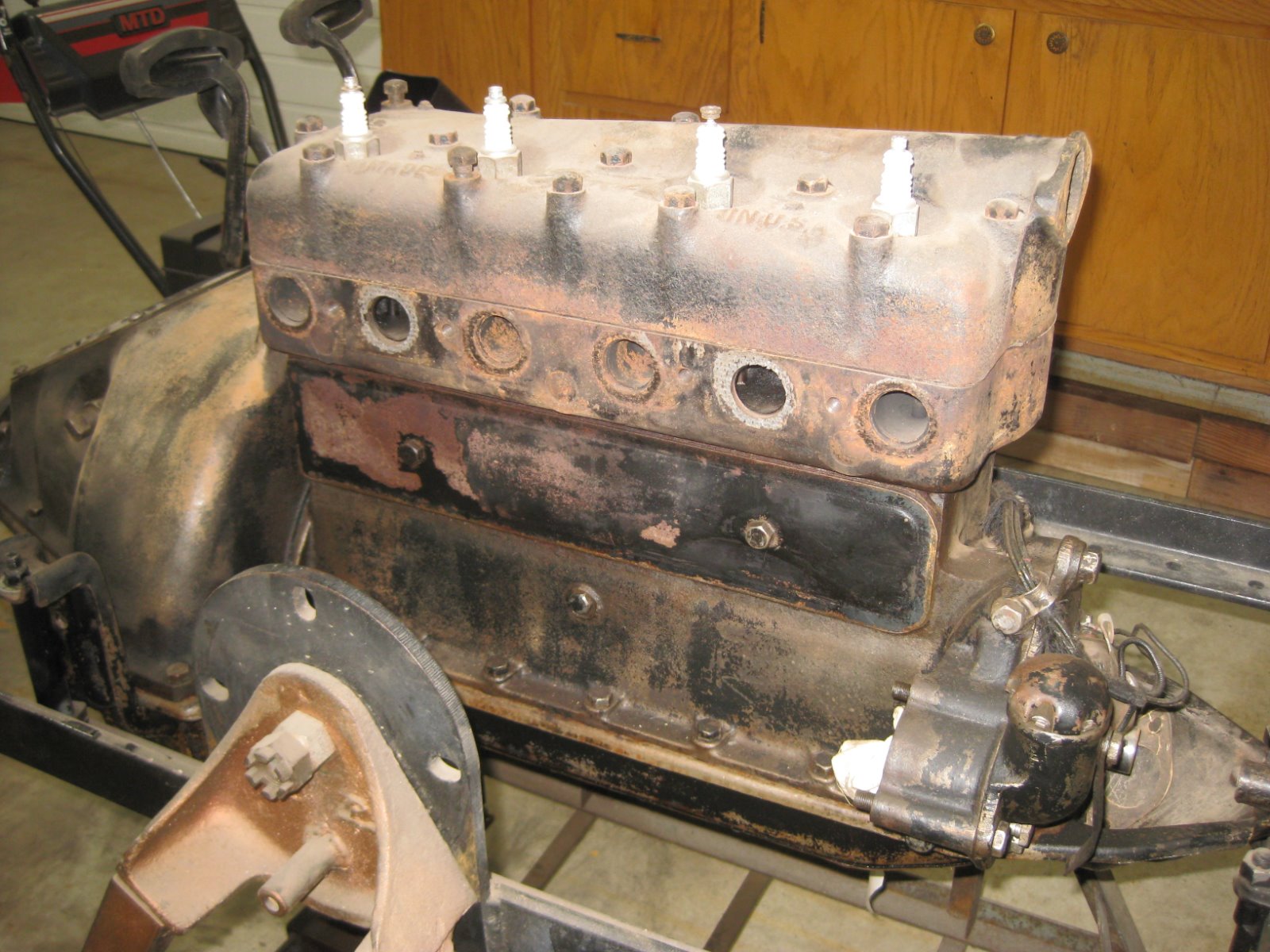

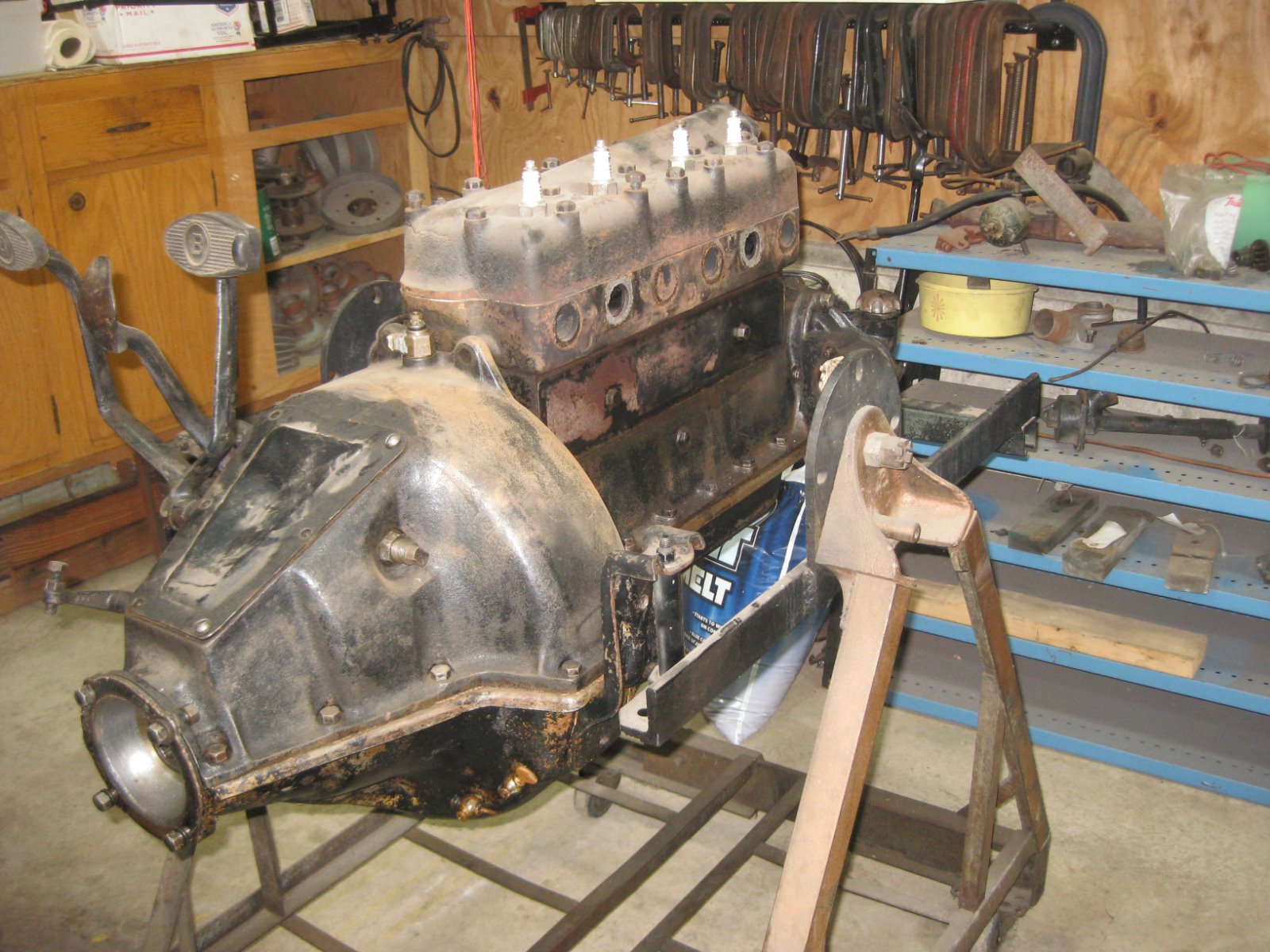

I have a quick question, about a compression test on a "T" engine. I have several picture of the engine as it sits and wondering if a compression test can be done as the engine sits.

Install the hand crank or a starter and yes you can perform a compression test. You sure won't need to make sure the throttle is open!! Do remove all spark plugs to make it easier to turn over on either the starter or hand crank. You will only have compression on the cylinder where the gauge is installed. You may need an adapter for the compression tester. https://www.modeltford.com/item/5201CAD.aspx

The easiest thing to do is to just crank it over by hand with the crank, with the ignition off and the throttle open. You can feel the compression. If the engine has not been run for a while the oil has drained out of the rings and there will not be much compression. Add some engine oil, a tea spoon or so, to the cylinders with the plugs out and put the plugs back in a try it again. If you turn it over slowly you can hear any leakage at the crankcase, the exhaust manifold, or the intake manifold. Turning it over quickly will give you a more accurate picture of the compression during running. This is a qualitative test and not quantitative. It will give you a rough idea. To be more accurate use the compression gauge and crank the engine fast with all the plugs out. Use the starter if you can.

Since you have the manifolds off you can hear any valve leakage at each port.

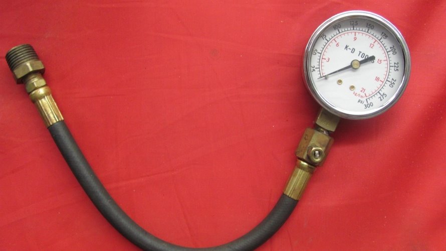

Hi, one of the problems with testing the compression on a low compression engine is not using the proper range of the gage. My opinion is the max gage pressure used should be twice the expected pressure of the engine. The standard gage pressures on many testers is 200-300 PSI. If one is used on a stock T , there is scarcely enough pressure to lift the needle. It also will be difficult to read minor differences between cylinders.

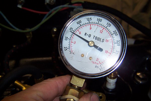

Didn't have any trouble with a quality gage on my T engines. Pipe thread adapter from the local hardware store, easy to do test. The test doesn't really have to be such accuracy, the test is to see if the needle holds. Mind did, had to push the gage release button to get back to zero!

What a fine looking engine stand!

Dan, Nice gage But you need to be aware that the error tolerance of any gage can be very wide at both the upper and lower 1/3 of the range.
For our T's it would be most accurate to use a 100 PSI gage if available. Your reading looks really great!

What would be a reasonable compression pressure for a stock engine, both dry and with oil added to the cylinder? Mine was in the range of 42-44 psi dry while hand cranking. I did not do a wet test. I want to retest using the starter.
