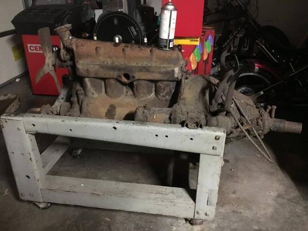

first post here. I've wanted a T since working on them in college, finally decided to start shopping at Thanksgiving time. While I've been looking for that *just right* car, I picked up a December '25 engine on a stand, to mess with. I'm hoping to collect the stuff, and have it running, or close to it, in the next couple weeks.
I'm going to give image posting a try here, so bear with me
[img]https://postimg.cc/7bFKjjbt/img]

Cory,
Welcome to the affliction as many of us say....
I'll repost your photo as I'm not sure if it will show up 2 years from now with the URL way you added it. It might, I just don't know. And you can click on the photo below and it will be much larger.
I like your engine stand - it looks very solid. I could not read the serial number on the engine but a Dec 1925 engine would be a 1926 model year engine. And it appears your engine has the bolts to hold the transmission cover to the rear of the engine block. If there are not any holes on the block for the bolts to screw into then the block is likely to be earlier than Dec 1925. It also has the wider low pedal and brake pedal that were introduced with the 1926 model year USA cars.
Note the cylinder head also has the 1926 - 1927 style water outlet that would have held the fan on a 1926-27 engine. But it is incomplete and the fan is missing. It appears that your engine has the earlier 1917-1925 fan arm and an early 1917-20ish fan and fan hub pulley.
Lang's has a lot of pictures and illustrations of parts in their catalog. For example the fan arm is Lang's part 3967BU (they often use the same part number or very similar part number as the Ford Price List of Parts from back in the day.) The part is shown at: https://www.modeltford.com/item/3967BU.aspx
There is a posting at: http://www.mtfca.com/cgi-bin/discus/sho ... post=90634 that discusses getting an engine going again after a long hibernation. That same posting has the link to e Milt Web's article taking a car out of mouthballs -- but that link no longer goes to that article so recommend you us the following link: which includes some good advice on that same subject. Please see his article at http://www.mtfca.com/discus/messages/29/8538.html and someone converted it to Microsoft Word ducument at: http://www.mtfca.com/discus/messages/70 ... 762335.doc
And be careful -- you can break your arm if you hand crank it and the timing is not retarded properly. And the carburetors normally leak gas -- so don't leave the carburetor where if it drips gas it will cause a fire (i.e. near a gas fired home water heater.)
Again, welcome to the fun and there is a good chance there are some folks not too far from you that can also offer advice and encouragement. Check out the chapter listings at: https://www.mtfca.com/clubpages/chapters.htm and also https://www.modelt.org/chapter-listing.html

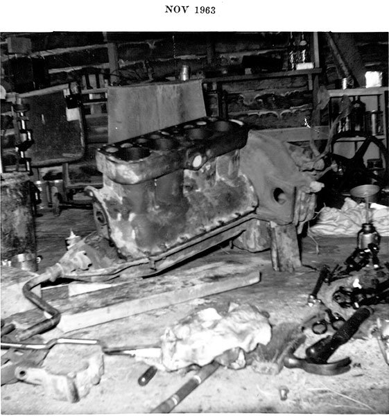

How that reminds me of my first Model T engine. It was happily covered in rust and solid grease like your picture. 57 years later it's still the best hobby I know. I hope you enjoy it as much as most of us do.

Thanks for the warm welcome !
I tried a bunch of different ways to post the picture, but all I could get was a link. I’ll keep reading and trying until I figure it out.
I believe this to be a 26 model year engine and trans, because of the extra mount bolts, 4 dip pan, pedals, etc. I didn’t know about the earlier fan stuff, so...thanks !
I’ve pulled the drain plug and the inspection cover from the bottom. Looks great up in there, so i’ll probably just try to wipe the gunk out and reassemble with new gaskets.
The carb is a fail. I can’t get the main jet out. I’ll be on the hunt for one now.
I bought a set of coils all set up and ready, trying to buy a rebuilt 26-7 coil box out of the classifieds here now. Then i’ll get the rest of the ignition parts new.

Don't give up on that carburetor yet. Heat that jet up a bit and quench it. It will probably screw right out.

I’ll try heating the jet !
