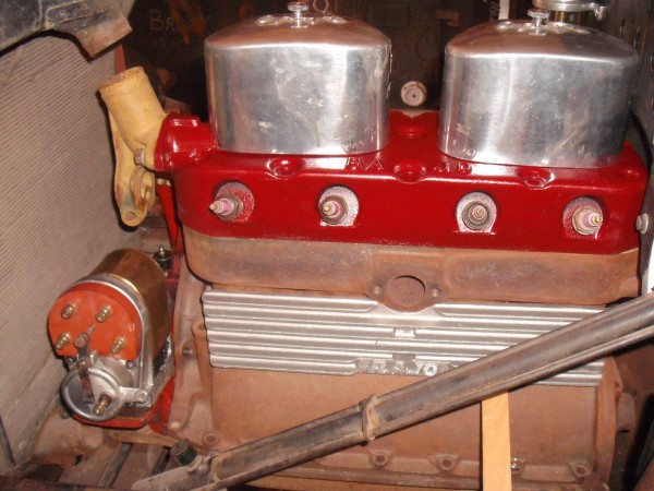

For those not familiar with Rajo 4 valve heads, here are a few pics of my head (red) when I had it mocked up in the speedster project. The black heads are other heads I found pics of on the web.

Your stands look a lot taller than I remember mine being.

Dropacent (Tim) My towers being the taller towers is why I think all my rocker parts are repro. It also came with the 2 separate valve covers and the new cast aluminum intake like the Australian repros came with. All those parts are obviously new parts. As a general rule the repro heads do not have a serial number on the serial number boss at the front of the head. I thought my head was a repro till I cleaned it up. Under three different colors of very thick paint I found a serial number stamped into the boss. I can not say for sure but Im leaning toward an original head and all the rest is repro parts. ???
I have an original open back valve/rocker cover. When I install it on my rocker towers it is about 3/4 inch too short in height. Every original valve/rocker cover I have seen has wear marks on the inside where the rockers have been hitting the covers. So it appears that the original RAJO covers were made with too close of a rocker tolerance. More than likely I will run with no covers till I can make up new patterns for a new cover one inch taller than stock. I also plan on enclosing the rear of the cover. The open back is only needed if running stock coils. The open back is to clear the plug /timer wiring. Just one more of the many "to do" projects
