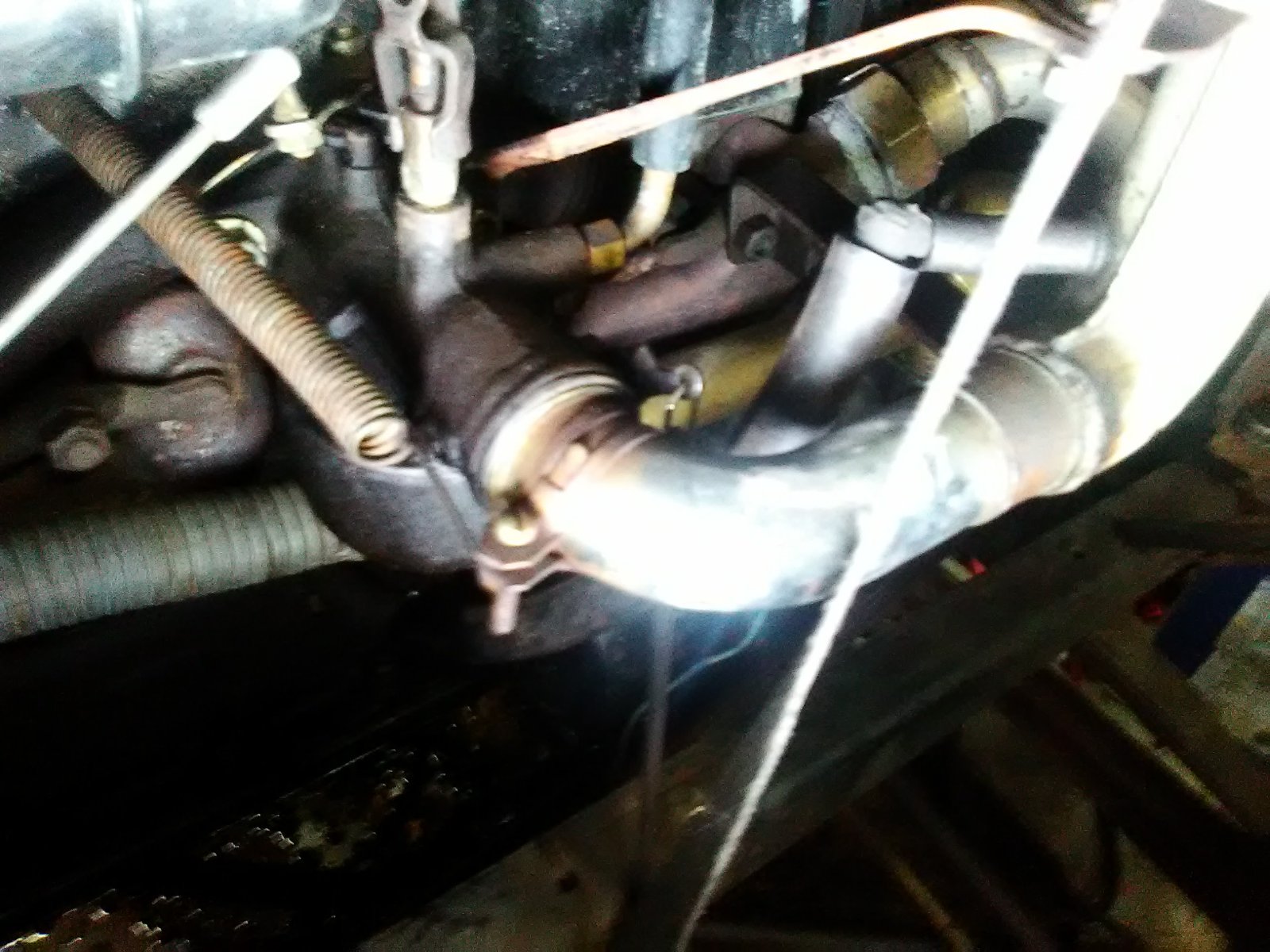

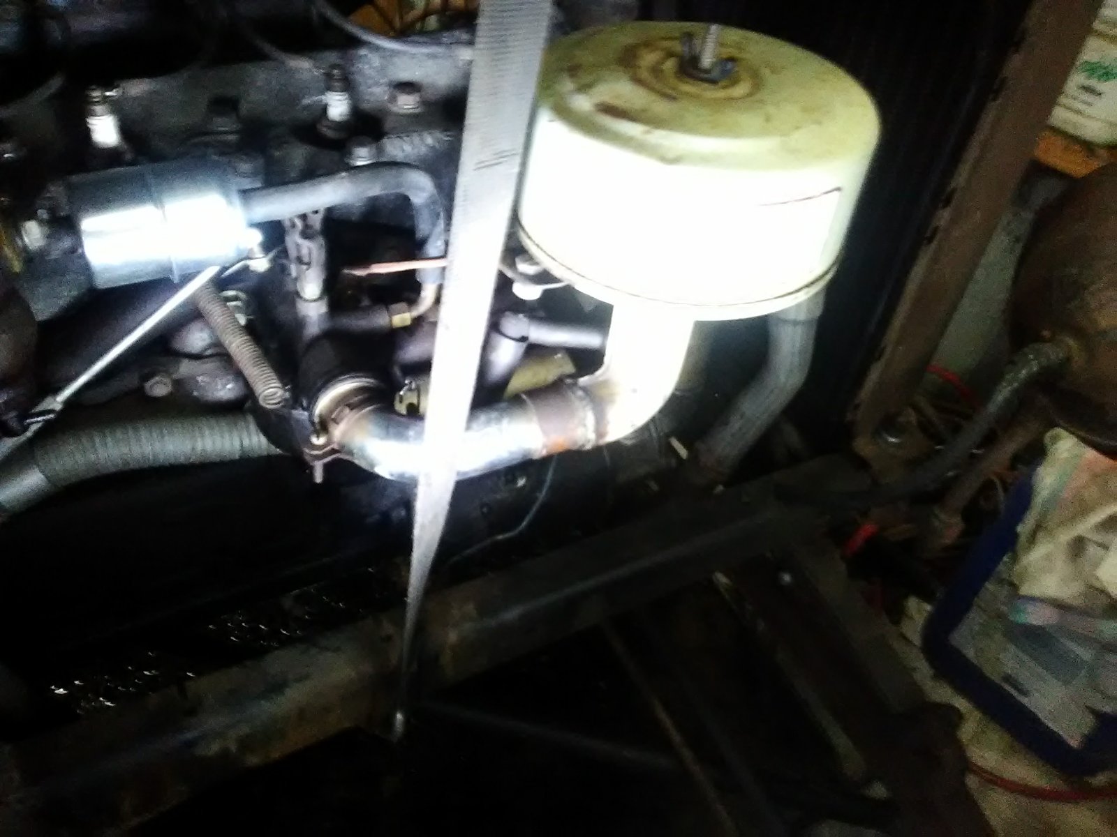

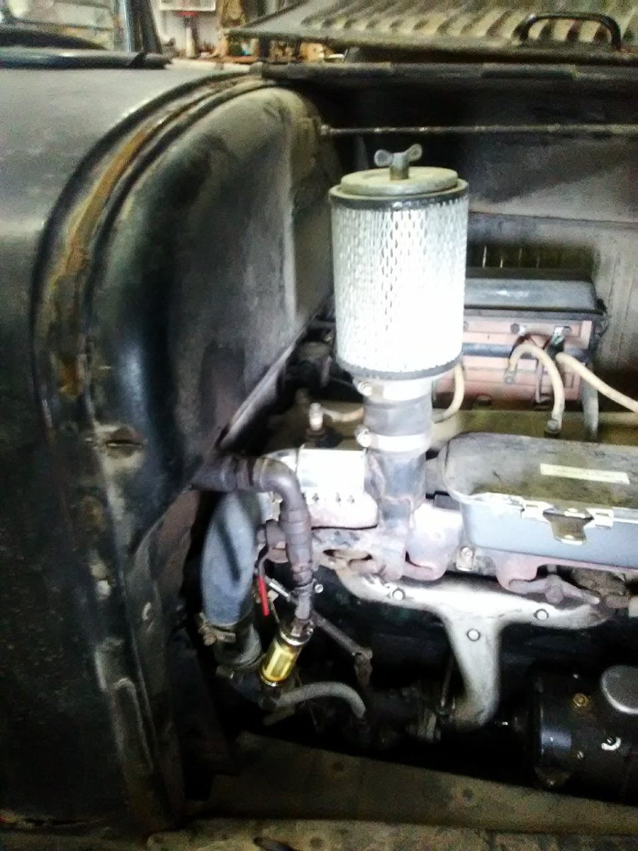

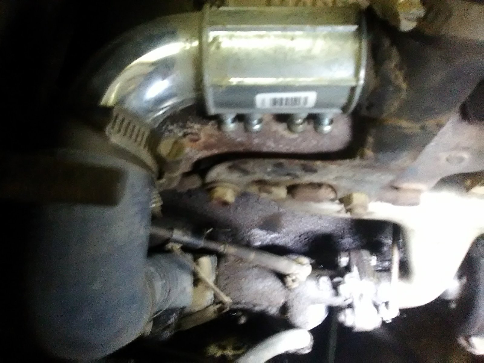

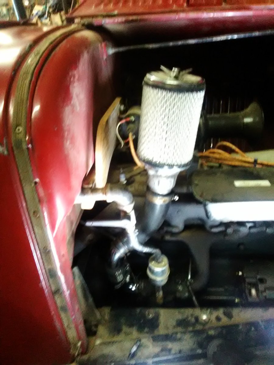

I am retired automotive mechanic and just couldn't drive a T on dirt roads without a air filter. I have 3 Ts with differing designs but all 3 work well,don't ice up and there is no change in performance. I will try to attach pictures of them.

Dennis. Your air cleaners appear to be connected, in some way, to a manifold air heater, so that you not only get the benefit of an air cleaner but also get the benefit of pre-heated intake air. My filter is about the same size as your third photo, but is not connected to a manifold intake air heater. Did you design and fabricate your air cleaners or did you purchase them? I can see where these would work. Thank you. Jim Patrick
Dennis Prince
- Posts: 407
- First Name: Dennis
- Last Name: Prince
- Location: Madras Oregon
Re: Carburetor intake air pre-heater as a cleaner
Jim, I did fab them myself and the first one ts over the exhaust manifold and runs along the manifold giving it time to heat the air. I used a Model A air maze and the over sized filter element, a conduit connector a sink drain pipe and a radiator hose with the right bends in it. I built this over 10 years ago and haven't had any problems with it, I am always amazed at how much dirt the filter catches. The last picture is the air filter on my Funster (built for fun not speed) and I don't run it very hard and only when it is warm, the filter might not be big enough if I worked it like my other cars. It has no preheat but I am running the carb side draft and the intake is above the exhaust manifolds (it has split manifolds and duel exhaust

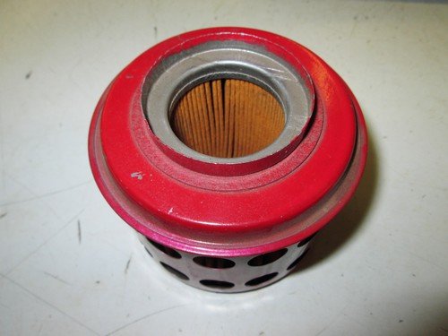

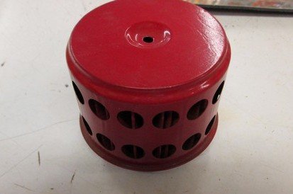

- Posts: 2548
- Last Name: Strange
- Location: Hillsboro, MO
- Board Member Since: 2013
I found an air cleaner for an antique Clinton lawn tractor on Ebay and modified it to fit my T. My seat of the pants impression after three seasons of running is that the car has a small bit of extra power with the filter installed instead of the factory pre-heat tube.
I do remove the filter and re-install the factory pre-heat tube for winter driving.
- Attachments
- clinton_air_filter_02.jpg (34.08 KiB) Viewed 5812 times
- clinton_air_filter_01.jpg (20.91 KiB) Viewed 5812 times
