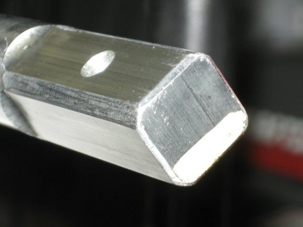

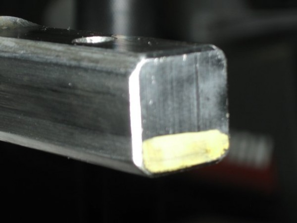

There are 2 issues that I found with the newly made drive shafts, both on the machined square end for the universal joint. The first is the chamfer on the end, they only chamfer the edge of the machined flat surfaces and ignore the "corners" that are left (I apologize for the photo quality, it is the only one that I have):John Illinois wrote: ↑Tue Jan 07, 2020 9:59 amI am using a new drive shaft but I do not have it yet.
John
Be sure to chamfer those four corners. If you look at an original Ford Drive shaft versus a modern made drive shaft you will see that Ford chamfered the entire leading edge and the newly made ones only chamfer what they machined. Those sharp edges can/will dig into your nicely reamed bushing and raise some material and create a bind.
Second, you may need to dress/break/reduce the aforementioned corners down their length to get the u-joint to fit. If you look at an original Ford drive shaft, they not only machined the flats for the u-joint, but also the corners that were left. The new drive shafts leave the corners at a 1.000" diameter and that can create an interference problem when trying to install the u-joint to the drive shaft. Check your u-joint fit to the drive shaft end and if it is tight or does not want to go on, that is your problem. On the original drive shafts, these "corners" were machined flat. Aside from those 2 issues, the drive shaft is excellent, they just missed a couple of steps.
