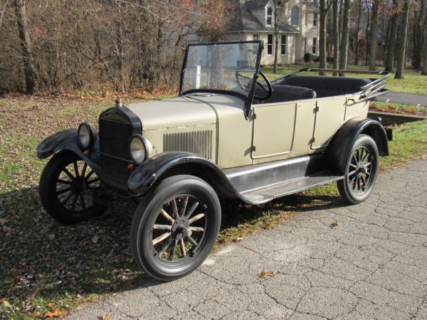

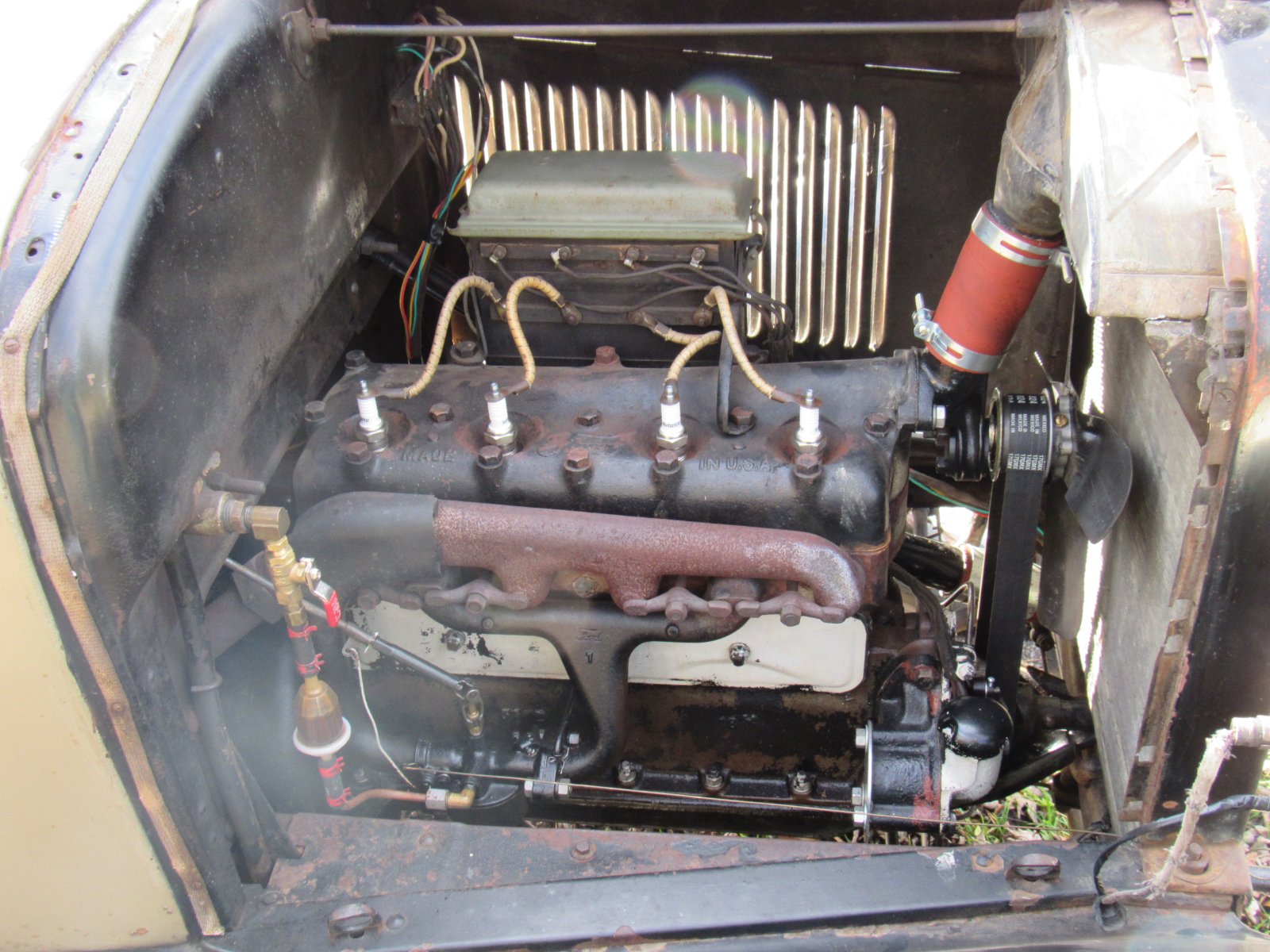

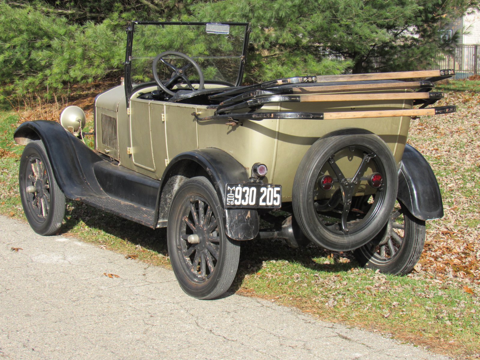

About 2 years ago I purchased a 26 touring (#13926448) last licensed in 1989. Nothing fancy but it does run. Previous owner had installed a rebuilt 25 engine (#11407045), he drove it to my house south of Ann Arbor, MI (only a couple miles) after sale as I had never driven a T. Needed some minor repairs and adjustments, fixing oil leaks, radiator hoses, fan belt, fuel leaks and carb rebuild. Also added stoplights and turn signals (removable) to add some visibility.
The original engine came with it which had been sitting outside 20 years or so after suffering a broken #4 exhaust valve which broke the piston and at a minimum damaged the babbitt bearings. Learned a lot taking it apart. Damage from sitting outside is less than I expected. Think there are a lot of usable parts. the block possibly could be saved but will likely need valve seats in addition to normal machining and babbitt. Rebuilding it isn’t a priority, plenty to do on the T first.
Learned a lot from the forum, virtually everything I’ve needed has already been covered here. Between my son and I have driven the T about 200 miles mostly around the subdivision. Had to adjust the bands a couple of times in the first 20-30 miles, seems to have settled in now. Doubt the PO drove it after installing the 25 engine as it had a major oil leak from the bolt holes which would be attaching the magneto coil ring to the block (was rebuilt without magnets/magneto, has oil slingers) literally left a stream of oil on both sides of the engine. Engine must have been installed some time ago as the fan belt and radiator hoses were petrified and fell apart in the first few miles. Still leaves a few oil drips from various locations but seems normal. Engine sounds good 50-55 psi compression, would probably benefit from coil servicing.
Hope to be working on getting the parking brake functioning this spring which will likely lead to rebuilding the rear axle. Axial play is 0.035” measured at both rear wheel hubs. Wooden wheels seem solid but need to be more carefully evaluated and at a minimum refinished.

That's a pretty decent-looking touring. It seems you have a pretty good handle on what to do with it, too.

Welcome to the affliction! That looks like the perfect model T to me. While the color may not be exactly correct (so who cares? It is a nice color)? It is a nice looking car, and needing a bit of work to sort it out, but basically ready to begin enjoying! It is nice enough to show up and park with other cars and not feel ashamed of it. And just beat enough that to not worry about every little ding or scratch it may get. Seriously. Some of the best fun is had with a car you can lash a picnic basket onto the running board or fender and just enjoy the outing with friends and family!

You say there is not magneto. From your picture you don't have a generator. How do you provide electricity to the coils? Do you have a starter? I would suggest you install a generator and a battery so that you can keep the spark going while driving and also to be able to use the lights. You might not plan to drive at night, but sometimes one runs late and it gets dark so you will need the lights to be in working condition.
Good looking car. Body looks very good. Top looks invisible except the bows!

That's a nice looking old girl. I like the color scheme.

Not much gets past you guys. The original post was long enough and of course doesn’t cover everything. The generator was not functional and not repaired yet, a couple of the brushes were split where the pigtail attaches (never saw brushes fail that way), the armature tests good and the field although wrapping is kind of ragged seems ok, brush plate is a bit wavy. Presently just running off the new 8V battery that came with it for the short trips I’ve taken so far. Lights work now but the right reflector is poor and the headlight ring is glued on with silicone caulk due to rust damage at the bottom bayonet catch. It did come with a top that was never installed however it seems a bit less than supple and the main section has some mouse chewed damage (that had been patched??) so I don’t know if it’s worth the effort to try to install. It did come with side curtains which seem ok.
I agree with Wayne as far as level of restoration is concerned for this T. Currently have two 65 Beetles one that I totally restored 20 years ago that spends most of its time in a car bag and another daily driver which I’ve driven a couple hundred thousand miles as a commuter, on and off road, rebuilt and changed numerous engines, used at scout camp, haul lumber on the roof…. Although I had it repainted and don’t drive it in the winter, it sure has its share of stone chips etc. Guess which one is more fun?

I'm with Don about that color on your nice looking Touring. Looked back at it 20 times or so. Looks really neat!
