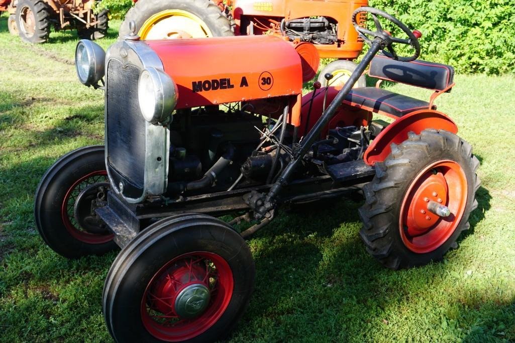

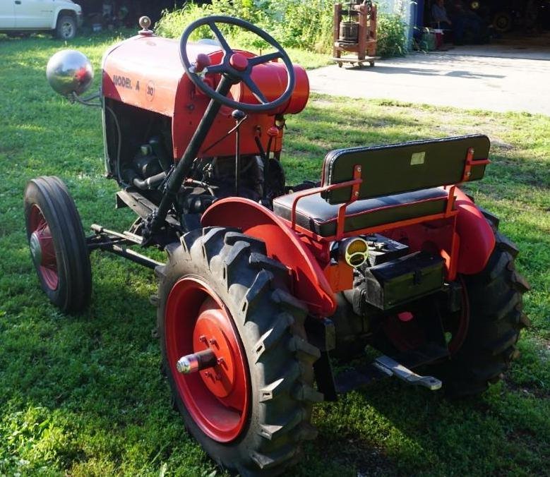

I am new to Model T's as I am a tractor and engine guy. I recently acquired a Doodlebug (farmer built tractor from automotive parts) and it has a Model T rear axle with Ruckstell two speed.
I have a slight grinding noise in the right rear outboard axle. It also gets a little warm when ran for a while. I can tear this down and look for problem, but thought I would seek any advice available here. I can't find an exploded parts diagram and expect a worn bushing/bearing. Any help before I tear down would be appreciated.
Looking forward to enjoying this Doodlebug at Tractor Shows, parades ect--younger grandkids and neighborhood kids already love riding in my buggy trailer behind it. It is a 1930 Model A engine, tranny and frame, Model B front axle and wheels, Fordson tool box, Farmall seat and fenders, Model A lights, and of course Model T rear end with Ruckstell split and Budd Wheels.

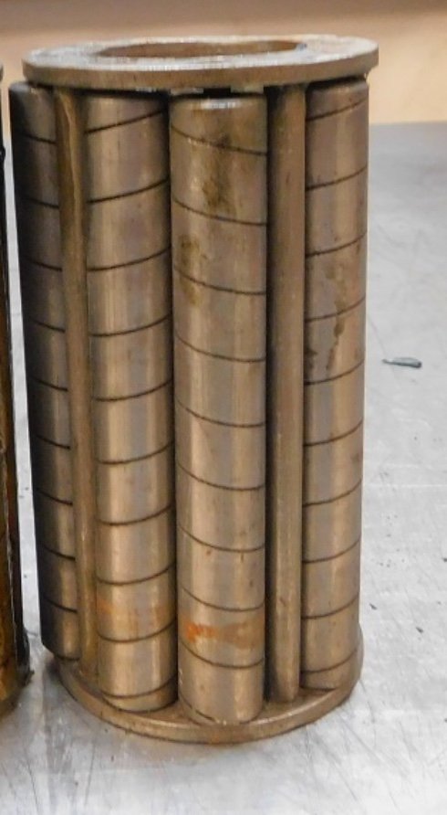

Is the rear axle a Model T axle and driveshaft? If so I suspect it would have to be cut down. Model T rear axles were supported by Hyatt bearings both just outside the differential and just before the wheels. Not your typical wheel bearings at all. Pictures of what you have might help.

The axle you have there is from a TT, or "Ton Truck". It takes a larger Hyatt than a Model T rear end I believe.
Since it's a low speed affair, try researching Berliss bearings. http://www.berliss.com/
Re: Outboard noise Right Rear axle
I have found bearings available for the T rear axle, but not for TT. Is there a difference in OD measurement between T and TT axle housings?

Yes TT larger bearings. Someone here probably has a set good enough for your project. Post a wanted add in the classifieds. I have several TT rear axles but I have major project going in the shop and no room to tear one down mining for usable parts.
