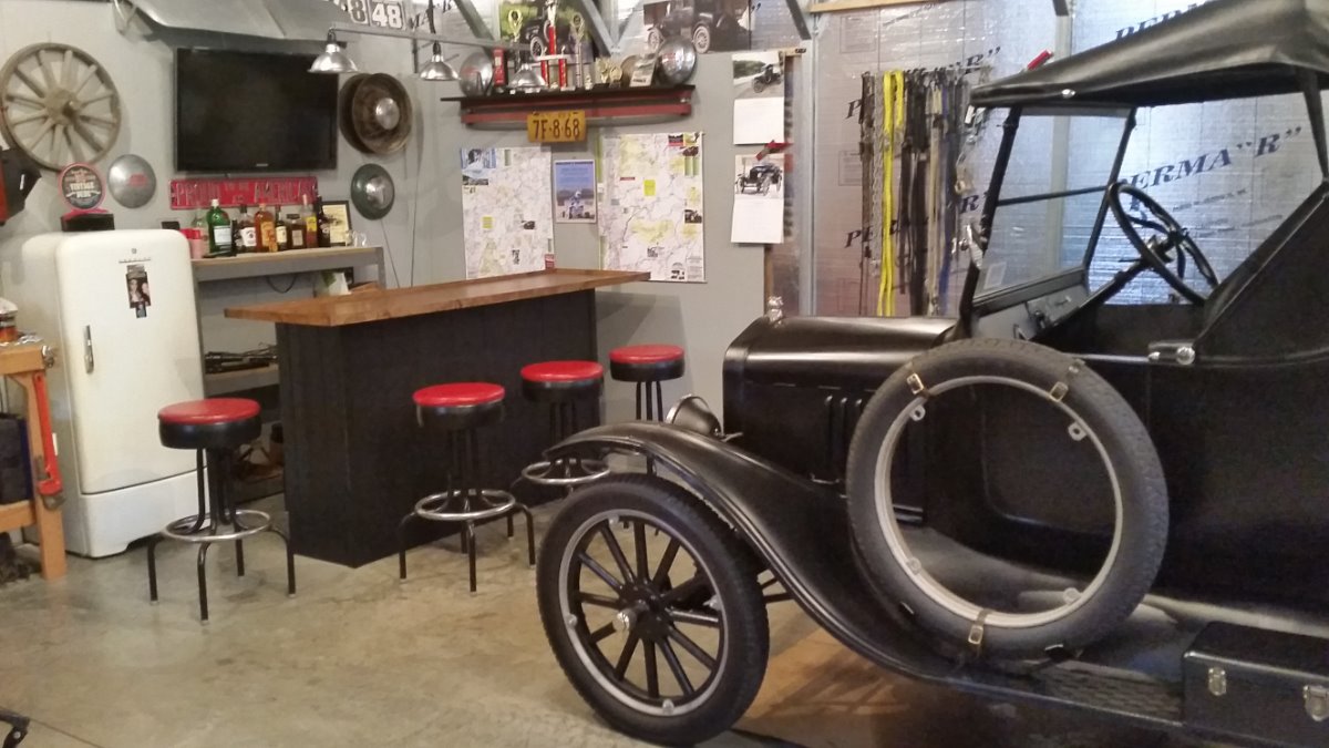

Not much but I built a Man Cave so I can visit the Ts in a comfortable setting...

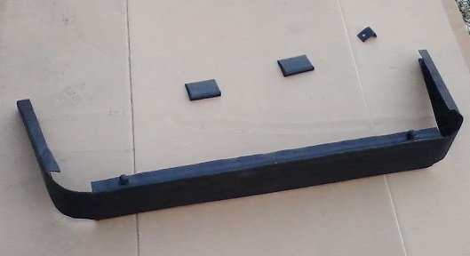

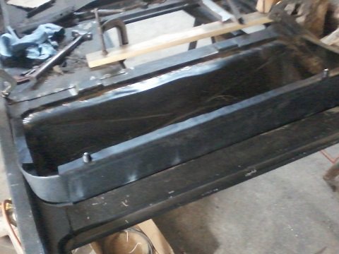

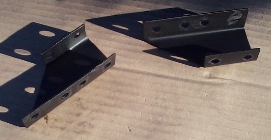

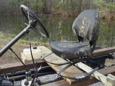

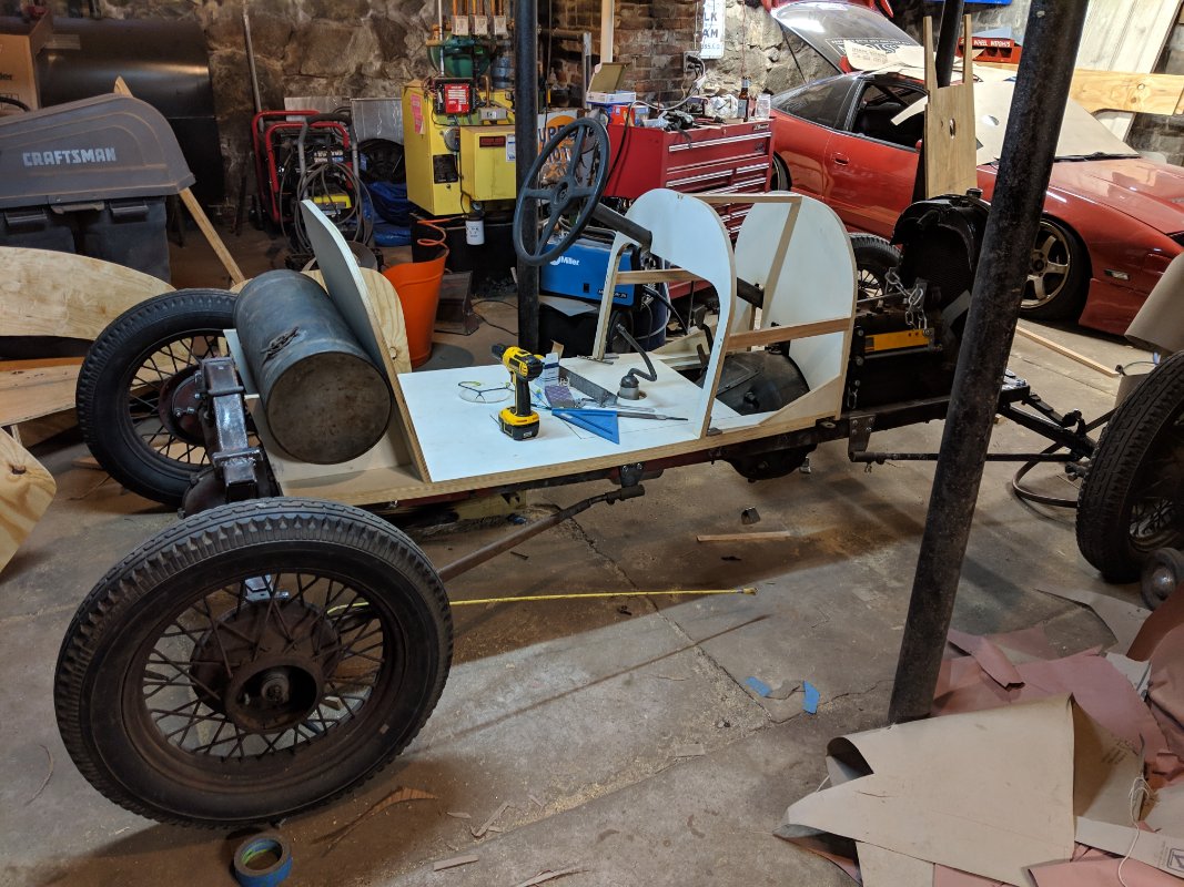

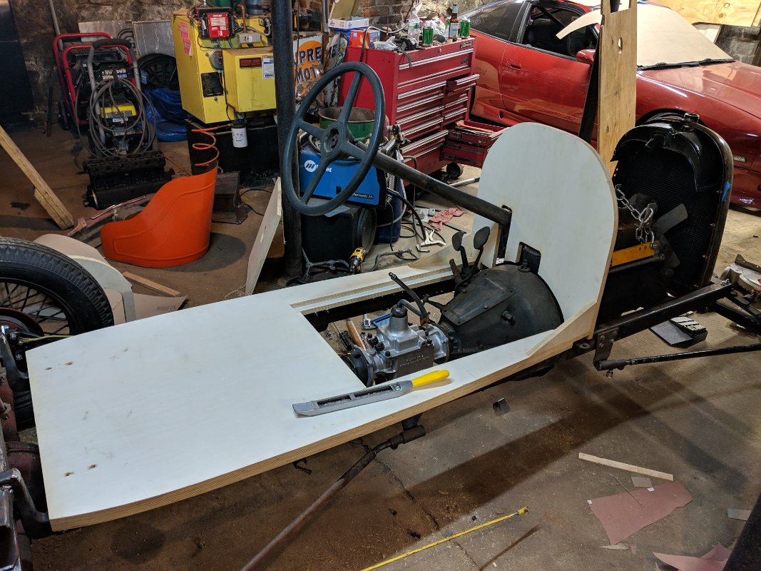

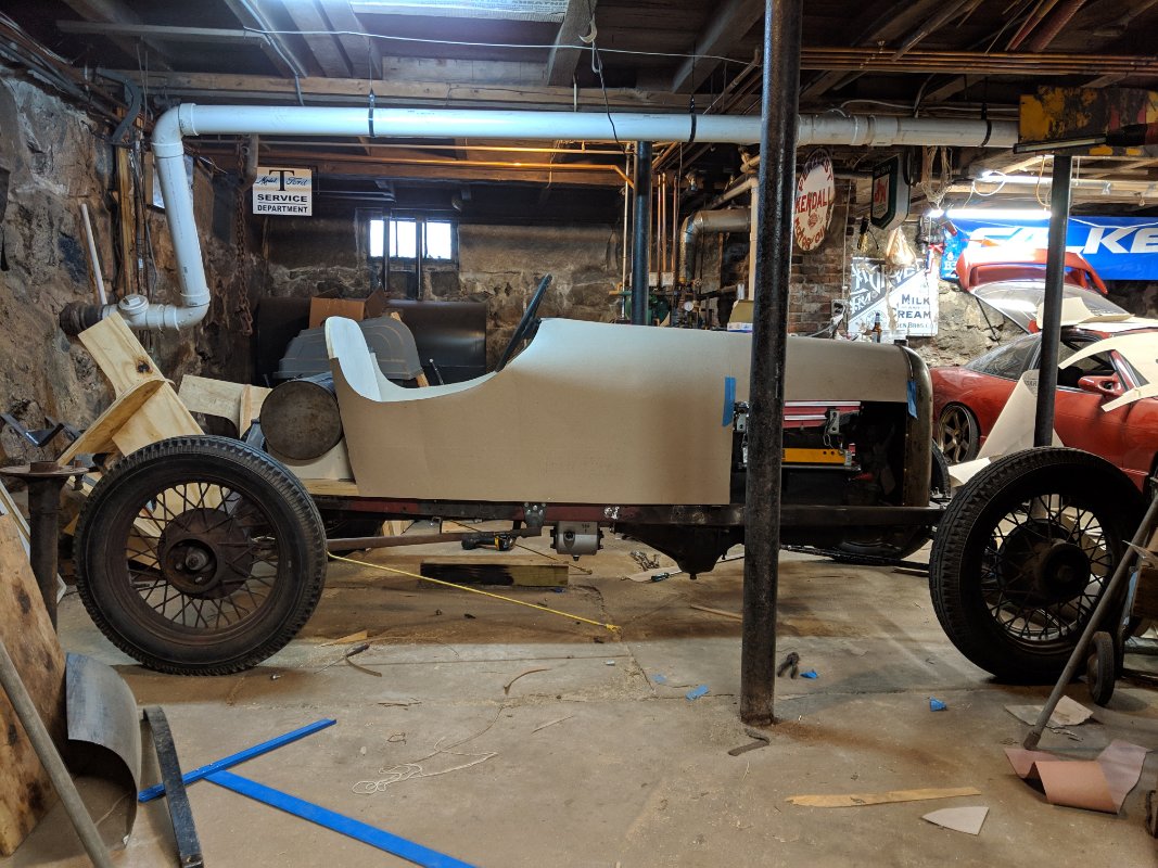

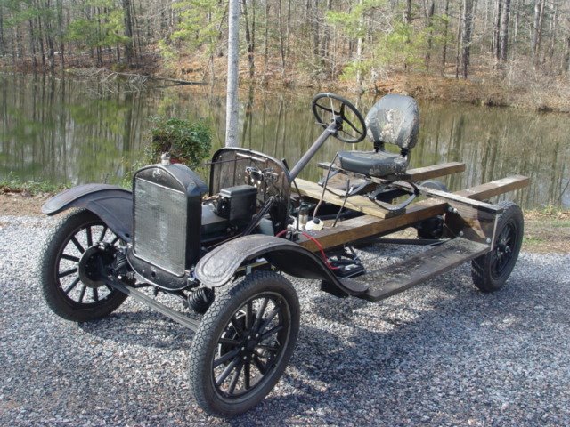

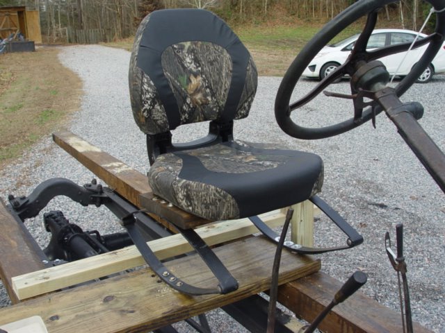

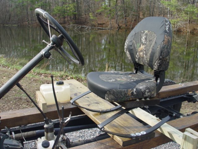

I put the driver's seat in my TT. This is the only planned seating so far. It is on buggy seat springs for comfort, and is a boat seat so I don't have to park the TT inside.
TT driver seats tend to aggravate me, they are too close to the wheel and cramped. I can not even get in the driver's side on a lot of TT's, and I am not a big guy. I adjusted this just for me, the right distance back for the pedals and the right height. I have only done a couple of hours of test driving, but it is very comfortable.
I like the ease of posting pictures on this new forum. I suspect they come up in opposite of the order one inserts them, so if you want to post a lot of pictures in a certain order in one post you have to put them in in reverse of how you want them to show up?

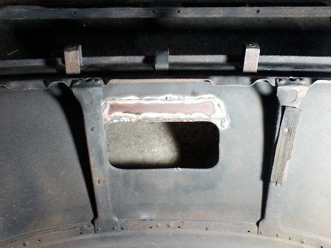

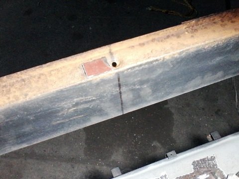

Welding up some holes in the cowl and above the windshield.

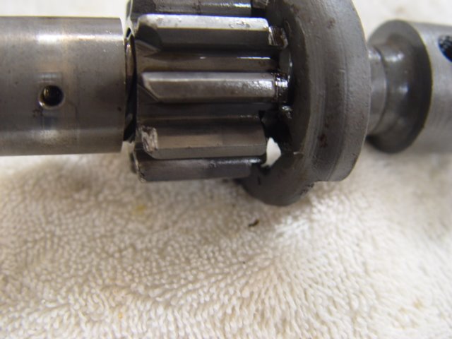

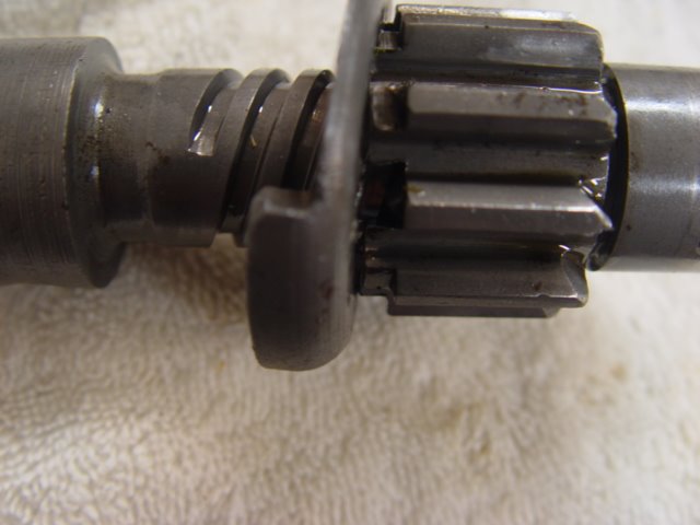

I replaced a broken Bendix. Don't you hate it when that happens?

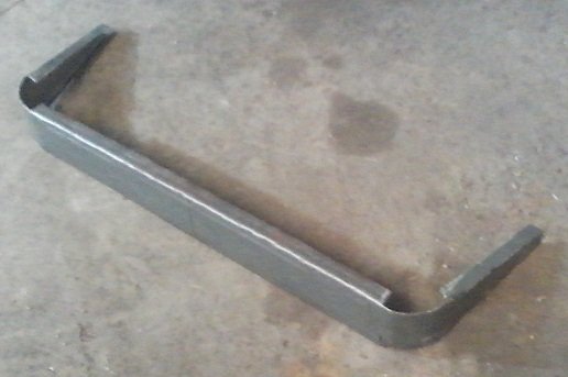

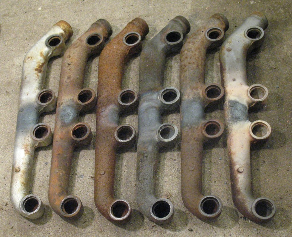

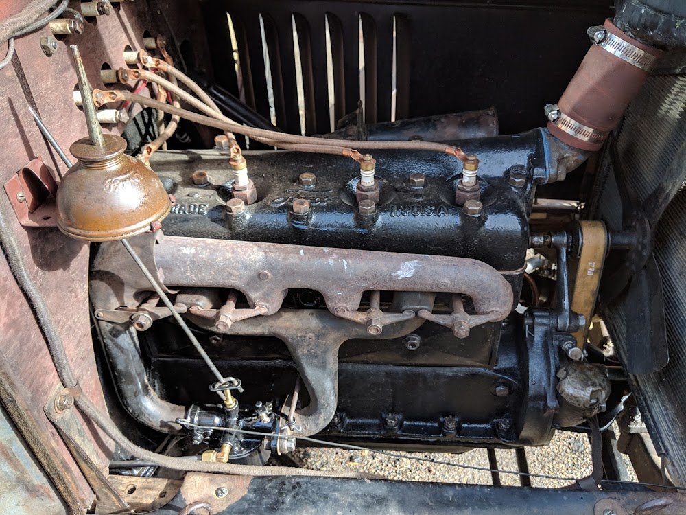

Finished straightening a batch of exhaust manifolds. One will go on the 1915 runabout, I'll keep a couple for spares, and sell the others.

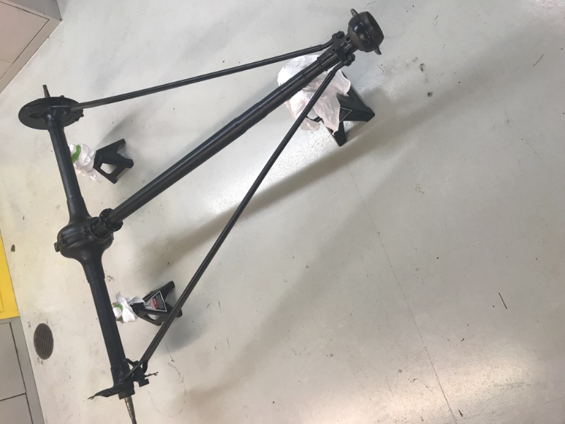

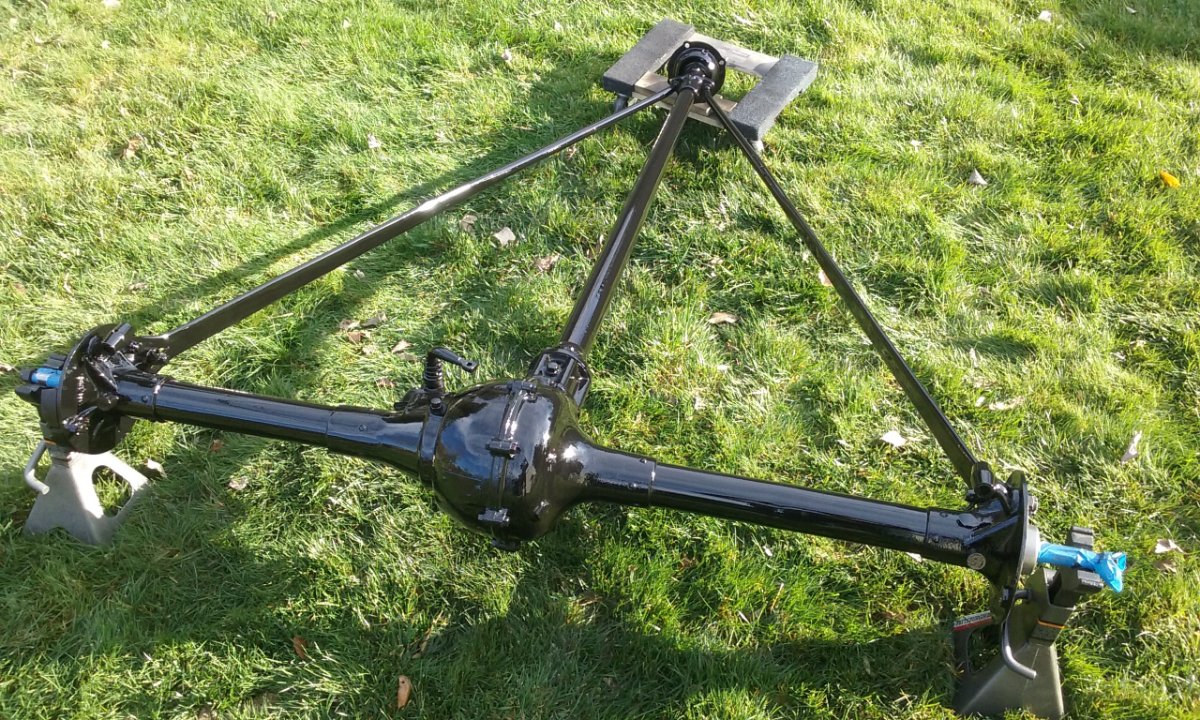

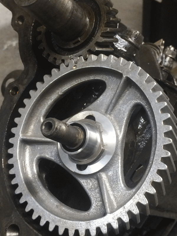

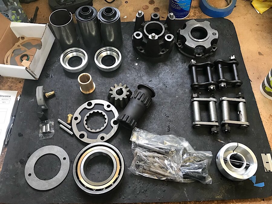

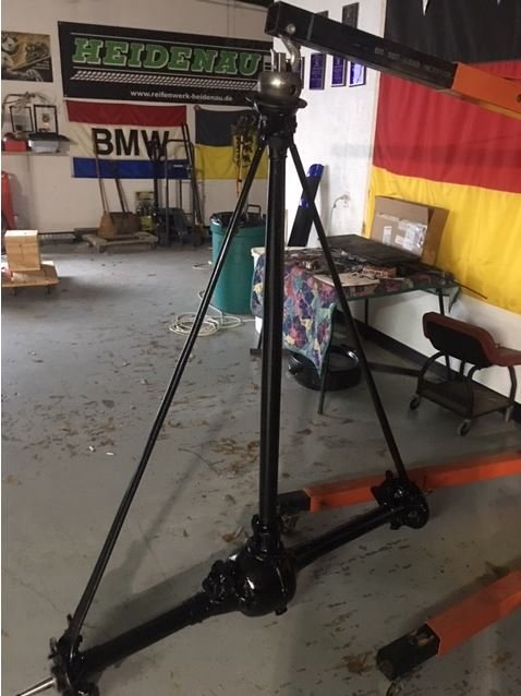

So many things... in fairness, I started all this the last weekend in Dec.
Finished the December Ruckstell rear end total rebuild incl straightening axle tubes and got it all back in the car
New fun projects adjustable pinion bearing. Nice design, great upgrade.
Got rid of most of the new pinion noise. Grrrrr....
Installed New safety hubs - what a pain, but worth it
Rebuilt steering shaft bushings & installed “new” wood steering wheel
Quick Front end alignment - it was actually toed out 1/4” vs in. No wonder it wandered.

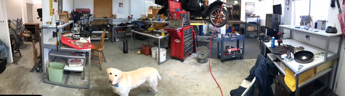

Put all new workbenches and LED lighting in my shop - Sears went out of biz and sold everything
Rebuilt the starter w new bushings, bearing, and brushes, rebuilt Bendix & New starter switch
Ordered a New radiator from Brassworks to replace the previous multi-leak version
New pulley, fan and fan hub
Installed new wiring looms throughout
New rear shackles
Adjusted the generator 3rd brush and now the battery actually keeps a charge.
Finished programming and installing a cool blinker system that runs on 6 volts and turns off automatically after making a turn. More on this in a different post.
I’ve only been able to drive it 3 days this month so far. It been raining non-stop.
Ok, back to sleep now...

Tom Hicks,
Where's you gas tank?

Jeff, if you do a lot of driving, especially on less-than-perfect roads, let us know how the new radiator holds up.

In the second picture, on the far side, below the steering wheel, you will see a 2 1/2 gallon plastic tank from a riding mower. It is my test tank, it has a line with a shut off valve and filter. I'll remove it after I install the permanent tank and use it on my engine test stand.
This TT has a long way to go. Right now I am just test driving to make sure the drivetrain works properly.
I don't know where the final tank will go, but it will be high enough that I don't need a fuel pump!

So your putting the gas tank on the roof, yes ?

I don't think it will have a roof, but it is design/build as I go along. Next is the driver's side front fender and running board. The running board will go back almost to the rear tire, and the running board's rear support will probably include a brace which will support the tank close behind the seat. I have to do a mock up and play with it some.

[/quote]
Replaced? I welded mine together. It's not a bad solution
[/quote]
Yes, an excellent solution for someone with welding ability and probably srtonger than the press fit which separated on mine. I do have a small buzz box and som 1/8 rod, and I could probably make it stick together, but I am not a welder and don't trust my work. I have too much to do to spend time monkeying around with a broken bendix and then possibly having it fail again. So I replace and put the broken one on the shelf, maybe one day when I have more time...
[/quote]
- Posts: 7260
Re: What Have You Done To Your T In January?
Tom, when you get to fix it, you will find iy's not a press fit. Rather, there are lugs to locate the counterweight, and these are upset to essentially rivet the two pieces together. These tend to let go to give the problem you experienced. Those same lugs are a big help locating the two pieces prior to welding. I have found many such repairs made by bronze welding the two together. Today a mig weld might be quicker and easier.
Hope this helps.
Hope this helps.

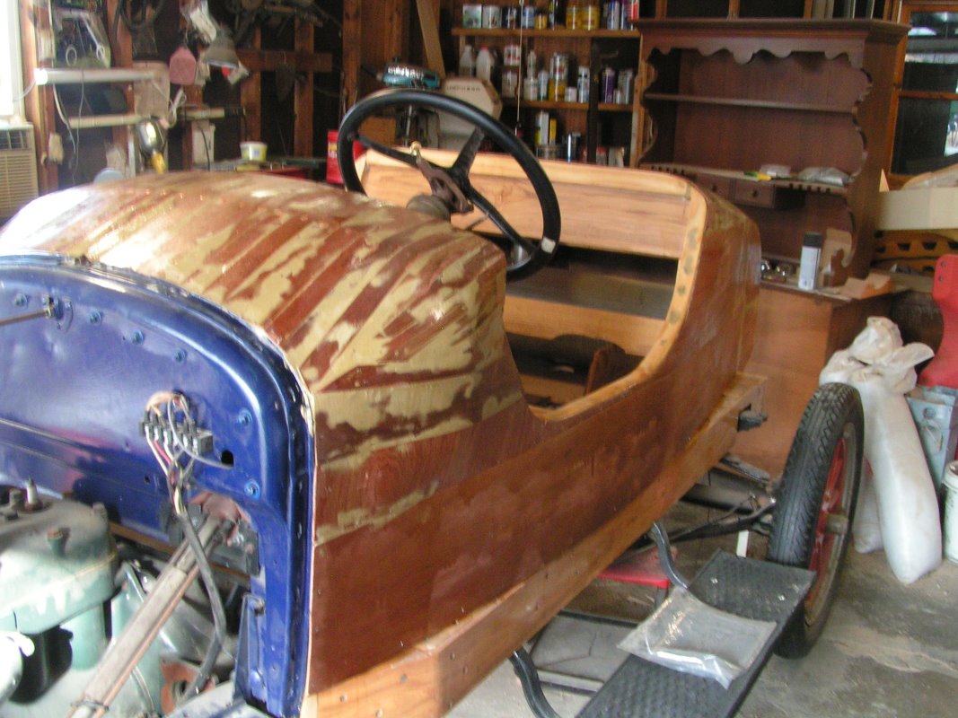

Watched and waited for varnish to dry, don't like getting the surface to messed up. Next step, come spring is laying wet canvas over this, then varnish and sanding before painting and finishing the cockpit.

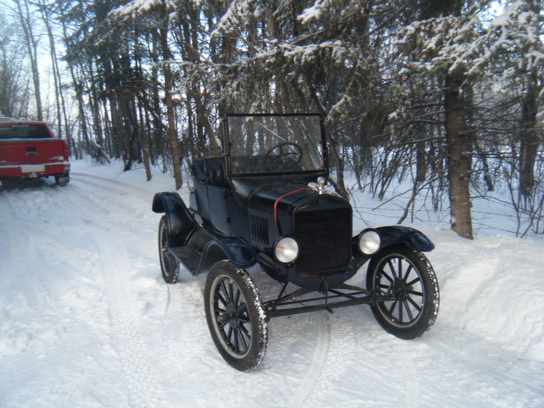

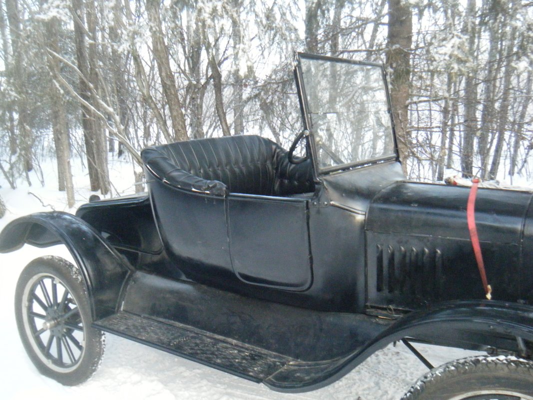

hi I picked up the t from the guy that put in the upholstery pictures are at his place bernie

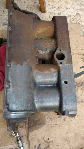

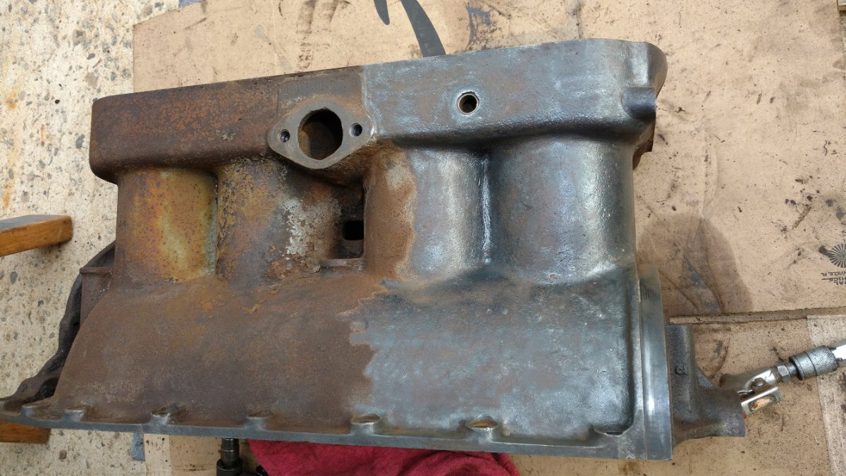

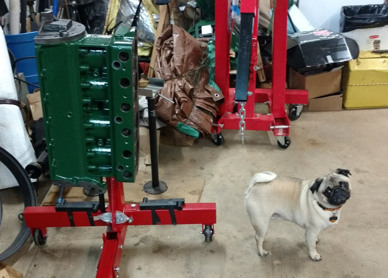

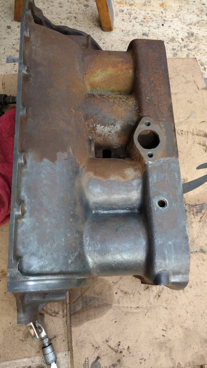

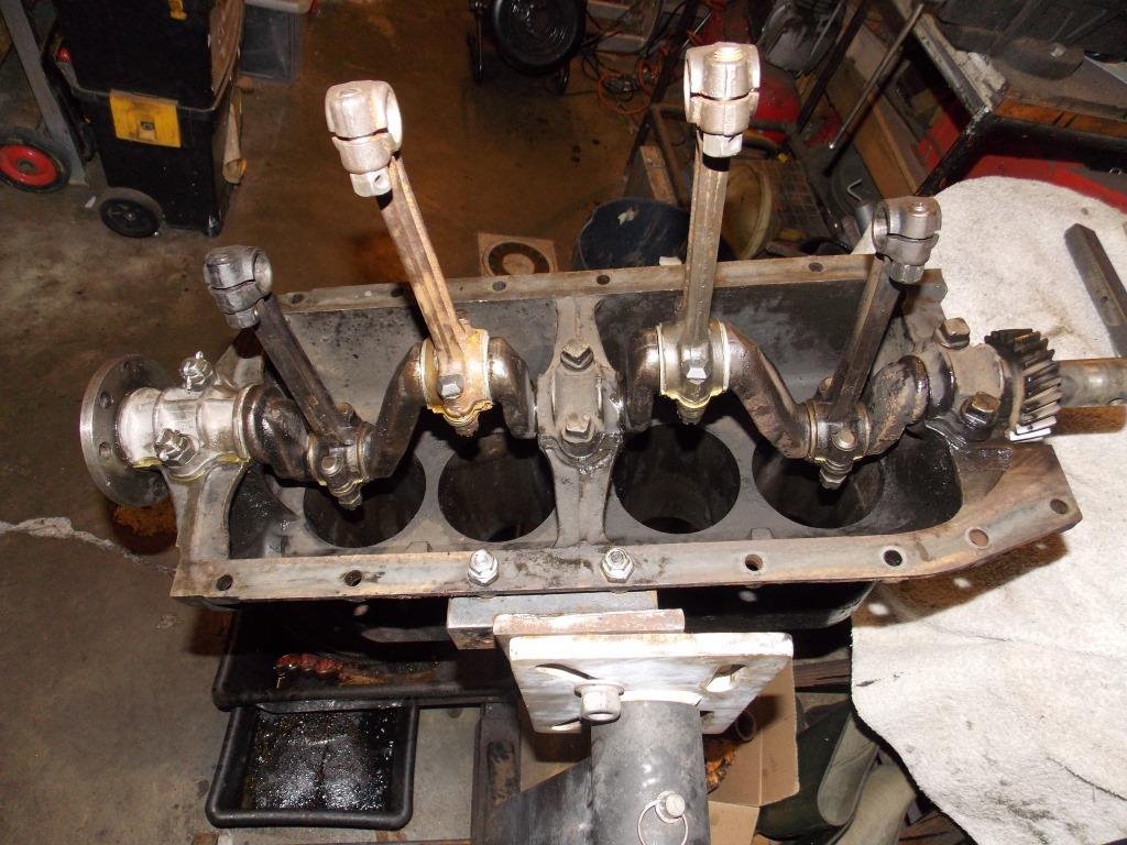

Well, I promised to get my block married to the pan last month, but it didn't happen. Three days ago it did........and everything fit like it was supposed to! Well, except for that modern oil seal....it needed a little "modification" but it looks like an engine now instead of separate parts. Next up, 4th bearing re-babbitt and new wood bands.
Haha! Hi Bernie! Glad to see you here and posting pics! You have it sorted I see!
Pssst. My 18 doesn't have any upholstery in it yet. Don't tell anyone.
George, It is good practice to align the pan when fitting it to the block by having the fourth main in position over the output shaft. I put the two bolts either side of the crankshaft in first, slip the fourth main in place to keep it in line, and then put in the remainder of the bolts. Without the fourth main, things can be well out of line. If your remetalled main does not line up when you come to fit it, you might try following the above steps.
Hope this helps.

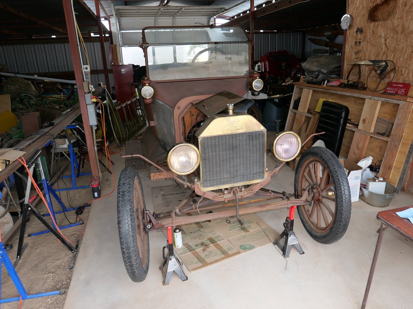

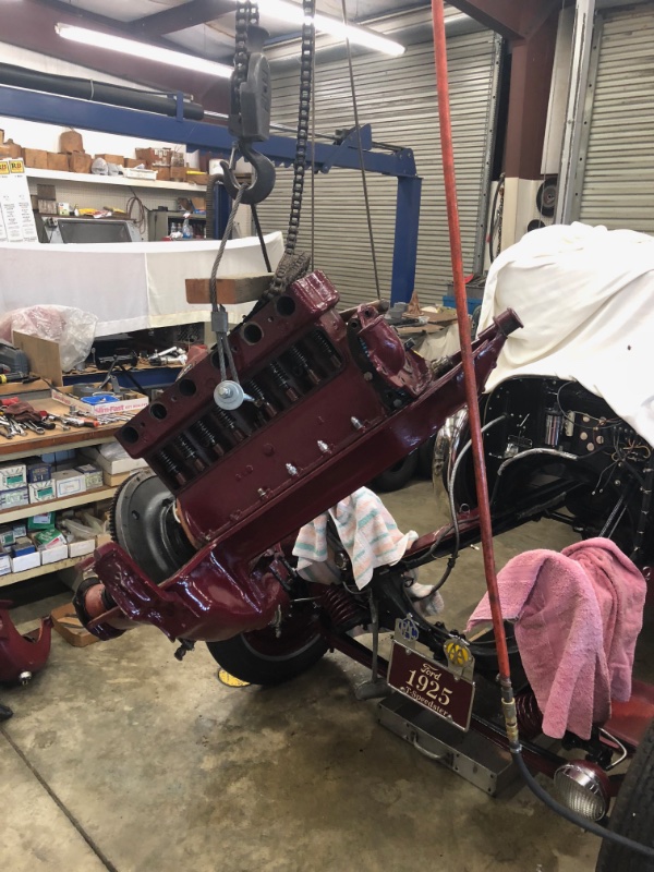

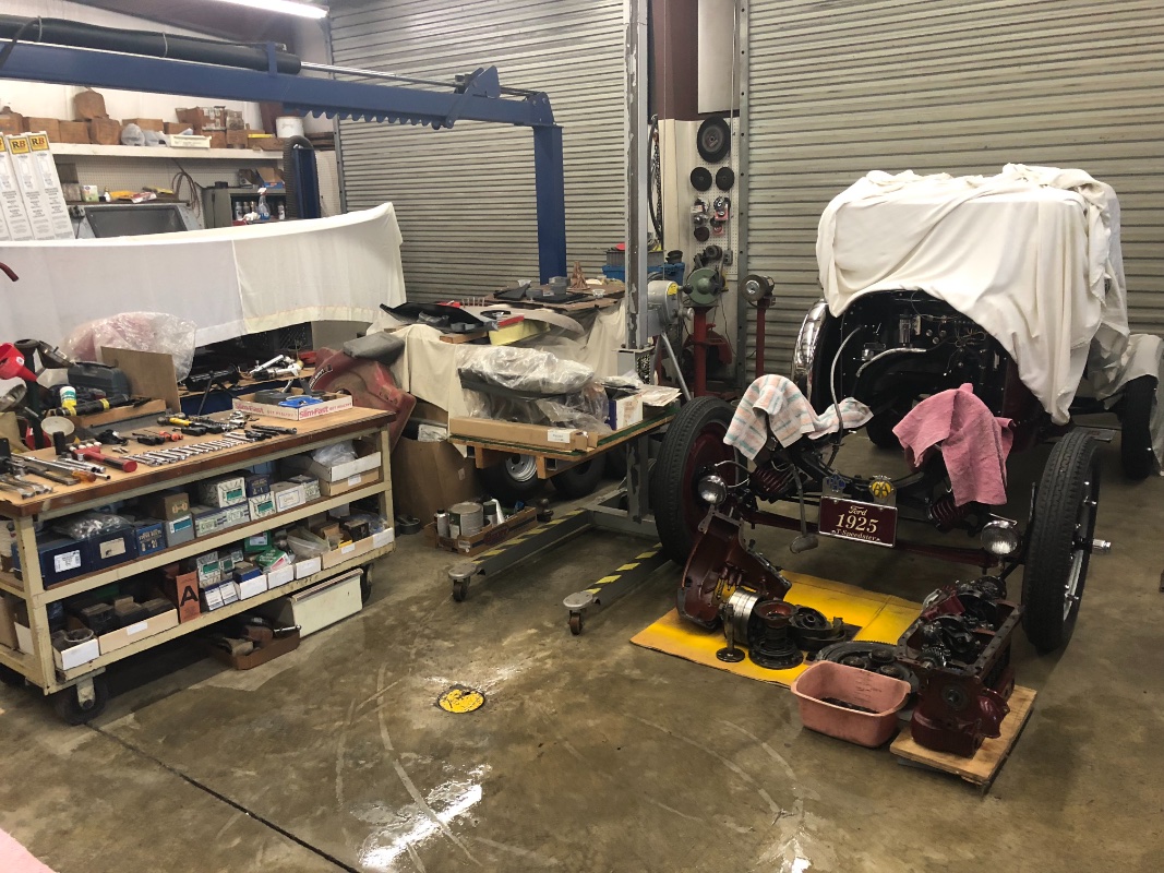

Pulled the magnet eating monster out.
Now cleaning, setting everything for the new engine and transmission.
Therapy! She will up and going again in no time.

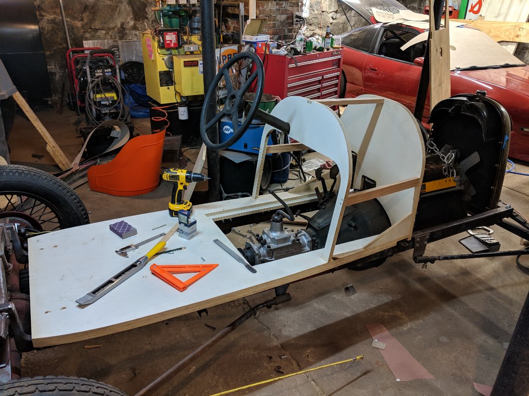

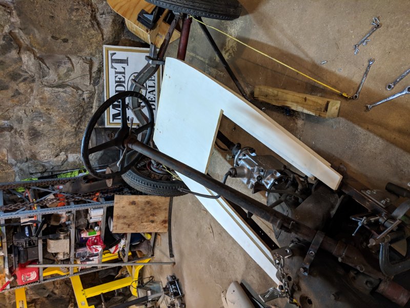

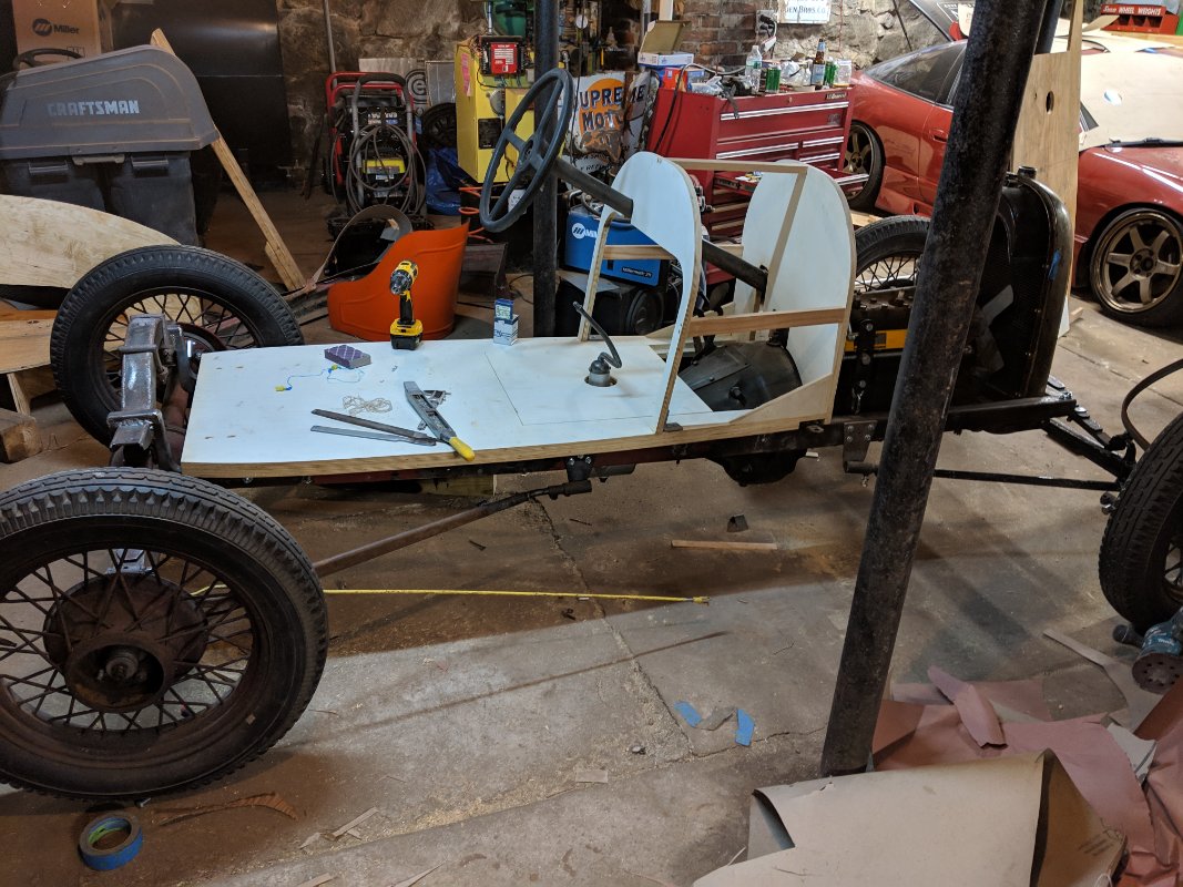

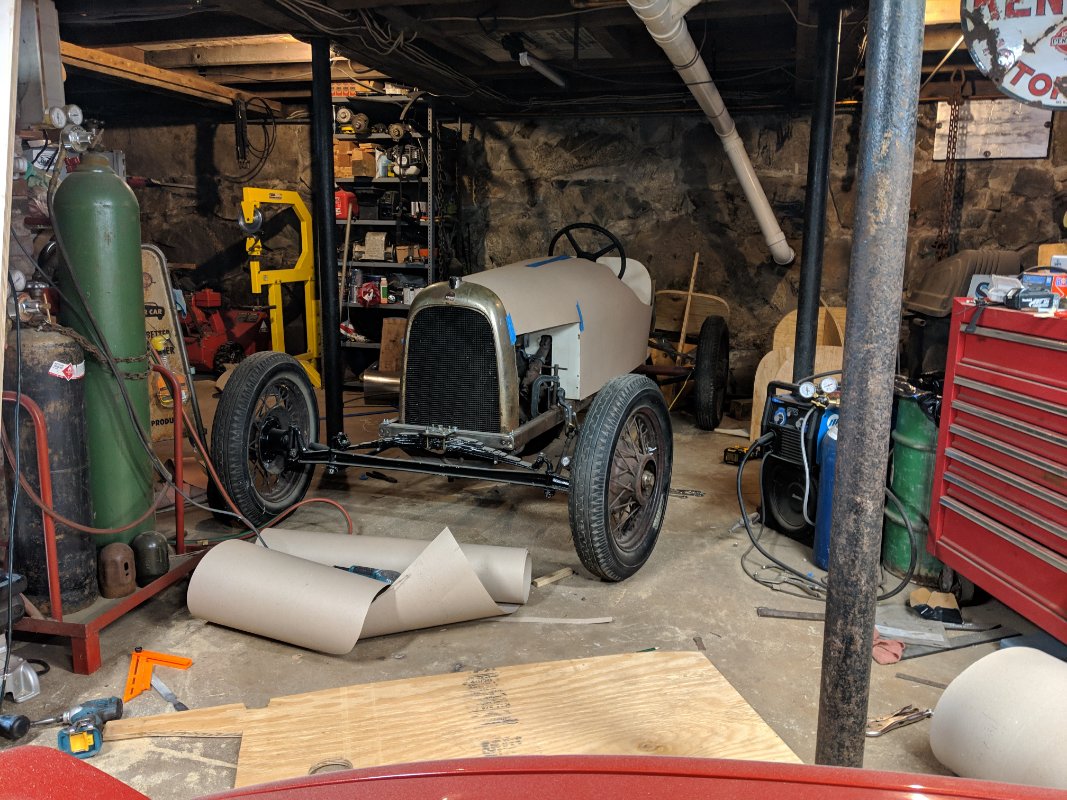

Working on building my speedster body skeleton. It's slow going but it's getting there.
Shane Lach
- Posts: 246
- First Name: Shane
- Last Name: Lach
- * REQUIRED* Type and Year of Model Ts owned: 1927 Tudor and 1921 speedster in progress
- Location: Milford, NH
Here's how she sits with a couple templates in the making

Finally had some weather nice enough to get out and spray some paint on my new Ruckstell for my 15'.

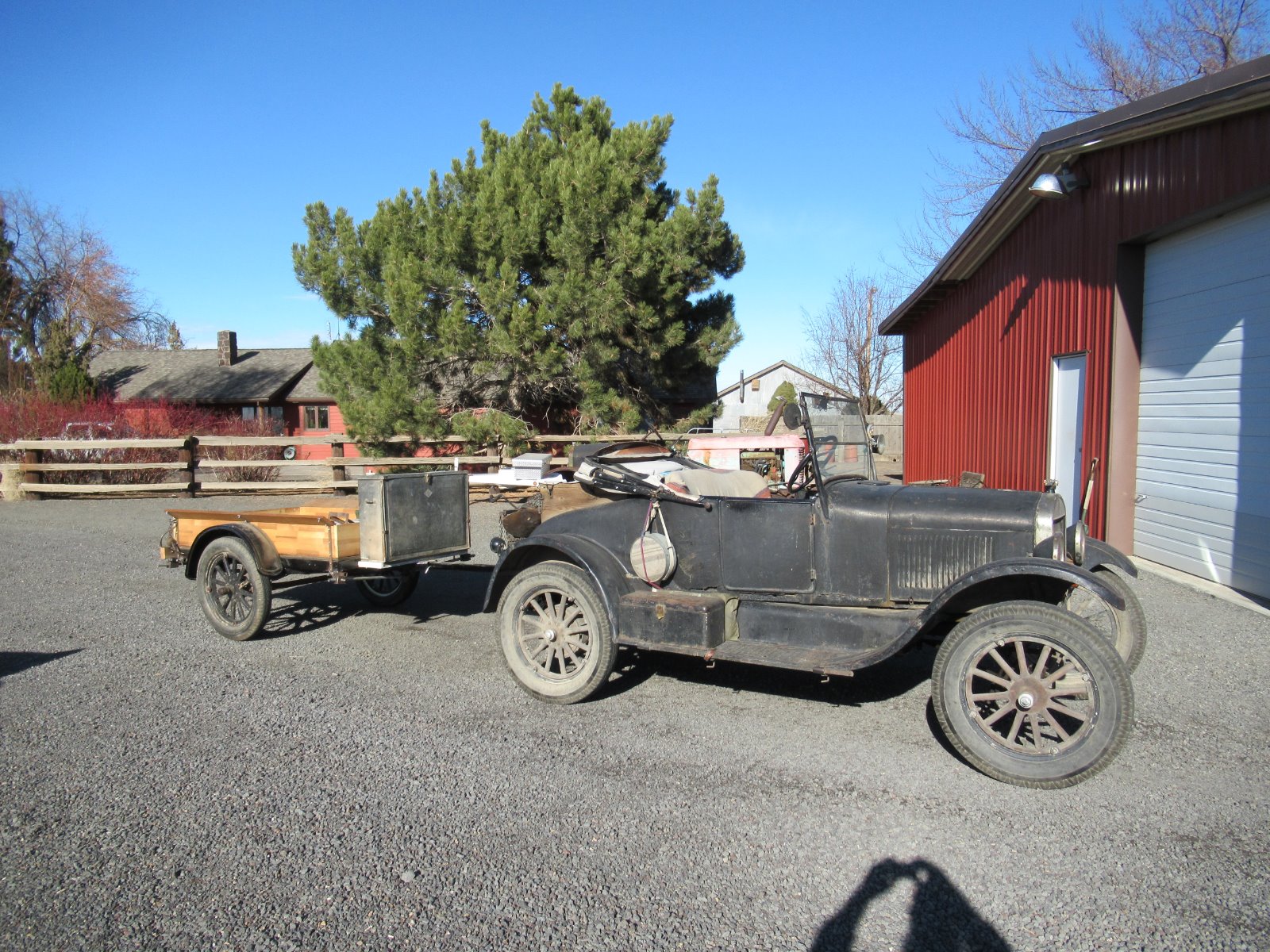

Not much to report here but I took the coupelet out for a little spin this afternoon and she ran well, shifting is getting better the more I drive. Plan to attend Cars & Coffee next Saturday.

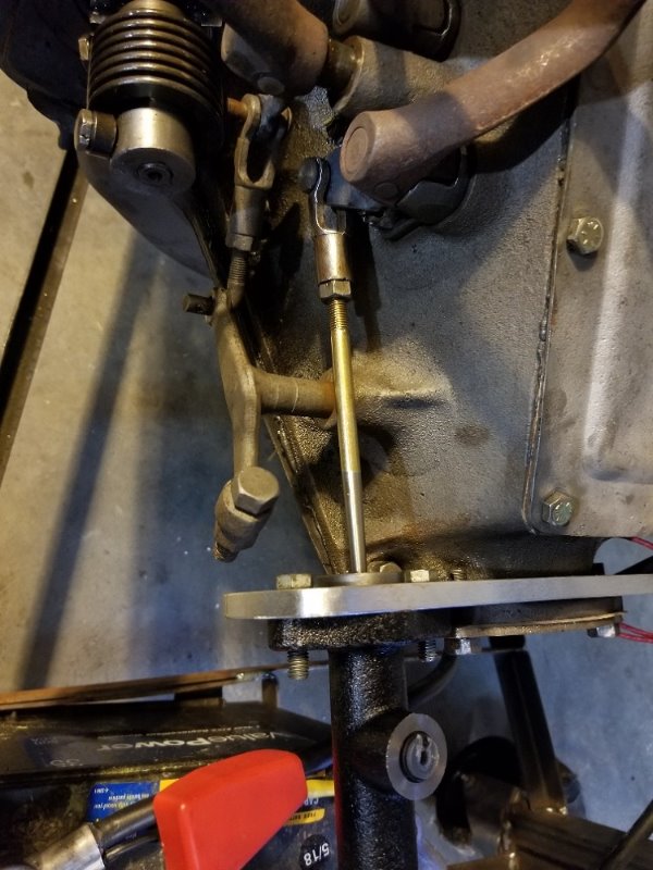

I’m getting my new steering gearbox ready to be installed. I milled the slot for the stop pin to match the later version. I filled and polished some dents with silicon-bronze weld wire. The gearbox cover is too pitted to replate so I filled pits and painted it for now.

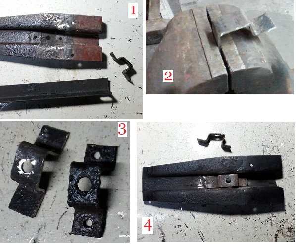

More rear center bracket below deck lid this evening.

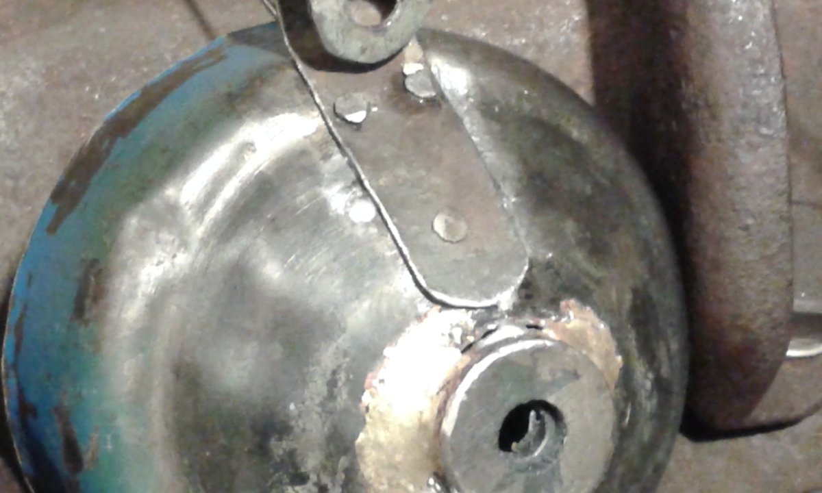

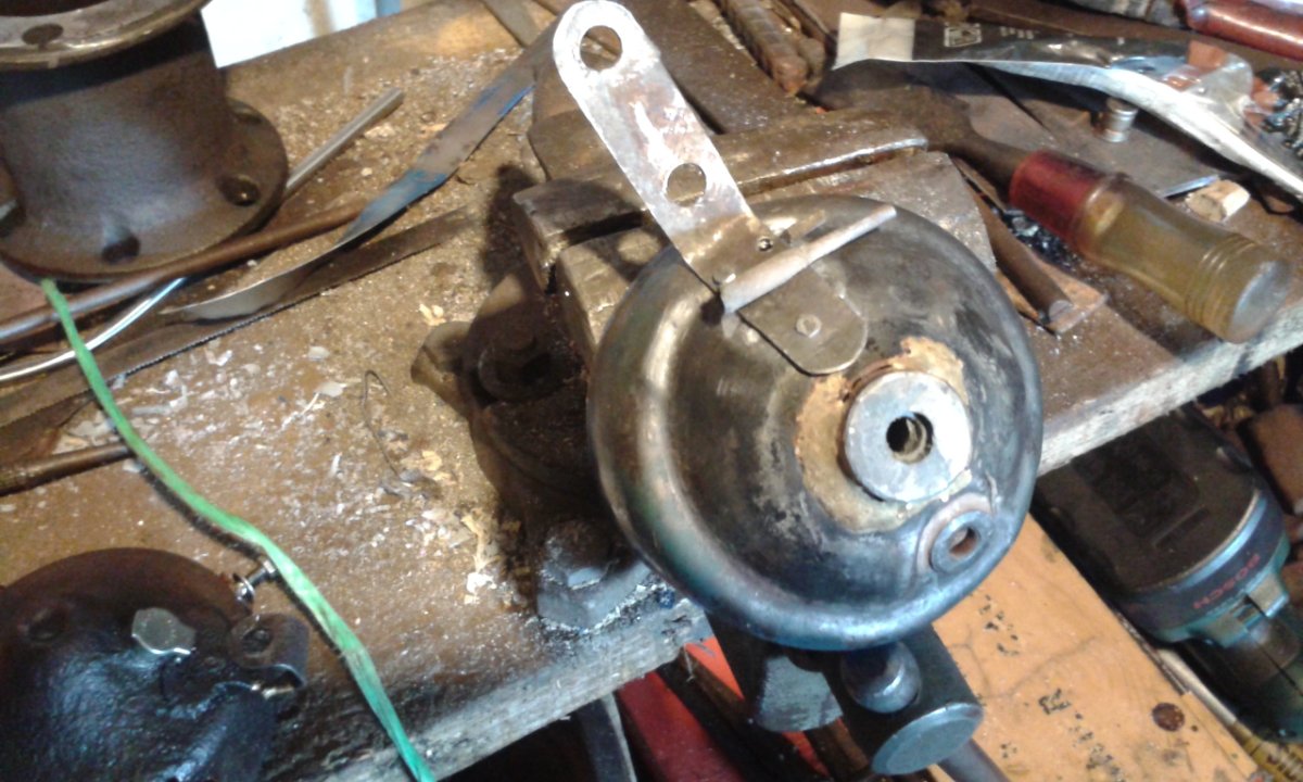

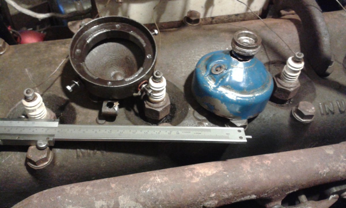

Started making a right hand drive friendly timer because the left hand drive one is getting to a point where it can't be skimmed true anymore.
See that stump of welding rod? That is the rivets,and the arm is also soldered for good measure.

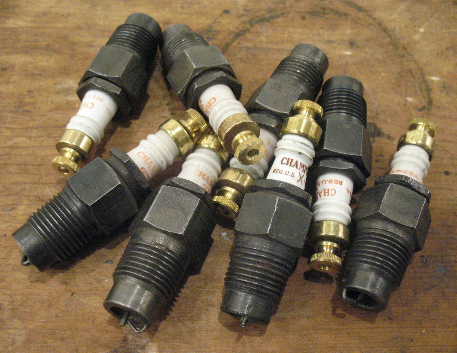

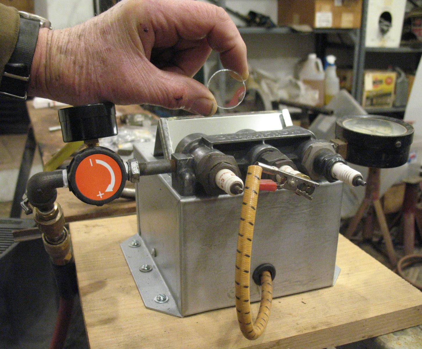

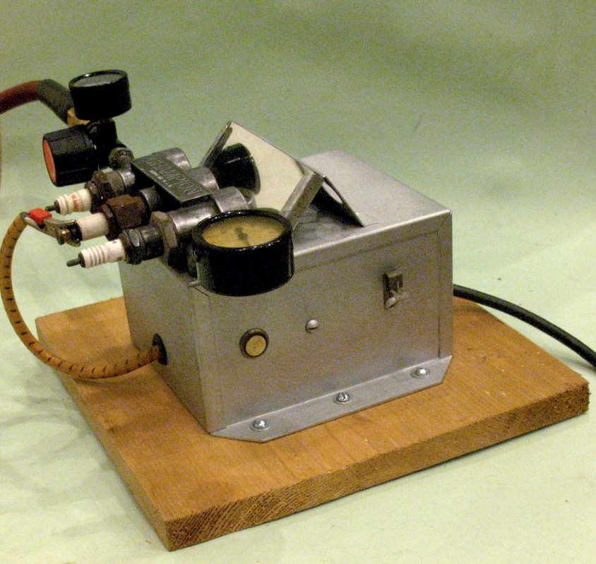

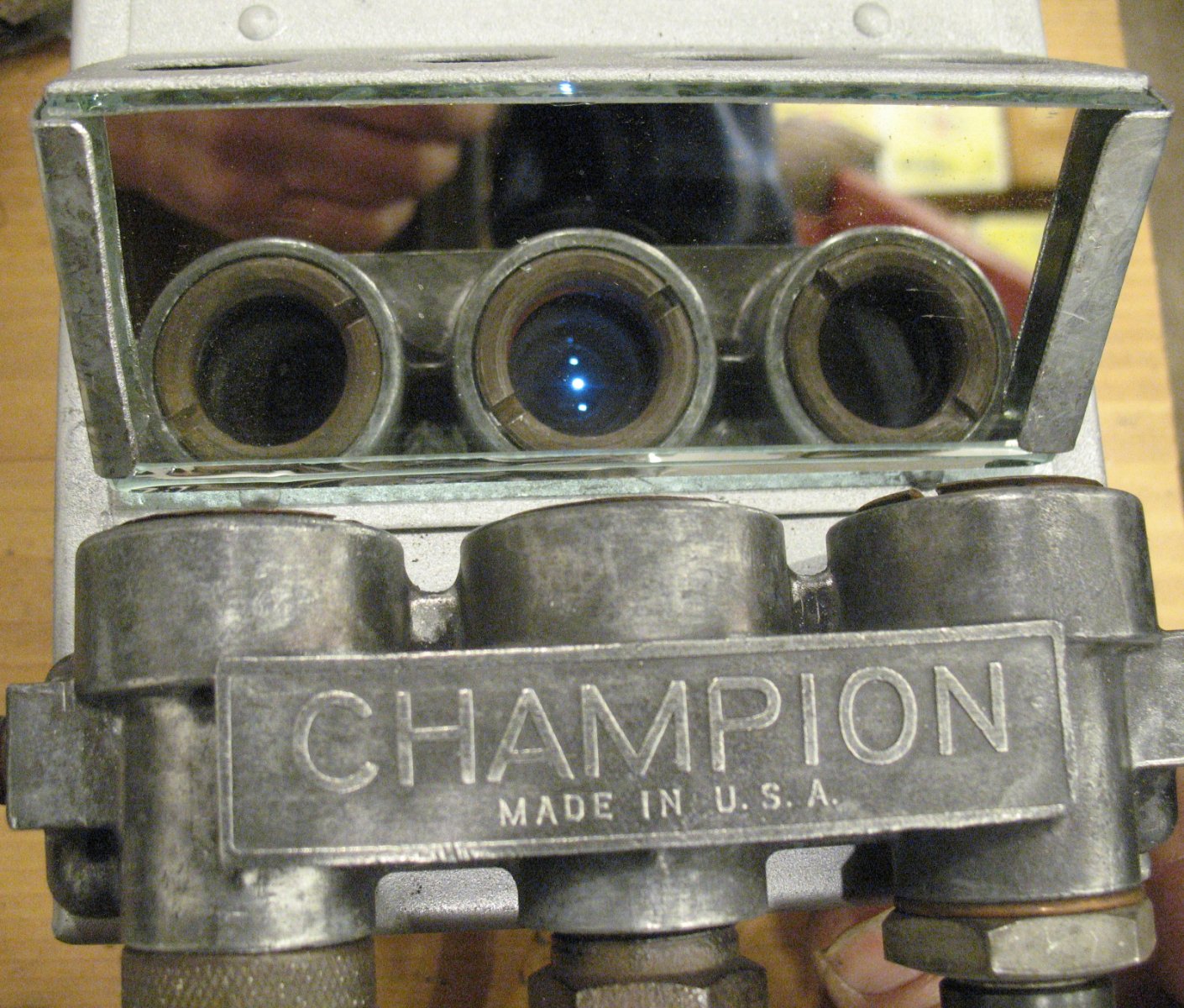

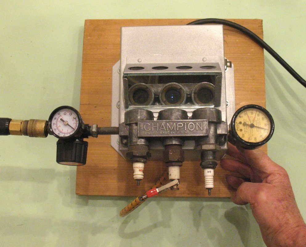

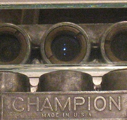

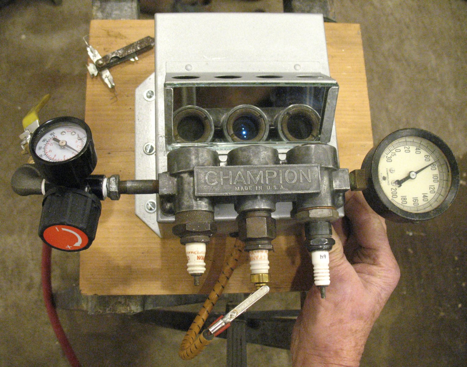

I didn't do this to my T, but for all my T's (and other vehicles too). I finished my 1932 Champion plug tester. The best part is that it actually works. Yesterday I thought I might have to buy a new transformer to replace the broken one that was in it, but I found a good one in another old tester. Miraculously, everything else I needed for it was available locally.
I kept the old time ground clip, but with a new grounded power cord the clip is just decoration.
I used a Fordson tire pressure gauge and a HF regulator to set the compression.
If the plug is good you see a spark in the little window when you press the button.

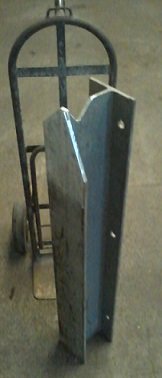

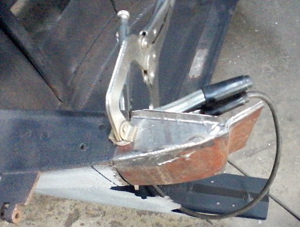

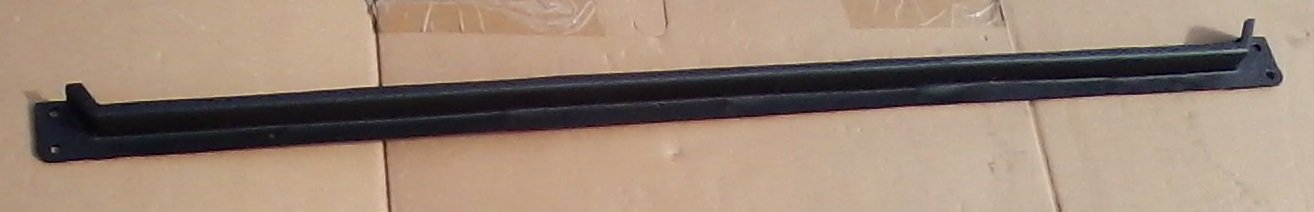

Made A-pillar to sub-frame brackets, left and right side. Hardly anything left of the original.

Finally got the rear axle together for my speedster project.

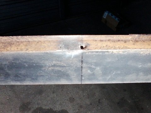

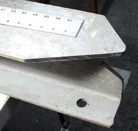

The last brackets we made were difficult to flatten on a 6" train rail. So, I went to the scrap yard today and bought 94 lbs of scrap for a home made anvil. All we have to do is save $32 to break even,

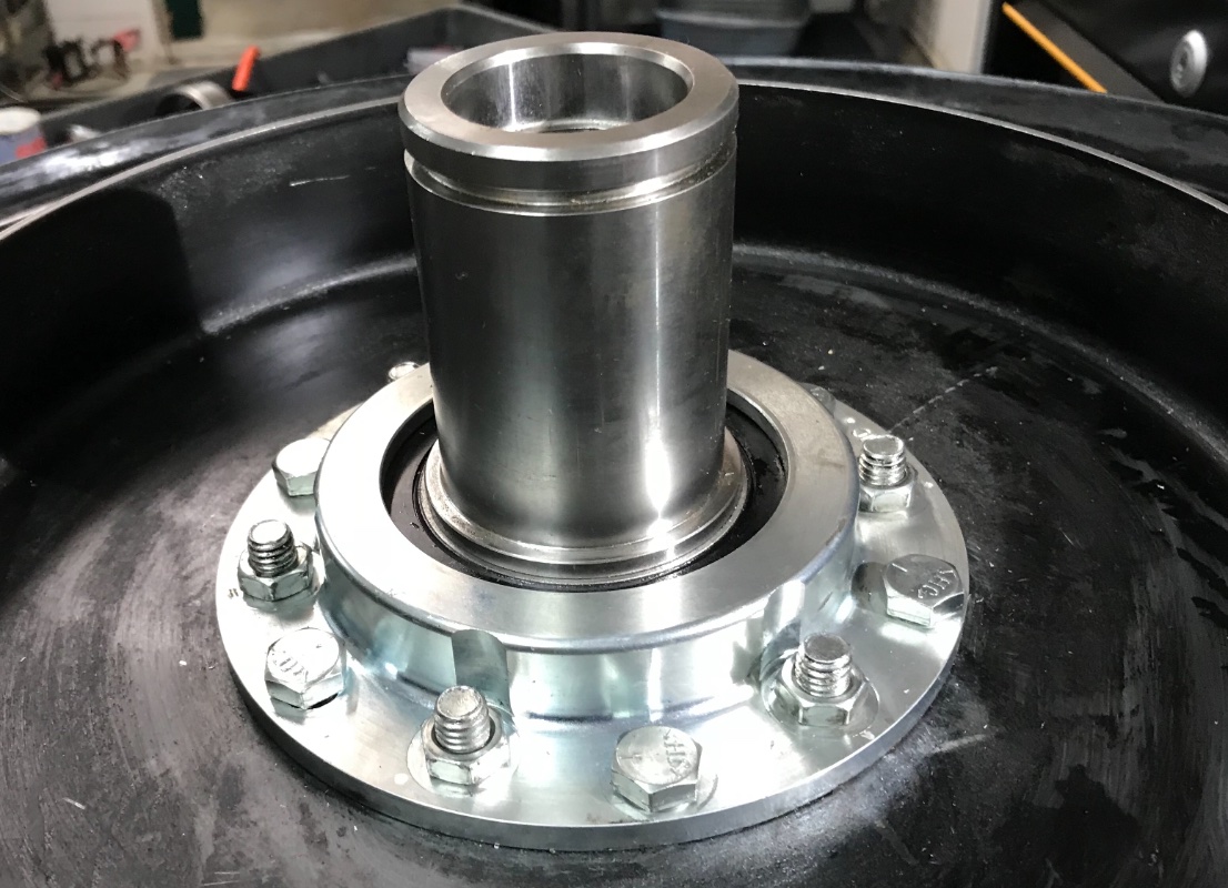

I finally finished assembling the the new Ruckstell rear end, along with two new axles, new spider gears, new ring and pinion gears, new sleeves for the roller bearings, new axle seals, inner and outer, new universal joint, and I painted it. If will will ever warm up on a weekend, I'll re-install it in the '22 coupe.

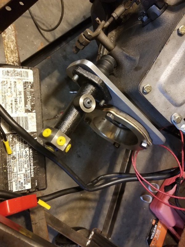

Made a bracket to hold the master cylinder for my front brakes. Tested the master cylinder. Made a rod.

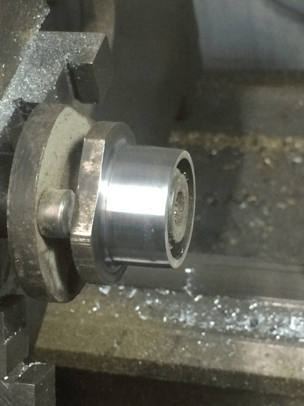

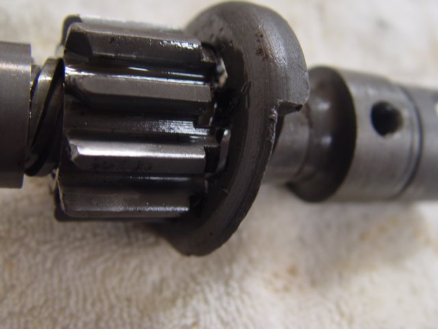

Shortened and polished cam gear nut, bored and faced old cast cam gear & installed.

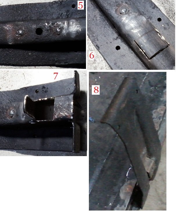

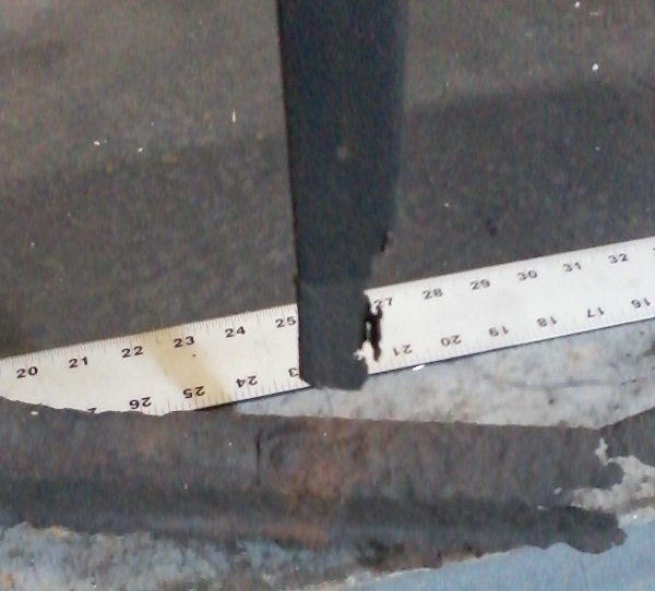

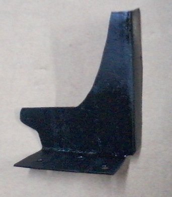

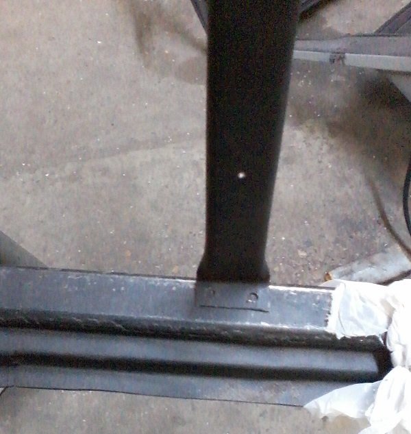

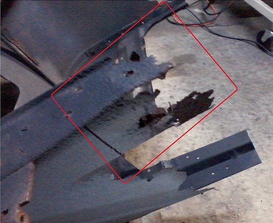

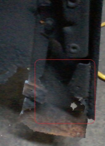

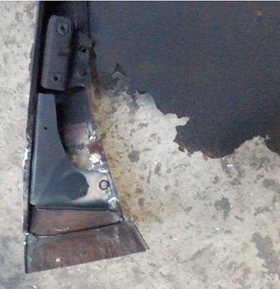

1926 Coupe lower left A pillar where it meets the sub-frame...
The bottom flange will wrap around sub-frame rail.
Rotten side panel to get replaced after cab is united to rails.
We made our own lower seat bracket from a thick electric panel and embossed the front with a bead roller.
Note that this one is one piece, not the three piece, spot welded together. A hex bolt was cut up to make the two rounded pegs for the front of the cushion to sit upon (which is two position).
We also made the two brackets that the rear of the bottom seat rests on. Some coupes have 1, others have 2 of these brackets. Here the parts are attached to the sub-frame.

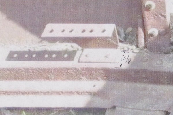

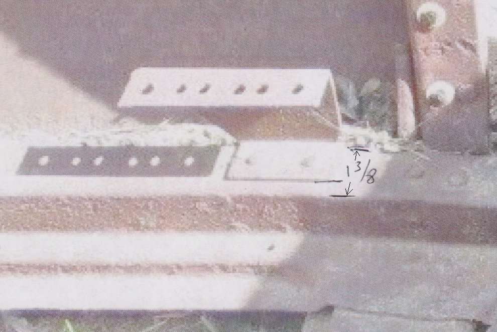

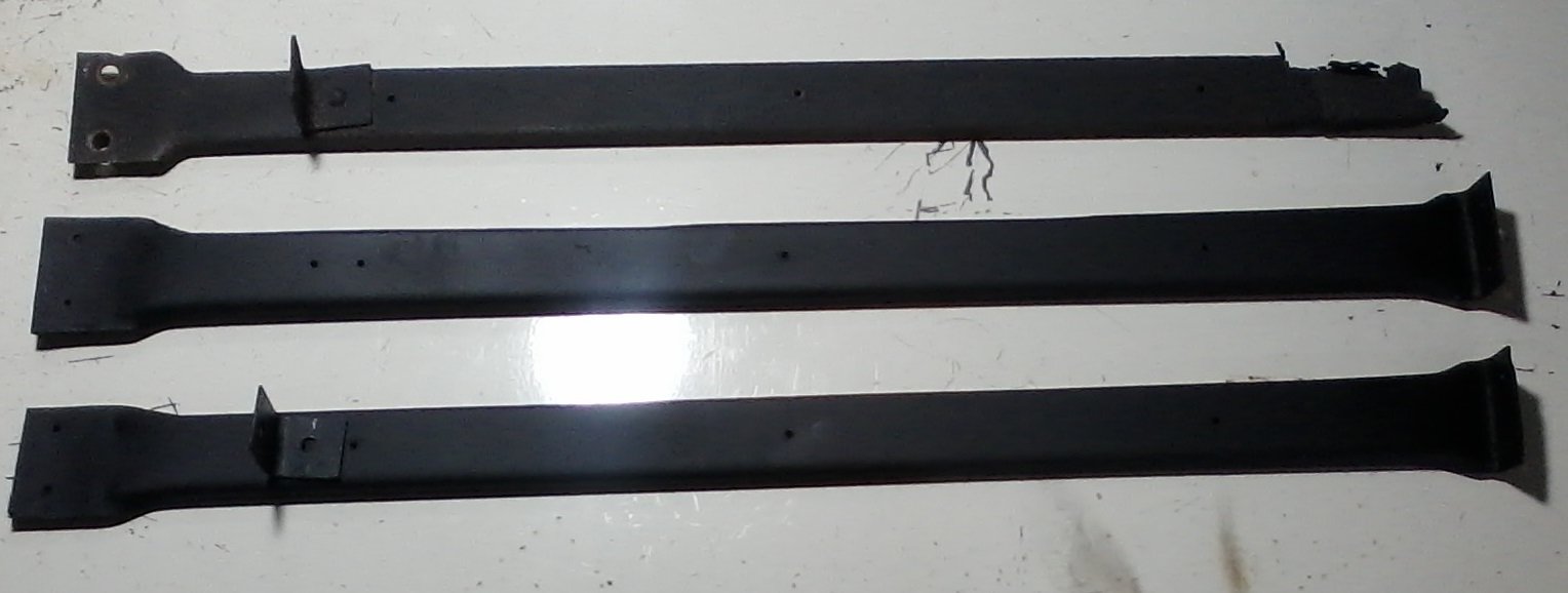

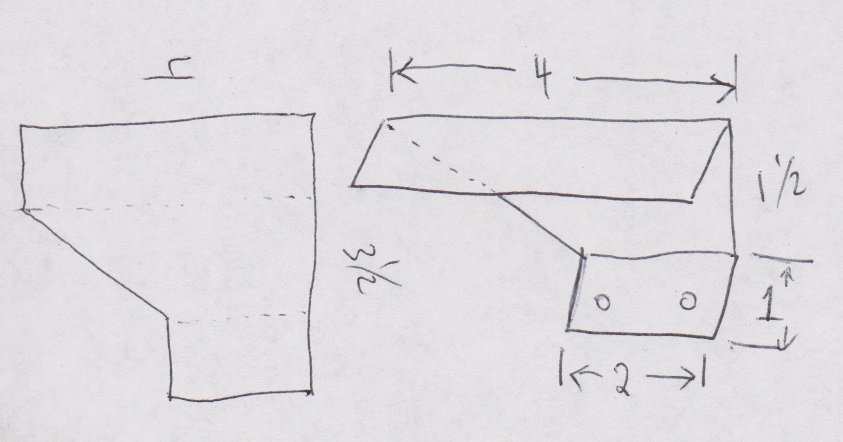

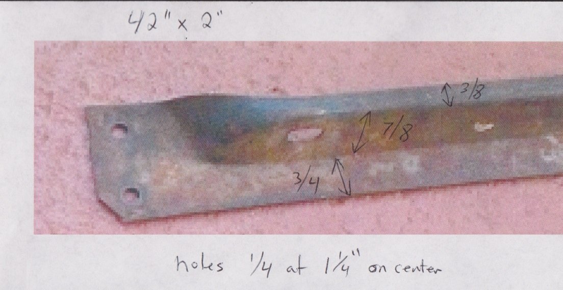

There are at least two different types of brackets for the seat back that sits on the rails for the '26-'27 coupe.
One of these is adjustable and probably accommodates the wood shelf below the back window, while the other most likely matches a metal shelf. Left and right sides are symmetrical, left side shown. These measurements are guesses from a photo that came from somewhere. Since my sub-frame rails are boxed in, the two holes on the bottom of the bracket are for plug welds, not rivets.
The most difficult part, as always, is getting the dimension.
Here is another photo that I borrowed from somewhere for a part that you cannot buy. It is lower bracket support for the seat back that sits on top of the two sub-frame rail brackets (photos in prior post). That was confusing.
I don't know what the actual length is supposed to be but it aligns up with what I've got.
After two failed attempts of getting rounded ends I gave up and just cut and welded the right angle.
Since I cut the ends to fold them back, I had to sister up two inches on each end to mask the holes. The seat back will sit up 1/16" higher.

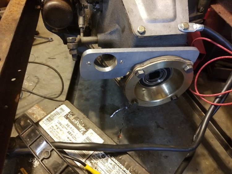

Not as much as some of you for sure. Bought a accessory modified for my 26 rpu and dropped parts to be powder coated. Drove model A to dad's last week and will tomorrow. Maybe some actual real T work next month. Been spending more time planning on what I want to do in the spring that making it happen. I love this hobby..lol

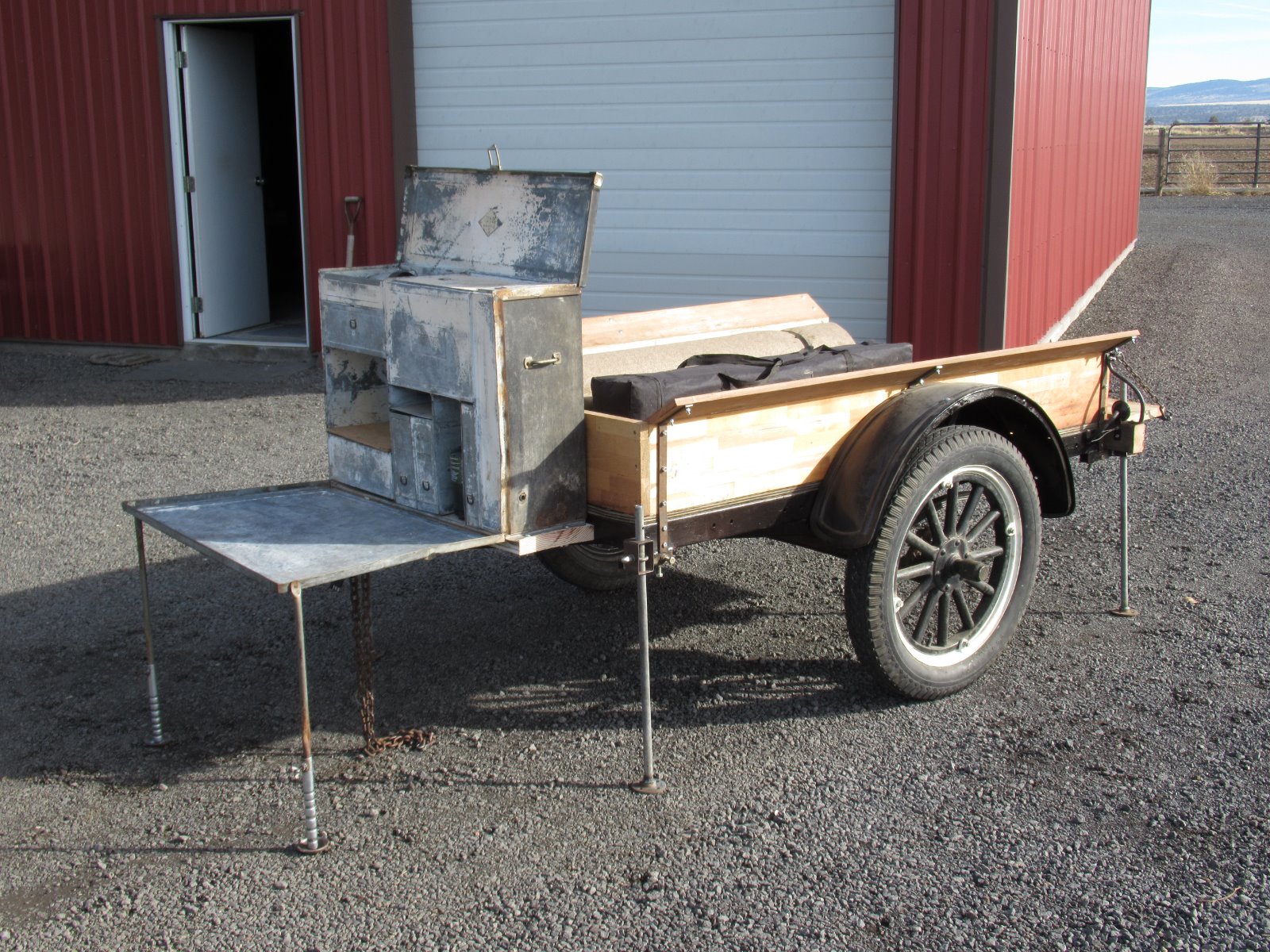

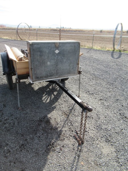

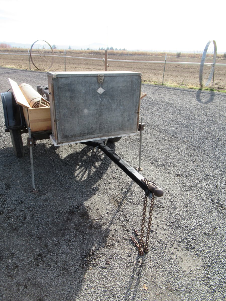

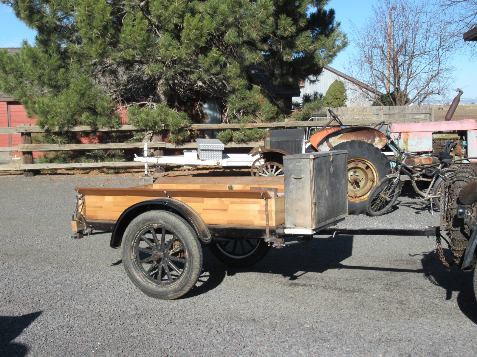

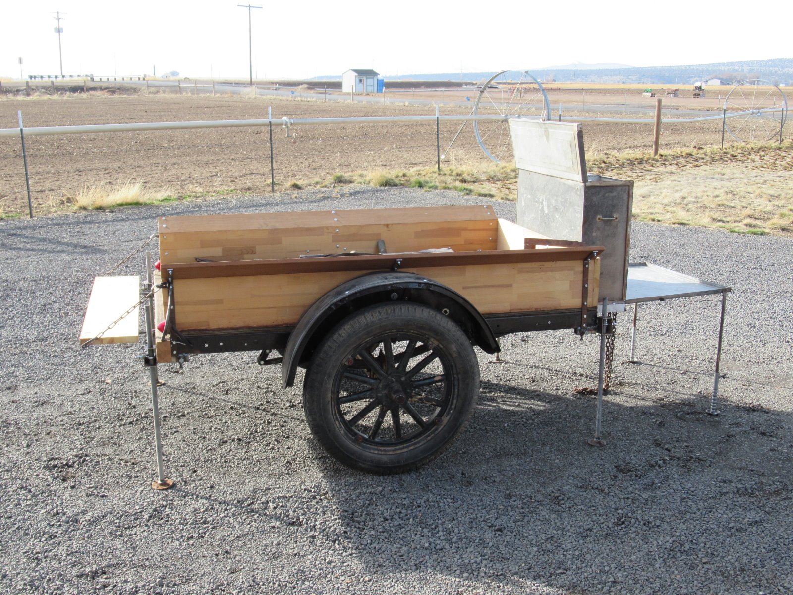

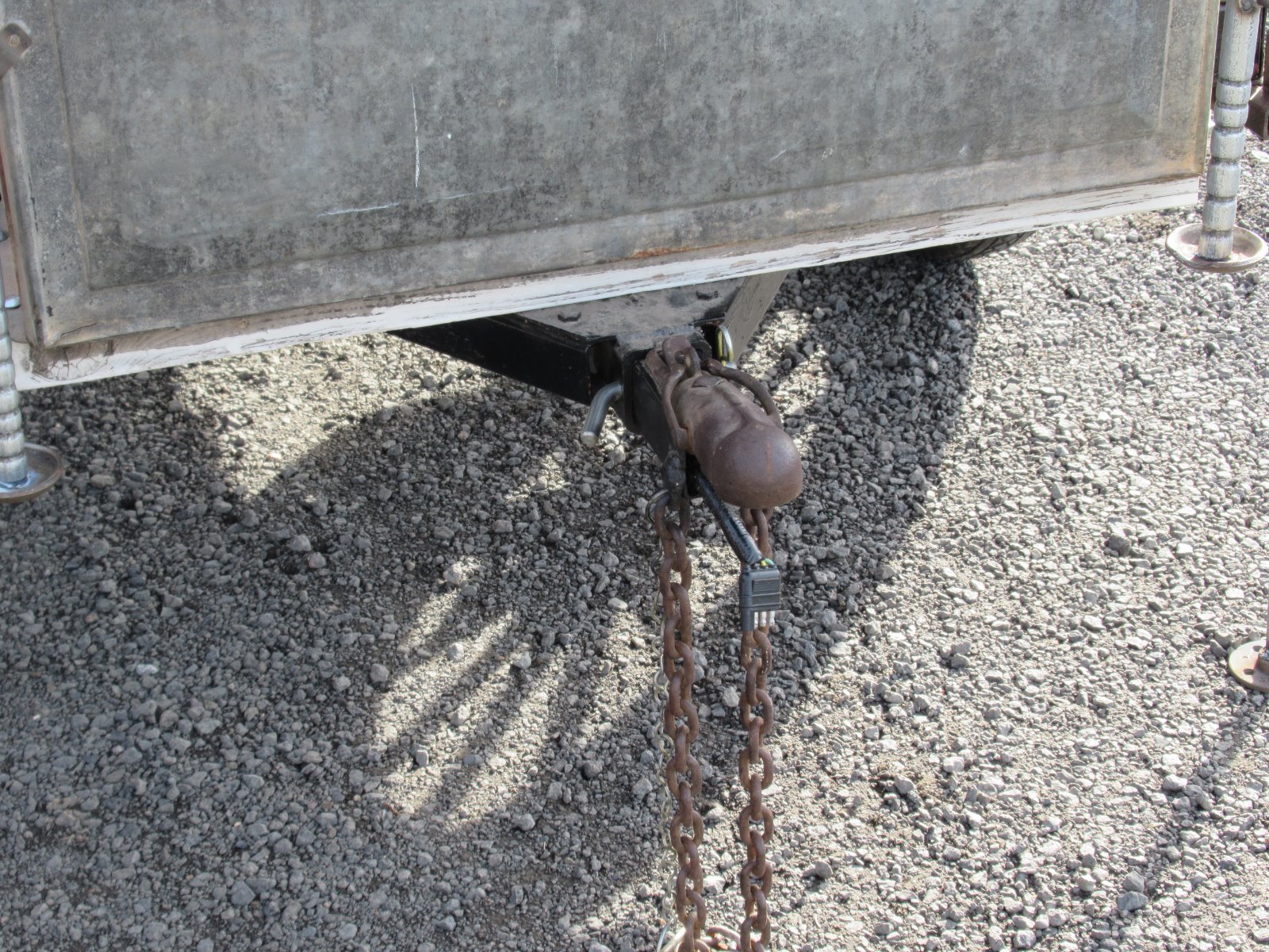

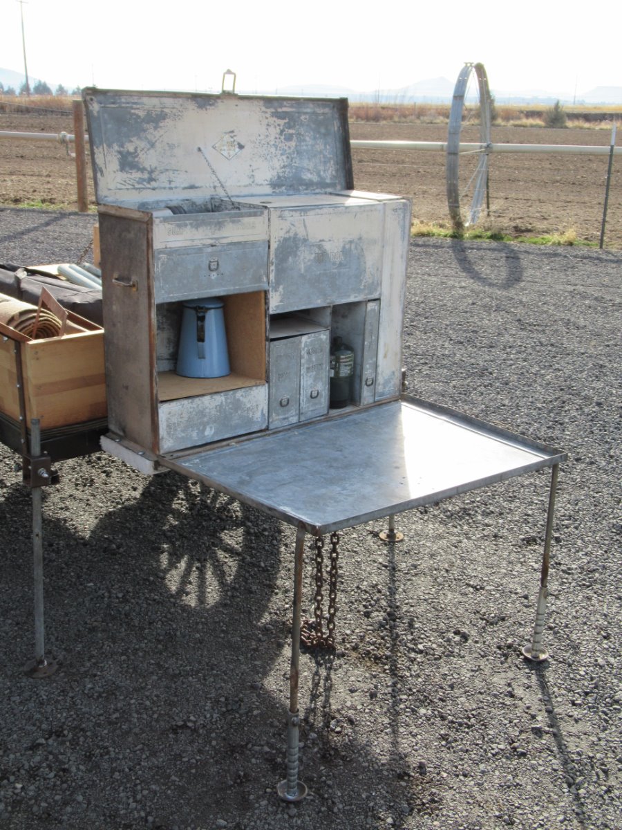

I finally finished (except some painting when it warms up) my model T trailer, I got a free cheap trailer given to me and modified the frame, put a T front axle on springs from an old buggy and was able to use parts and pieces that I had. I bought the kitchen from a fellow that was going to mount it on the wall of his shop because he thought it was interesting. I made it with a retractable tongue so it is out of the way. (got a new knee 2years ago after falling over a trailer tongue). I towed to coffee this morning and it tows really nice.

I guess that there is a limit on the number of pictures per post.
There is a bracket that screws into the wood beneath each side window and goes down to the top of the seat back bracket on early 1926-7 coupes. A later revision goes straight down, directly to the sub-frame rail.
That's what's left of the rail and two visible rivets above. The right side piece was totally missing.
This is the homemade replacement piece. Here is the only original piece and the two I was hammering on today from scrap. The holes were enlarged after this photo. Measurements that I came up with are: 25" long, 1-3/8" face and 5/16" sides. No one makes these.
Also made the tiny L bracket and going to reuse the original one.

installed a newly rebuilt carburetor. Big difference in the way that the new engine runs. Next put the rebuilt front end in. Had some sun in between the snow and cold, went for a drive just to make sure I still remembered how to do it, ha, ha. Can't wait for spring.

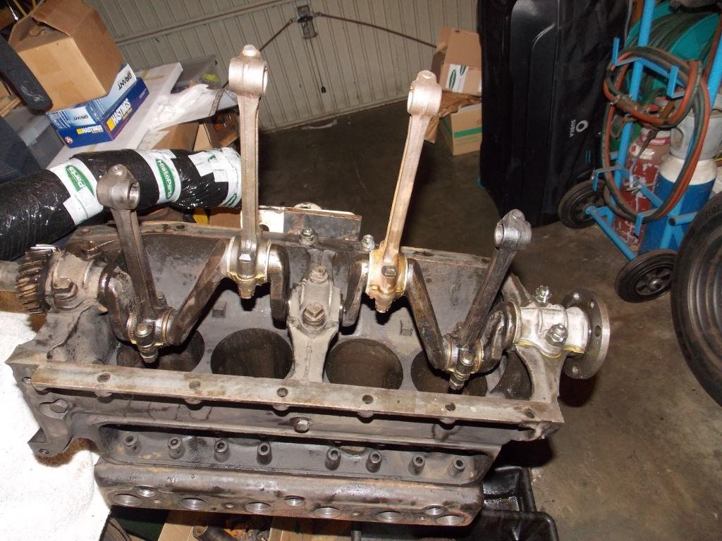

Weather to bad to set a dog outside.
Rain, wind, cold.
Good time to go on with the engine.
Set a new third bearing on the crankshaft and regulate the rebabited rods this afternoon.
Andre
Belgium
Rain, wind, cold.

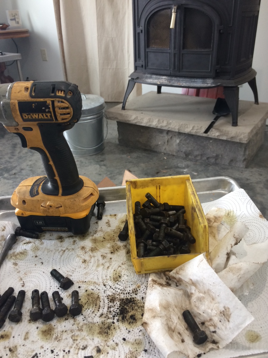

I clean pan bolts all day yesterday
Finally finished cleaning and painting the engine block. The weather and my health have not been cooperating. Its not the proper color for a 27 engine but this is for my bitsa so I went with what I've got in stock.
Just give me time to Rust and I'll be good as new.
I finally got everything I needed to install wood bands in my transmission.....including a rather neat little countersink that I modified for the job.
The first band took me about three hours. The other two about an hour each, but everything fit which is saying something for non demountable bands!
Next task is to disassemble and sandblast the hog's head, then reassemble with new parts and install. At that point, all that's left is distributor ignition, model A intake/exhaust and drop the cylinder head in place. Probably another month or so at my pace!
Not for a particular T, but for all of them. I replaced the broken window in my spark pug tester.
I ordered a couple of spares just in case of future need. Unfortunately the glass shop got them slightly too big to fit, so I had to grind them down a little. Glass is hard stuff, so it took awhile.
- Posts: 7411
Wrapped up the plug stuff for now, gapping and testing two sets to carry under the seat as spares.

My 15 came with the front fenders unattached so I almost finished drilling and bolting my left fender on.
I will try and finish the left and move on to the right front today.
