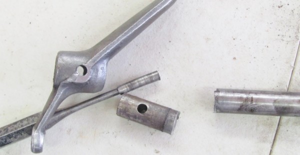

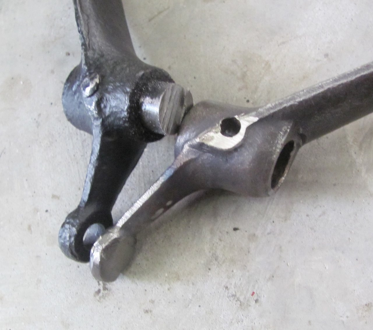

First of all, I finally gave up on trying to drive the pins out. Heat, a punch and large hammer had NO effect. Rusted pretty solid, so now we drill them out.
Had to cut the old shaft in order to remove the slow speed cam from the hog's head. Carefully lined everything up in my drill press, center drilled it and began using progressively bigger bits up to 1/4". When I removed the cam from the vise, I was delighted to see that it was an almost perfect job. Easily close enough for the new pin.
The pedal, well, that's another story. Again I lined everything thing up and drilled as before, but this time the exit hole was off by about 1/4 of the pin diameter. Off to the welding shop this morning! I'll have them weld up the off center hole, then wait until my replacement shaft gets here. I'll place the pedal on the shaft and redrill, using the straight hole and shaft hole as drill bushings.
Once I actually install everything again I'll "heat and beat" the ends of both pins. THAT oughta' hold!
