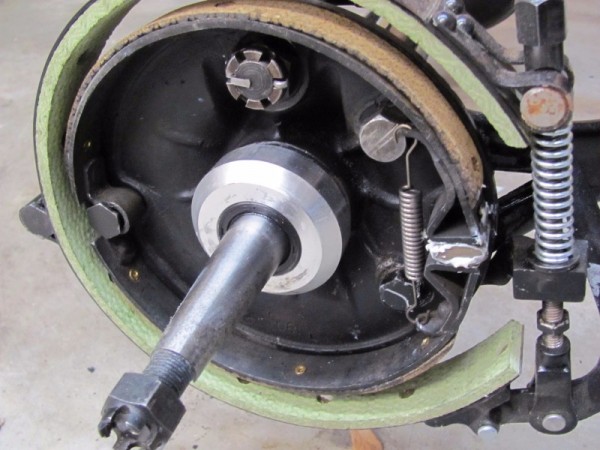

Larry does make these small drum brakes, you order from him and likely he can help ship export to you, obviously more easily bought in the USA.
And another makes the rods and equalizer assembly, bolt on, without drilling frame. I have this set of attachments and they are well made too.
You will need a modified brake pedal or buy the accessory pedal from Larry too.
My set of Larry's A-C reproduction brakes, the emergency brake shoe is old accessory one-piece steel with new lining.

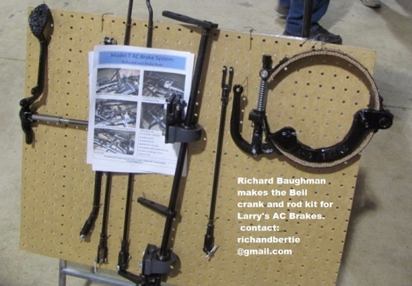

Richard Baughman makes the linkages for AC brakes.
