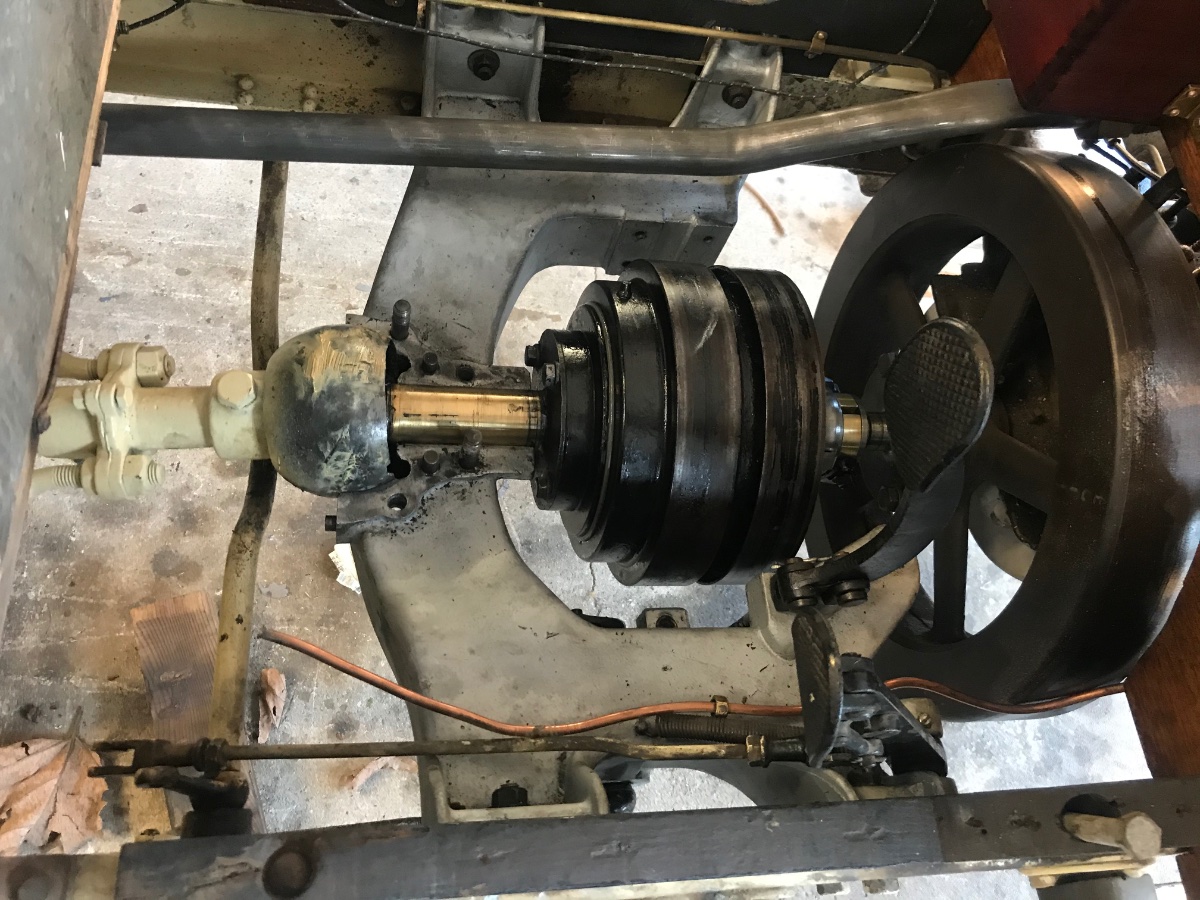

Transmission Repairs
Post by FreighTer Jim » Sat Jan 11, 2020 11:24 pm

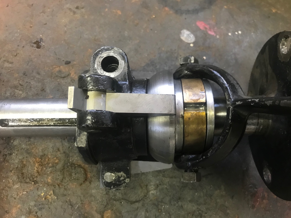

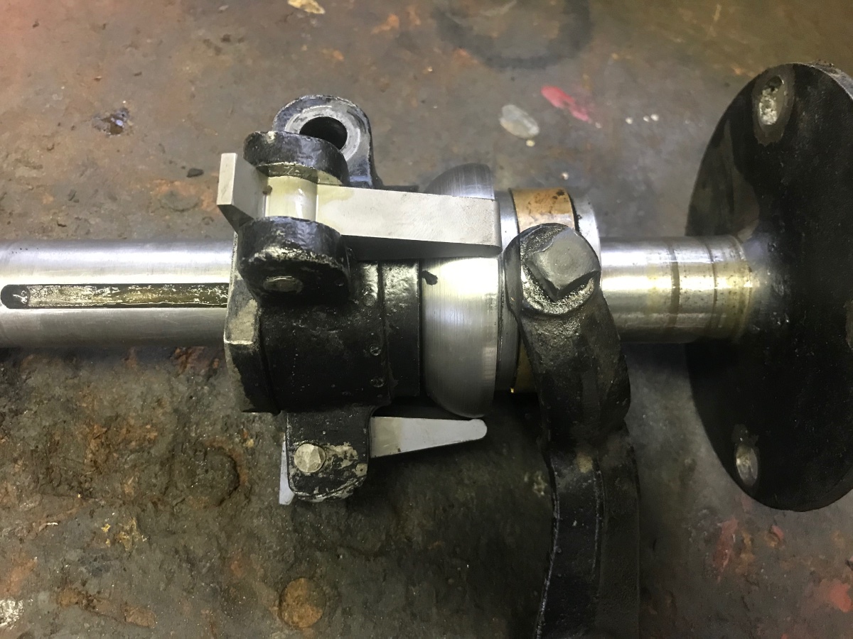

Kim has been plagued by transmission repairs.
Dean Yoder had transmission problems with the 1906 Model K.
Since no one living has had any practical experience with the Ford Model B other than
Wayland in Oregon - it has been a learning process for Kim.
The transmission linkage with recently made fingers and ball.
Images courtesy of Kim Dobbins.
FJ

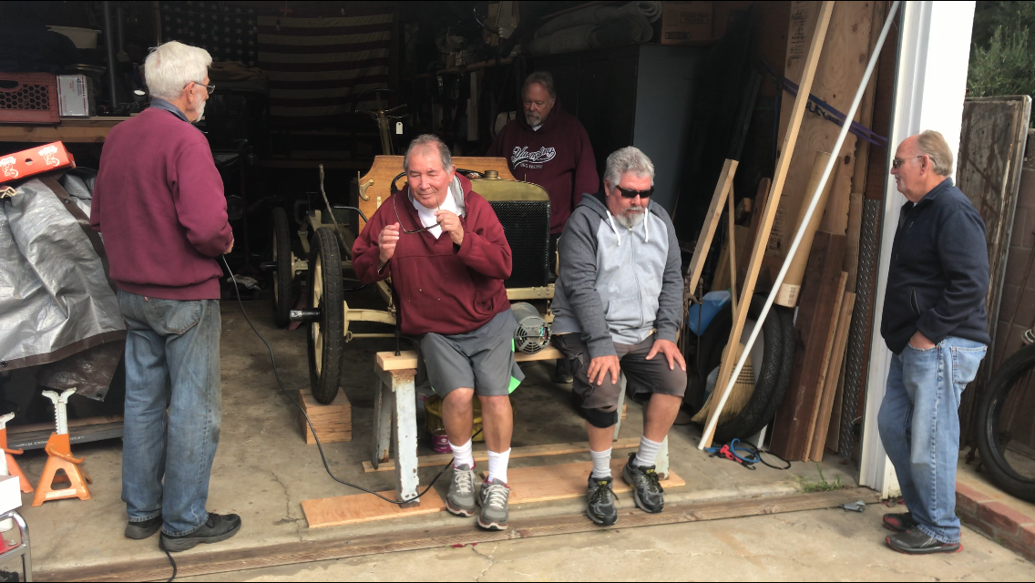

For this historic day - KD assembled a top notch crew of brother in laws and friends.
I filmed the process of start attempts for history.
The B caught - fired - ran briefly on three cylinders.

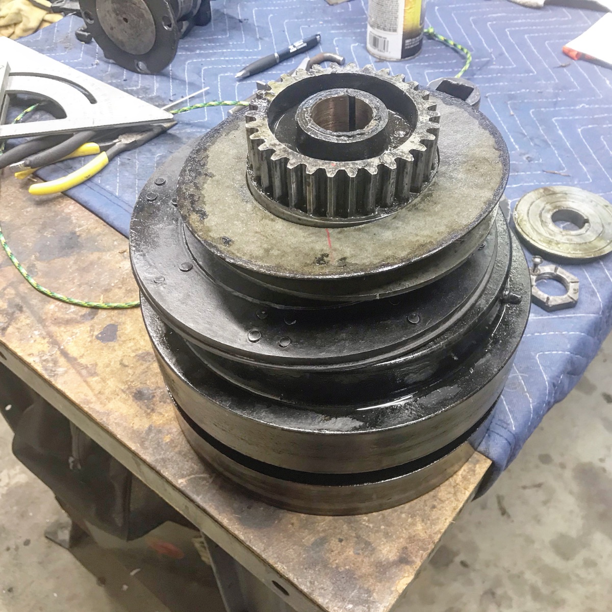

Two speed transmission
Post by FreighTer Jim » Sat Jan 18, 2020 9:43 am

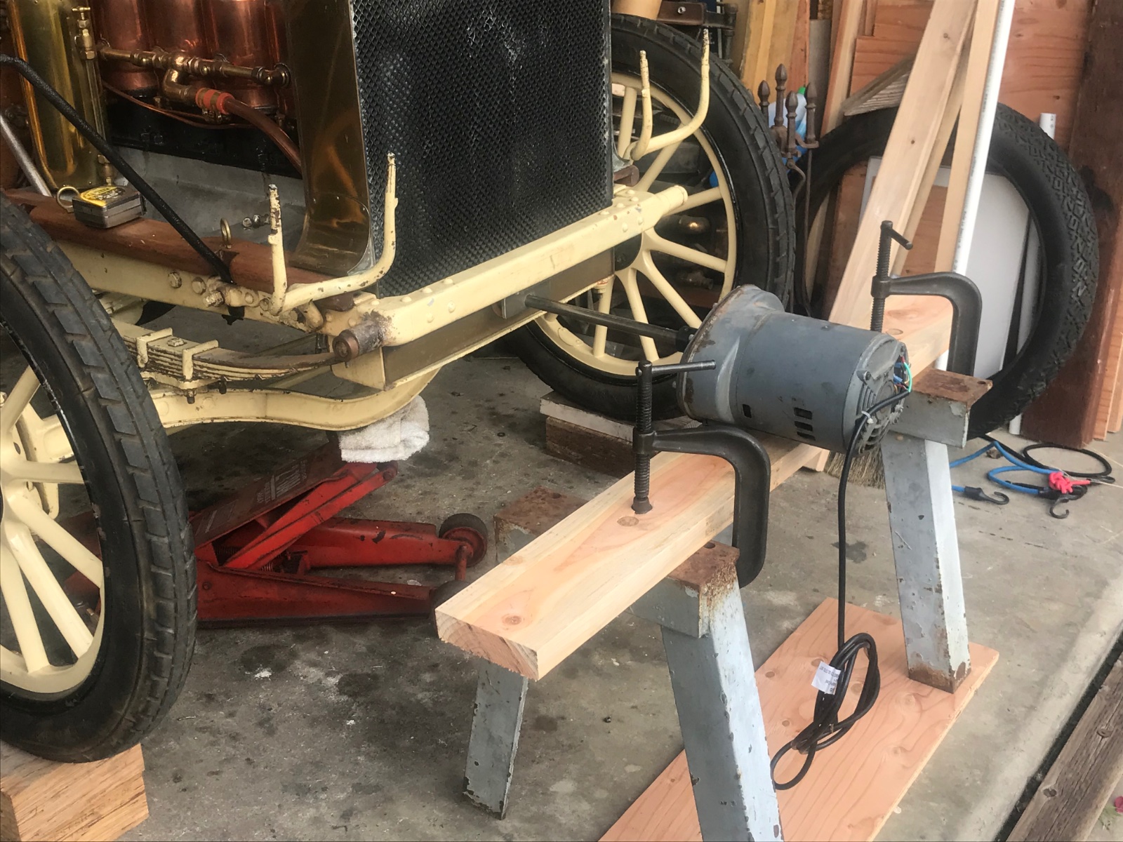

Here is the two speed B transmission on KD’s workbench.
FJ

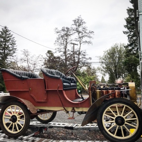

Story Noted Above
Post by FreighTer Jim » Sat Jan 18, 2020 11:00 am
The story of the discovery of the car is outlined in an earlier post on this thread.

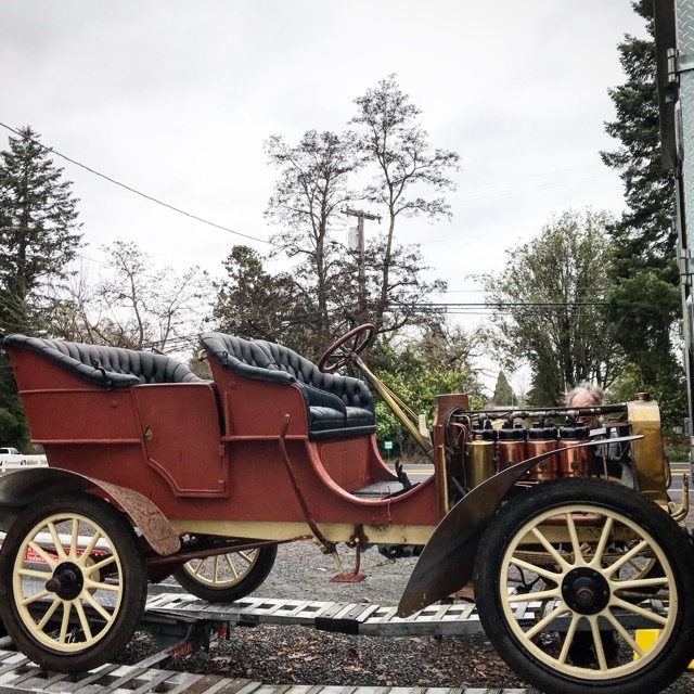

This is December 2018 when I picked it up for transport to KD.
FJ

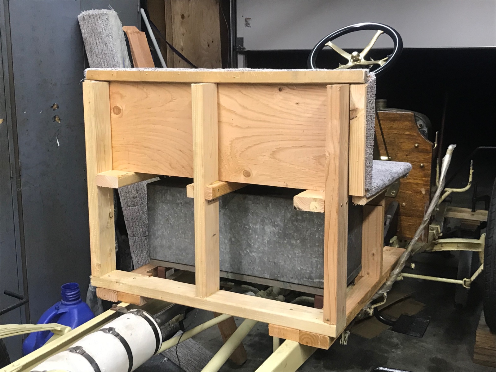

Post by FreighTer Jim » Sat Mar 07, 2020 7:37 pm
Since I last checked in - I started a photo album on Facebook and uploaded all the videos and most of the images for public viewing that I have taken along with images provided by KD.
The 1904 Model B caught on all four cylinders
and ran smoothly for at least a minute - I was
on hand to video that historic moment.
Images courtesy of KD ( Kim Dobbins ).

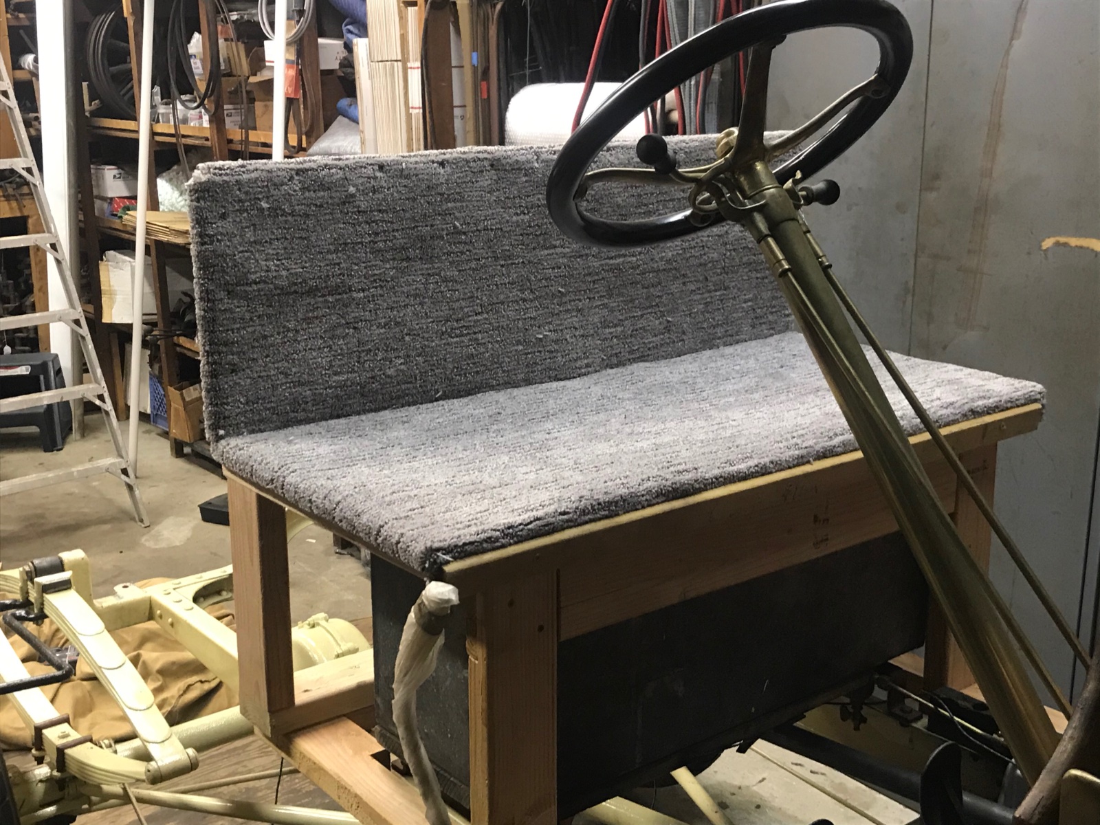

KD has installed the transmission back in the car.
He has to get the brakes & linkages hooked up.
He has fashioned a temporary seat for the maiden
voyage which I hopefully will get to video.
This has been the most historically important
endeavor I have ever or will ever probably be
fortunate and honored to document.

I don't want to put the body on the car until I'm sure it's road worthy, and didnt want sit on the gas tank so I made this temp seat. I probably won't have it on the road until after I get back from Chickasha. Work, family and customers cars seem to keep delaying the B. I'm really looking forward to driving it around for a bit.

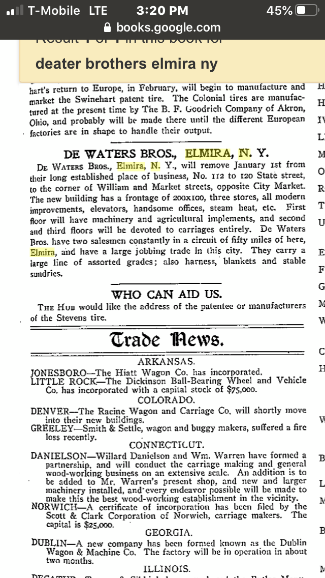

It is believed this 1904 Model B came from a building being demolished in Elmira, New York where a blacksmiths shop was located in the basement where the car was found.

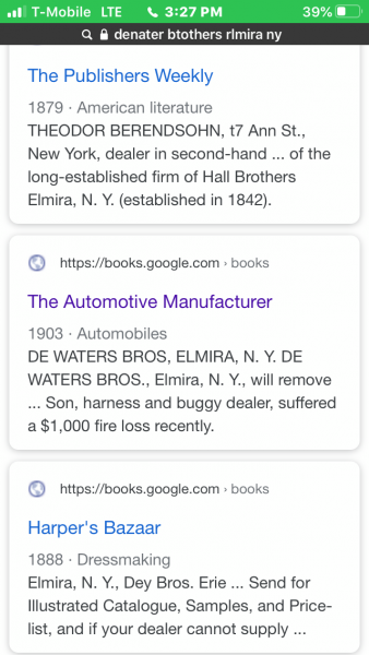

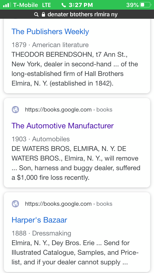

DeNaters Bros in Elmira is listed as selling # 208 (4/6/1905) and #230 (6/8/1905) Model Bs in Trent Boggess’ Datasheet accompanying Carl Pates book on early Fords. I’ve done research locally and have not found and information on DeNaters Bros.
The year of this discovery is not known at this time.
I graduated from Grammar school in 1957 and expect Dick’s purchase of the B to be around then.
Sometime later Jack Grace found the car acting on a tip.
Jack found it in the daylight basement of a residential home.
The home belonged to a gentleman involved with the demolition of the building who purchased it for scrap metal value because he wanted an old car.
Jack Grace handled all the details regarding the purchase of the car on behalf of Cecil Ralston of Gruver, Texas who bought the 1904 Model B.
The name of the town where the house was located and the name of the gentleman are unknown as of now.

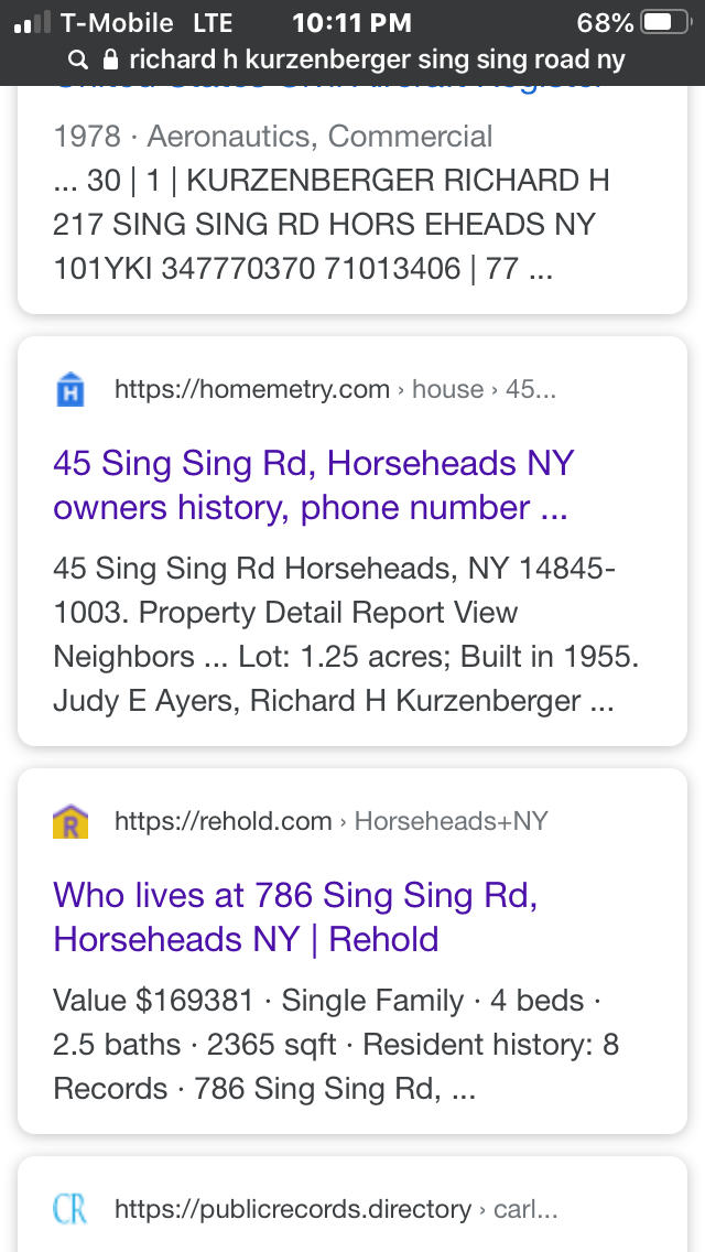

The town is Horseheads, NY. The Man was Richard Kurtzenberger.
Photos of the 1904 Model B taken at that time with dates on the back may exist.
If that happens - perhaps records exist of building demolitions prior to the photograph(s).
Then perhaps the gentleman might be able to be identified who saved the Model B.
FJ
My recollections of the B in Horseheads, NY.
Recalling my encounter with the Model B Ford, likely #52 as mentioned in the article. I grew up in Elmira NY. I believe there was an owner of #52 between the blacksmith's shop and Mr. Ralston, of Texas (in 1986).
As I recall we were at a gathering of the soaring group and someone mentioned that one of the members had an old Ford. The conversation went on and eventually we were asked to the member's home to see the vehicle. It was in a suburban home that had a drive in door in the back of the basement. I drive by the house regularly today. The owner ran a local business, and had somehow acquired this car (from a blacksmith shop?). His owner's name was Dick Kurtzenburger. We spent quite a while looking at the car and listening to Dick's stories. The only one I recall was that someone in Texas (Mr. Ralston?) wanted to borrow engine parts to reproduce parts for their car.
My old car interests hung on and I became involved with the local Twin Tiers Vintage Ford Club. One night some members were sitting around telling stories and I mentioned having seen Dick Kurtzenburger's Model N, (or S or R). My friend jumped on it and asked how I knew about THAT car, I related the story, and Bud said that the car was a Model B, not N (or S or R) and that NOBODY knew about it.
I’ve done research locally and have not found and information on DeNaters Bros. I graduated from Grammar school in 1957 and expect Dick’s purchase of the B to be around then.
